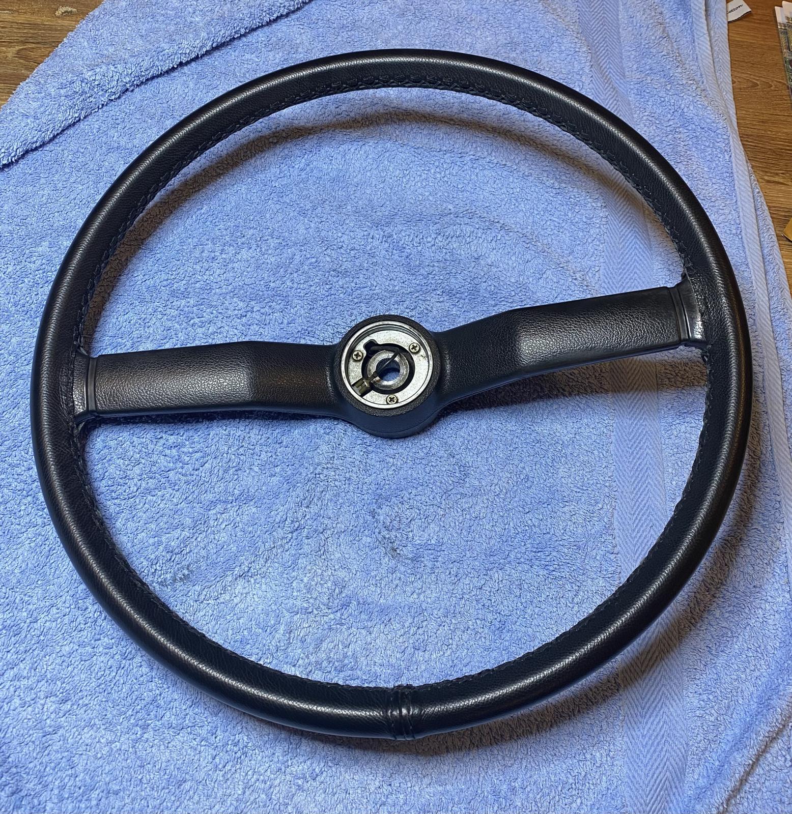

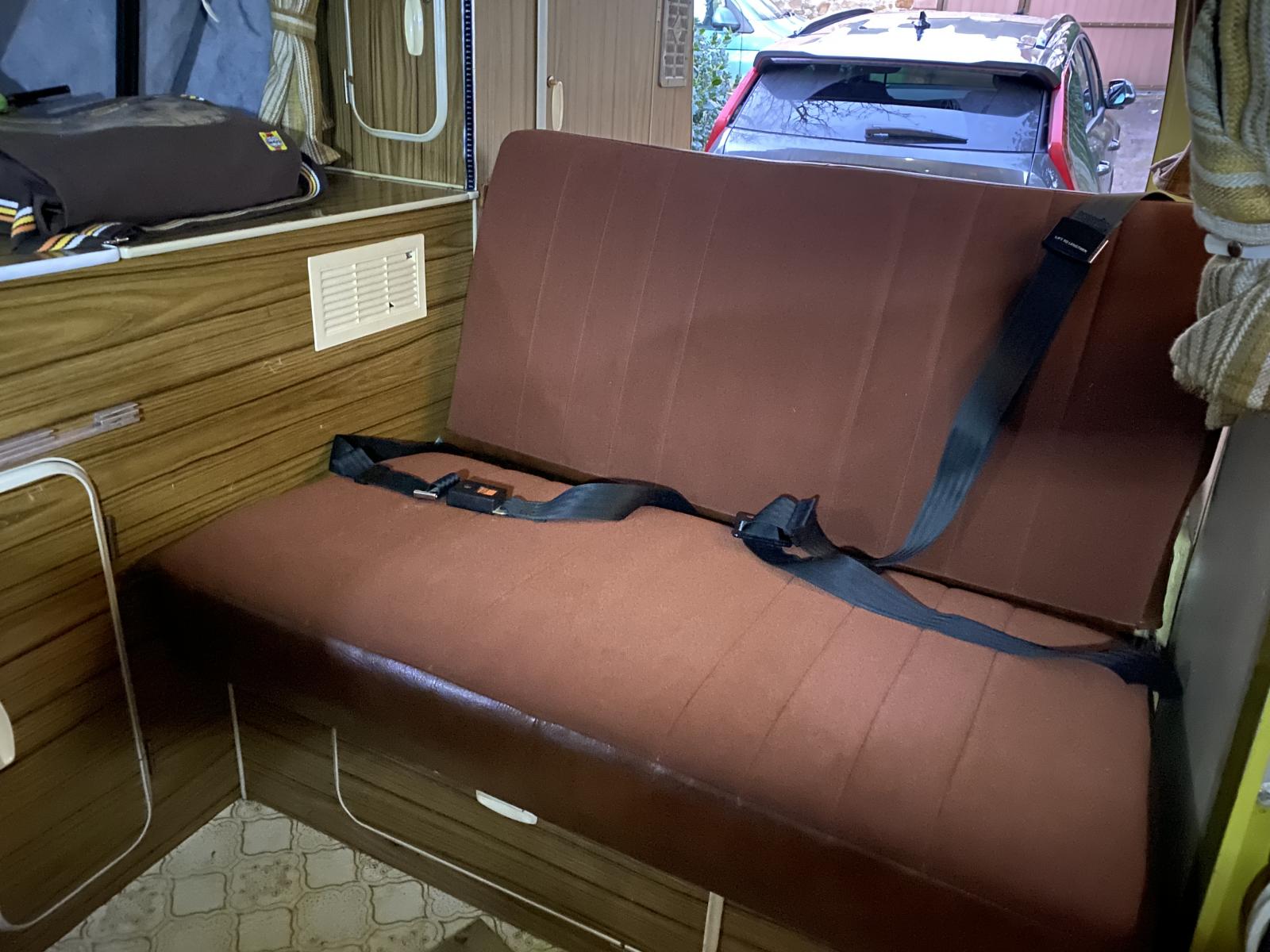

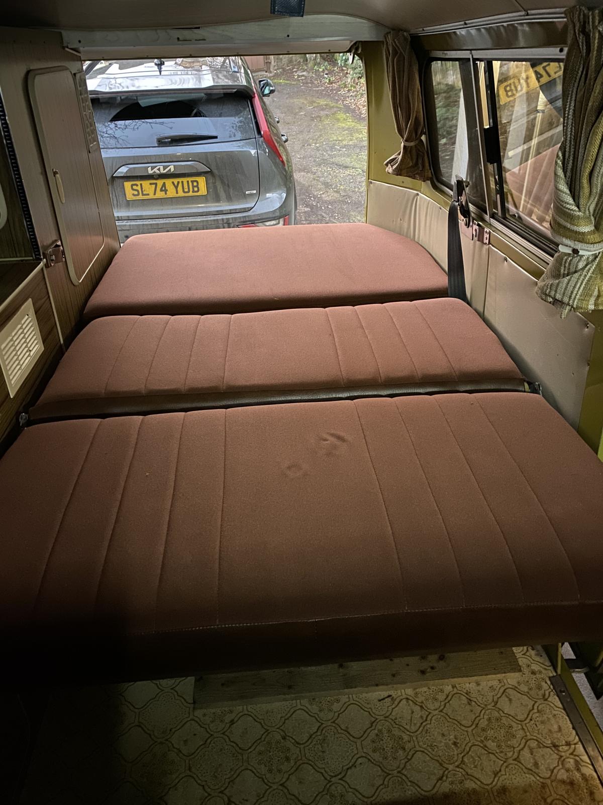

I think I have ticked off most of the small winter maintenance jobs I wanted to do. We are going away in a couple of weeks, so I wanted to get Olive roadworthy before we leave her.
Jobs included:
Wiper motor rebuild and lube
Washer switch replacement from parts bus
Wiring behind dash tidied and repaired
MPH speedo and tacho fitted
Radio/cassette wired in and period speaker fitted
Heater ducting repaired, boots replaced and cables lubed
Leather steering wheel cover fitted (this was loose on the hard, thin steering wheel but fits a treat on the bigger, padded wheel I got from the parts bus)
Loose glovebox strap repaired
Indicator lenses replaced from parts bus
Rock and roll bed fitted back in
All looking pretty good!

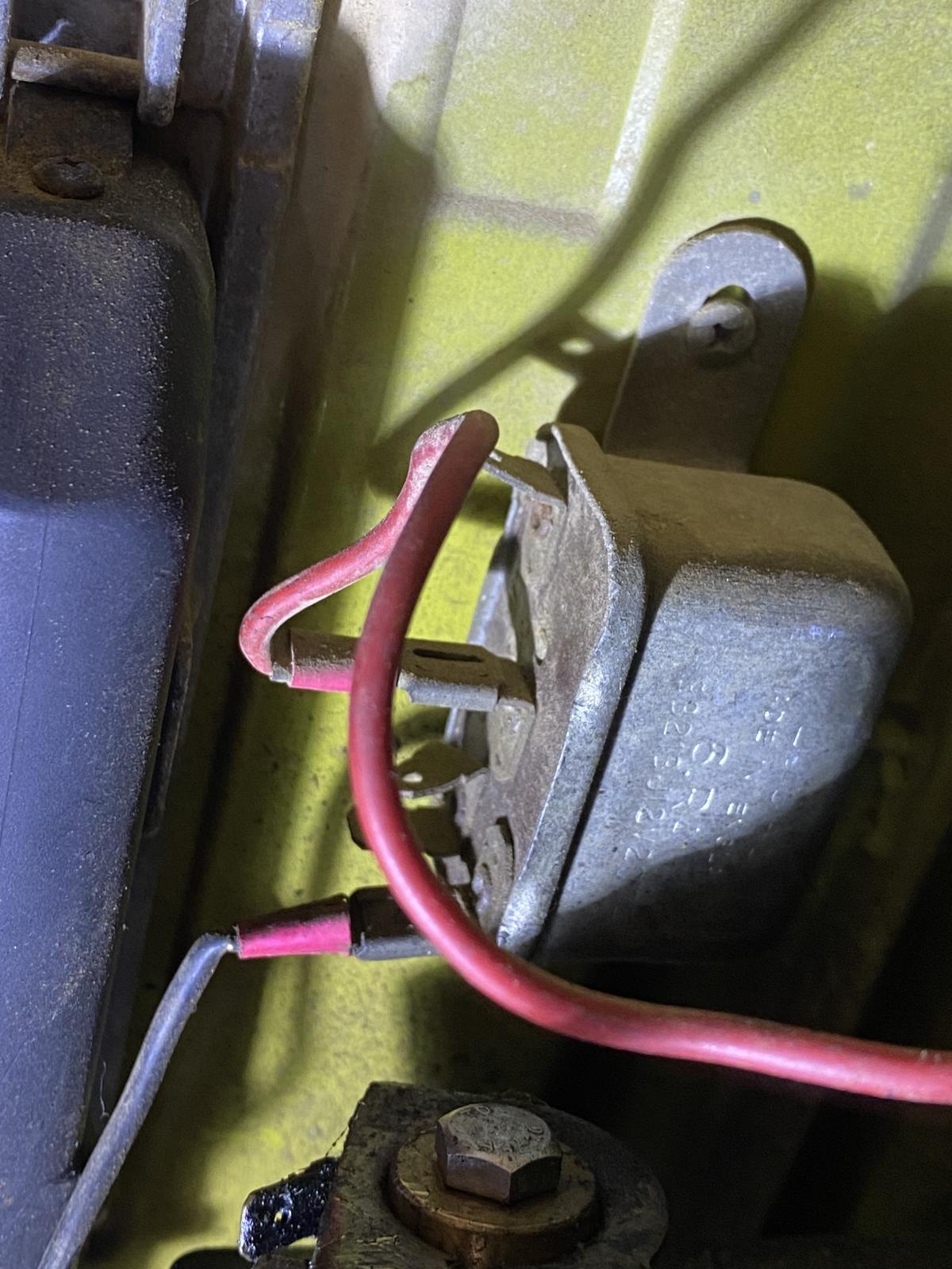

I’ve found another job to occupy me: recommissioning the Dometic 3-way fridge.
It has never (for us) worked with gas. When I did connect up a gas bottle there was an almighty stink and I discovered the gas line is disconnected from the fridge, but couldn’t see the end of the pipe.
The 12v input had a household mains cable attached to it but nothing on the end. When we were in Aus I wired on a cigarette lighter plug and ran it off the 12v socket at the dash. We had to disconnect manually every time we stopped and the plug melted after 11 weeks on the road!
On the plus side, the fridge did work on 240v. Yay!
I have found the fridge relay in the engine compartment, with no trigger wire and partially connected: to earth and a wire that disappeared into a bodywork channel along the side of the van.

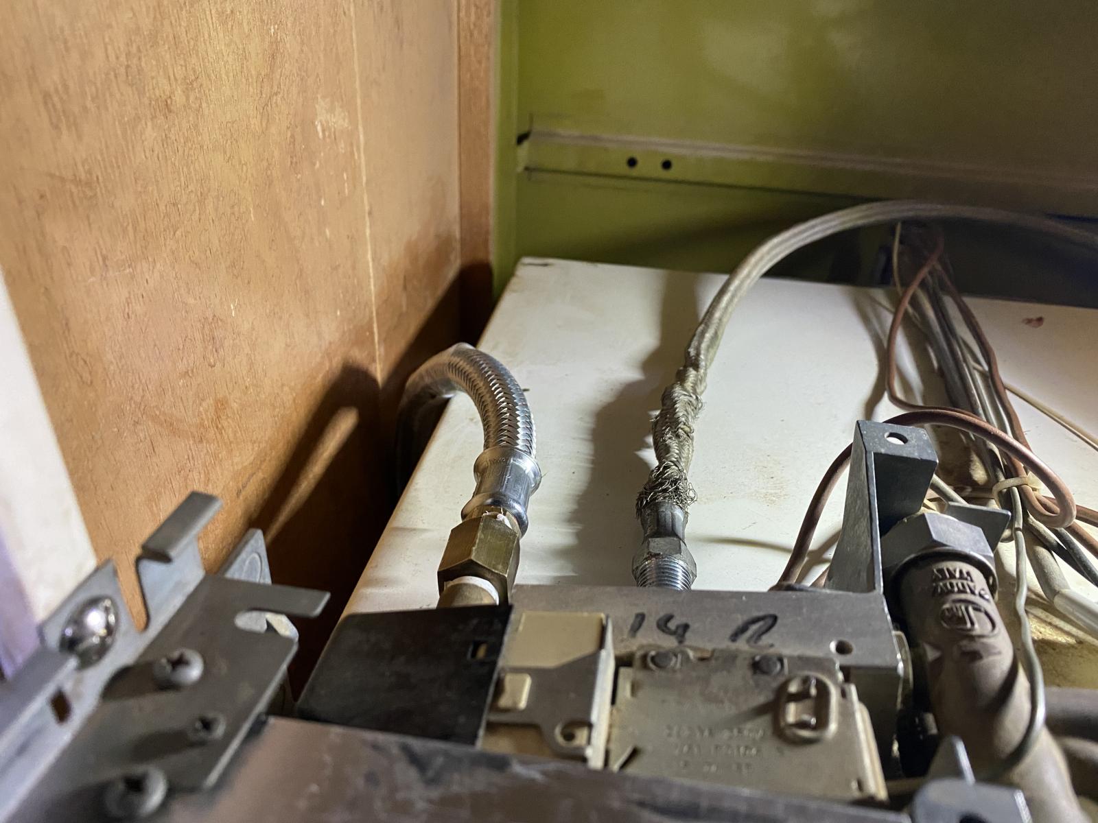

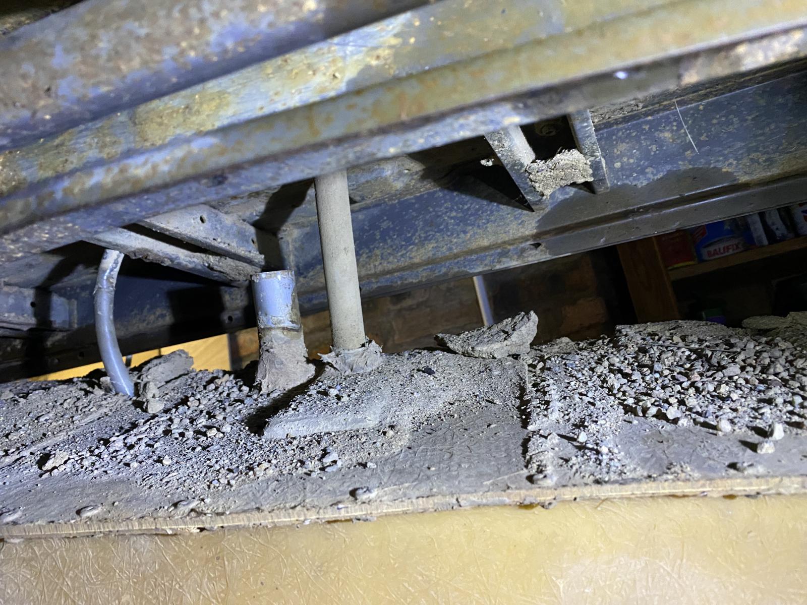

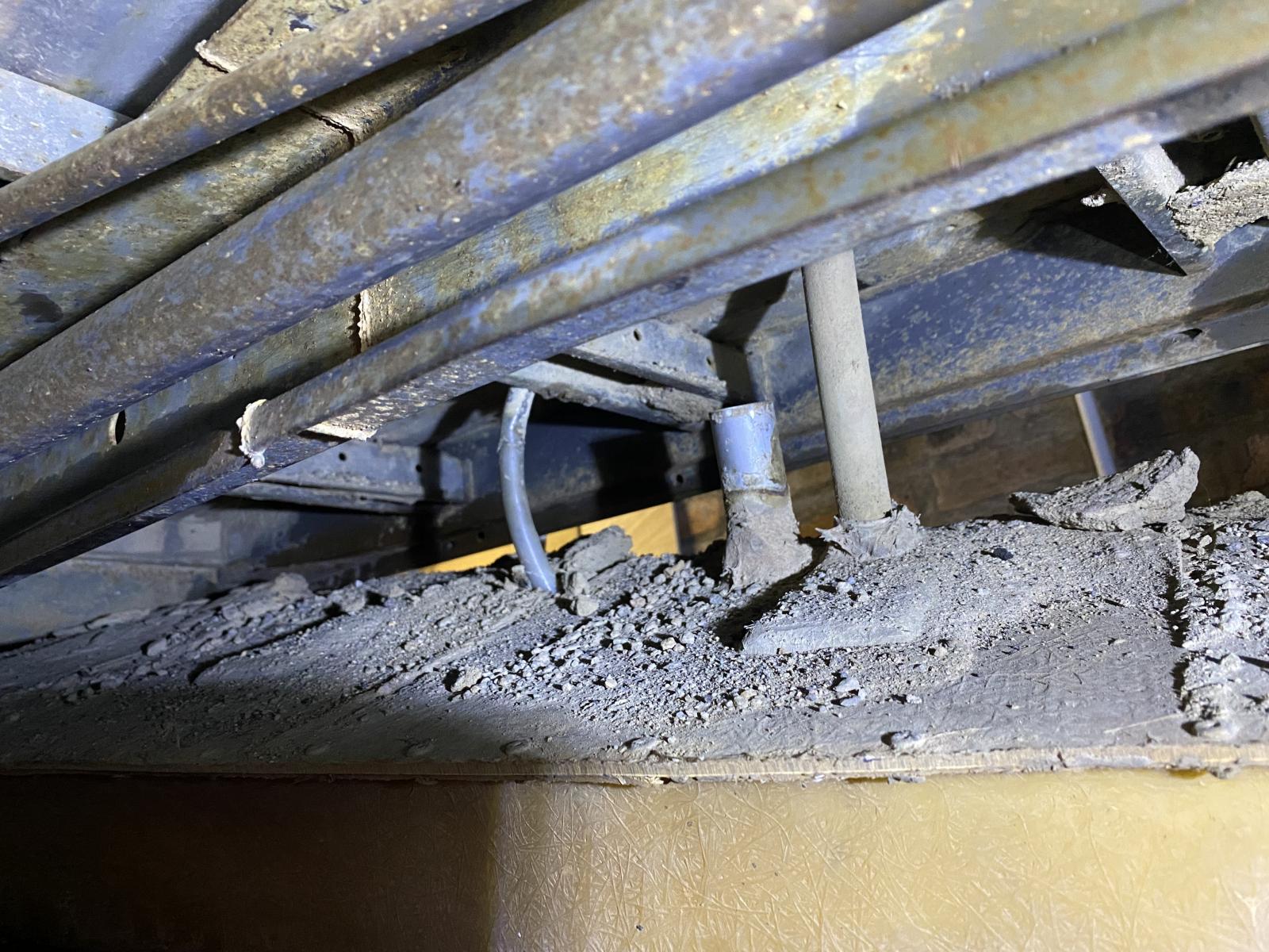

I manhandled the fridge out of its slot and discovered two interesting things:
The hot wire and an earth cable that must have been the original 12v supply, cut and lying behind the fridge. Hopefully I can splice in enough cable to function.

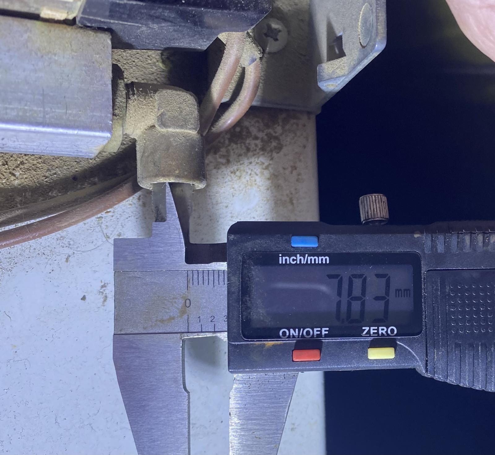

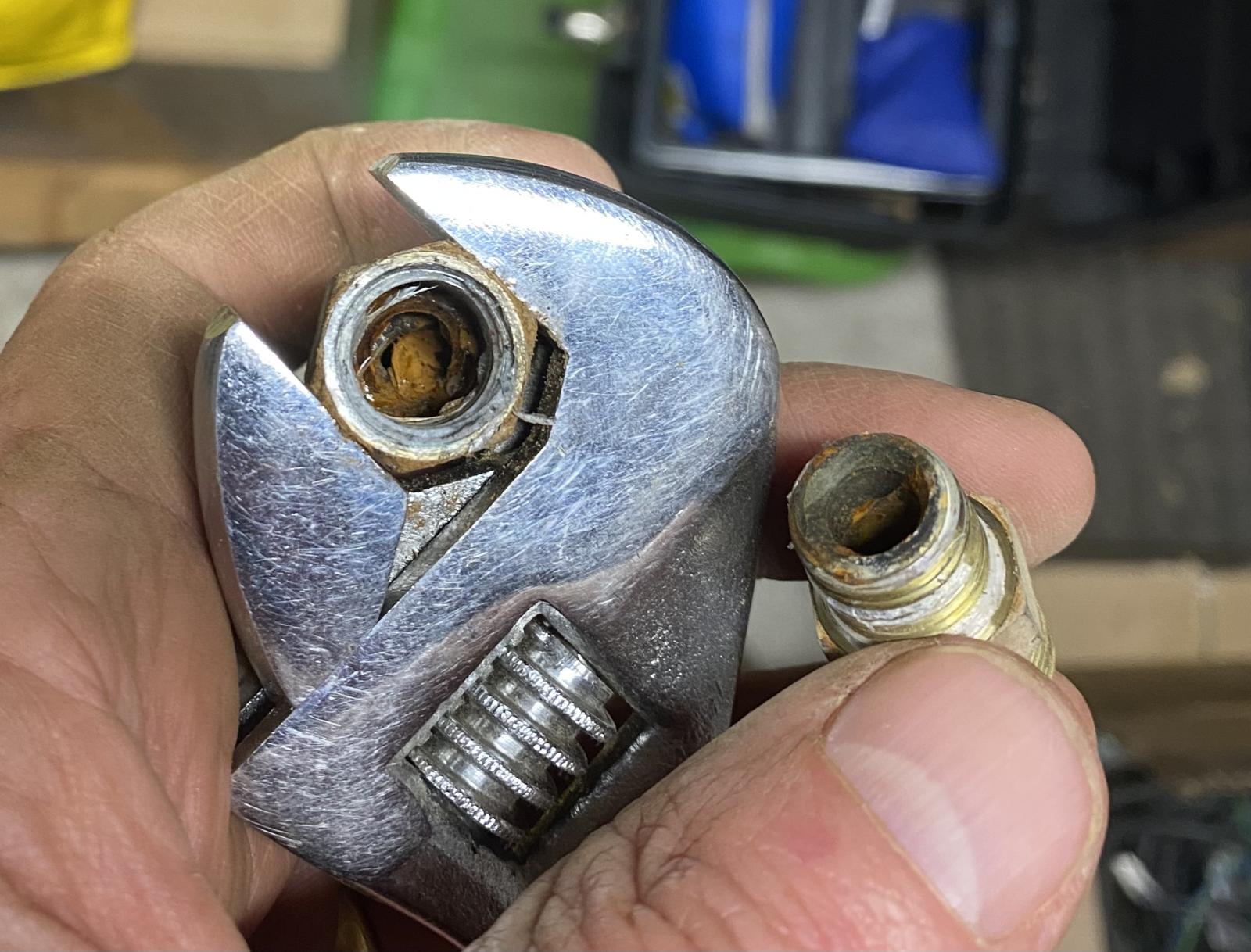

Also, there is a steel braided gas line with a tapered thread end that will attach to the gas inlet. Unfortunately it looks very elderly and twisted, but hopefully I can get a replacement and maybe get it running on gas again. Our experience with our other Dormobile suggests gas power is effective and efficient when it works. We’ll see! I might have to post on an Aussie VW forum to find out their gas connector standards.

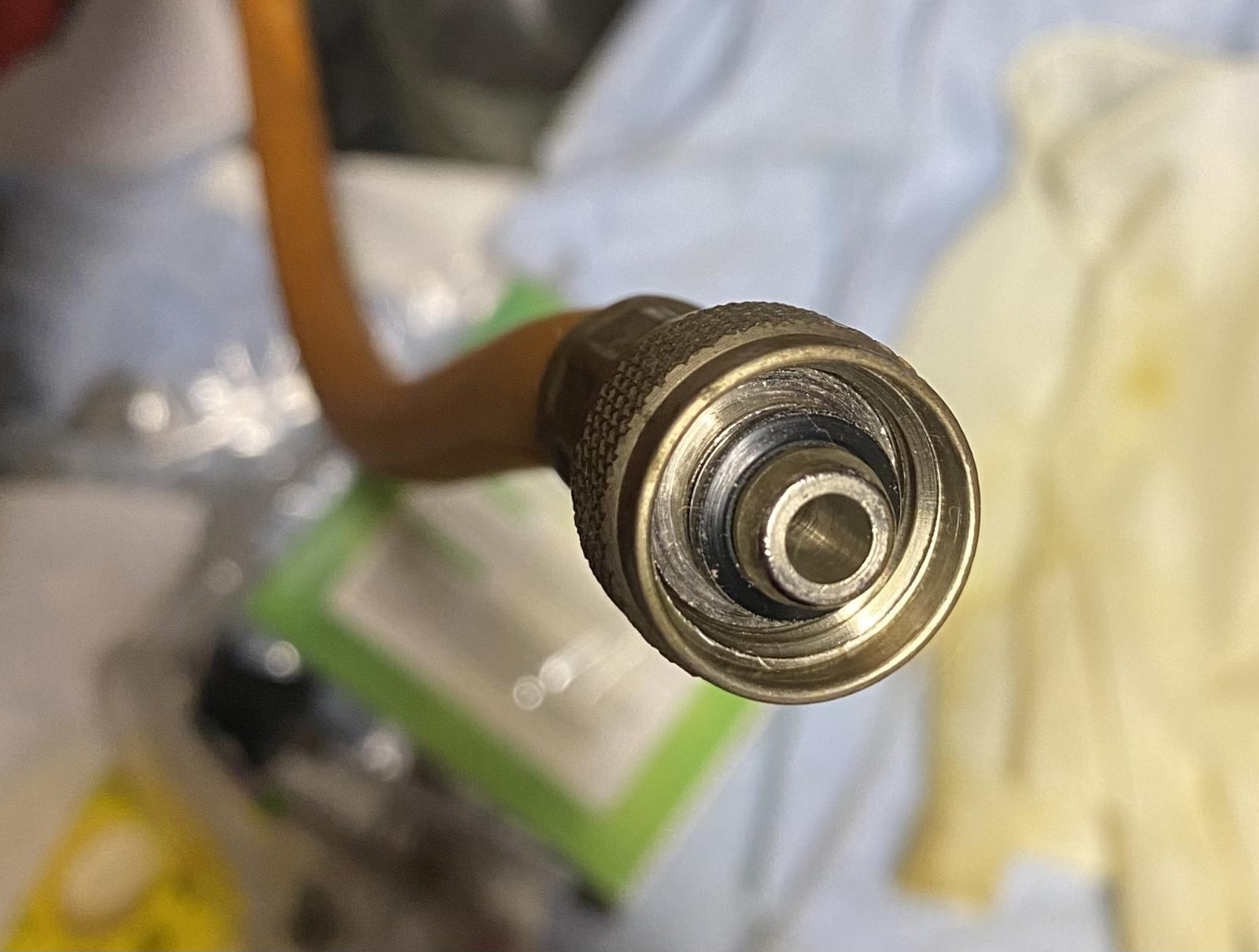

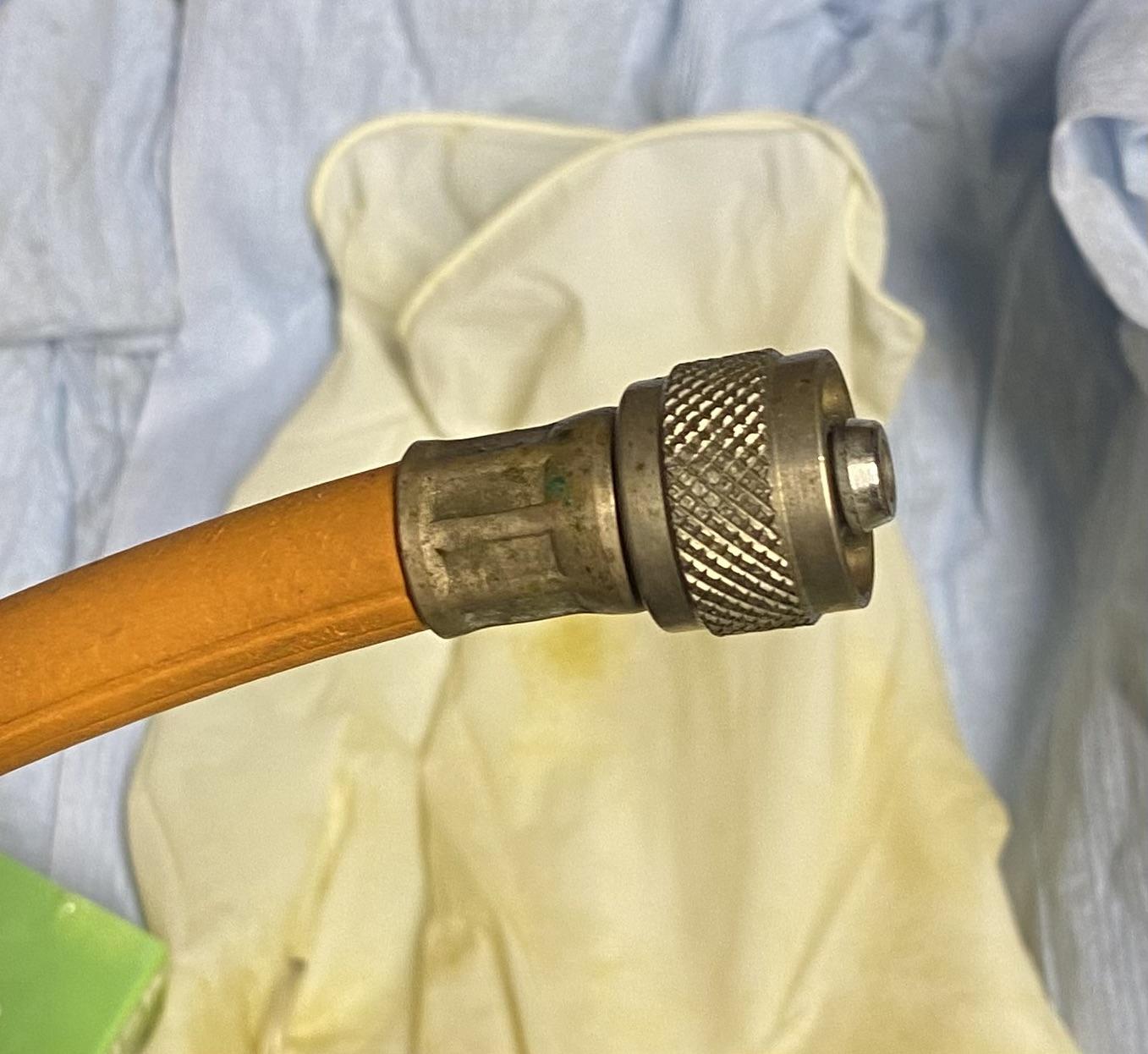

I also wanted to check the gas supply of the stove, which uses a separate cylinder. It runs off direct high pressure LPG from a Primus cylinder. The cylinder connection seems to be Australia specific and the valve connects via a BSP fitting to high pressure hose. I’m not sure what the connection is called that connects to the stove itself, with the knurled collar, so I have asked on an Aussie FB forum (the Kombi club). I think it might be called a companion fitting, but I’m not sure!
The stove works fine, the hose is about 8 years old and looks in good condition, so I think I will leave it.

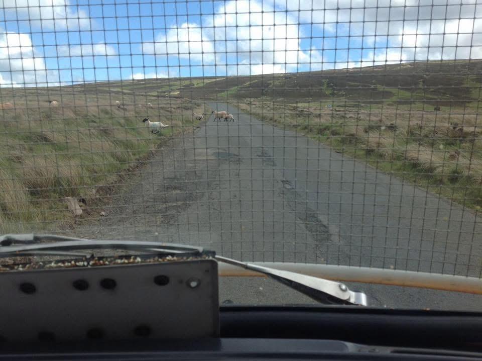

I have a genuine Australian stone screen which used to be fitted on our Orange Kombi and I plan to fit it to Olive. The screens were a popular accessory on campers in Aus in the 70s and 80s for over landing on the outback roads.
I wanted to get a feel for how the screens were mounted and angled and so I posted on the Australian Kombi Club FB page and it generated a few pictures (which are otherwise surprisingly hard to find online!) The first pics are our own Kombi…
They’re actually pretty similar in style and mounting and ideally would tilt upward to give better visibility (otherwise it’s like driving and armoured car!)

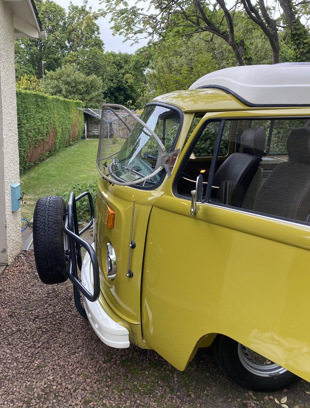

Posted: Fri May 23, 2025 2:11 pm Post subject: Re: 1976 ‘Martini Olive’ Aussie Dormobile Kombi |

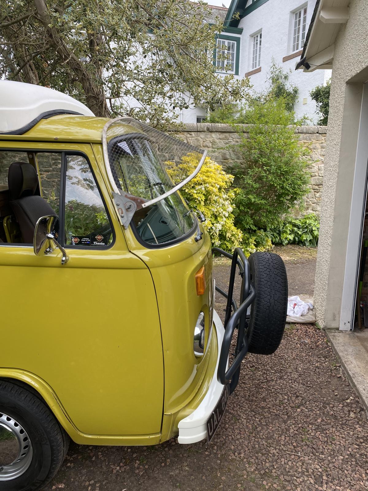

‘Olive’ did previously have the attachment brackets, fixed with aluminium rivets, but both had fallen off and the rivet holes seemed to be in the wrong place. I cleaned and filled the holes with JB Weld.
I worked out which way up the screen goes and test fitted to get the screen level and to make sure it would retract upwards.
Then I nervously drilled new holes and tapped for M4 machine screws, which gives a really solid attachment. The screen looks good I think, and hinges upward to give a clearer view ahead! The whole thing, including the brackets is easily removable and I’m happy with the look, which fits with the ‘original survivor’ vibe Olive has going on!
