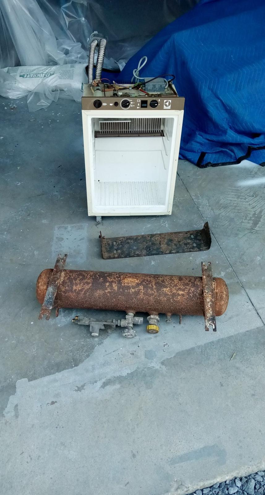

My Client had a condemned Propane tank, and wanted to be rid of his useless original fridge.
I proposed a dedicated vented propane locker to hold 1 LB tanks
First the old fridge and tank were removed, stripped of usable parts and discarded the original copper stove line was saved and re-cut to fit

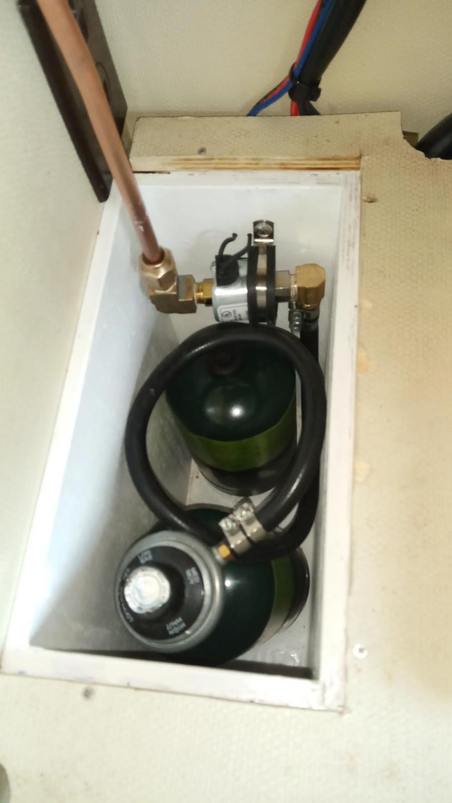

A piece of 1" fiberglass tube was epoxied into a drilled hole, this fits into the existing propane hole in the floor, Propane is heavier then Air and the locker must be vented out of the vehicle

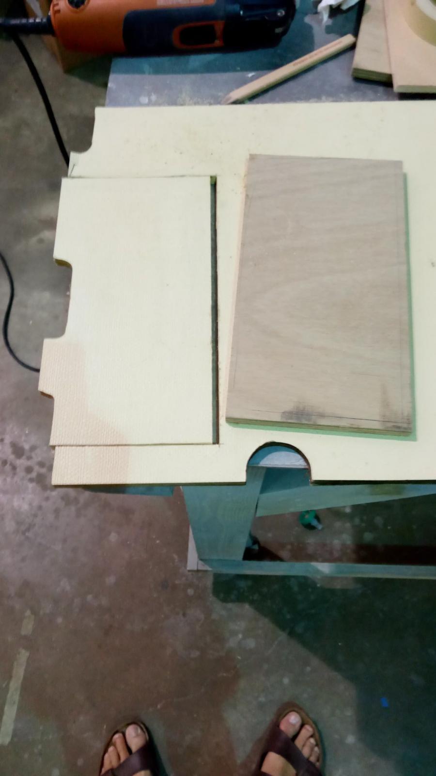

some more measuring I cut the lid in the top using a FEIN saw, a new lid was made of marine ply
I glued on some framing to accept the fasteners, and support for the shelf

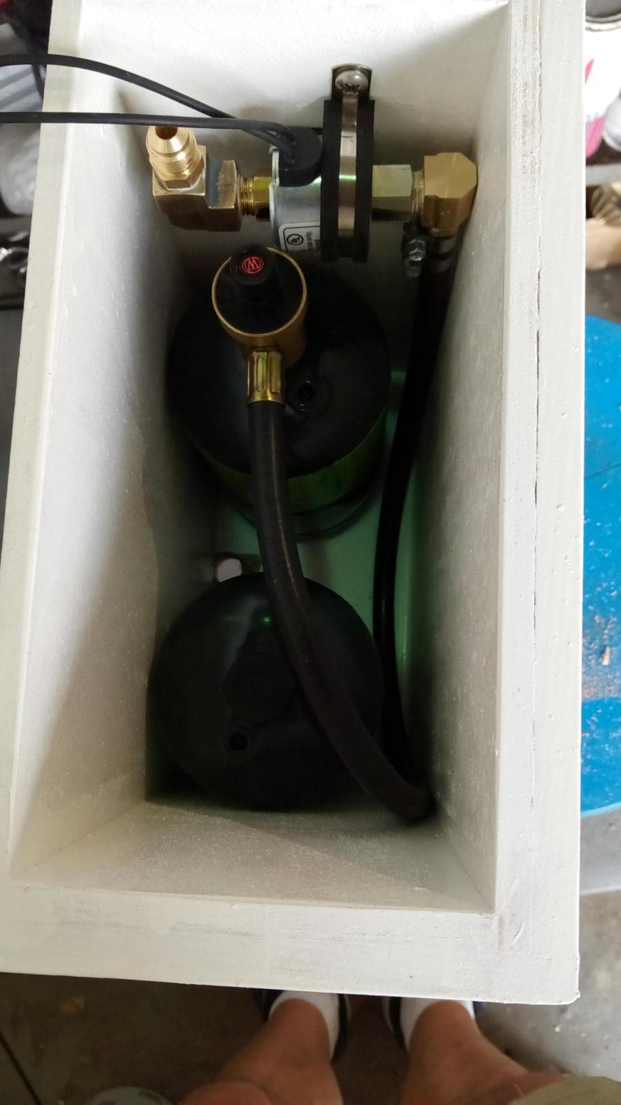

the lid fits snugly, As the fridge was now gone forever, I pulled the 3-wire pigtail down and repurposed it to power the solenoid, I salvaged the 3 wire pigtail off the fridge, and made a connector block on the back of the box.
the 2 solenoid wires got 2 small holes to exit the box, all electrical connections are exterior of the box,
I order a different regulator from Amazon, this one actually works properly for the original burners,
I used one of these simple switches to turn on and off the propane, I wanted an LED so it is clear that the gas is on.
Done! I found a Rustoleum 2x color that matched the interior , Note the carriage bolt head lifts up slightly to pull out the lid, the LED is located in the corner to the left of the drawer.

I'd like to make a suggestion, hermetically seal the electric solenoid/on-off valve.
Potting or burying it in silicon would probably do the trick.
Any electrically operated switch/valve has a tiny spark when energized (on) and also when de-energized (released or off).
Smothering it in "goop" would not effect any heat dissipation problems on this type of devise as it creates nearly none when in use.
It is in the same chamber that may have unwanted propane lingering within it, vented or not.
The QC on the little 1lbs bottles and their built-in overpressure valves leaves something to be desired, play it safe.

from the manufacturers website-
The Solenoid Valve's internal components are of stainless steel with a completely enclosed
valve operating mechanism; burst pressure Is rated at 10,000 PSIG. The solenoid actuator coll is
completely encapsulated with an epoxy resin and no portion of the electrical circuit comes In
contact with the walls of the sealed valve enclosure.

I don’t know RV refs because I go propane to ABYC, but you would fail on
None direct connections to valve and appliance
If that’s a metal to metal bushing, that’s isn’t allowed. Flare fitting is ok
You need 15 sq inches of vent for that box , roughly. That pipe is too small
