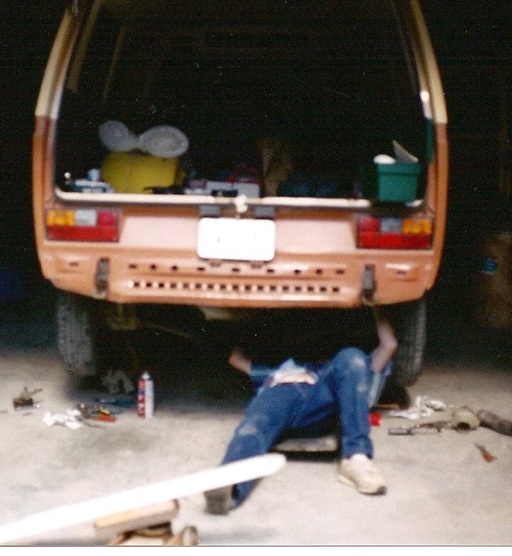

Below is the only photo taken of me doing major 2.0 Air-cool Engine repairs in Delta Junction, Alaska, 1997. The engine burned a valve after the top compression ring broke and mostly came out in pieces. The 2nd ring was broke but in its groove. (As I may have mentioned previously, I was adding a lot of oil.) A local junk yard had all I needed including a new gasket kit. The owner of the wrecker allowed me to use his garage. Total cost, including two nights in one of his vacant apartments and tow, was less than $500. Yeah, I got away with a good deal. We finished the remaining three weeks of our road tripping vacation.
