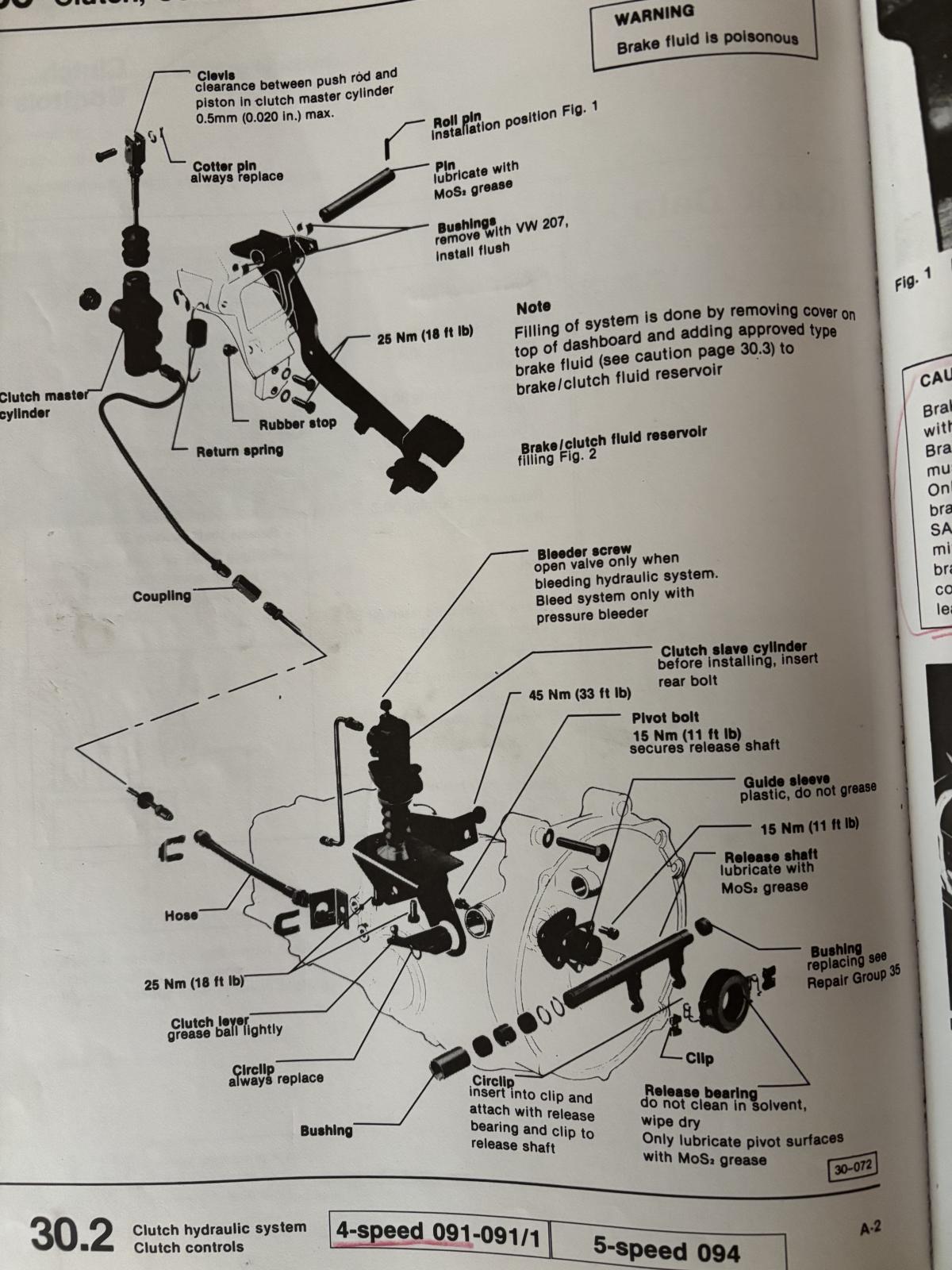

Ok on the time machine it's more of wanting to slap the ever living hell out of the person that thought this was a good idea. Now that that's out of the way. How is anybody getting the arm off to remove the bracket to modify it. Seen plenty of ideas on what can be done to the bracket. Problem is I cannot get the arm off the shaft. I've been spraying it with PB Blaster, WD40 penetrator, I've even tapped it with a small hammer to see if It would help loosed it from the splines. Other than taking a torch and cutting the damn arm off which is not what I want to do. Has anyone been able to get a puller up there to get the arm off? I'm thinking this might be next on my list.

there's a small circlip on the end of the shaft, might be rusted to nothing, but it needs to be removed as well as the locking bolt going into the bushing.
i didn't recall the arm had to come off to get the bracket off but my trans was on the bench during the arm removal gyrations so i can't say. battery cable pullers have very thin ears meant to get underneath an installed cable clamp, they might work. since there's always a bit of slop back and forth in the shaft, securely wedge the arm outward as far as it will go and using a BRASS hammer so as to not mushroom the end of the shaft, tap the shaft inward. rinse with penetrant and repeat.

I believe the clutch release lever is fighting him. I imagine the circlip is off, but the lever is rusted to the cross shaft splines.

You have that correct Mark. Circlip is off and as far as I can tell the bolt on the bellhousing just keeps the shaft in place. Been slowly modifying a puller . Hoping to get the claw's just thin enough to grab the backside of the arm.
I'm going to try the wedging of one of my prybars under it and then tap the end of the shaft as mentioned. That actually sounds like it might loosen it up enough to finally get it off. Will update with my progress or lack of.

You can only do it by moving the clip in the bellhousing so it can slide inwards. Works great when stuck, but a lot of work.
