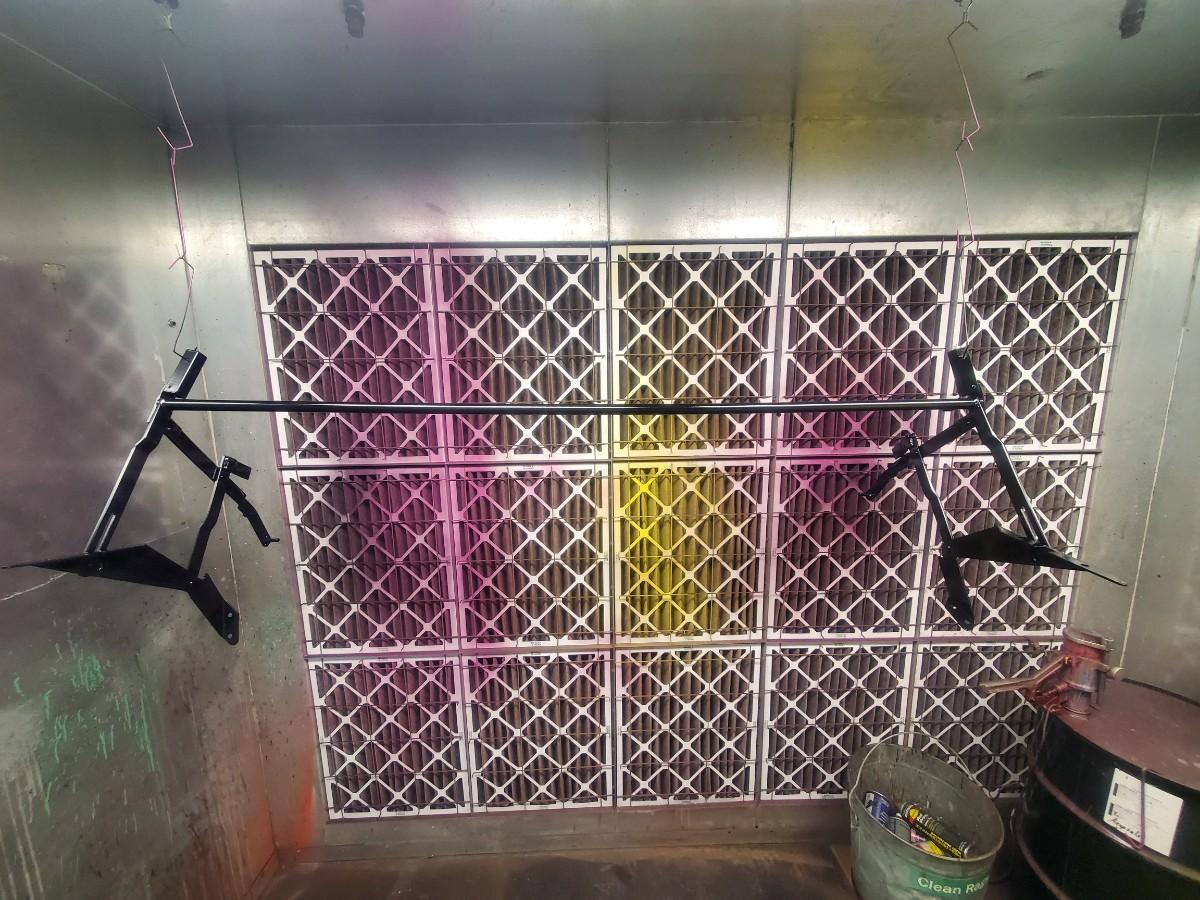

PostPosted: Today 12:25 am    Post subject: Re: What did YOU do to your van today? Reply with quote
Found my clamp at work! Should've waited longer before ordering a new one... Laughing
Blasted and painted the rear seat frame at work.
