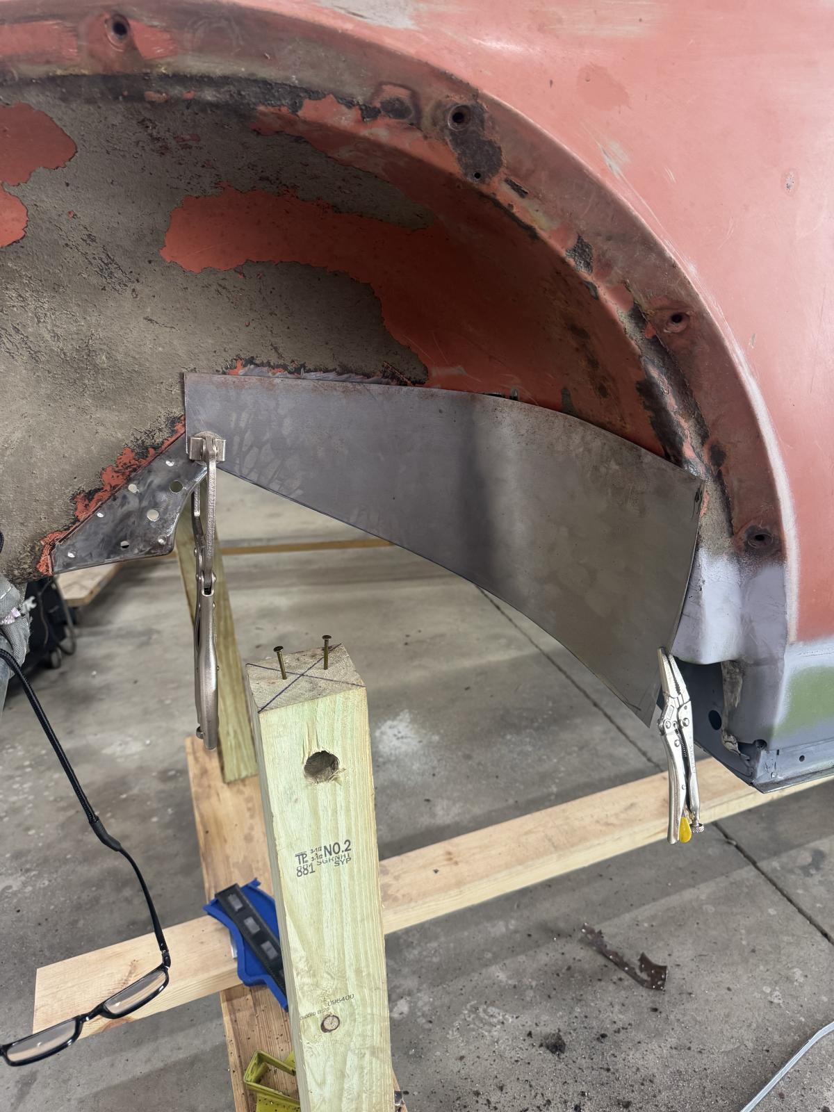

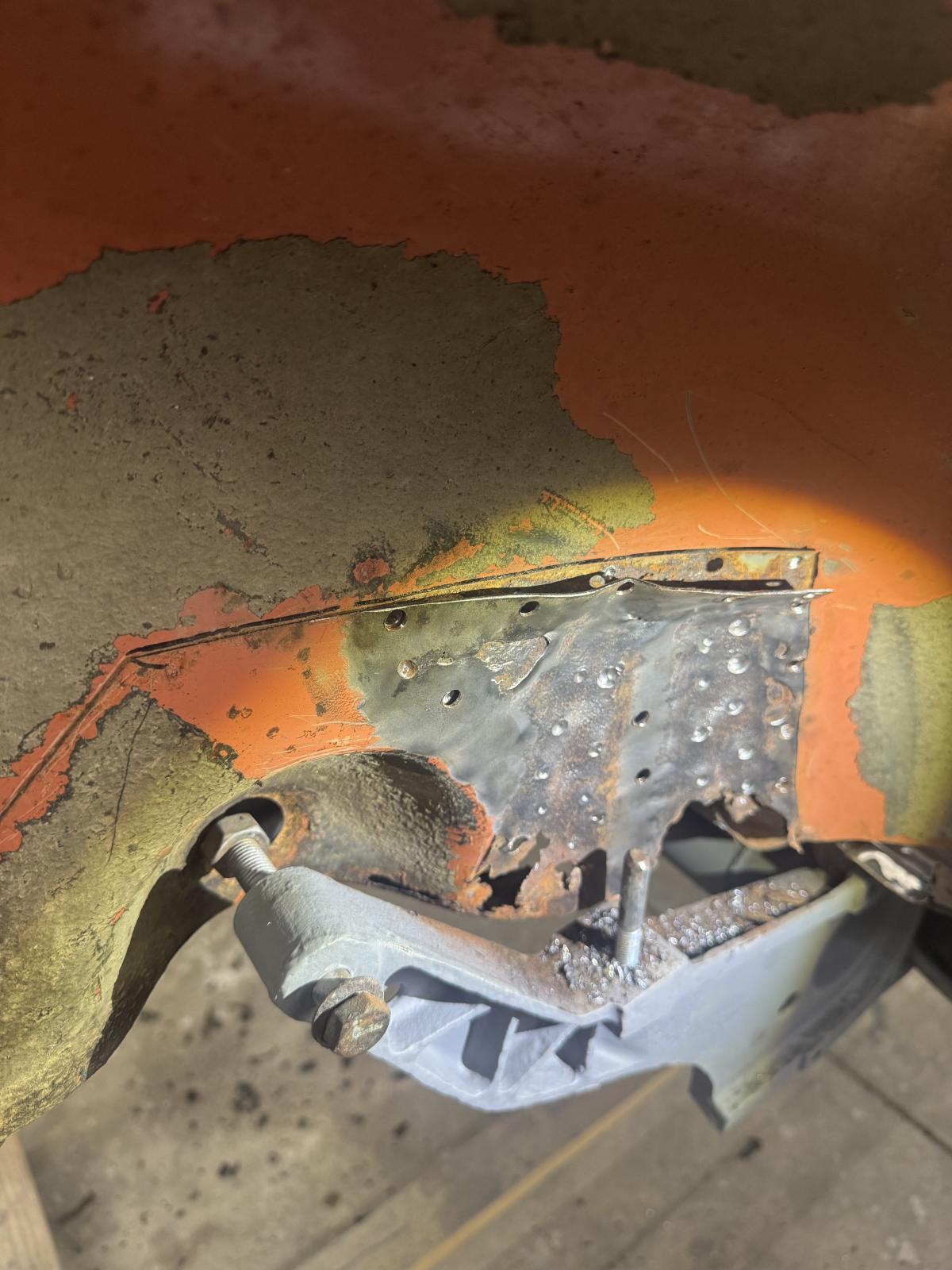

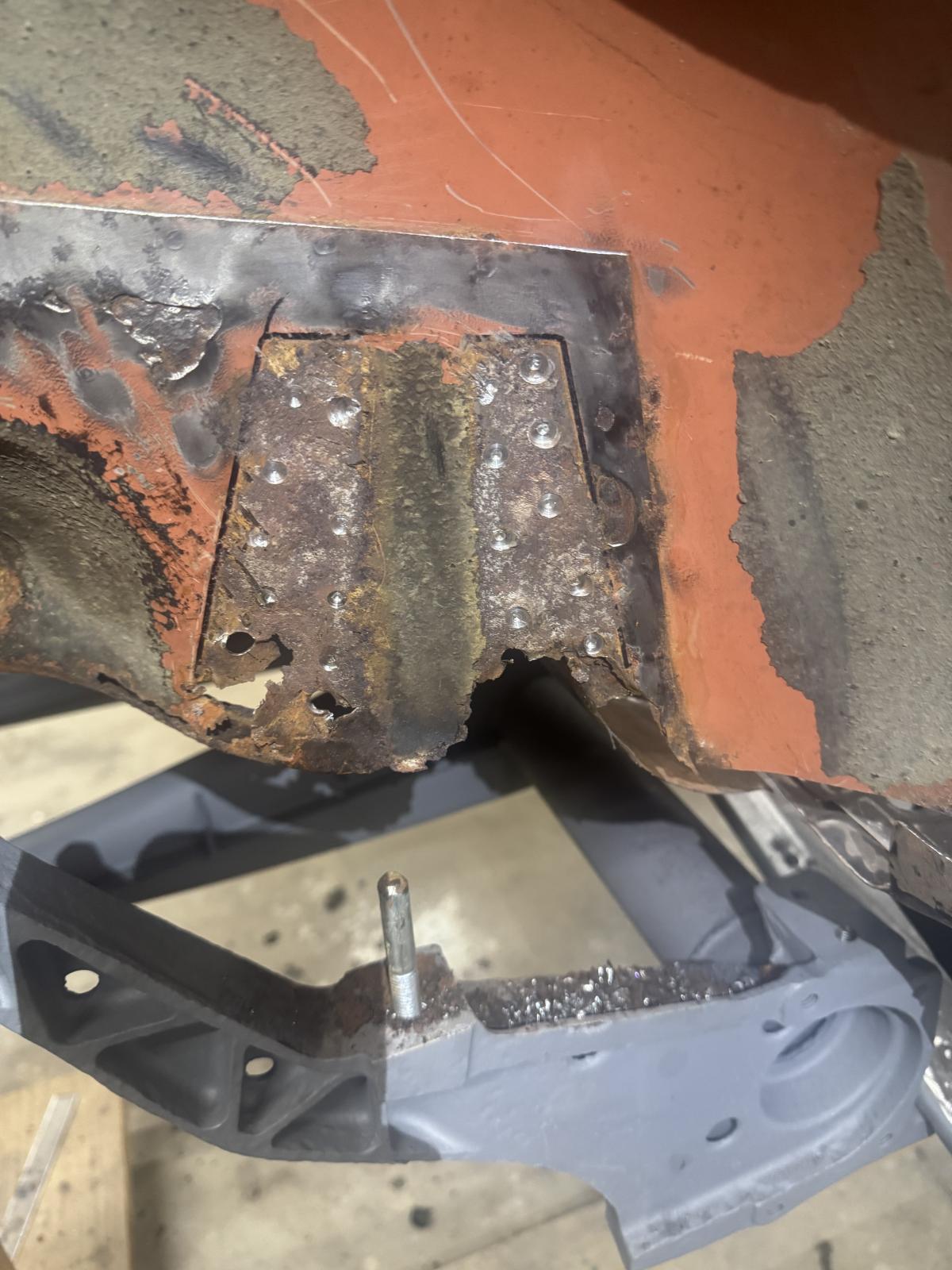

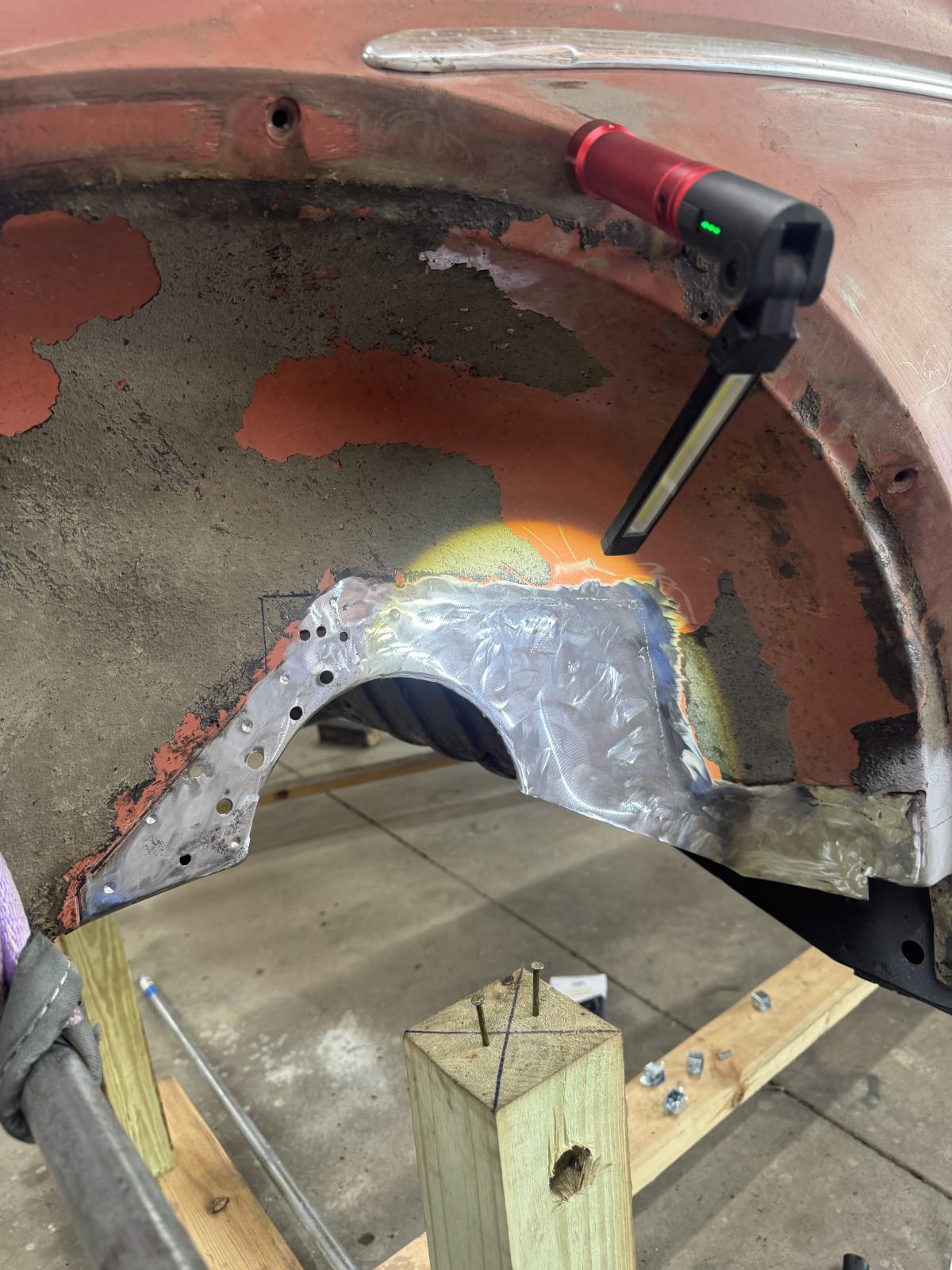

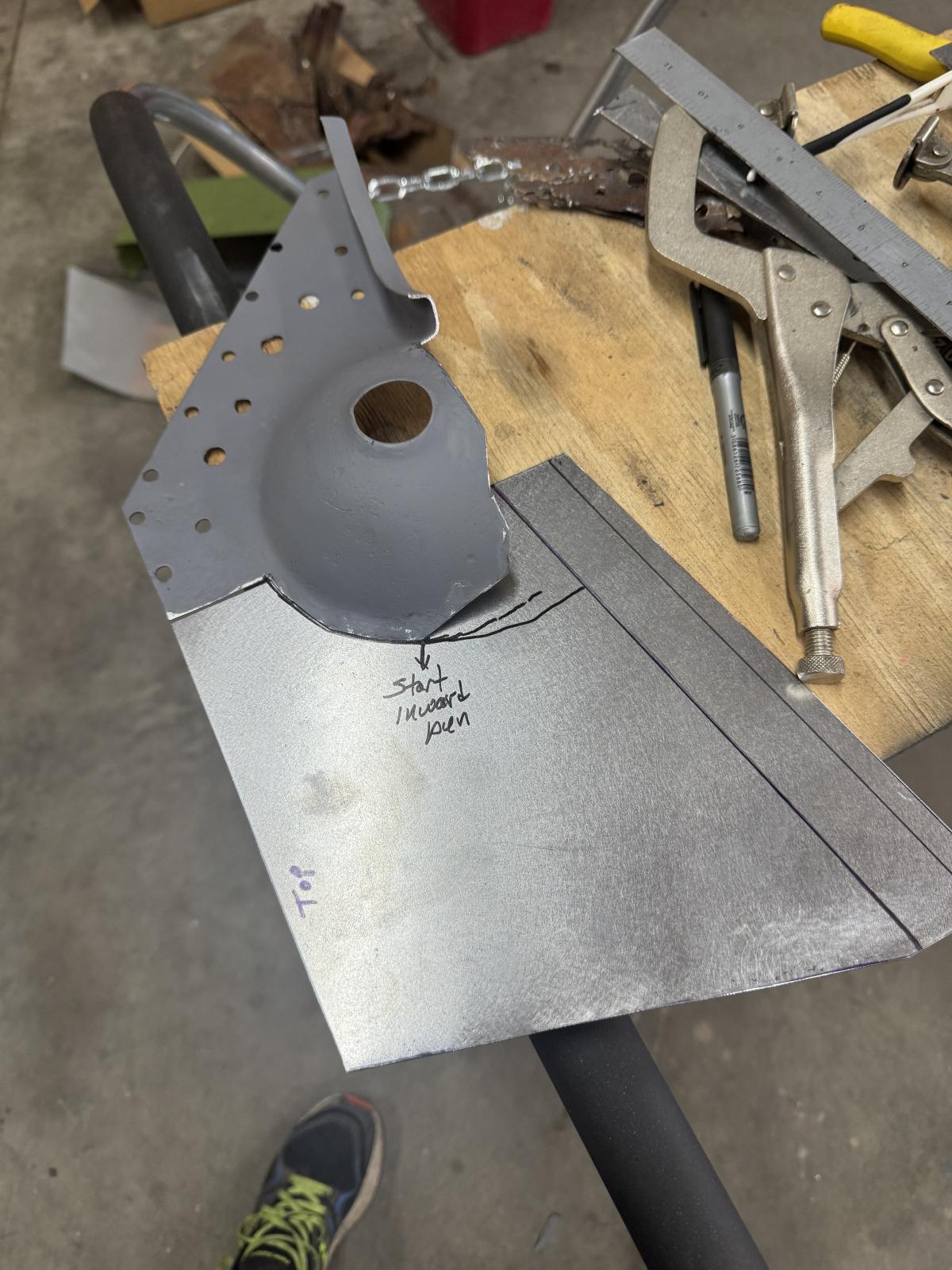

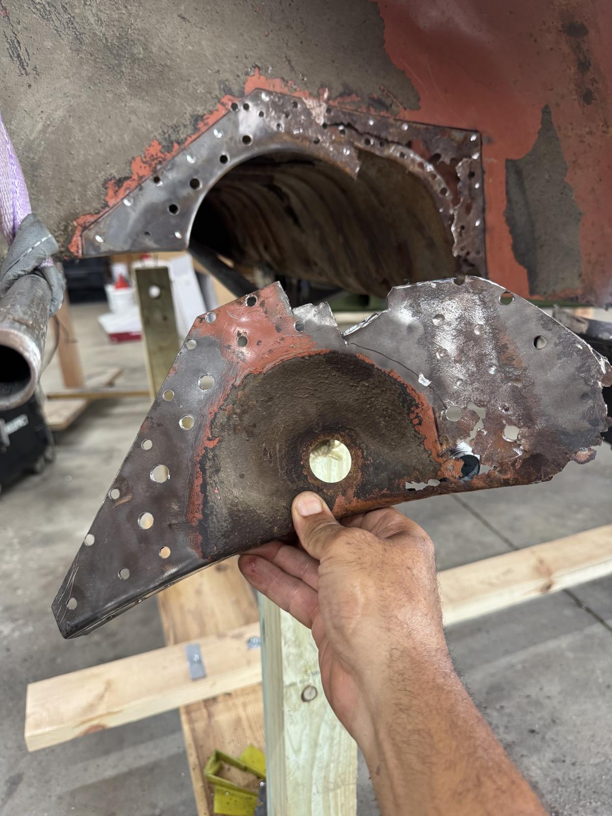

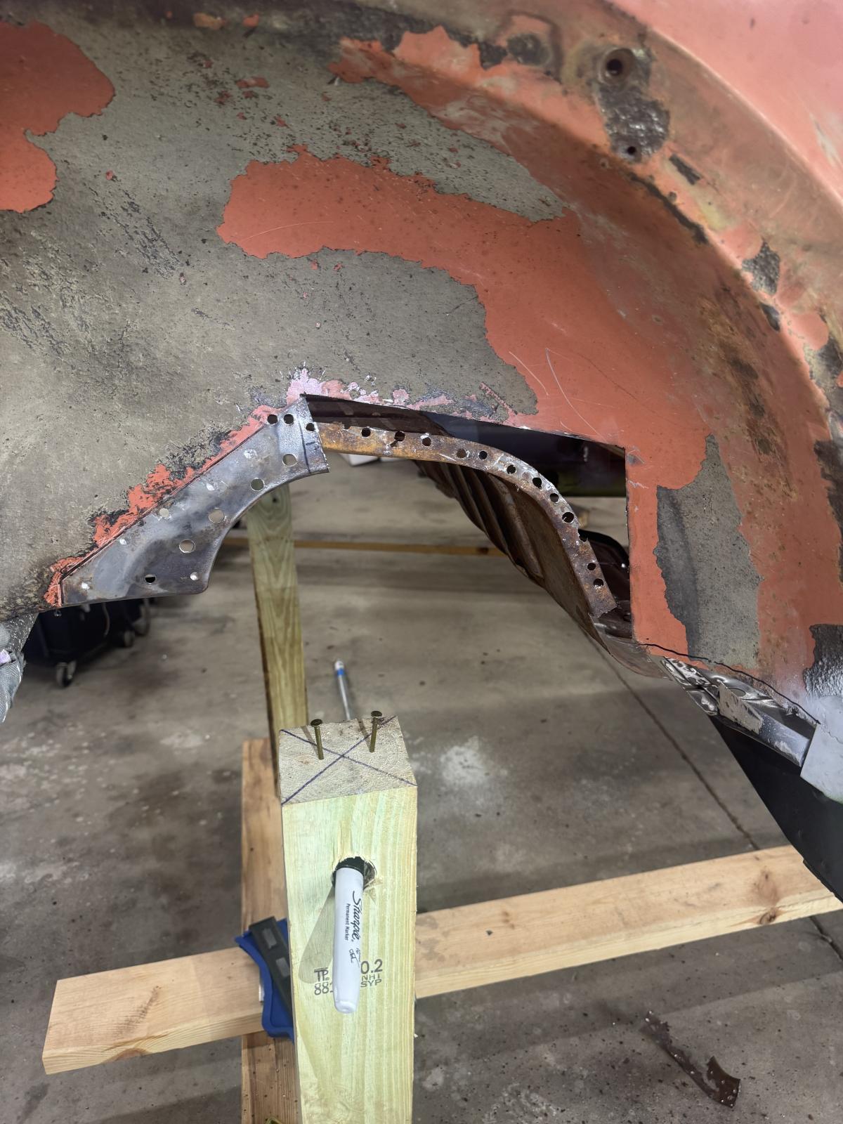

Completed both driver and passenger side rear body mount repairs. Mounting brackets were rusted pretty bad and noticed some metal distortion. This was due to moisture getting in between the two metal panels and rusting from the inside out. I could have went with some panels which include the mounting bracket, but my goal for this build is to keep as much original metal as possible and keep it looking period correct. So decided to repair what I had.
Parts used were left and right brackets purchased from kaeferland-shop.de/en/, 20 and 18 gauge sheet metal.

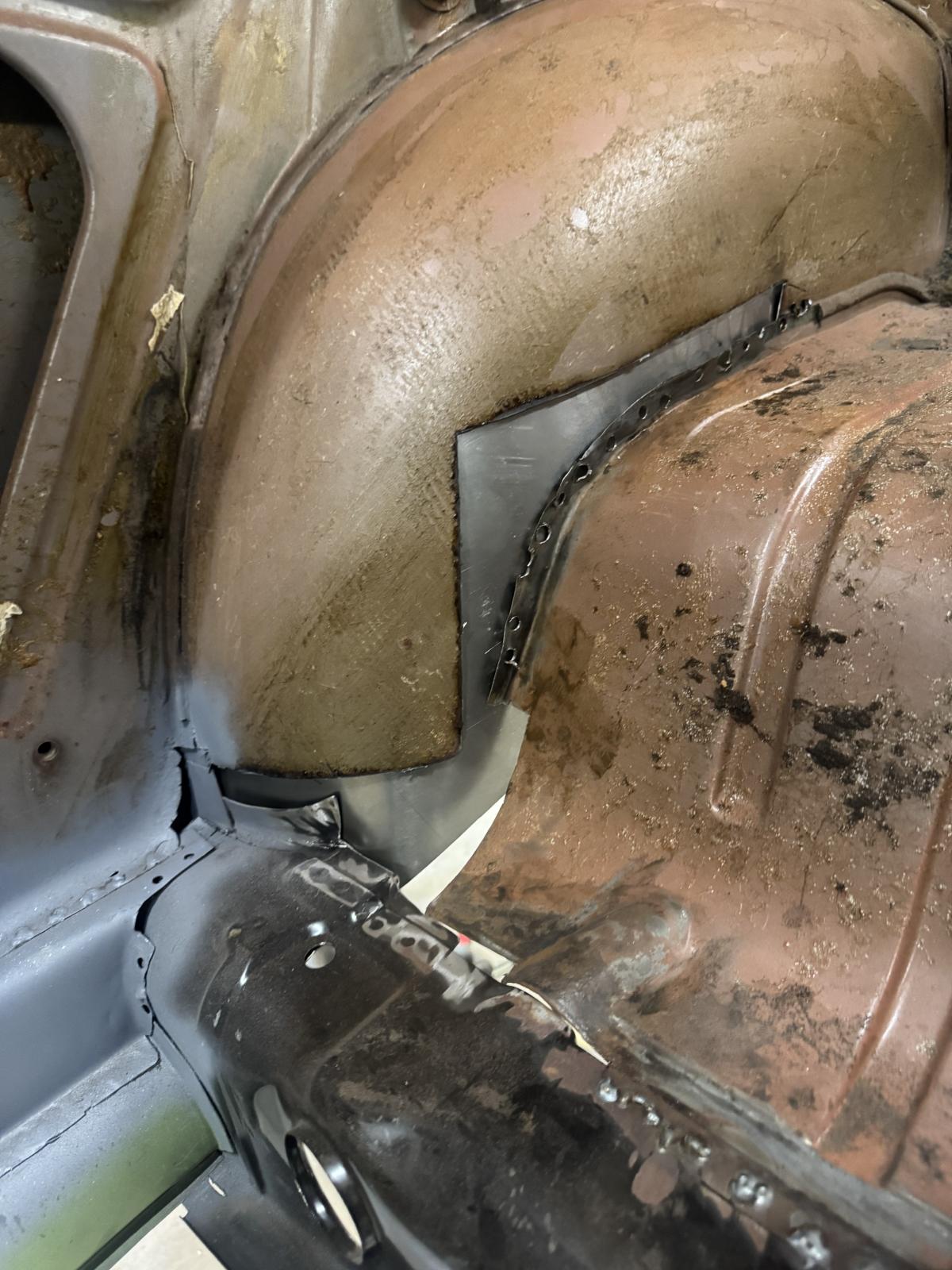

Starting on the passenger side, I removed the bracket and then began peeling off the subpanel. Once the subpanel was removed I could then see how much body metal I would need to replace. Fortunately, the metal towards the backend of the halfmoon was still good. This will help ensure proper alignment using the drilled spotwelds.

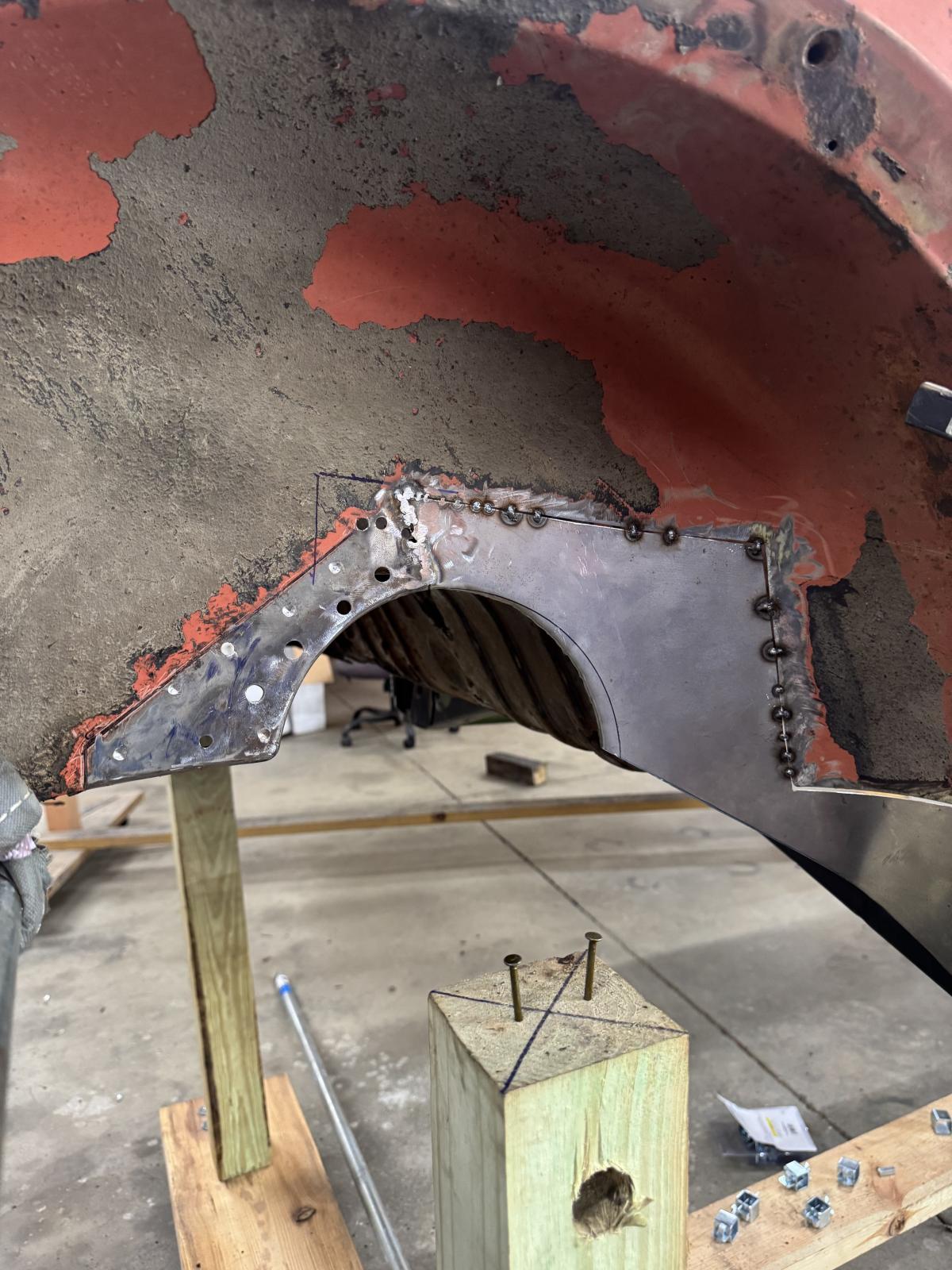

Cut out rusted metal, wire wheeled and treated surface rust. Then sized and shaped new sheet metal panel.

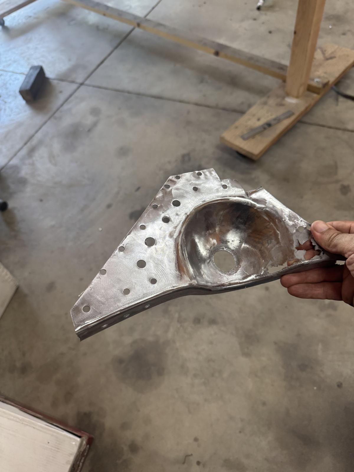

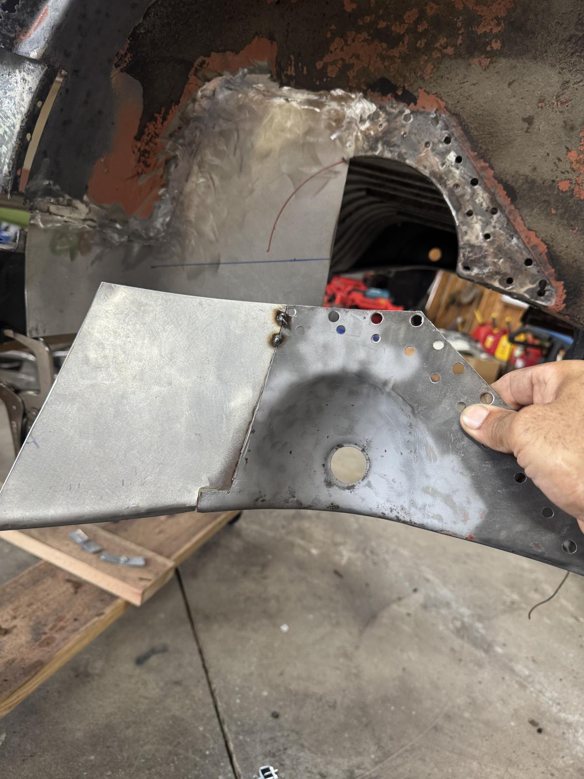

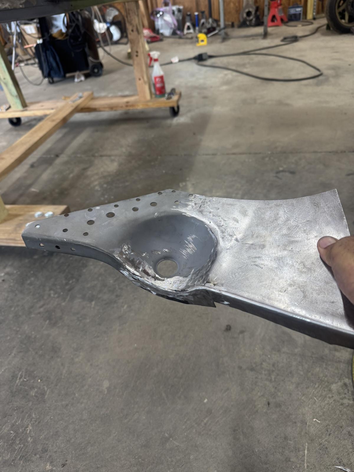

The subpanel with the dome needed to be fabricated. Had to cut a lot of rust out but luckily most of the dome section was salvageable. With some 18 gauge sheet metal and sandblasting I was able to repair this piece.

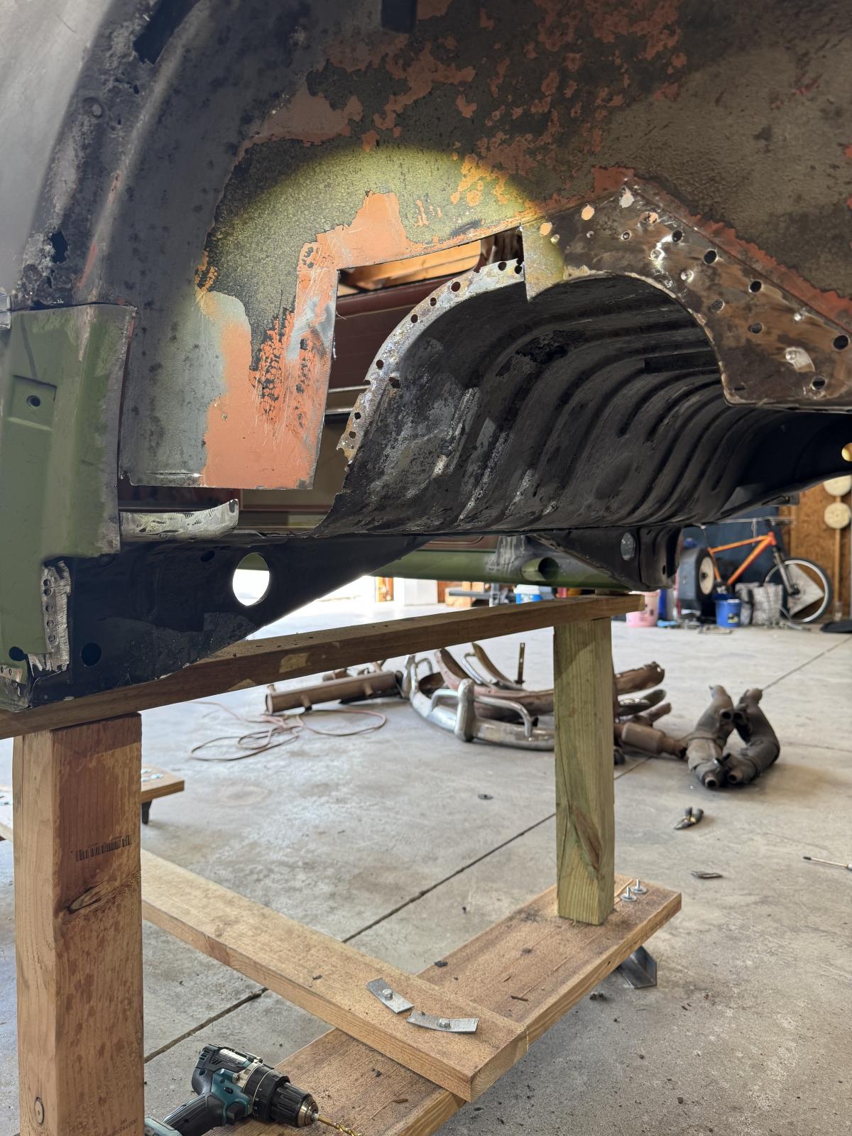

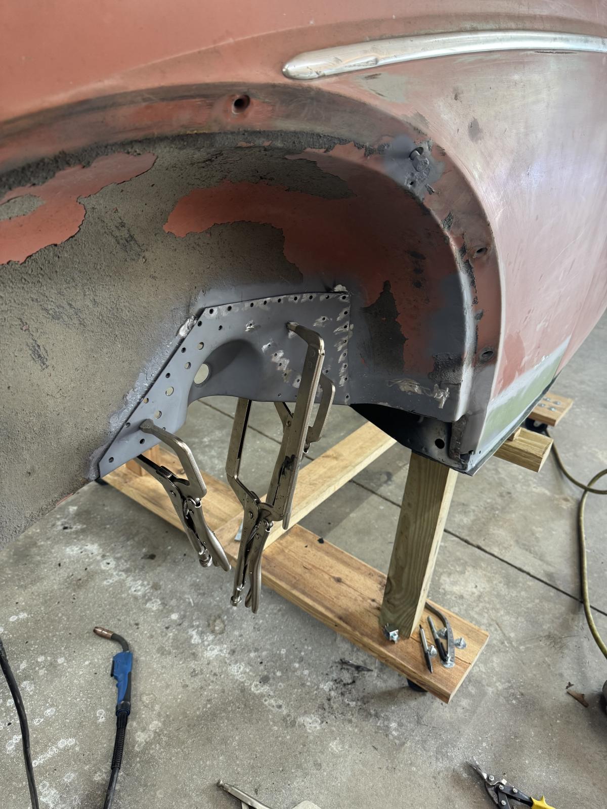

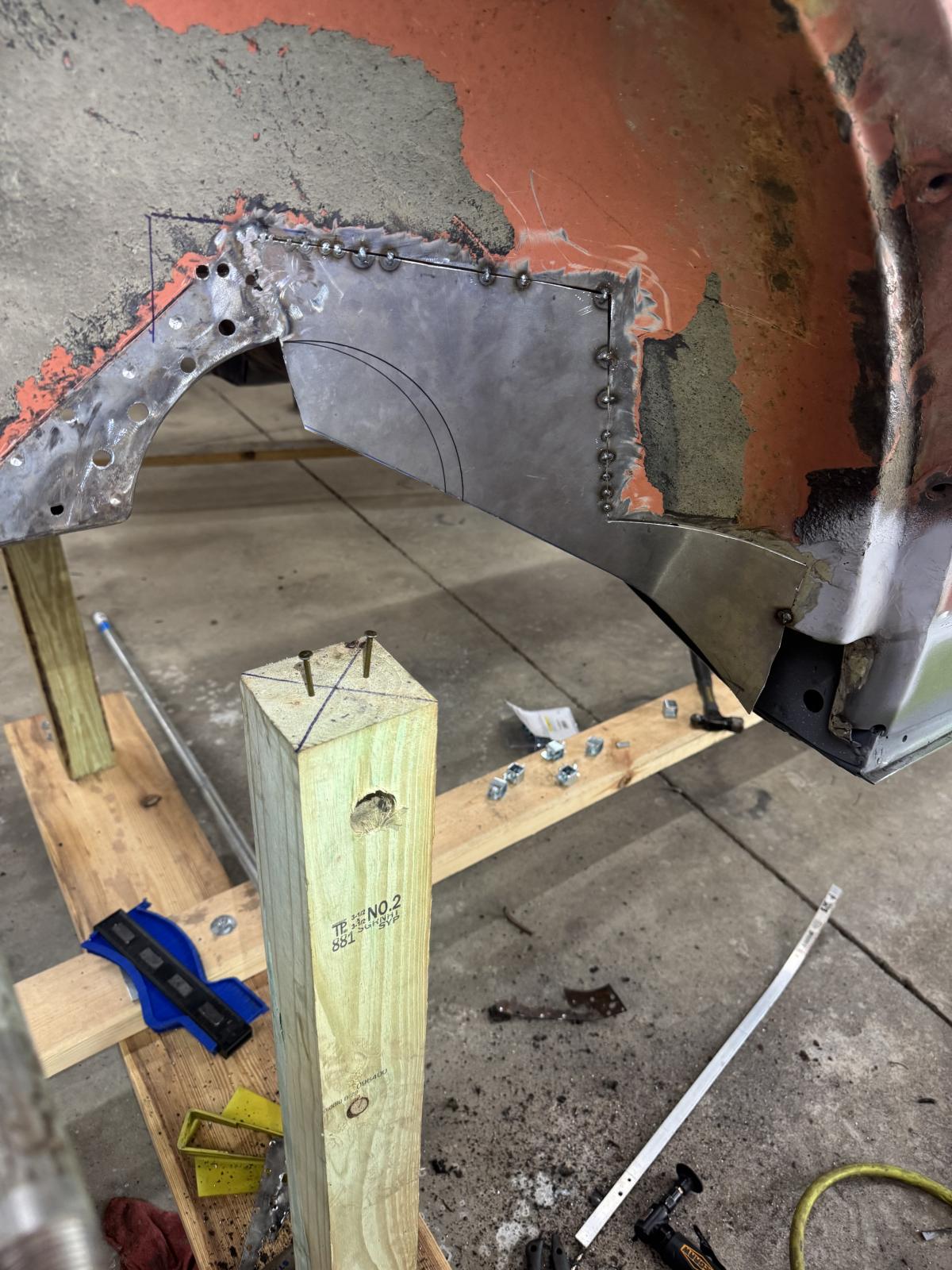

Finally, it was time to weld in the new panel and bracket. Sat the the body on the pan to ensure proper bracket alignment.
Did the same process for the driver side.
