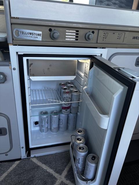

Pianoxcape
Joined: July 04, 2021
Posts: 5
Location: Cape Cod
Pianoxcape is offline
PostPosted: Fri Jul 18, 2025 7:46 am    Post subject: Re: fridge replacement projects - post here Reply with quote
Received the fridge, and completed the install of Vitrifico C50i. As others have mentioned, it's a great fit and fairly straightforward install. A shout out and thanks to the others who posted their pics and experience - it helped a lot.
I did botch one spot on install. While removing left edging to mount trim kit, I errantly took off a small piece of the top left cabinet facing with my oscillating blade. Bummer. Other than that, was super easy. I reused original hardware and grey screw caps to keep some of the original vibe.
After wiring up to 15 amp fuse, I added a battery-powered thermostat. The internal temp went from 79 degrees to under 40 degrees in about 20 minutes. I now have fridge temp setting near "min" and reading 38 degrees on the thermometer.
One note I haven't seen mentioned. When I removed the original/stock Westy fridge, I capped the gas line with a 3/8" flared cap. I know GoWesty video shows removal under the vehicle, but I wanted to keep the option if I added propane heater or other propane accessory in the future. I did the whole soapy water test on the fitting for safety.
Here's a photo after moving our travel stickers from the original fridge door. Now I'm itching for our next trip. Summer in the Northeast has always included a second DC powered fridge and this should be a great upgrade.

PostPosted: Thu Aug 07, 2025 7:41 pm    Post subject: Re: fridge replacement projects - post here Reply with quote
I also did a bodega R50 install. Can be seen on page 35 of this thread. I put 1/2” foam board on the sides, bottom and back for more insulation. Also wired in a 120v adapter power supply and switches to toggle between 120v adapter power supply, house battery and 12v off starter battery when the engine is running.

PostPosted: Thu Aug 07, 2025 7:58 pm    Post subject: Re: fridge replacement projects - post here Reply with quote
grandfatherjim wrote:
Averaged about 26 during the day, down to 16 at night (61/79F).
Yours is a nice installation. Those temps however are not yet a real test. Even the propane fridge when running 40f under ambient has no issues at 80f ambient.... Please report again then you are in 90f+ in sun and let us know the draws under those conditions so we have another data point for those considering this fridge. Thanks
