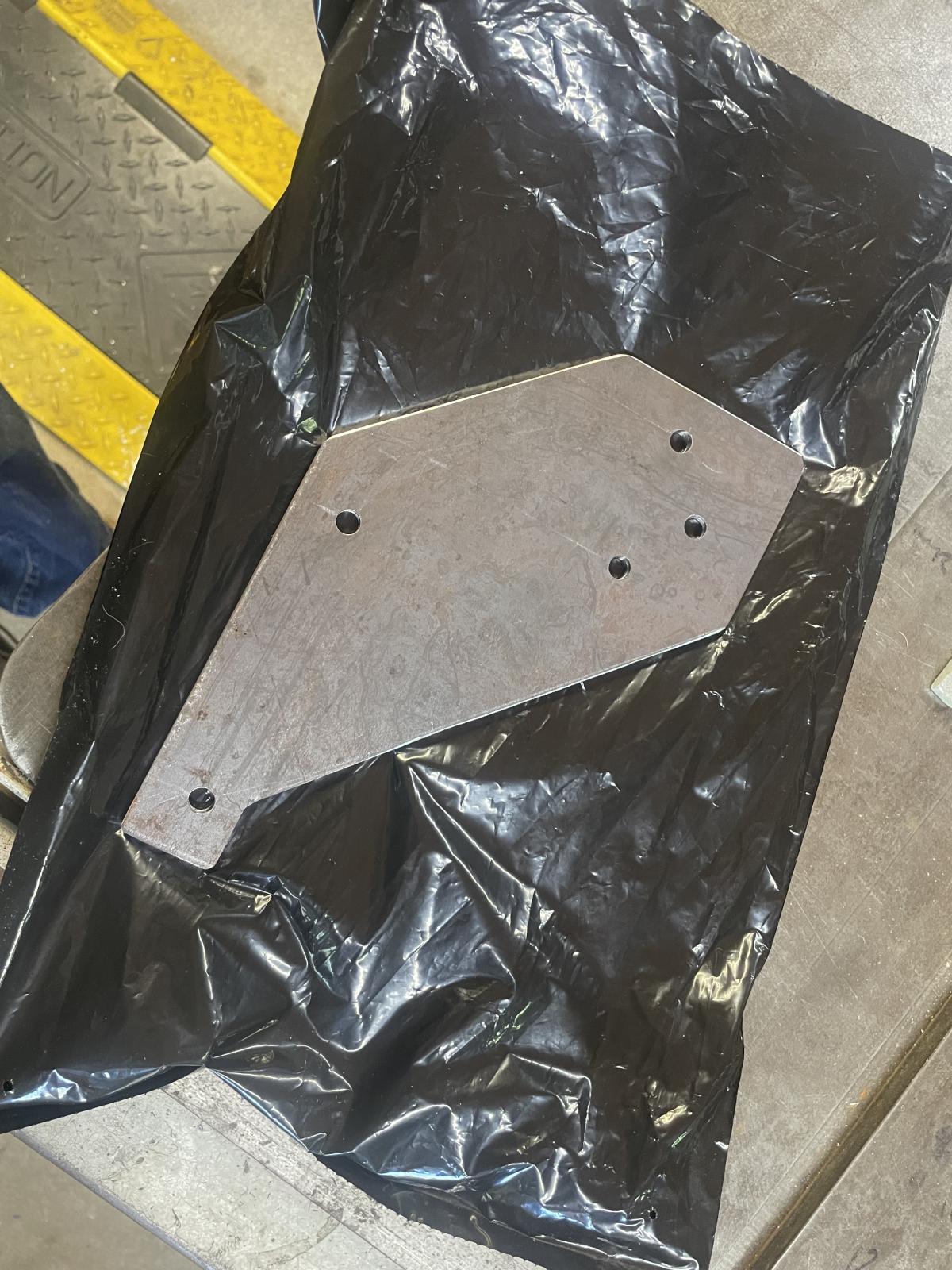

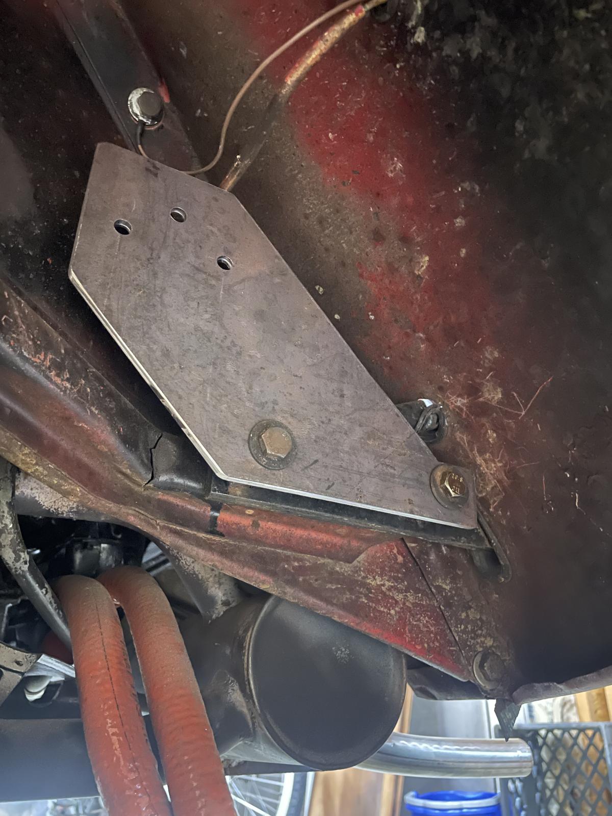

Oil filter bracket:
I wasn't going to drill holes, so this pretty much meant I had to use the bumper mount bolts. This is standard practice on later cars, but early cars have the overrider brace bars in the way. I ended up using some spacers and longer bolts to get around the brace, and it worked out well.
Yes, the oil hoses are close to the fender, there's room to slip a business card between them, but no more. Not on purpose, thought I had measured to leave more room..

Thanks for the oil filter mount pix. It looks like it tucks nicely up there and quite serviceable.
You may consider welding up that crack in your bumper mount someday. That provides rigidity to the whole panel and other cracks can generate.
