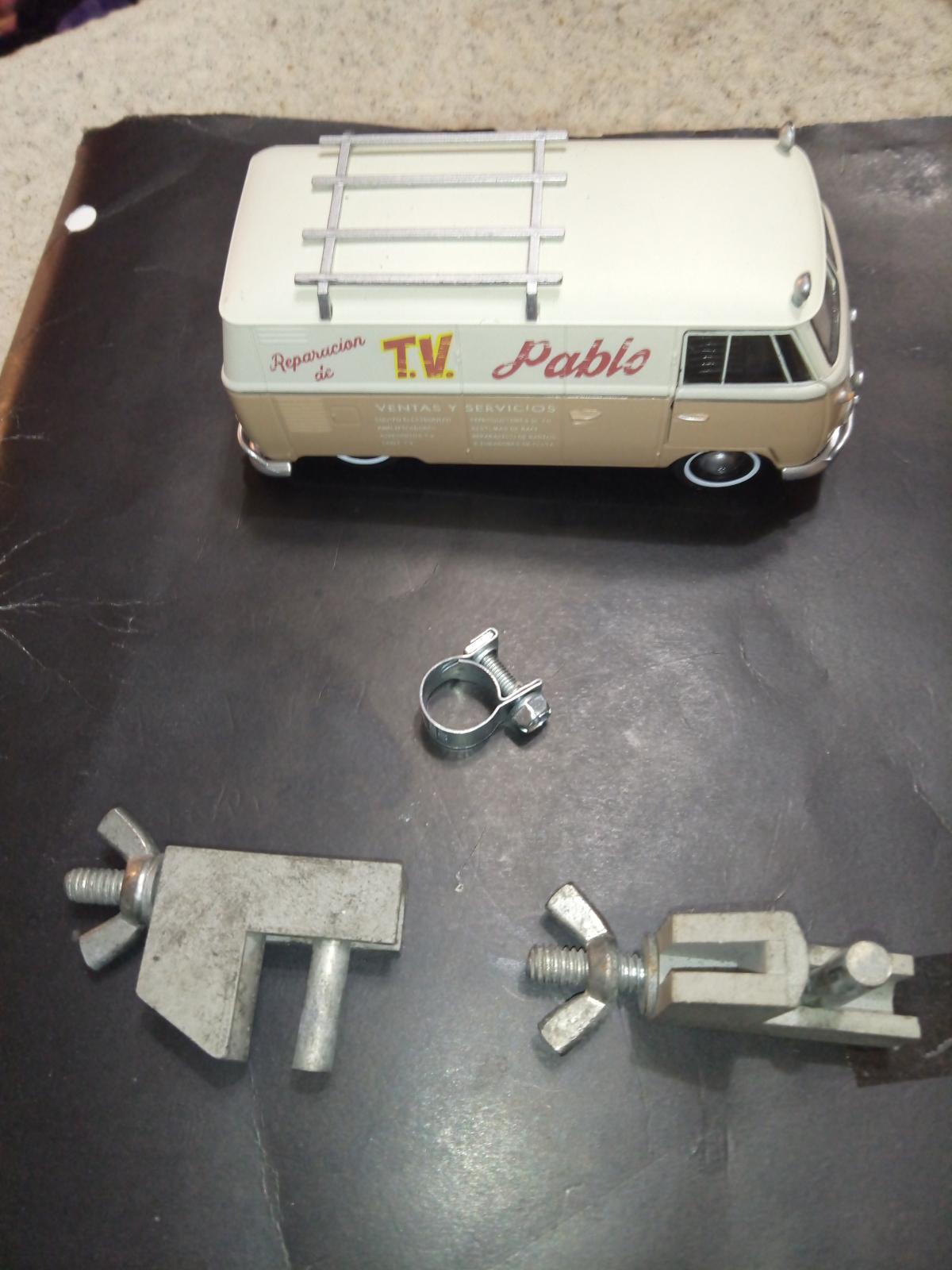

@ Marks_Bug
I'd recommend maybe a broken pencil on each serrated jaw of Vice Grips to prevent weakening the hose, or a lengthwise cut down a dowel or broomstick then making it short.
I found these years ago at a flea market & paid $5usd for both.
I use them all the time.
The correct style clamp makes a huge difference too.
Best to you ... stay safe
jinx
