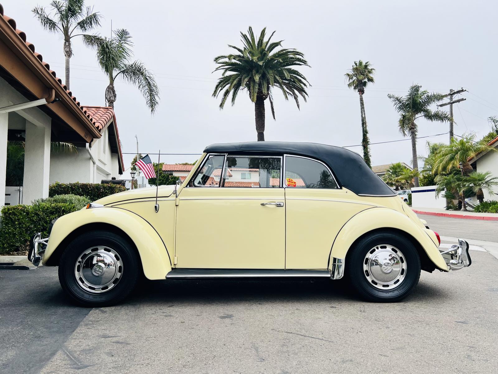

After 2 years of owning my 67, I'm interested in lowering the front end. I'm looking to upgrade the ride while on So Cal freeways at 65-70 mph, and around town. I'll usually have a passenger and occasionally back seat passengers.
I'm not interested in the slammed front end, Cal Look.
I have read that just drop spindles will cause tire rub when making a U turn or speed bumps.
Currently, I have 165/70 15's and am probably going to go 185's all the way around.
I'll also upgrade the brakes to disc in the front.
Do I want just the adjustable beam? Looking at AirKewld PROBuilt and a few others, complete front end.
Thanks
