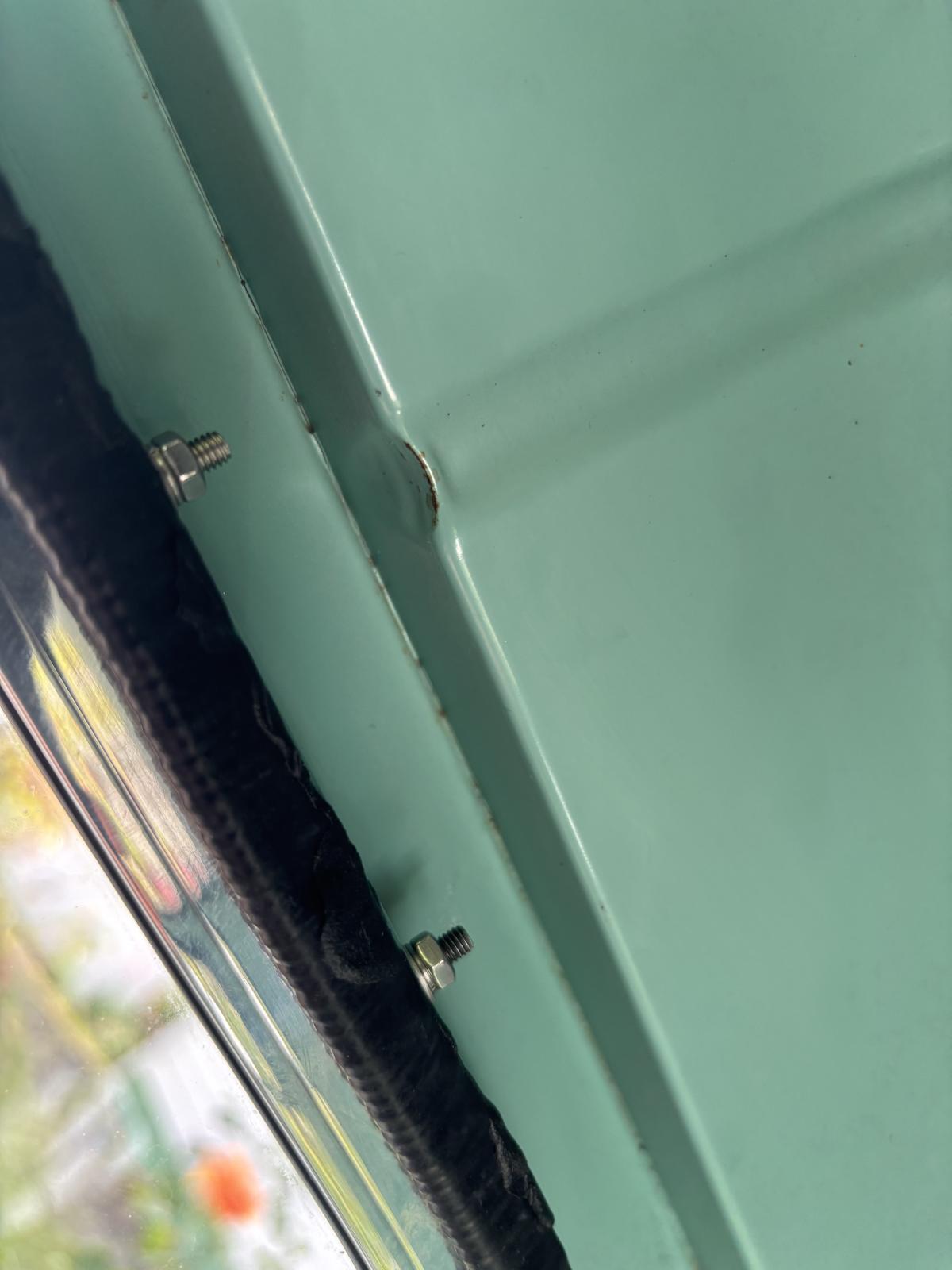

I have a question to anyone who has done a rear safari in a singlecab. How do you mount the latch plates. I can’t really bring myself to drill that bottom lip. It seems that there must be a better way? Do you weld or adhesive them in place?
Edit: I am going to attempt to use a structural adhesive, likely an acrylic. Methyl Methacrylate type. Still looking into options. I will update on how it goes. As for the hinge screws and side plates I drilled at 2.0mm followed up with a 3.3mm, tapped for 4.0mm. Screws thread through the body metal. I am using m4x12 countersunk ss machine screws with lock washers and nuts to lock them in. Strip caulk on hinge screws. May use a bit of friction tape on the hinge as well. Same strip caulk will go around the body seal. Getting the glass in is pretty tough but doable. Slowly bedding the window in now. That barndoor style rear window profile makes the lower frame half pretty tight going on…..

Well that was fun getting that glass in! The 12mm screws for the hinge are way too long. Could probably get by with 8 or 10mm. I think 10’s on the slider plates could work as well. Tapping the body for the hinge screws worked out well. Placed some friction tape on the hinge, pushed the machine screws through the tape. Then a dab of strip caulk on each of the threads. The friction tape held all the screws on the hinge nicely while I held up the window to get the screws started. I still need to mount the latch plates. I’m thinking of getting a stud plate that I can glue on with adhesive, then it will be possible to have some adjustment in the latch plates themselves.

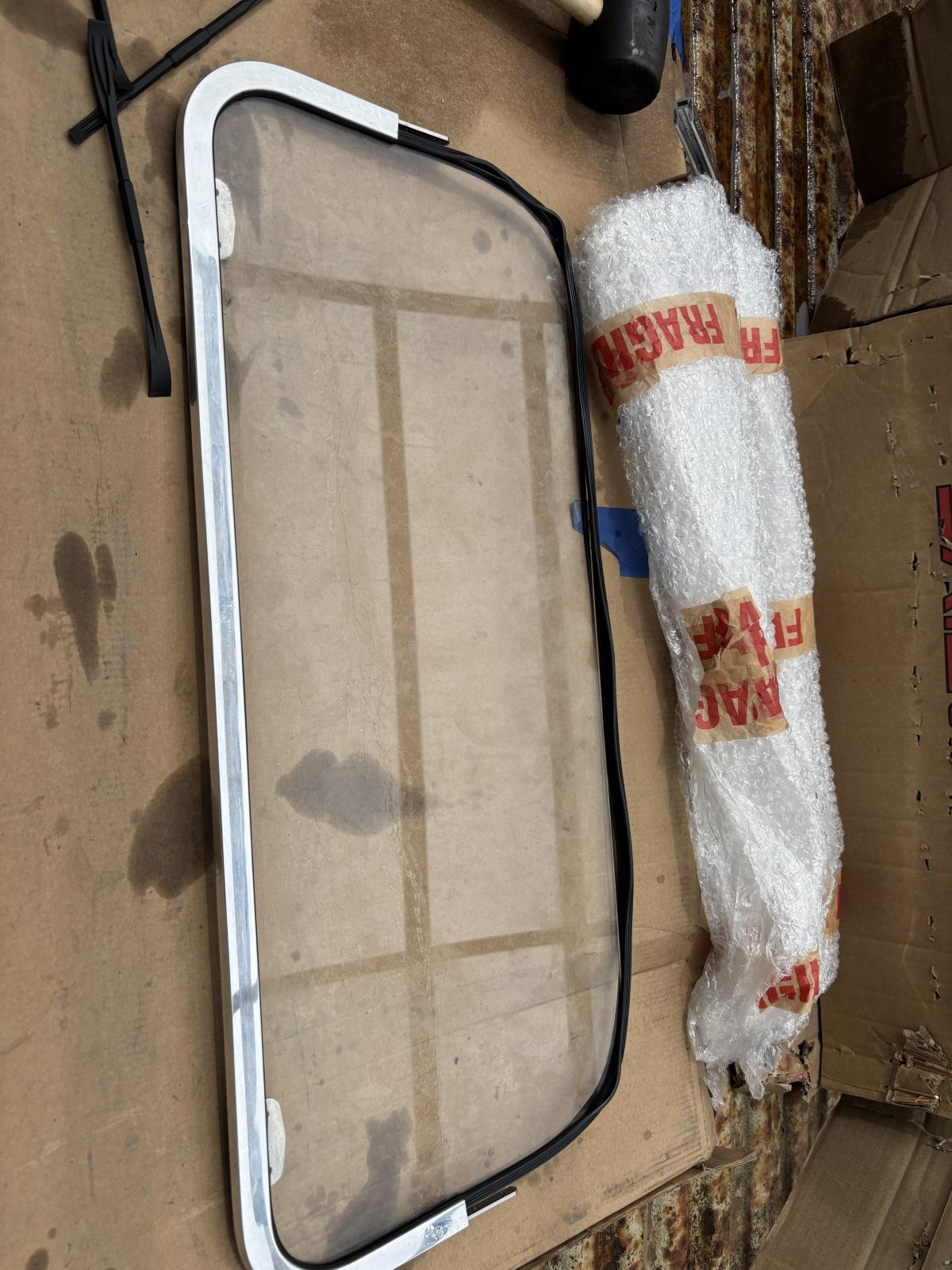

I'm trying to assemble my Creative Engineering safaris. I have the aluminium version, bought them in 2018. I also bought nice 5mm laminated glass for them.
The problem I've run into is I can't get the glass and inner seal into the frame - it's just way too tight. I tried with the glass that came with them and it goes together easily - because the CE glass is less than 4mm thick, but the tempered glass seems so thin and frail.
Is there a thinner seal available? I've seem references to using butyl tape, but it's not clear from the context if that was to use instead of a seal, or to shim the seal.

This afternoon I tried using a WCM popout frame-to-glass seal. It takes some effort to get it stretched over the glass, but when you do, it's nice and tight, with no wrinkles in the corners. However, when I was sliding the frames on, I tore the seal, which meant I needed to take it all apart again. One half of the frame came off fairly easily, but it took almost 2 hours to persuade the other half to release - a lot of rubber/glass/paint stiction. I didn't take any pix though.
Here's a pic of how sloppy of a fit the CE glass/seal/frame is
I went ahead and installed the one window with the thin glass for now, as I want to do a quick test drive around the block.

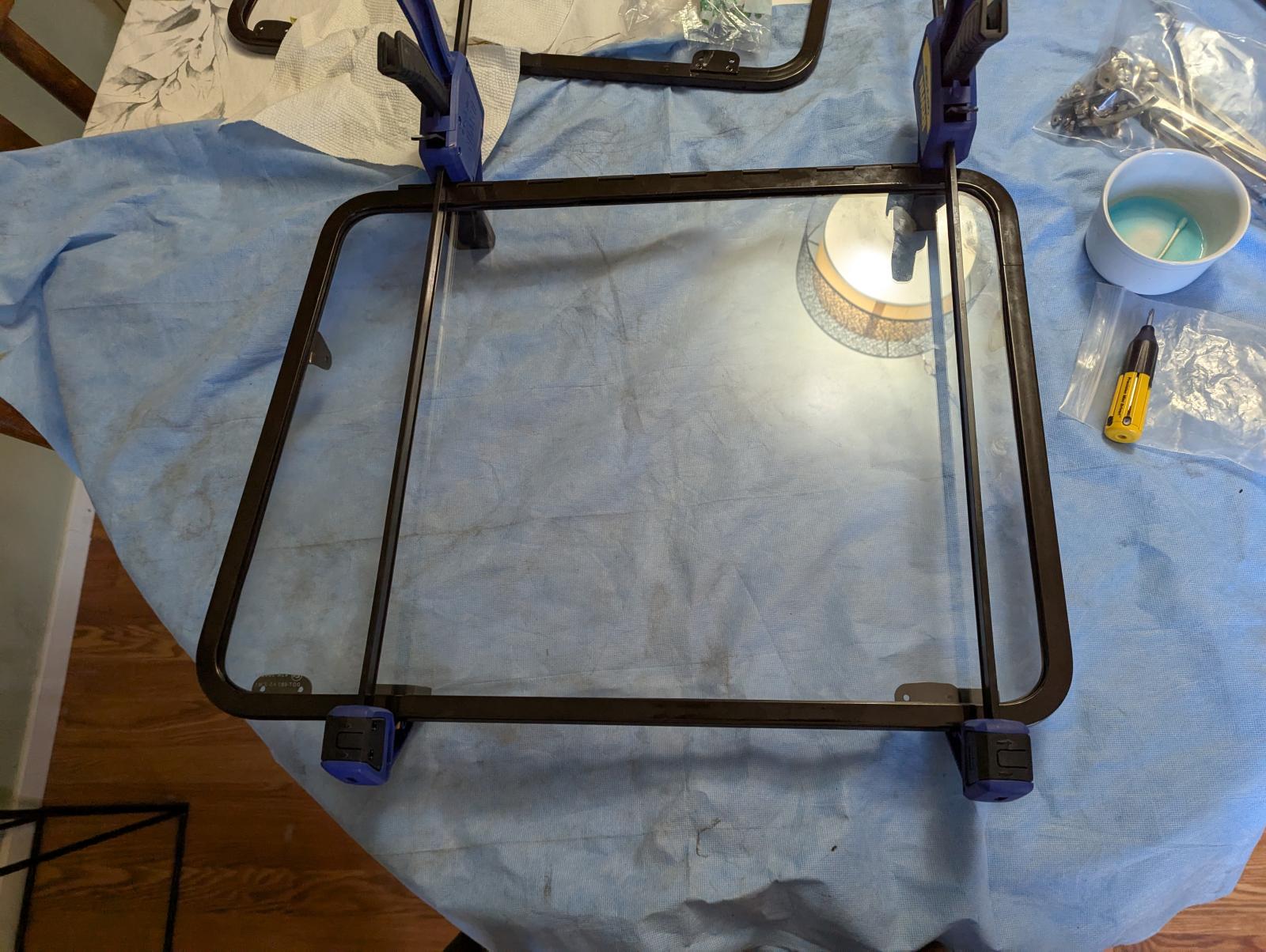

Ok, I think I found a good combination: Creative Engineering frames, Stacy's glass, Wolfsburg West inner seal, and probably the outer seal mentioned above - haven't received it yet.
It was a PITA to get these together, and I think my big mistake was trying to use dish soap as a lubricant instead of running down to the hardware store and getting some silicone. The inner seal bunched up in a few spots, which I think wouldn't have happened with better lube.
I tried both a WCM popout inner seal and the WW safari inner seal. While the popout seal is difficult to get stretched on the glass, once you do, the curvature in the corners is absolutely perfect. The WW safari seal is a lot longer, so it fits sloppily over the glass - it needs to be a few inches shorter. However, the WW seal is a .5mm thinner, and for this operation, you need all the help you can get. In addition, I filed small "chamfers" on the insides of the mating edges of the frames, so they're less likely to catch the seal. If there was some way to take 3 or 4 inches out of the seal and glue it back together, it would be perfect.
I should really take this one back apart and re-assemble with better lube and a new seal, but I'm going to get the other one assembled first and see how I feel.
The popout seal on the glass

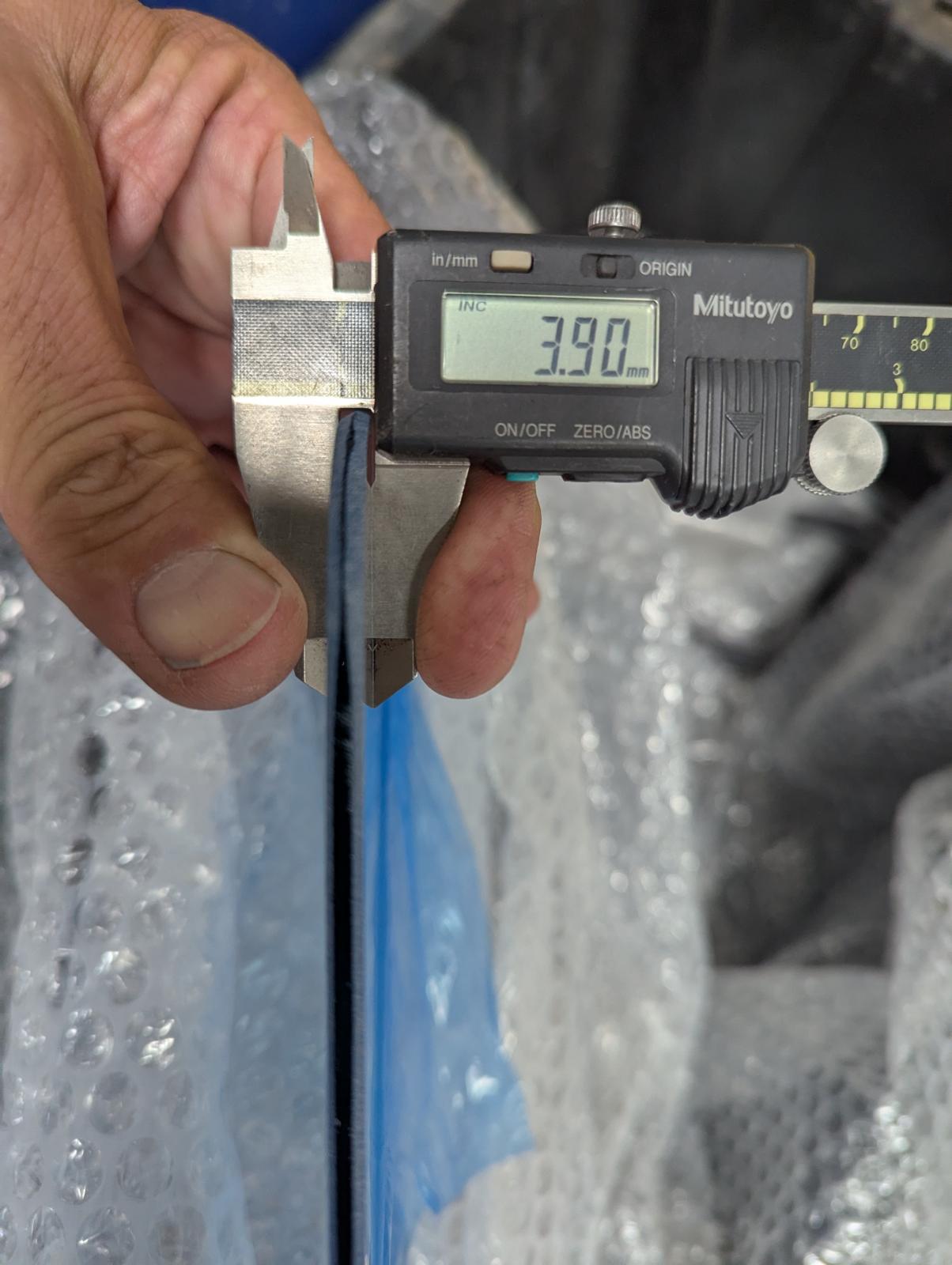

Last night I bought some silicone spray, and then re-assembled the driver's side safari window. I found that the trick with the silicone is you just just have to douse it - I was trying to be conservative, clean and tidy and it just wasn't working. My house smells like a robot orgy now.
With the silicone spray, the frames slid together a lot easier. I still had it bunching up at the joint, which could be alleviated if the seals were shorter - there's too much slack in them.
The CE glass compared to Stacey's glass.
