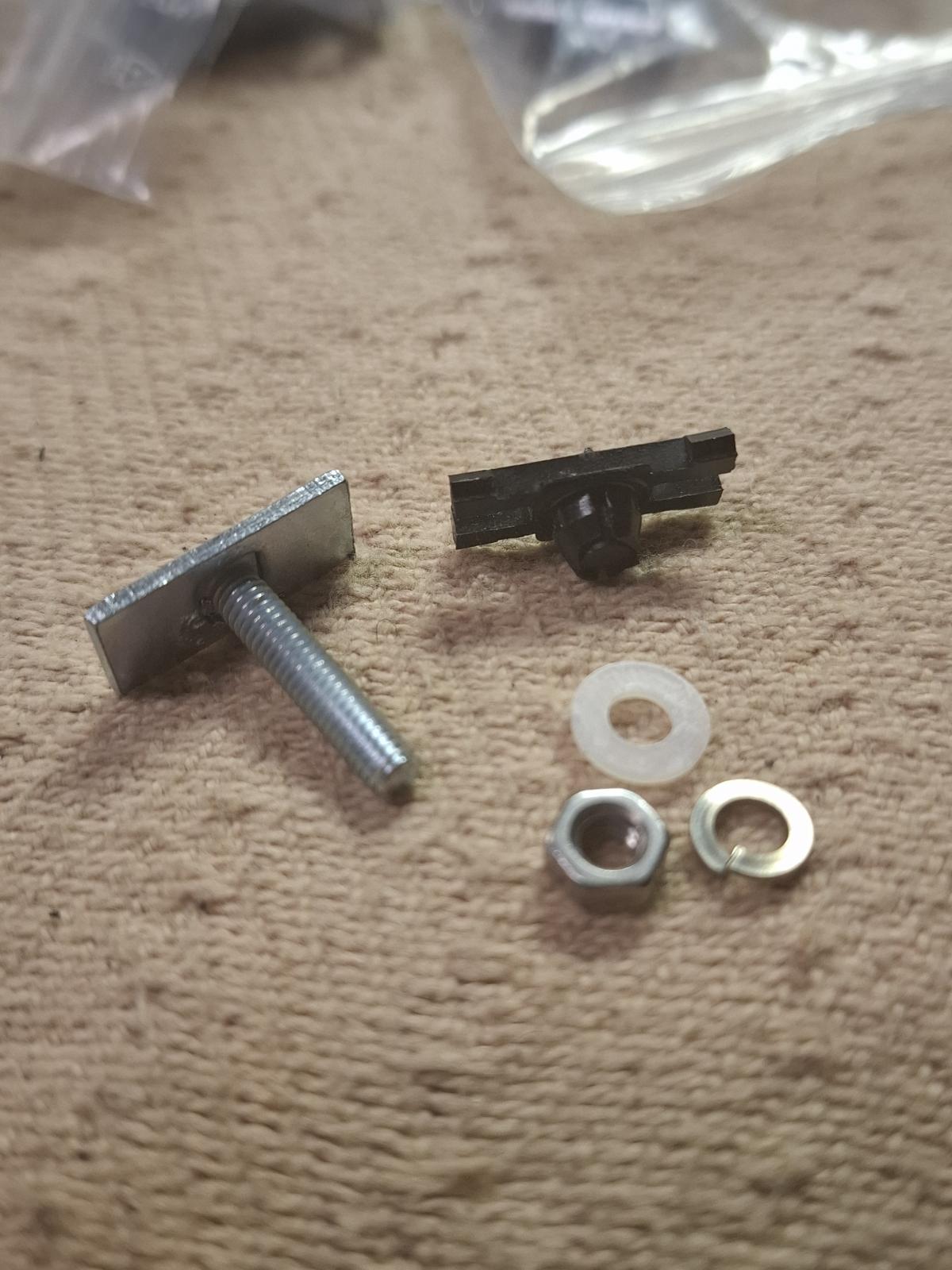

PostPosted: Sat Mar 15, 2025 11:41 am    Post subject: Re: Repro side trim - a case study Reply with quote
So after thinking about ordering from Rock Auto (who have stuff on a website, available here in Europe) and then realising that ordering a couple of the Chrysler style clips to try out would have both a hefty postage cost and imperial nuts would need to be sourced, neither of which I wanted to deal with.
I scoured ebay for every possible type of bolt head and eventually came up with some perfect little rectangular headed (9 x 20mm, m4 thread) bolts, intended to hold the trim onto a vintage Deutz Tractor. Not super cheap - I paid about 75 euros for 50, but they seem ideal. I fitted them with some plastic washers and spring washers and a stainless nut. As the threads are only m4, there's a bit of wiggle room to adjust the position of the trims.
If you're in Europe, they may be just what you need.
Search for "Zierleistenschrauben für Zierleisten groß Deutz diverse Traktoren"
