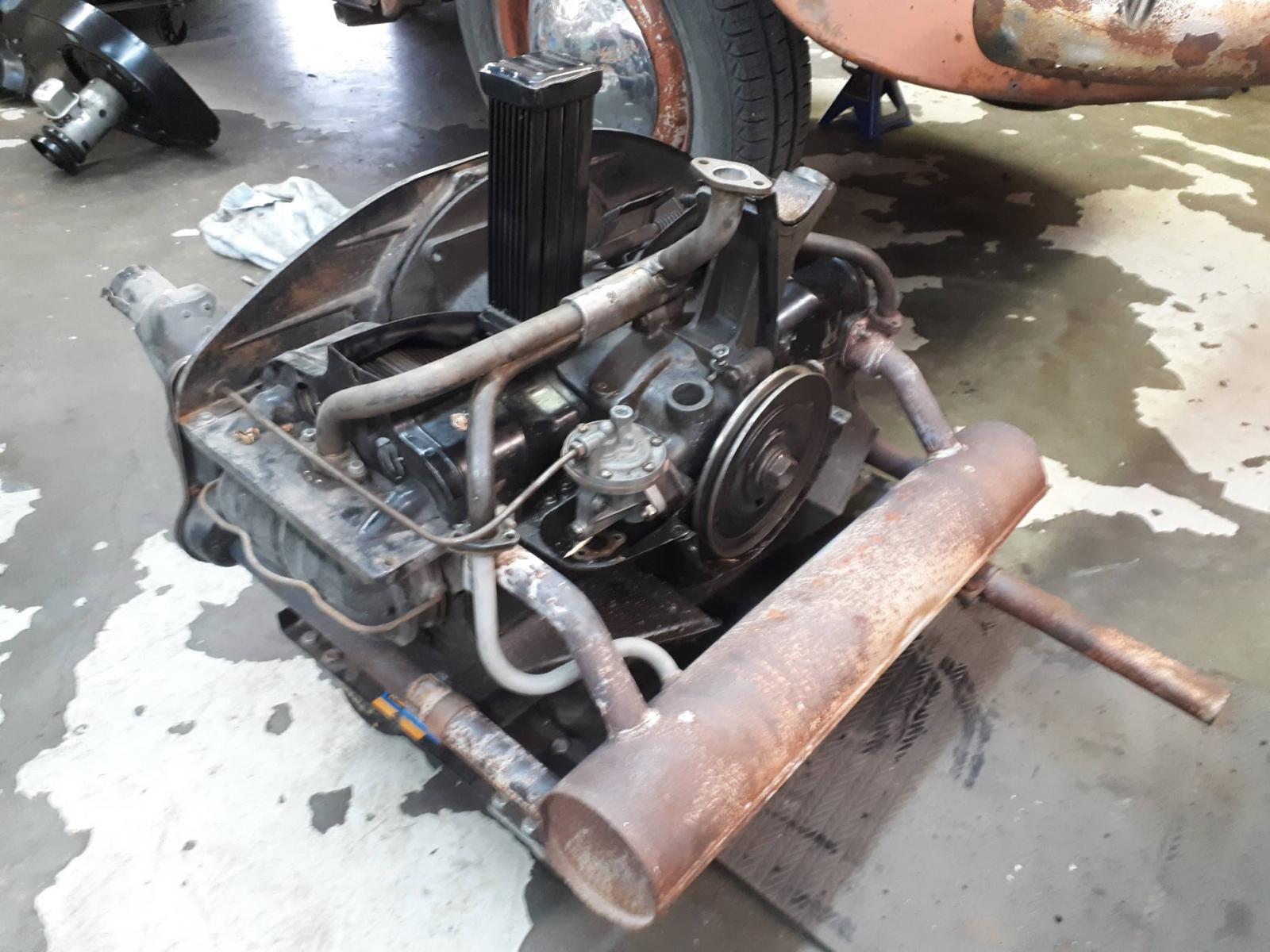

Later...
I have a spare engine:
It came out of a 1959 Canadian custom in Mignonette my best friend bought in 1979 for $80 because it was the only car in the paper for $80. We fell in love with that thing. Started a tire fire in my head for '59 beetles. Well it dropped exhaust valve #3 and broke the motor. I saved the motor and we sent the car to the shredder. Kinda sorry about that now, we were 17 tears old with no tools or skills but it was a mostly rust free car that was totally fixable. Just not worth anything in 1979. Anyways... I rebuilt the motor in 1989 for a '59 I bought for $50 which I drove for a year until it fell apart from rust. The motor then went into a '59 Canadian custom in mignonette green
Which I drove for 10 years until it got hit really hard by someone tuning their radio.
The motor then went into a coral red '57
Didn't like that car. Sold it but kept the motor
The next life was my 1959 Canadian custom sunroof
That I drove for 13 years. Before I sold it I rebuilt the original engine and kept my old one.
So far the engine has been in 5 cars:
original car, 1959 Canadian custom in Mignonette green
1959 deluxe in Capri blue
1957 deluxe in Coral red
1959 Canadian custom sunroof in Fjord blue
Now it will go into my 1954 Canadain custom in Ultramaroon until I can get the '54 motor fixed.
But first I will clean it
Including all this stuff
BTW I hate cleaning car parts.
Don
Better and better mistakes!

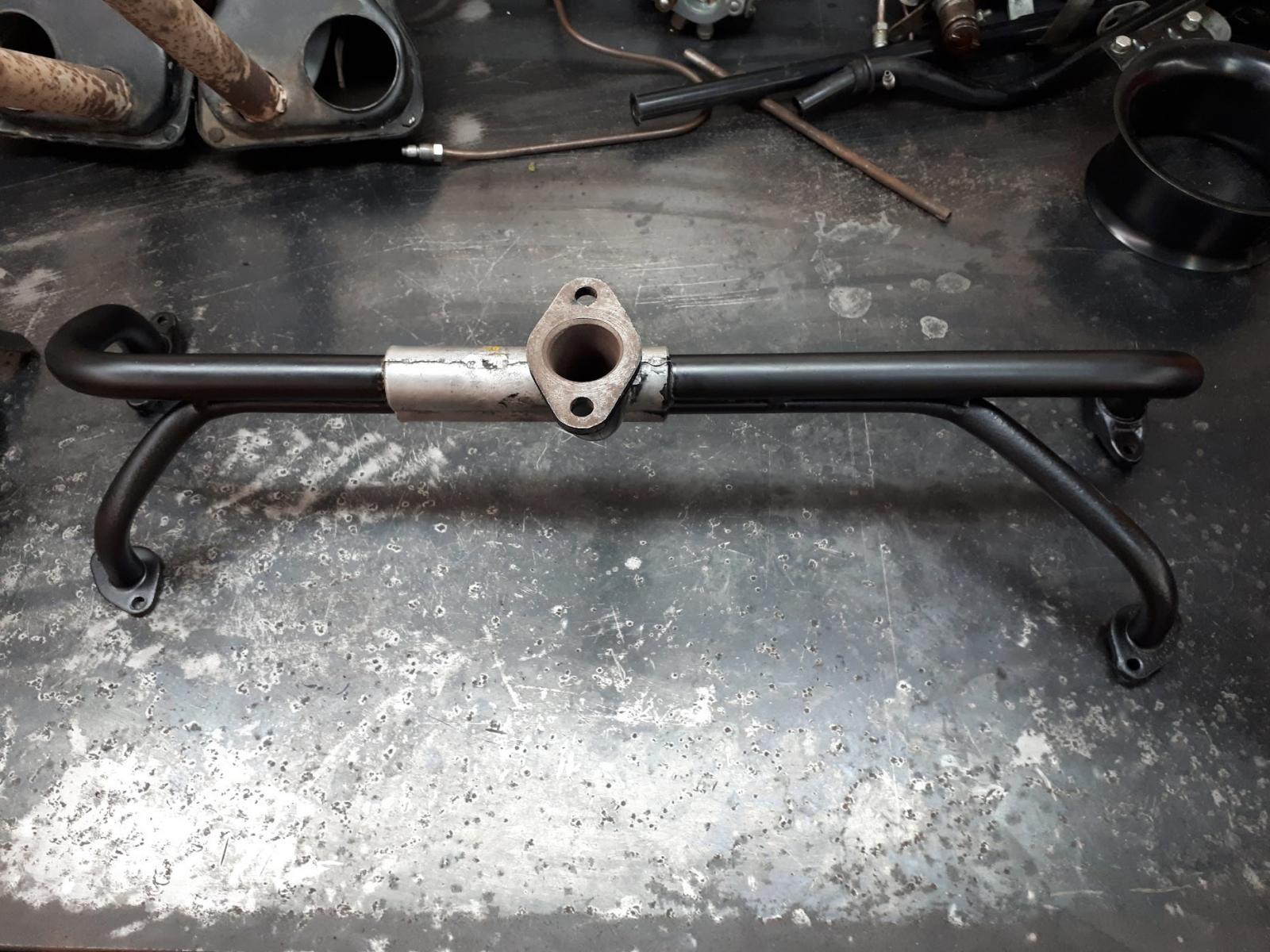

Yes, I checked the oil before I left. I am thinking something got into the oil gallery and shut off the oils supply to the push rods. I will likely pull the engine in the next day or two. My garage is a bit crowded right now, I have the TR6 with a blown header, the type three and the dead beetle. Does not leave a lot of room for taking things apart.
OTOH I am cleaning and otherwise prepping the replacement motor. I sand blasted the intake and painted it with POR15. I came out beautifully. An hilarious moment tho... I stuck the sand blaster nozzle into the heat riser and pulled the trigger. Things got very black for a second there. I made a bit of a mess of the blasting cabinet. Oops.
OTOOH. I powder coated all the tin on the replacement motor when I rebuilt it in 1989 and with a bit of elbow grease it is looking great.

Sandblasting seems like a great way to clean a partially clogged heat riser!
1-0900722 die langsame grüne Schildkröte
https://www.thesamba.com/vw/forum/viewtopic.php?t=765074
sunroof
Joined: October 06, 2006
Posts: 2023
Location: Winnipeg
sunroof is offline
PostPosted: Tue Jun 17, 2025 8:49 pm    Post subject: Re: Field find 1954 Canadian custom Reply with quote
Just be ready for a mess!
In:
Out:
Don

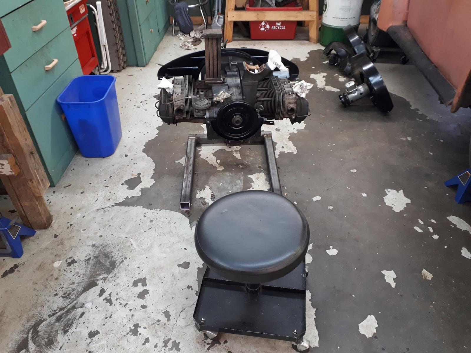

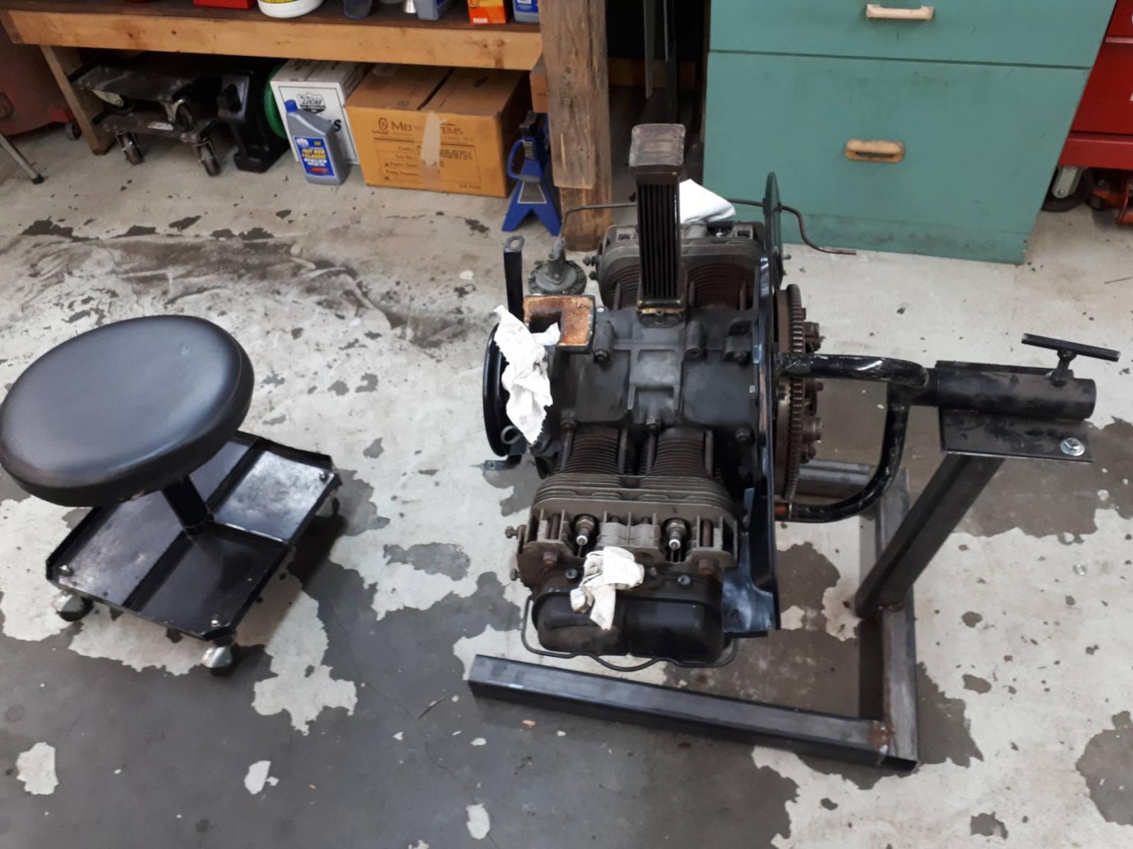

PostPosted: Fri Jun 20, 2025 3:06 pm    Post subject: Re: Field find 1954 Canadian custom Reply with quote
Had a very productive day today. Built an engine stand that I can easily mount an engine to with the floor jack. It is also the perfect height for working on while sitting on my little roller stool
If I need to have it on wheels I can drop the whole thing onto a wheel dolly.
I got the idea from this guy:
https://www.youtube.com/watch?v=vkckmSBW5HQ&t=3246s
Don
Is that black POR-15 specifically made for high-heat applications? If not, it'll burn off the preheat riser pipes soon after they get normal hot.
Very likely. I have tried various paints over the years and so far nothing I have tried sticks so I figgered meh why not.

PostPosted: Sun Jun 22, 2025 12:25 pm    Post subject: Re: Field find 1954 Canadian custom Reply with quote
Spent a couple of hours building this engine up
Man I love this old girl. She has been so great over the years and cars
Like I have said previously all this tin was powder coated in 1989 when I built the engine and has cleaned up wonderfully. It is so amazing to build something up that is not fighting me the whole way.
She will have to come back apart a little to go under the car but I wanted to buld it up to make sure everything fit together while it was easy to get to and not find a problem when it was already bolted to the car.
Don
VW_Jimbo Premium Member
Joined: May 22, 2016
Posts: 11145
VW_Jimbo is offline
PostPosted: Sun Jun 22, 2025 3:21 pm    Post subject: Re: Field find 1954 Canadian custom Reply with quote
Awesome man!
Hey, not to be a Debbie Downer but that fuel line so close to the exhaust might be an issue. Maybe?
Jimbo
