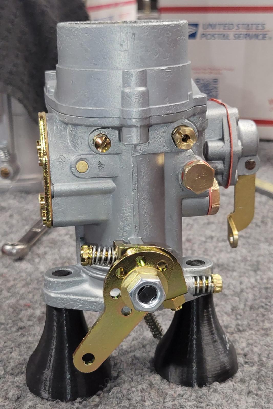

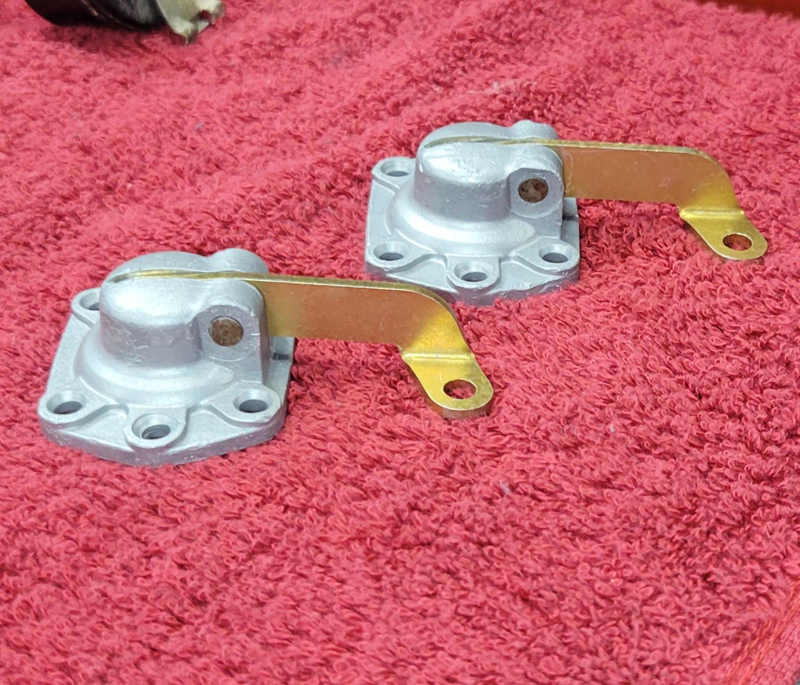

I'm restoring a set of selects 32 pbic carburetors for a customer that has a 356, I'm getting close to completing them it's been a long journey locating parts, ran into I think what is my last issue is the pump rod and diaphragm lever arm, from the research I've done online and the parts that I have there are two different pump rods, the one that is pictured here and another one that is slightly longer that has threads on the end and adjustable nuts which that one is the one I believe I'm going to need and there is I believe three different pump arms I'm just not familiar with the combination that I need and also finding these last one or two parts that I need if somebody has any information I would appreciate it thanks in advance!
