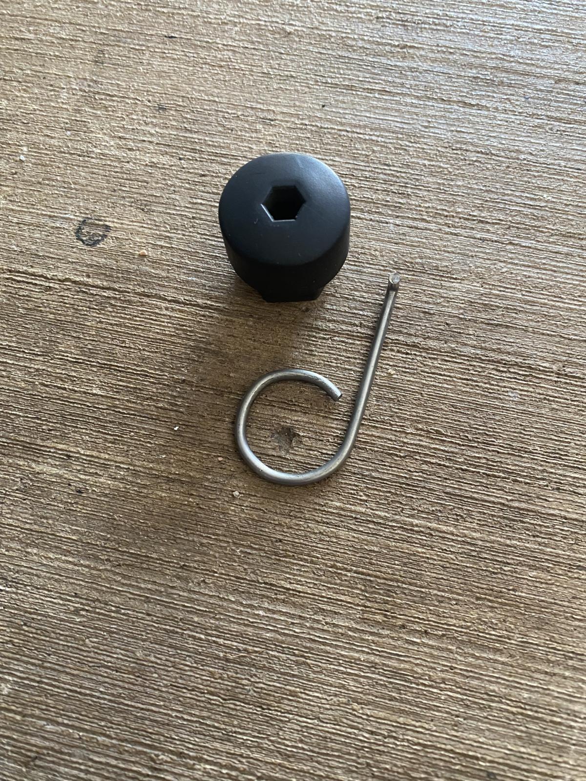

The Jack has never been used, and the pin is attached to a plastic clip on the Jack holder. My first clip came right off…. That is, when I held and pulled the clip with a pair of vice grips! The cap was so tight from accumulated surface rust on the lug nut, which will be treated and removed.

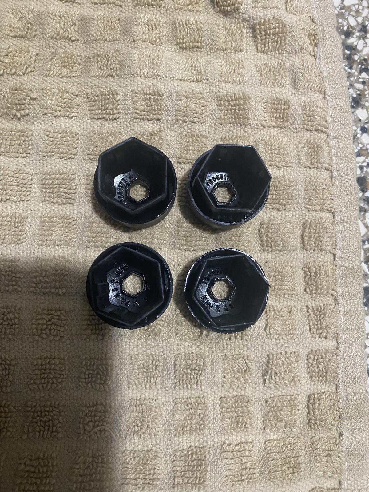

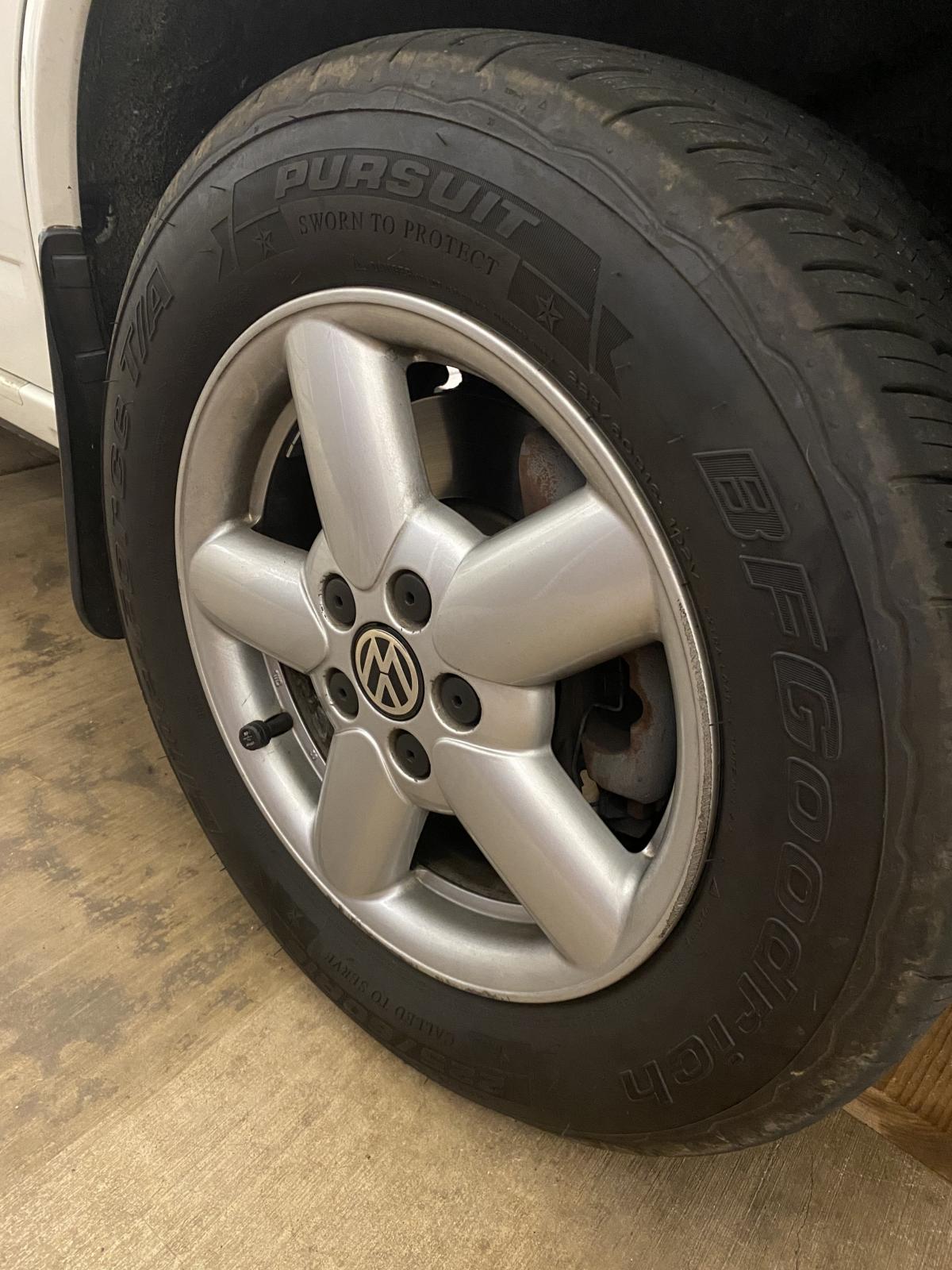

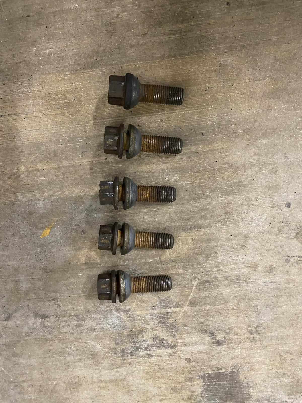

Thought you might enjoy these pics!
Let the cleaning begin! Yuk! Bob

McGuire's makes a decent aluminum wheel cleaner. Available at most main stream auto parts stores.
My GW wheels were a little nasty, I sprayed them with the cleaner and rinsed them well. It cleaned up the wheels really well.

About 30 seconds of propane heat, kept on the bolt head, will crack those next time. You can see where the metal had bonded up to the hub and made life tough

All day on one wheel, lug bolts, replacement mudflap! Rust Avenger, I will see if I can find the McGuires wheel cleaner tonight! The mudflap took a while, but came out OK. Lug bolts have a fine layer of axle grease. They will never look like they did when I started again, while we have this bus!!

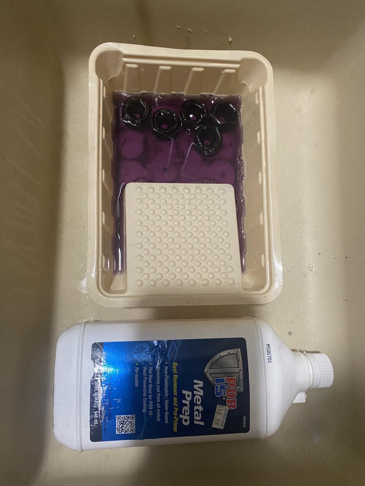

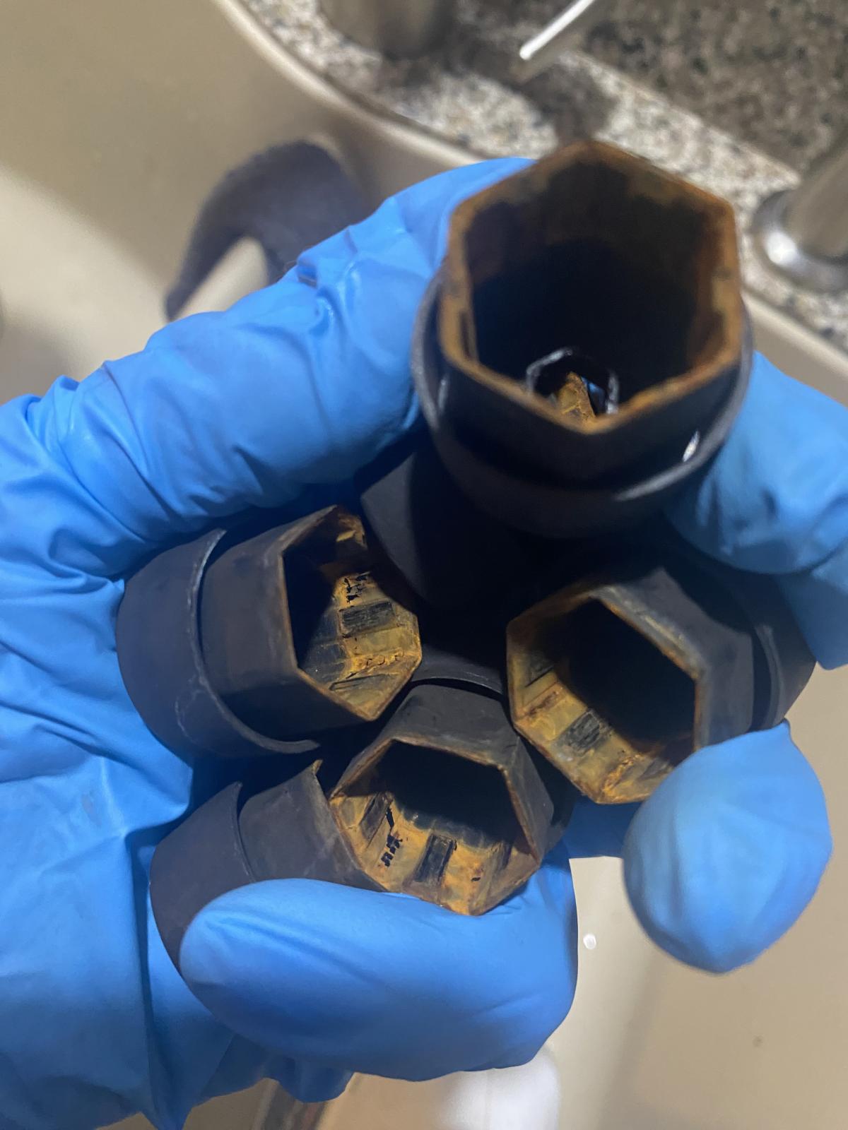

Thought you might enjoy these pics. I broke one of my lug bolt caps when taking them ALL off. As you have seen, the lug bolts were covered with surface rust, and the wheels were filthy inside from years of brake dust., the Meguiars Aluminum wheel cleaner did an amazing job when combined with a small scrub brush and a soap filled Brillo pad! The caps were so tight due to the rust on the lug bolts. Soaking the caps in POR15 Metal Prep for 24 hours removed ALL of the rust! All I had to do was rinse them in water and dry them off.

One occasionally sees professional trucking rigs (18 wheelers) with lug bolt caps installed for cosmetic reasons. Sometimes the caps are adding bling--chrome or spiky appearance.
I asked a shophand at the local Freightliner facility about these. He said flatly that those caps just capture moisture on the lug heads and cause them to rust and corrode, and make maintenance so much harder.
It looks like these VW caps, cosmetic in nature, are doing exactly the same thing.
