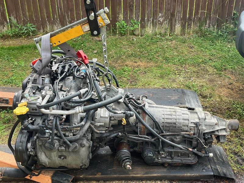

MSGGrunt
Joined: July 08, 2023
Posts: 248
Location: Western, MA
MSGGrunt is offline
PostPosted: Mon Jul 07, 2025 3:05 pm    Post subject: Re: Calling all Reversaru EJ25 Swap Owners Reply with quote
So the adventure begins.
