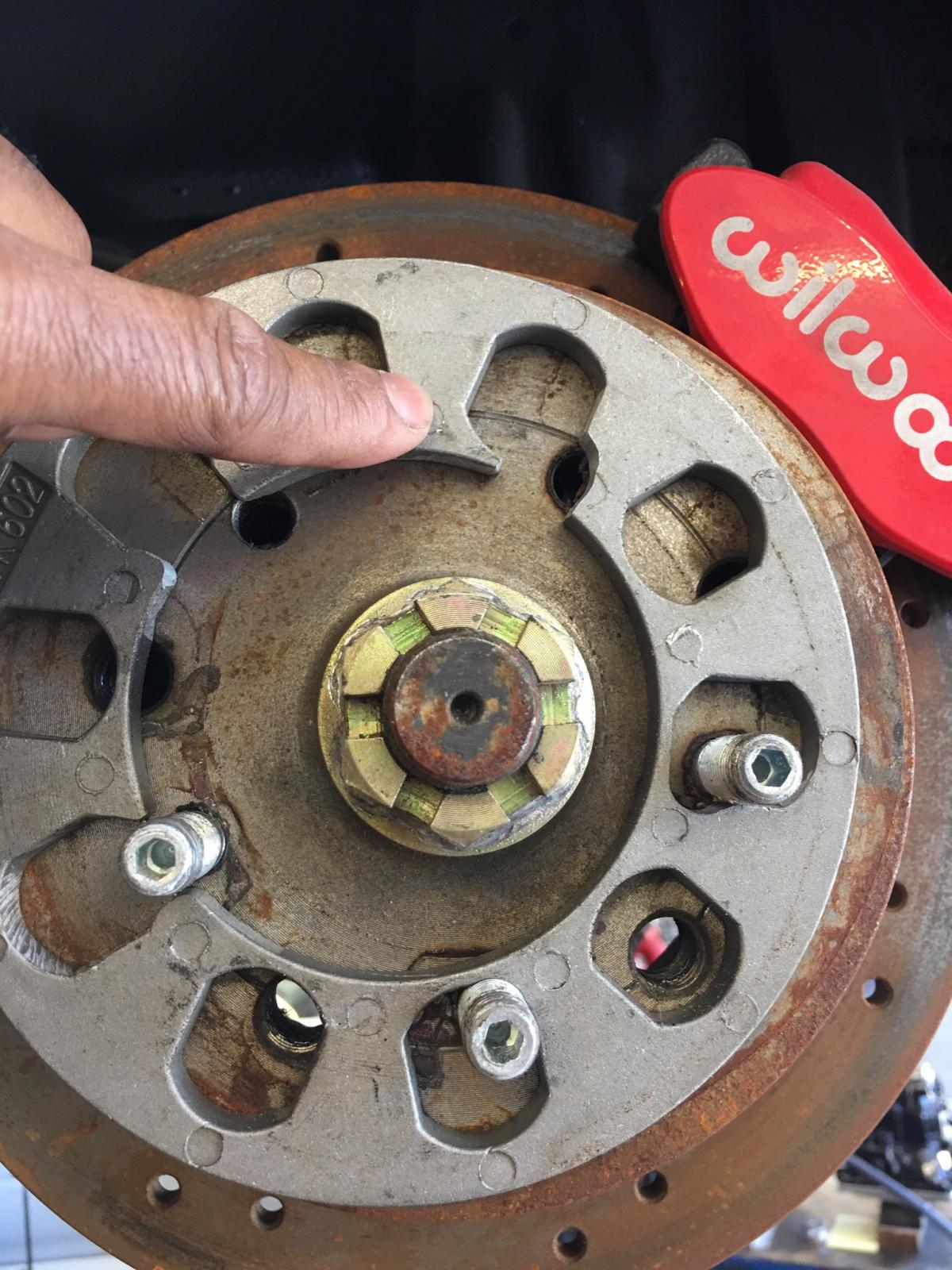

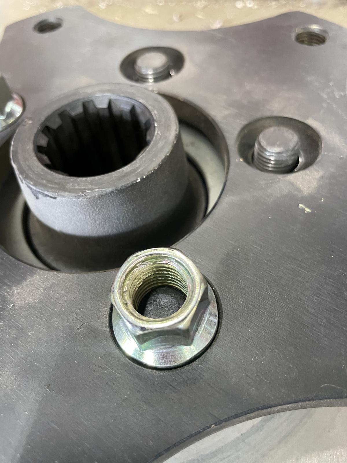

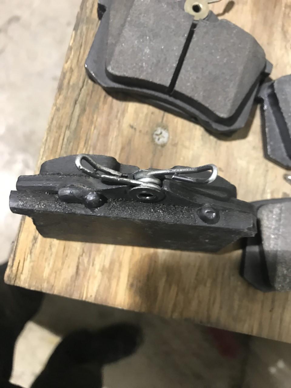

Better check your brakes, this is what he has sold to two of my clients now, that came to me after buying his trash.
so you understand what is wrong in these pictures. He is tack welding steel flat bar to the back of brake pads to space them out far enough to allow the pads to connect with a rotor that is too thin. The calipers are designed for a .81 thick rotor and he is installing them onto .38 thick rotors. When the tack welds break the pads will fall apart causing the brakes to fail. If they don't fall apart and your lucky enough to wear them down with out over extending the pistons you'll need to do the same crap to replacement pads. There is a reason they are not made this way at wilwood.
the other photos of the hub is how he studs a hub from 5 on 112mm to a 5 on 114mm hub. The studs fell out and the wheel when installed went up and down like a clown's bicycle wheel.
This guy is putting people's lives in danger, so please check your brakes if you have a set of his. This is not a joke!
The last picture are some cheap wheel spacers he installed on the same bus to make the wheels fit. Why not buy the spacers for the correct lug pattern. Also it is dangerous to stack wheel spacers like he did on this car, it will lead to the wheel coming loose.

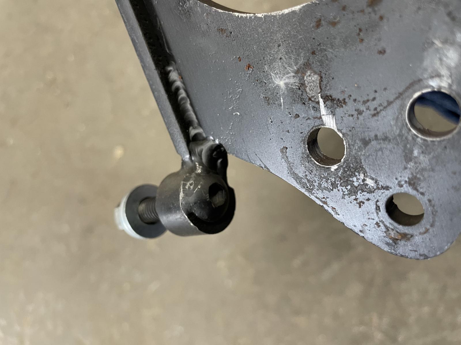

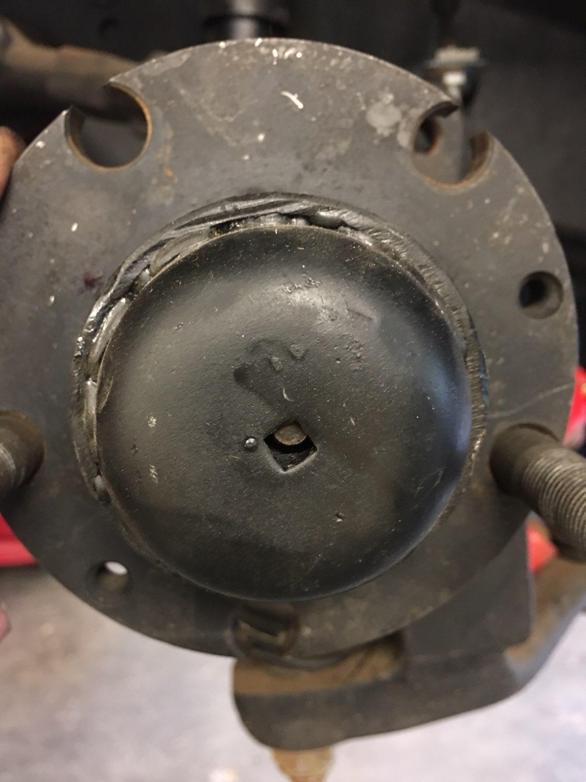

Here are a few pics from a guy I am trying to help out of his Vintage VeeDubs debacle. He spent over $7000 on front and rear baywindow suspension from Bruce. The rear was a complete mess, and there was ZERO way ANY wheel tire combo would go on. A stock wheel and tire was about 1" to wide to even fit inside the fender. The front he got as a complete assembled unit from bruce. Of course ZERO help, from VVD, and they will not answer phones, or return messages.
These spindles bent on the maiden voyage, driving 2 blocks on a side street, and never exceeding 20mph. And yes...the calipers came straight from Bruce with all of the washers stacked up like that. The rear end parts were even worse than this.
Rear end parts. Those crooked cut sleeves hardly welded on are supposed to be caliper brackets. And yes, he sent them out the door with only 2 threads of the lug studs holding on.
Be careful out there people. Don't send your hard earned money to this guy.
