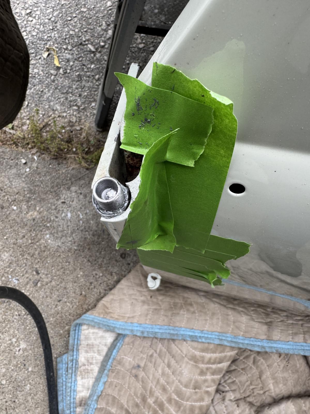

Installed one size over door pin. Drove out and installed new pin with air hammer. Used WW pin and reamer. Easier than I thought but happy it’s done.
Was this done due to a loose hinge? My driver’s side hinge is a bit wonky. Wondering if this helped.

PostPosted: Sat Jun 14, 2025 3:12 pm    Post subject: Re: What did you do to your Beetle this week? Reply with quote
Stockholm- yes exactly. Hold the half of the hinge that attaches to the A pillar. If there is play it needs replaced. I tried a straight up same pin and there was still play, so I went to one oversize and it’s now nice and tight. Bought the pin and reamer at Wolfsburg West. Good luck
Thanks Far Rider! I need to look into this, for sure. I’m tired of having the door fly open on bumpy right turns. Smile
I don’t have an air hammer, but might be able to borrow one. I’m just weary about messing up the paint.
