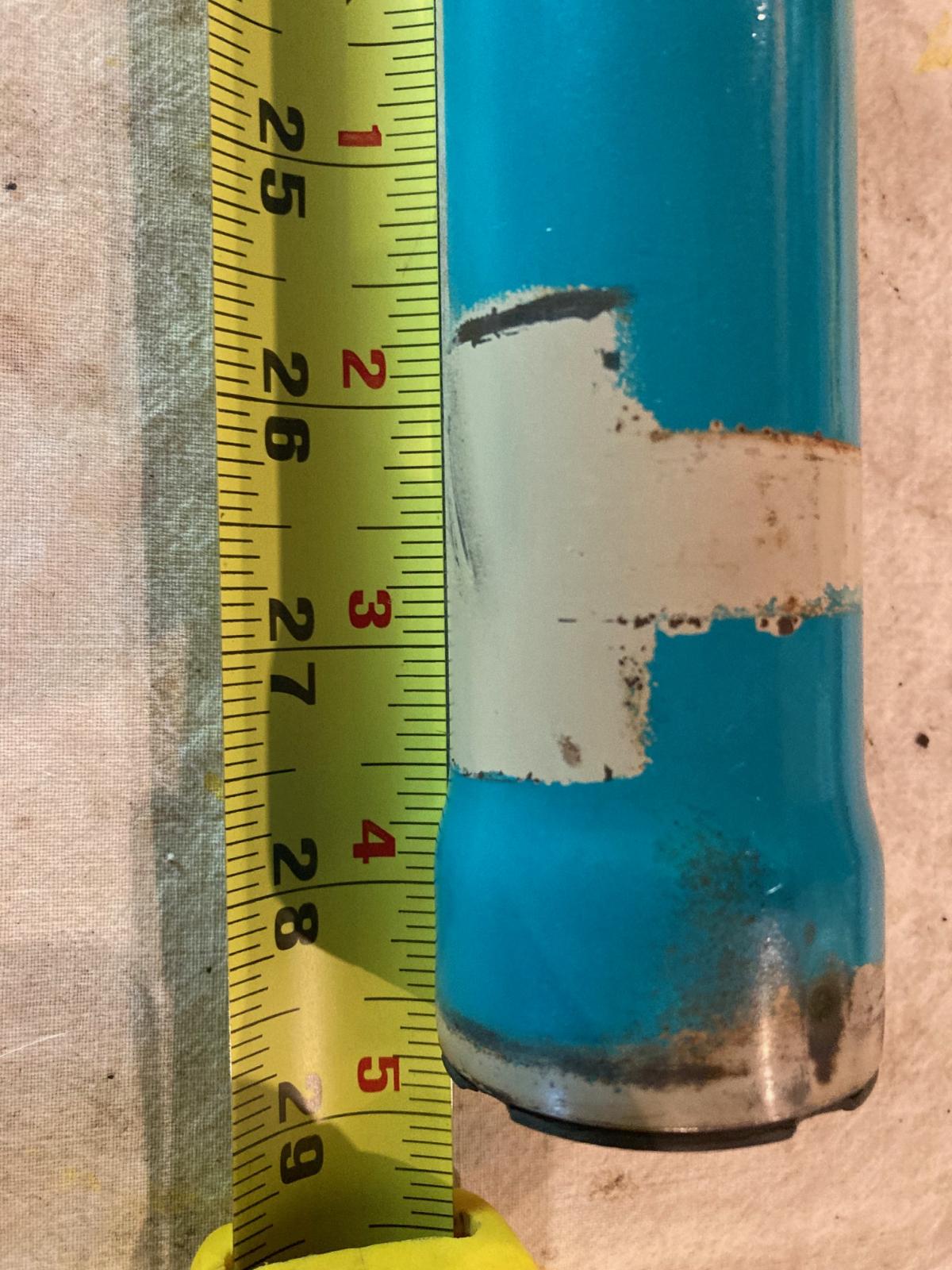

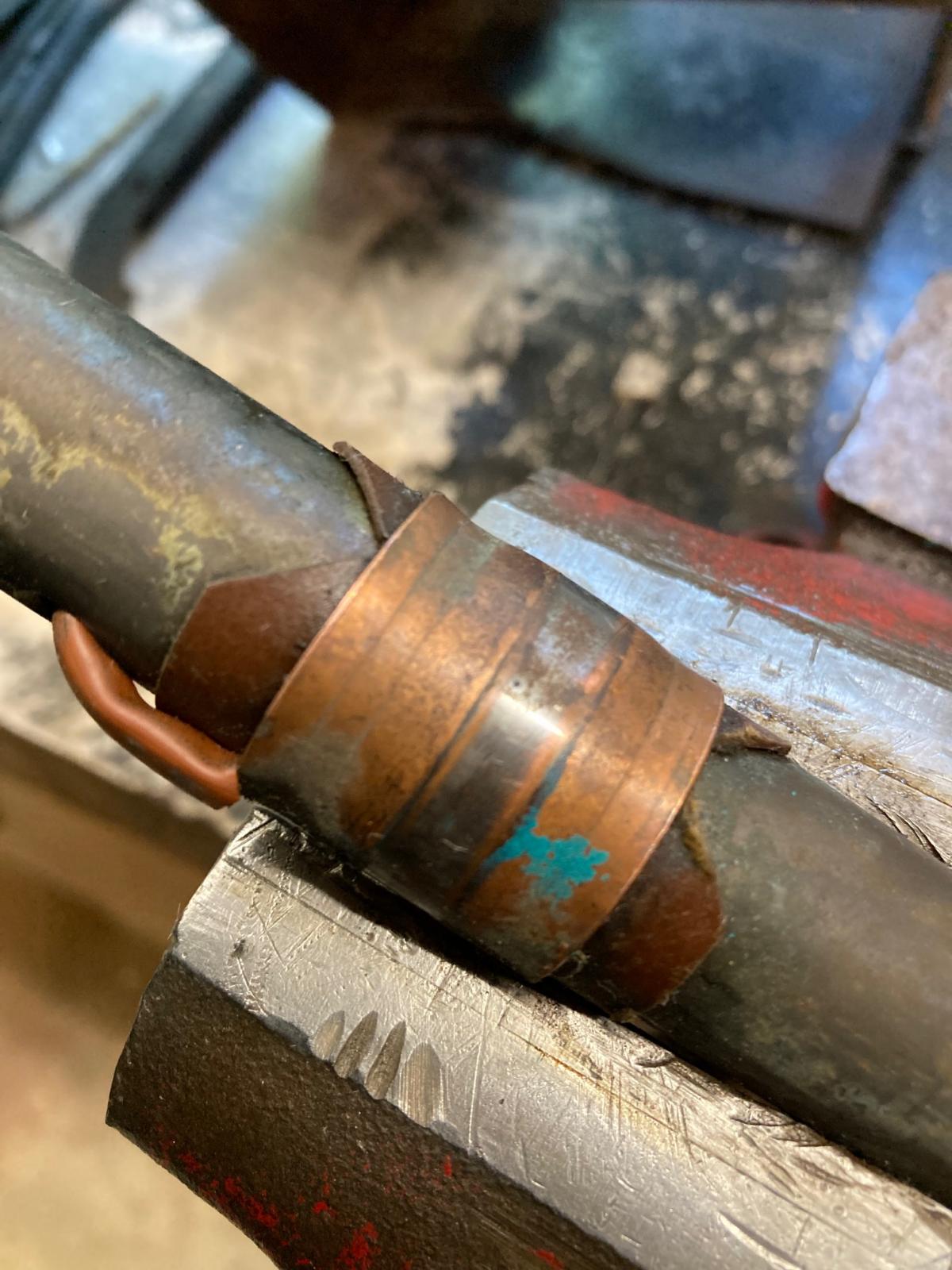

Okay .... nominated for worst rusted bolt of the build is the rear passenger side lower shock absorber mounting bolt.
This beauty had 70 years to rust weld itself for eternity or so it hoped!
Soaked relentlessly with penetrating oil and heat I got it to rotate about 30 degrees and then would go no further.
Heating and shocking with water..... nothing. Now the bolt head is further mangled as the vice grips were used with enthusiasm.
Now going full attack ... the rubber bushing was melted off and shock absorber also cut off leaving the metal sleeve. Hoping to slide the sleeve off..... Nope.... it had rust-welded itself in pieces and this was ground off leaving the exposed bolt.
Wasted too much time putting a cut into the bolt and hoping to twist it out by using a chisel..... Really bad idea on my part. So now cut the bolt flush to the mounting point on the axle.
Next centre punched the bolt perfectly, (lifetime achievement noted here) to drill it out or at least partly. Drill bit goes in ..... but bolt still not moving!!
Short trip to walk-in clinic to get infected finger dealt with ... think this was related.
Have a friend who is an aircraft mechanic that provided me with a air rivet gun and different size punches to use. Also with some magic penetrating oil in an unmarked bottle and instructions to use only one drop on work area!!
Found the perfect punch .... too perfect... it got quickly and badly stuck in the drilled hole. Magic oil applied and finally got the punch out with no damage to the punch. Found a smaller sized punch and pulled the guns trigger....
Finally the bolt slowly was driven out with a good coat of defeated rust evident..... as per below.

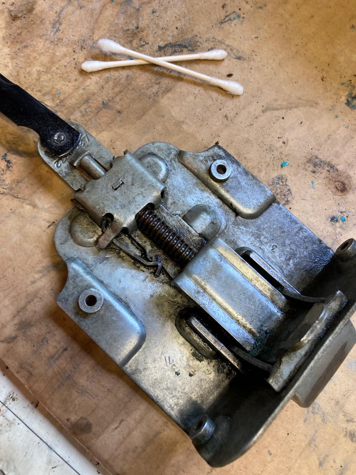

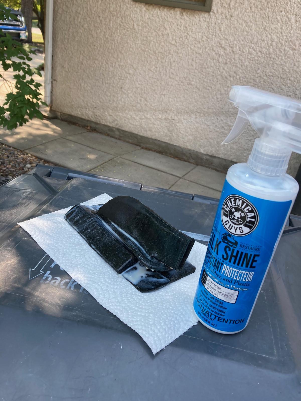

Now preparing some parts for eventual reassembly. Cleaning steering column, removing rust and grease and the blue paint that is always present.
Rubber steering column grommet.
Removing grease and grime from passenger door latch mechanism.
Decided to reuse the OG rubber handbrake boot. I ordered the repro but it does not have the dimpled surface of the original. 0000 steel wool and paint remover took good care of the blue it was painted in. I like to reuse the original parts if they can be cleaned up!

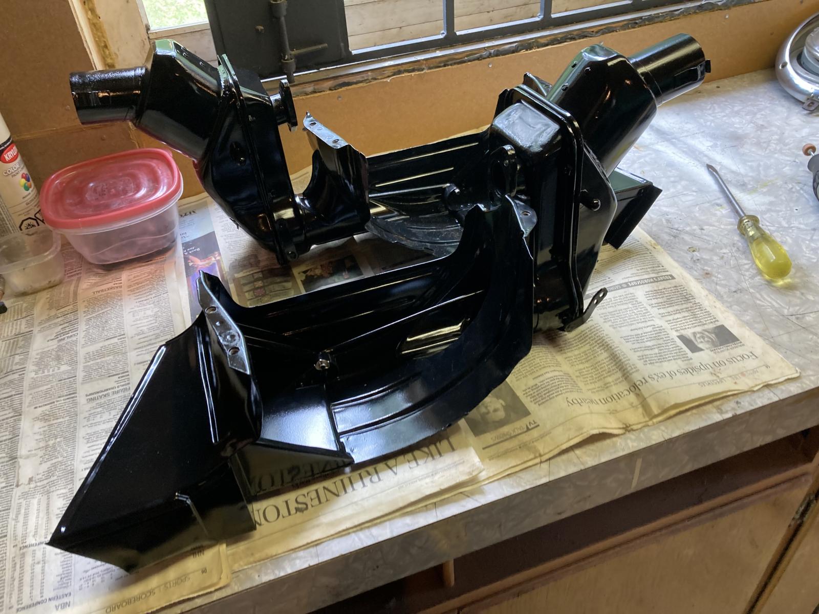

Heater boxes operational and ready to go.....

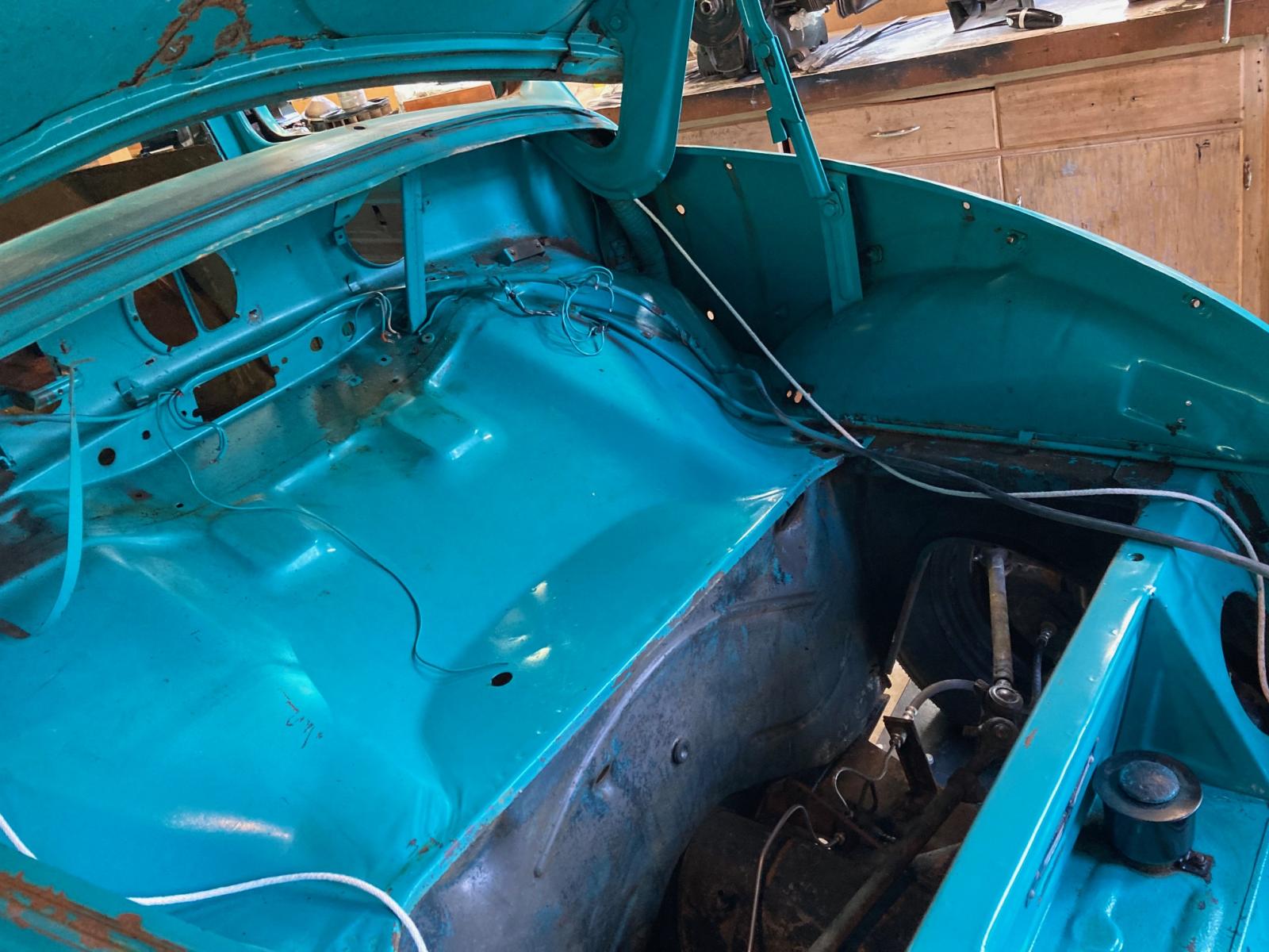

Removed the wiring harness yesterday with no drama. All the blue wire is finallly gone!!
Also wire wheeled the back parcel tray to further find out the damage caused by one leak in the rear window over time!
Still aiming for body work to start in September. Since I am not gifted with that skill like others here I will be contracting this out.

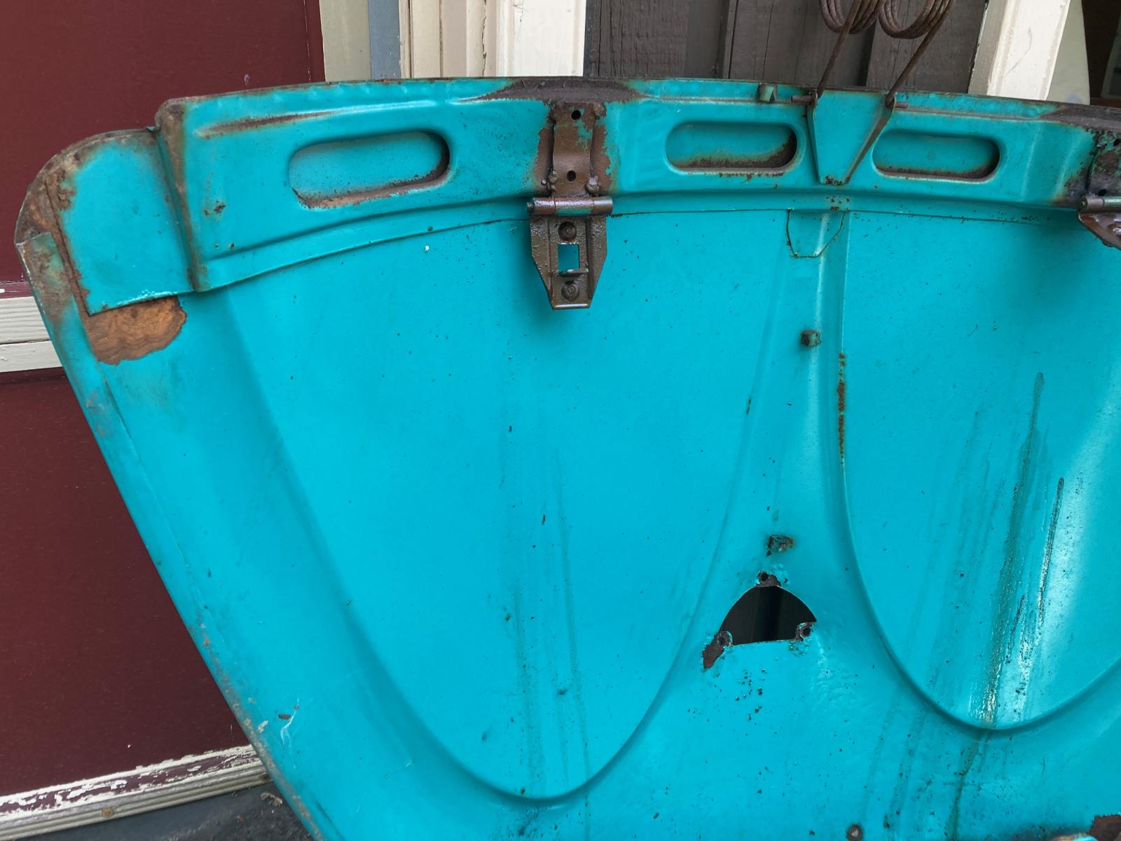

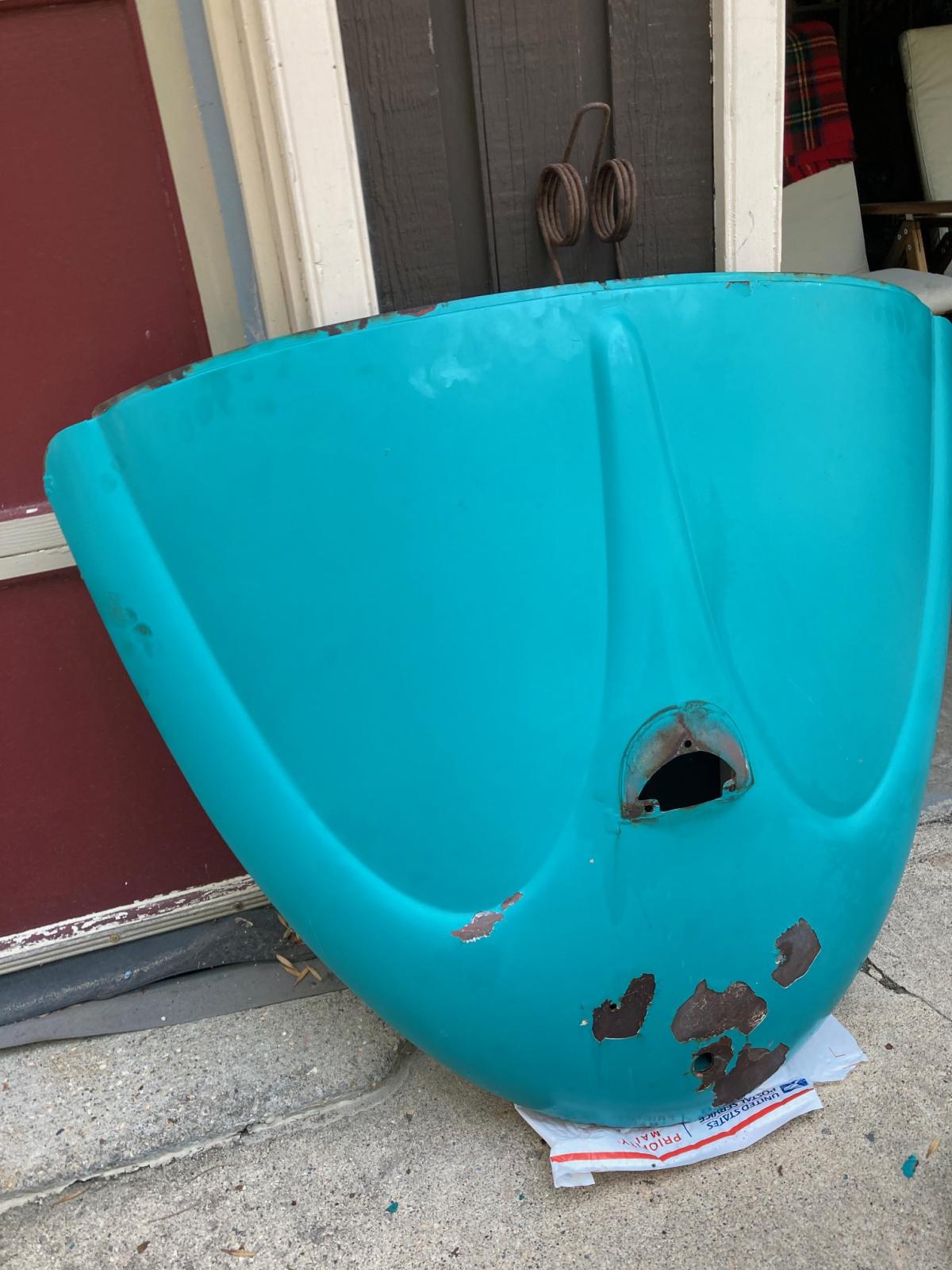

So my engine deck lid has seen some use and seeing what options there are locally to find one in better condition.
One hinge is fine although the other does not have full range of motion. Also evidence of previous welding repair of both hinges. Rust and older repair body work as well.

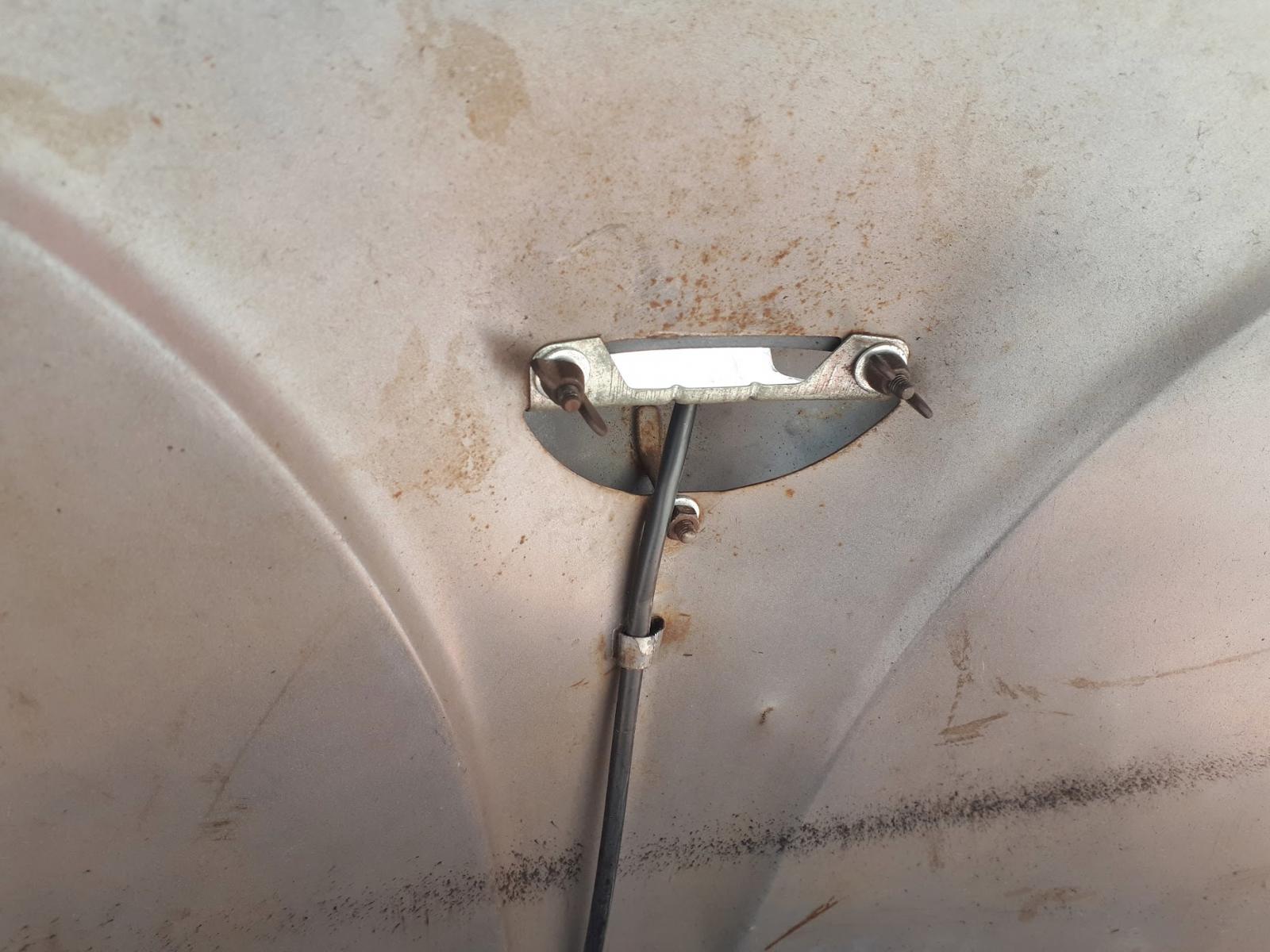

Also amusing myself on how to put the rear licence plate light assembly together. The factory workshop manual mentions wing nuts.....
Have access to better hinges. It is the original deck lid though and these are increasingly hard to find. It can be repaired as well.

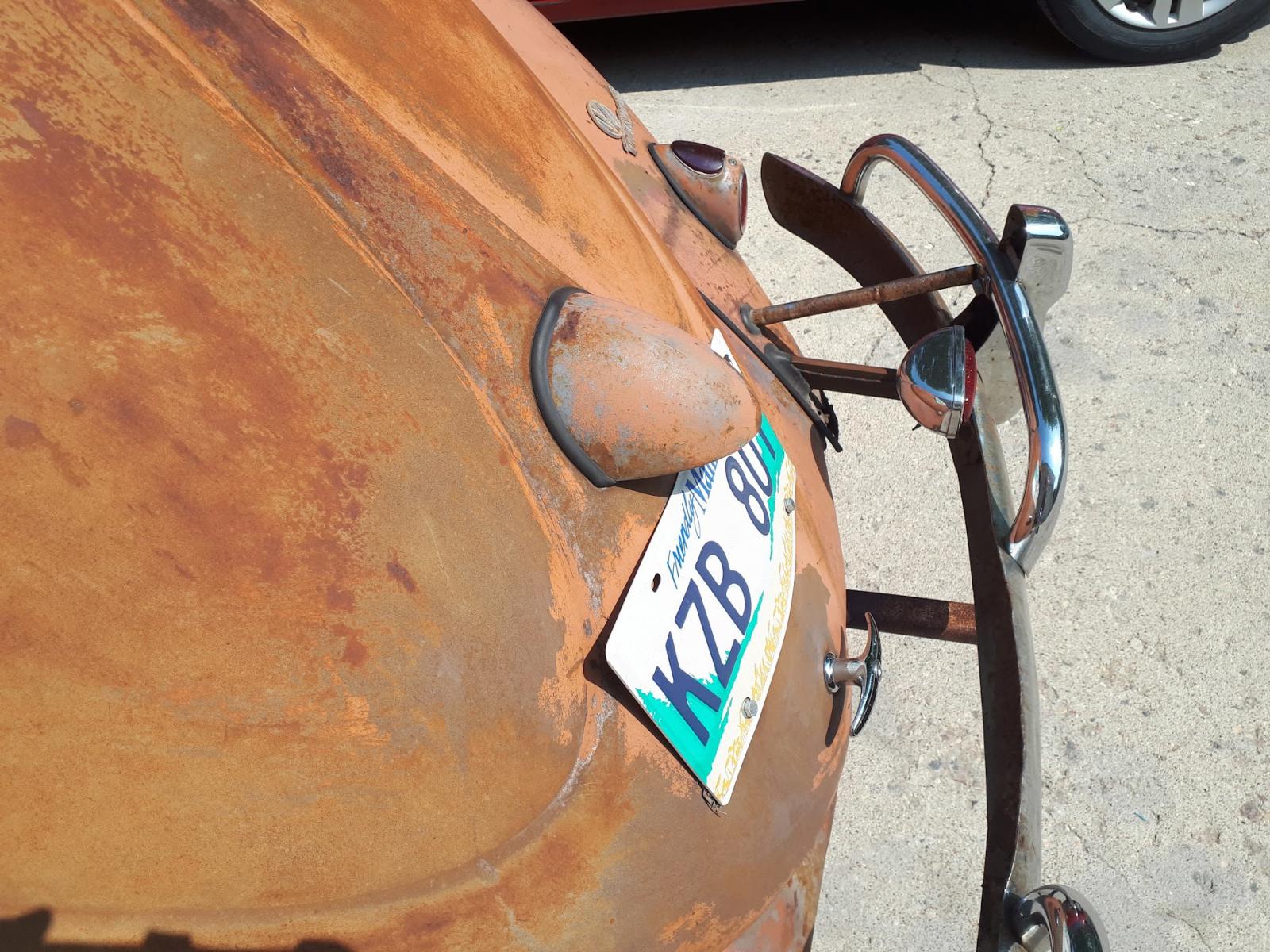

So why two licence plate light seals?
Plus the related link to where is the seal for the plastic lens to housing. I pulled the remains of this small circular seal out yesterday.
https://www.thesamba.com/vw/forum/viewtopic.php?t=792527
Top West Coast Metric '53-'57; Bottom West Coast Metric '52-'57
Top one makes way more sense....

The top seal goes on the inside between the inner clear lenz and the hood. US models had a clear lens inside so I think the licence light would shine on the engine bay in the dark with the deck lid open.
The lower one goes between the lamp housing and the hood.

Yes, what Dan says is correct. I don't have an inner lens on mine so I just have the outer seal.
No inner lens
