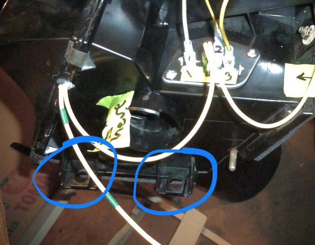

Someone was in there before me, and I have two that are broken and missing. These are the tabs that hold the screws to the front body. Has anyone fabricated them?
Thank you!

Picture or two would help- this way even if someone hasn't done the job before, they might have a great idea on how to go about a repair for you once they've looked the situation over. Think Think

If you mean these:
I could see using or fashioning a key-shaped washer or similar:
Cut a small slot in the side of the heater box (right where the broken plastic tab is), insert the tab of the new washer & mount the heater box back in place with the original bolt…prob’ly better than new!

Like this
https://photos.app.goo.gl/ZQcfiKpQKFpUZWRCA

Yep, we’re talking about the same thing. What ya thinking, what you gonna do?
- Dave
I suppose I can try to build something up with ABS sheet and ABS glue or a metal L bracket. I was hoping to find other examples, but in searching, I couldn't find anything.

Bend some aluminum or steel sheet into an angle shape and the screw it to the plastic box.

This would be very easy to model and 3D print some generic L brackets to adhesive to the existing box.
If it was me I would just call Bus Lab up and ask them how much for a new used heater box.
