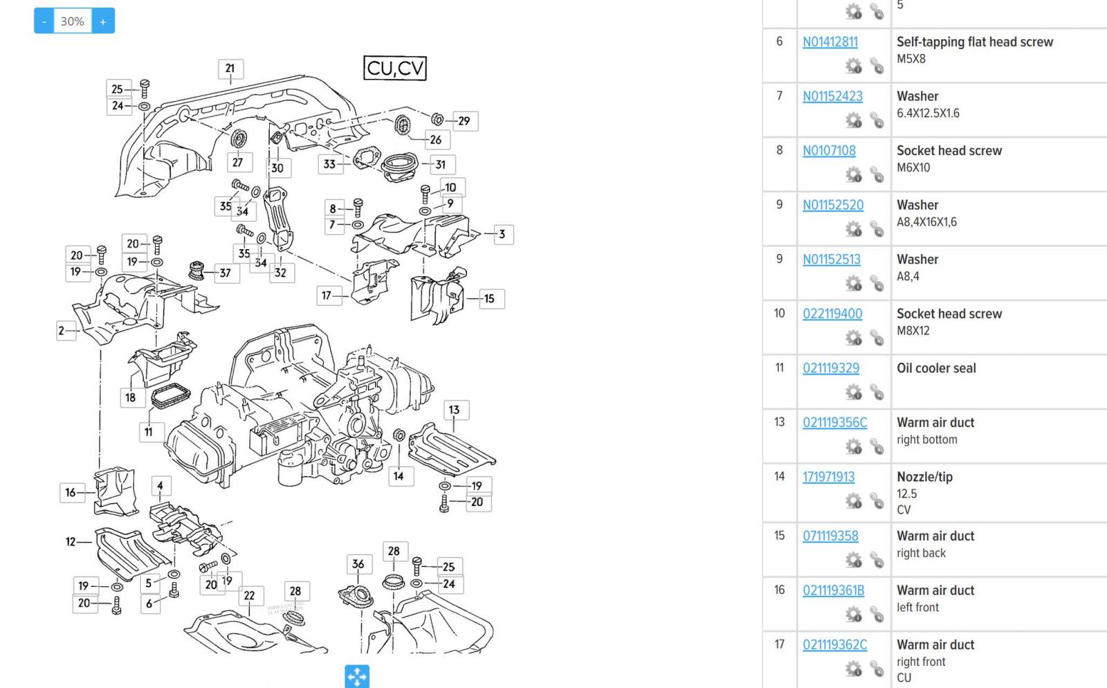

No, the Vanagon vertical piece is different, and so is the horizontal piece on other Type 4 probably , I just ran into the same BS, I had the wrong vertical piece from possibly a Bay Window bus and couldn't figure out why the correct horizontal piece wouldn't attach to it.
Here are the Vanagon tin parts:
Vertical left piece 021119361B
Horizontal left piece , part number 021119355B?

PostPosted: Sat Jul 05, 2025 6:32 am    Post subject: Re: California Model Engine Tin Reply with quote
Thanks. Judging by the photo we do have the correct warm air duct piece. I ‘m not sure the lower piece is correct though. There is a crossover pipe that drops down a bit with California Exhaust and I think it should have a bump out to accommodate that. I’ve found a piece in the classifieds I think will work and ordered it. I’ll let you know what we find out and take pictures of it installed if it works out.

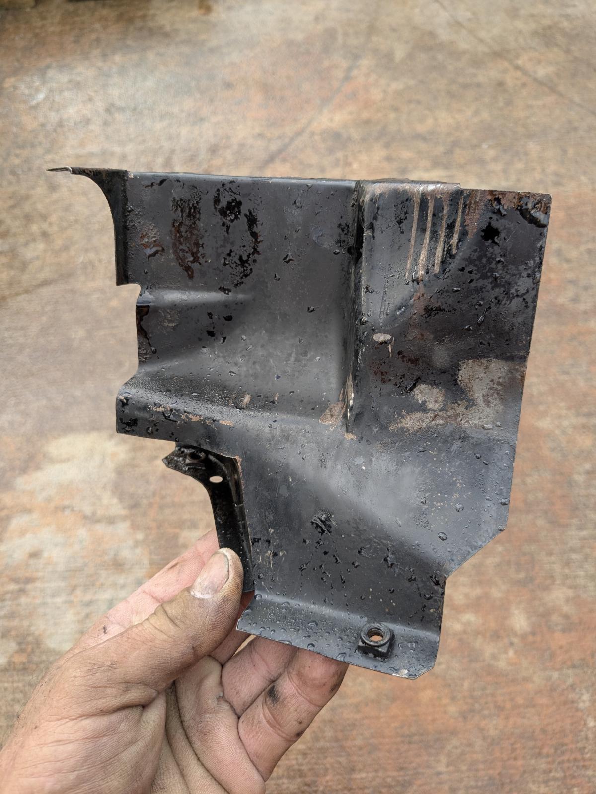

PostPosted: Sat Jul 05, 2025 6:37 am    Post subject: Re: California Model Engine Tin Reply with quote
This is the piece I found and ordered.

ALIKA T3
Joined: July 30, 2009
Posts: 7161
ALIKA T3 is offline
PostPosted: Sat Jul 05, 2025 11:27 pm    Post subject: Re: California Model Engine Tin Reply with quote
Could you post pics before and after installation please?
I can't find any drawing about the CA models, just Federal, which is apparently what I have pictured.
It seems mike the 2 tins on the far right on your picture are for the left side, like mine, but slightly different, so that would be 3 models?
