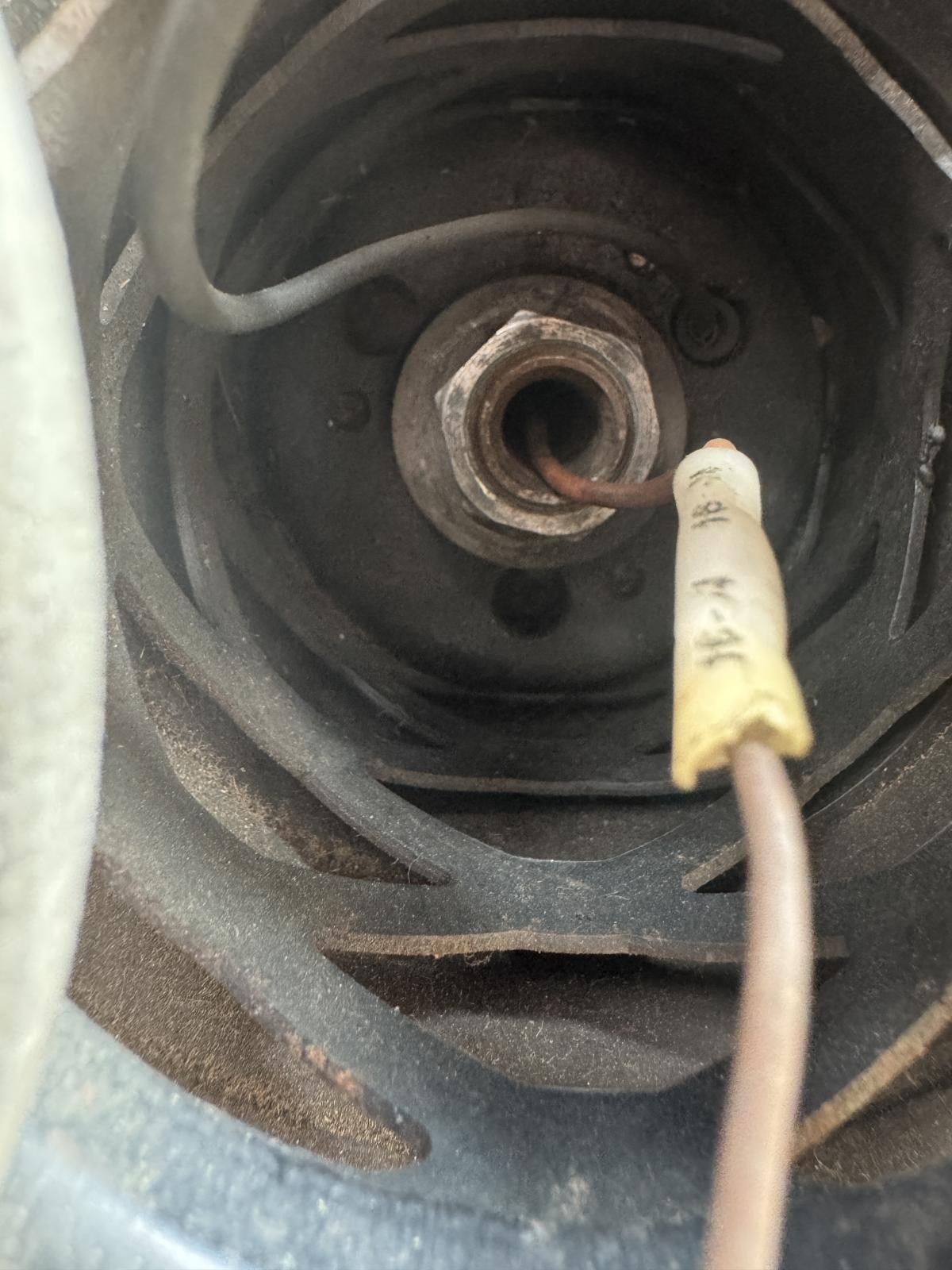

My '68 came with a steering wheel from a '72 or '73 I believe, so it's one of the first things I'd like to change out. I'm just unsure as to which style would be the correct one. I've seen many peoples 1968's with the horn ring, and without the horn ring. Was there a determining factor when these were built? Mine was built in Oct of '67 for the '68 model year in Germany.

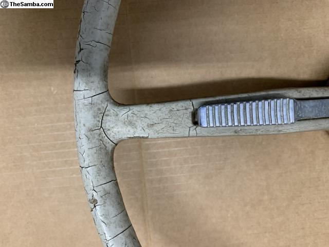

This is what a '68 steering wheel would look like when new:
From '60 (I believe) - '66 they looked like this:
I've seen the earlier style horn ring used on later steering wheels and visa versa. That said, you will be unable to use either of these stock steering wheels on your bug because you have a '72 - later steering column ... which is a different animal. Personally I don't care for the appearance of the '72 - steering wheel and would want to change it out as well. Unfortunately you'd need to select an aftermarket style with an adapter. There are a variety of styles to choose from, but none look like the stock '68 wheel.

lots of this info here too .
if you want the horn ring this is what to look for
if just the bar look for this

you will be unable to use either of these stock steering wheels on your bug because you have a '72 - later steering column ....
I don’t think the seller swapped the steering column. Just the wheel.

I may be wrong but I think the 72 and newer columns are different and the earlier wheel will not work with the later column. Someone else please weigh in on this to fact check me-thanks Bob
I’ve sent him a text message to confirm.
ETA: I just confirmed that the steering column is what the car had. FWIW, the steering wheel is held together with electrical tape at the moment. So unless the splines are completely different, it’s been rigged to work.

PostPosted: Fri Jul 04, 2025 2:42 pm    Post subject: Re: Which one is the correct steering wheel? Reply with quote
I looked into this a few years ago with several sources. I was told that the splines were different and one could not put an earlier steering wheel on a '72 - later bug and that no adapters are made that would make one work either. The only option if you REALLY wanted the correct stock steering wheel was to change out the column. If that is the correct steering column for a '68, it would be interesting to see how the PO got the later steering wheel to work on it.
Did the car have the correct-for-'68 steering wheel on it before the later style stock one was put on ... or did the later stock one replace an aftermarket wheel?
BTW ... none of us are trying to rain on your parade. Just hate to see you go to the time and expense of trying to get the earlier stock wheel on that column if it is designed for the later wheel.

In the meantime, you could get one of these. Trust me, neither you nor anyone else will notice the late style steering wheel. Wink

Try to get the correct column with a key. You can probably have the existing column out and the replacement installed in about 2 to 3 hours. I have seen them for sale in the samba classifieds. Or if there are any wrecking yards near you there may be a bug in there you could pull one from. 68 to 71 should work. There was a 70 in the pick and pull near me about 1 month ago but it's gone now. Good luck-Bob

.I think you are getting some bogus information. The splines didn't change until 74. A 72 wheel will fit on your 68 just fine, a 68 wheel will fit on a 72, but it will hit the column mounted wiper switch.
