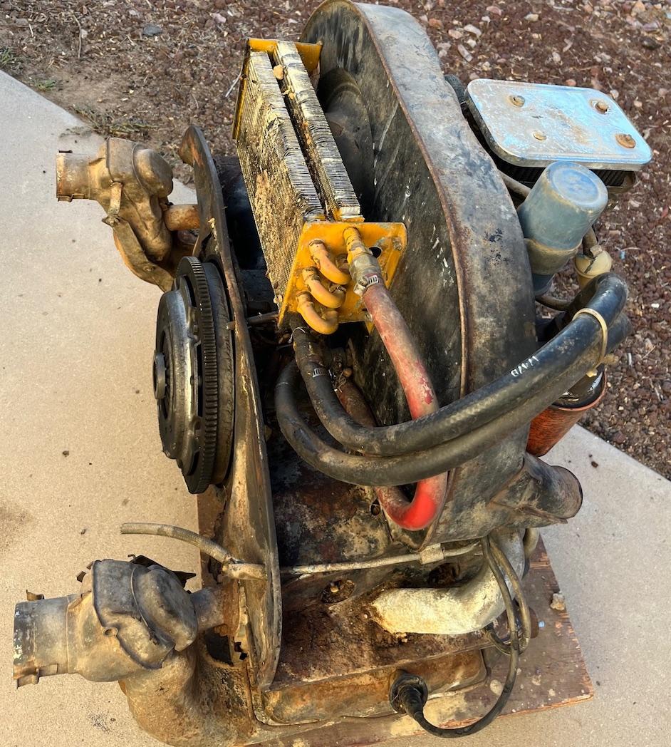

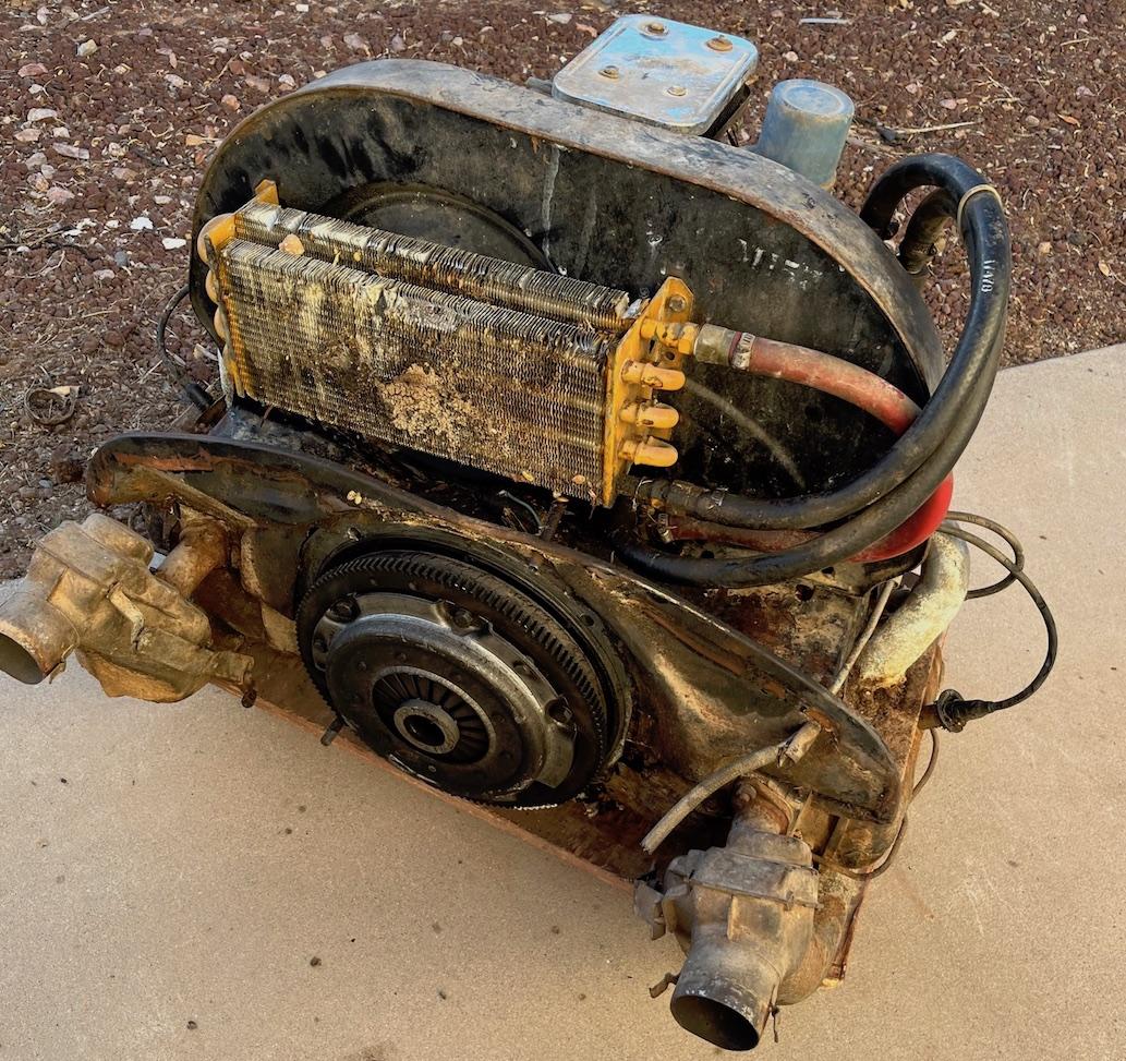

Its out! It came out easier than I expected. Advice from tasb of taking a wheel off saved 6 inches of jacking. Everyone's comments helped:) That's my buddy Jim cleaning it Smile
Is that a stock VW clutch? It doesn't look like the ones I usually see on YouTube. All that oil cooler stuff will come off. Anyone want to trade a stock oil cooler for it? A bunch of white stuff came out of that exhaust port when I pulled it (still on the car)). It doesn't look good. Thoughts?

That is the early style clutch with the ring in the center which uses the early release bearing. In the 70s they removed the center ring and redesigned the release bearing. Glad it worked out for you. Bob

mercsim wrote:
I've got that same type oil cooler on my 1835cc DP engine (Phoenix) since 1976, and I've been happy with it, keeps #3 and #4 cooler.
My rubber oil lines started to seep a tiny amount of oil after 31 years, so advise to install new hoses every 30 years.

Cusser, would you advise continuing to use that cooler even with all that fin damage?
No, I'd get a new cooler unit, available separately. Example: https://www.jbugs.com/product/9243.html
I made a slip-over sheet metal guard for my oil cooler, I place it over the cooler before I remove the engine to protect it, and leave it on for the engine install. I don't have any photos of that guard at this time.
