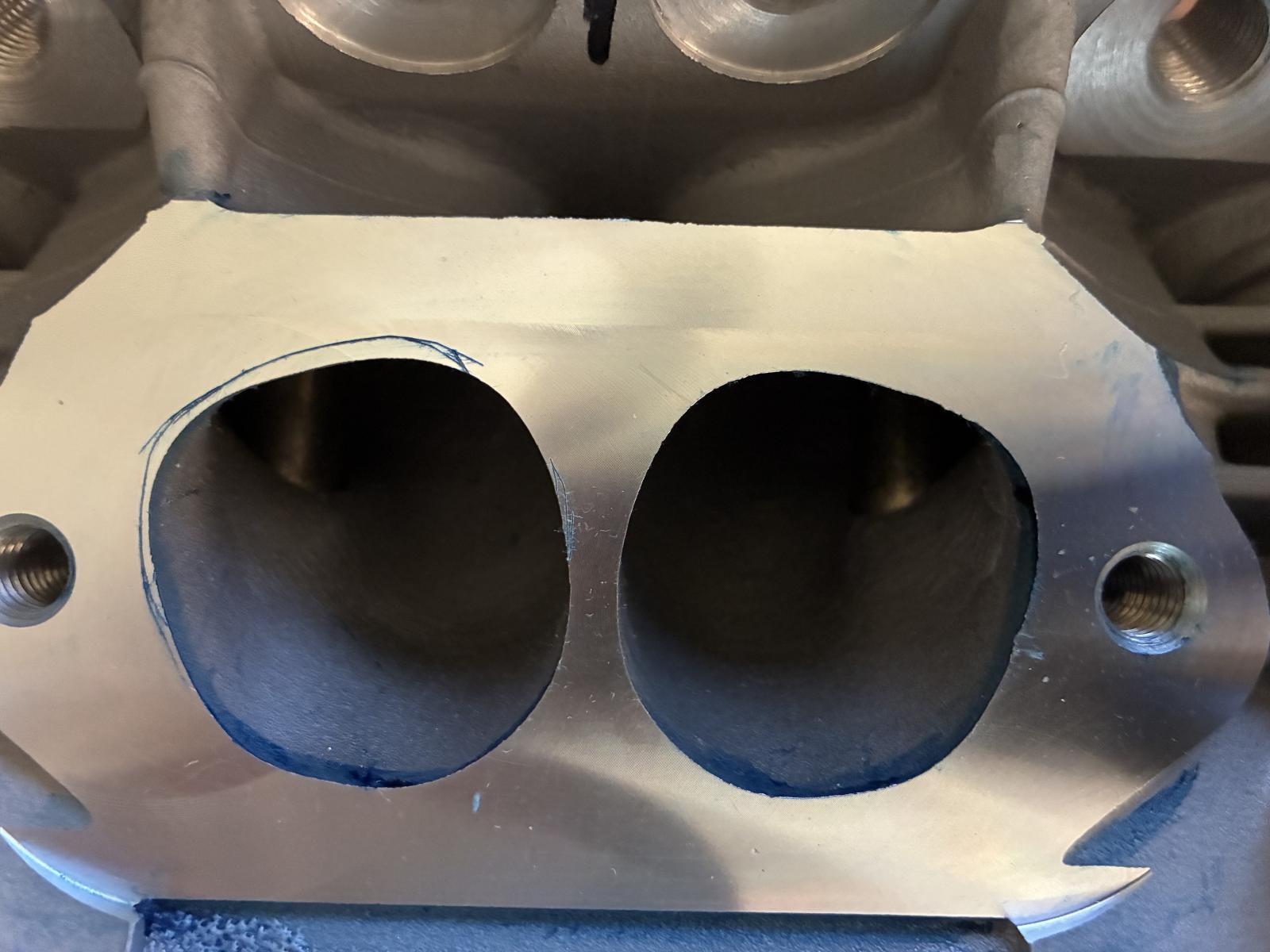

Worked on match porting my intake manifolds and got a little wild with the first one. The scribe line is where I blew out the manifold a little beyond the head port.
This is only about ~ 035", maybe .040", but that seems to be a little bit too much of a step into the airflow. I don't trust epoxy to stay put so would rather not build up the inside of the manfold and re-port. If the epoxy comes out it would be disastrous.
So, should I just run it as-is or should I relieve the port out to the manifold and blend a tight radius back into the port? It could be either cylinder #2 or cylinder #3, depending on how I assemble it. I plan on making it cylinder #2 because it has slightly higher compression and, splitting hairs here, would be better suited to compensating for any velocity loss from relieving the port a little.
The other manifold came out just about perfect.

Best thing to do is make the other 3 holes all match that one.
That spot is about the best spot you could be removing material. Just make it a smooth radius between the two.
That port shape is a little tough to make proper manifolds for. Spend your time extending the shape up higher up into the manifold. Try to keep the cross section consistent.

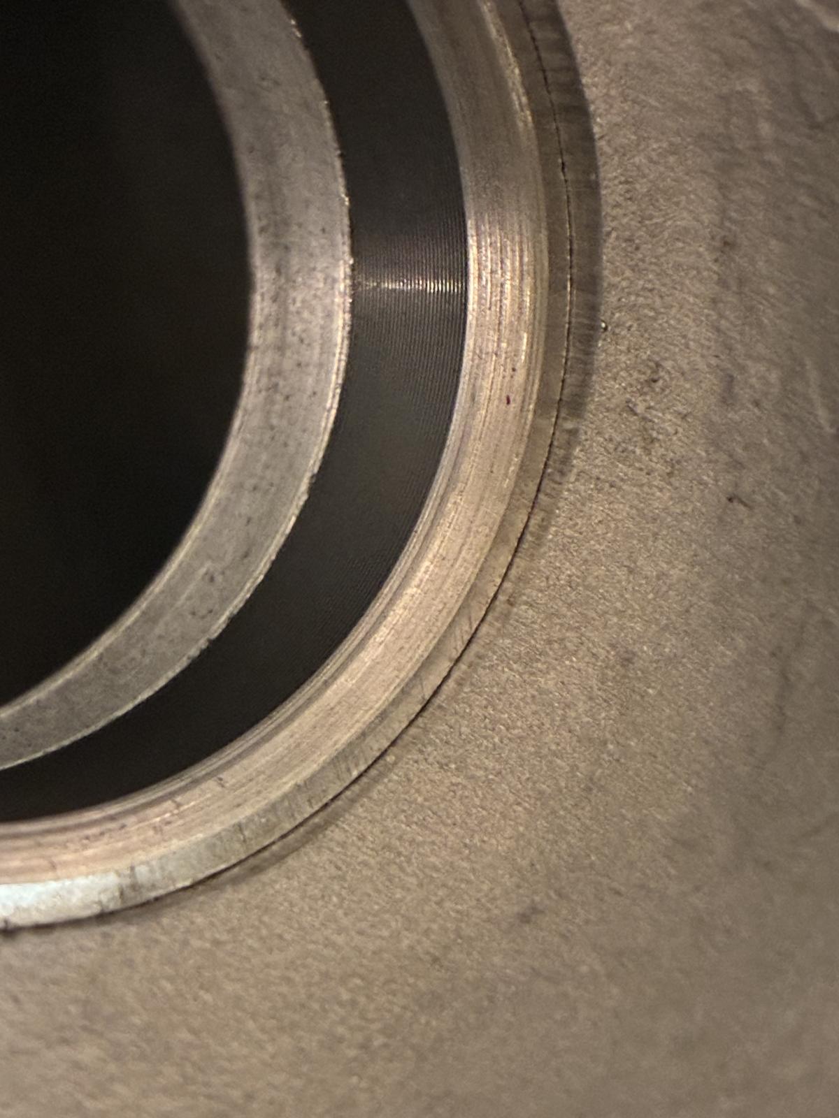

Ok working on a template to port the intakes - filled the voids in an FI end casting spacer with epoxy and am waiting on it to dry out so I can match it up to the ports and transfer the shapes to the heads and manifolds. Should have done that in the first place rather than depending on prussian blue markups and a not so steady hand...

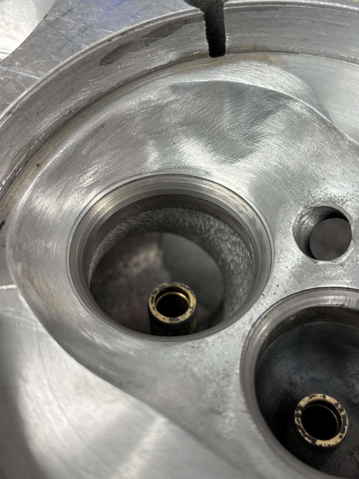

Now on to the heads - I have one of them broken down to look through the ports, and as far as I can tell AA must have been listening to Brian because there's no step under the guides and you can see where the port shelves were cut off flush with the valve seats:
I can maybe see doing a minor cleanup to those sprial cuts with a cartridge roll but not much else, as far as I can tell.

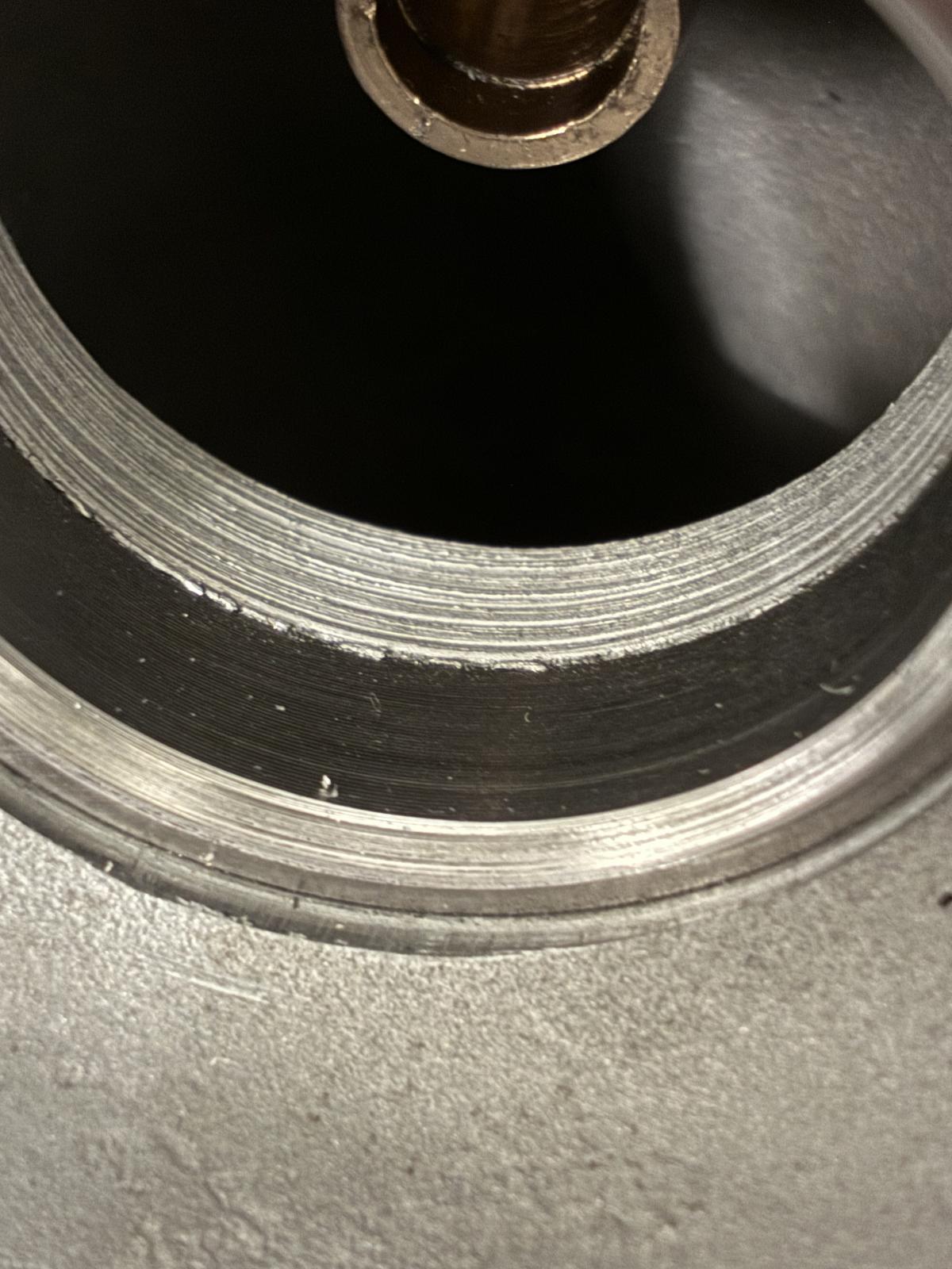

The pics with the flashlight show how the seat fits up to the port. The long turn into the exhaust looks completely unobstructed. I don't think any material needs to be removed here. The short turn into the exhaust port is a pretty sharp "corner" but not sure that needs to be touched at all. Should I radius it a bit or just leave it the hell alone?
There is a bit of a step between the tops of the valve seats and the combustion chambers, should that be flattened off/blended in?
Seat cuts are single angle ~ 45*
And we knew the valve job kinda sucks out of the box; valve seat right down the middle and a little wide:
Those dual valve springs are no laughing matter to compress! First time I've had dual springs.
Should those intakes be back cut when it goes out for a valve job, or does that transition look ok?
Overall I'm rather impressed by the ports under the seats as delivered. Am I close to seeing this right?
Again any input is welcome!!

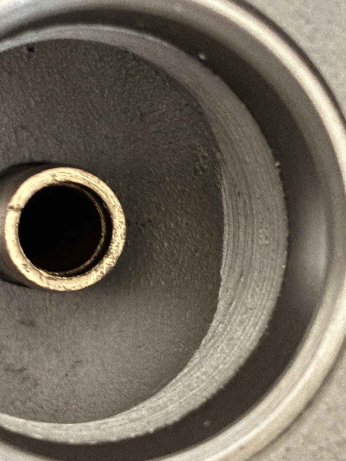

On your heads, the smooth transition from the seat insert into the material just below the seat is a standard bowl hog cutter. It’s the material right at the end of the bowl hog cut that needs to be worked on. That ridge from the cast port to the machined ridge from the bowl cutter needs to be smoothed out.
The port just below the insert needs to carry the ID of the seat insert down into the port. Both intake and exhaust. If you have a snap gauge you can set it at the smallest diameter the ridge and compare it to the ID of the seat insert. That is usually a good indicator. It should be nice and smooth, and the same ID from the seat cuts to about 3/4” down into the port.
These are pics for the 502’s I did. These are the ones I listed the flow numbers from.

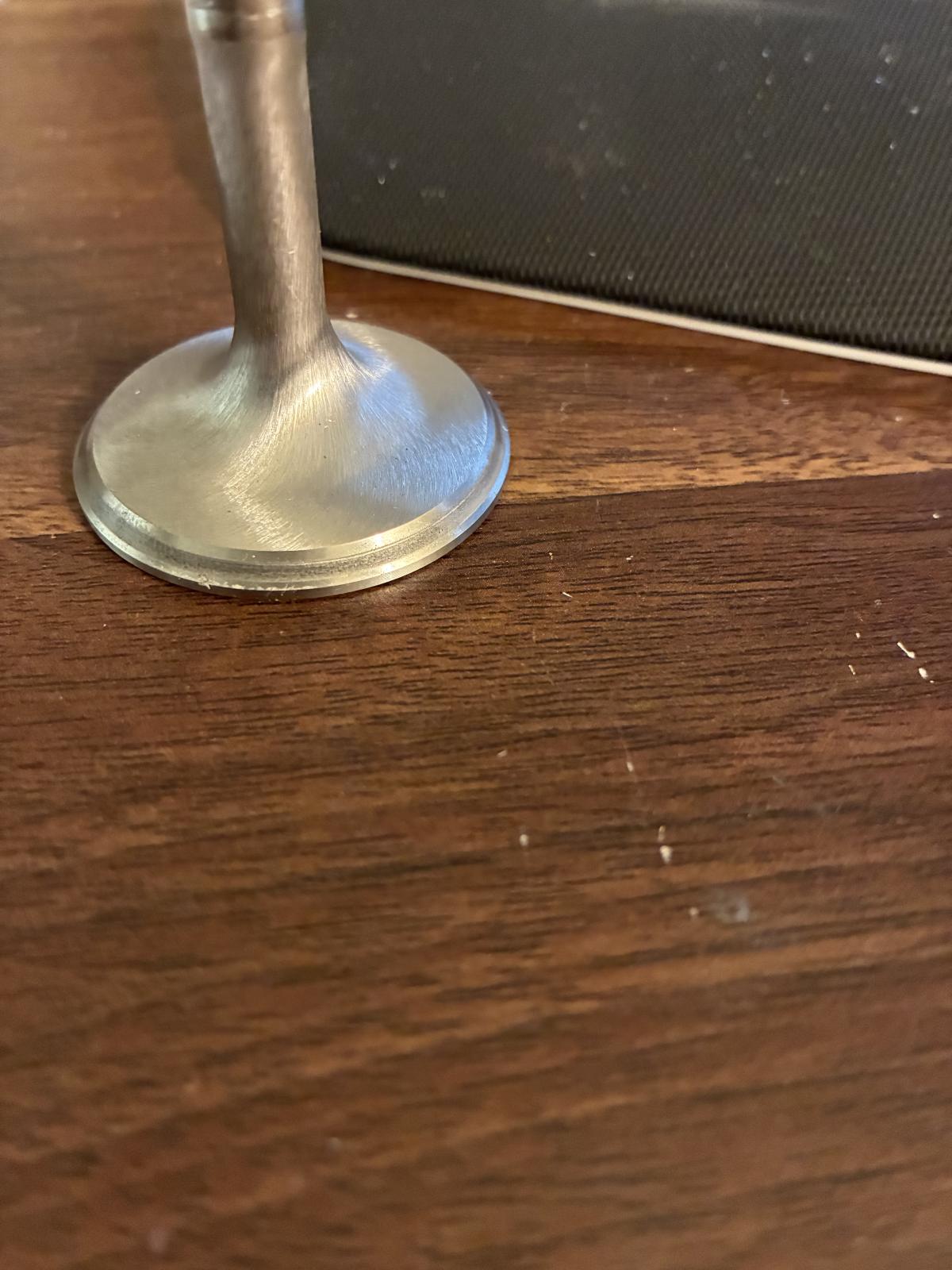

I would have the shop do a 30deg back cut on the intake valves for sure.
This is what my lapped valve with a back cut looks like after my seat cut.

Copy on the back cut. I'll definitely have that done.
The above pics of the ports are as-boxed. The lighting has the contrast between the bowl cutter marks and the casting itself grotesquely overexaggerated. Sticking a finger down there, one can barely feel the transition. I've since cleaned that up a bit and gotten the transition even more smooth. In all honesty I was expecting a lot more cutting and cleanup to be needed based on some of the pics I've seen of other people's panchitos they've posted up.
Based on your postings on other threads, I also relieved the sharp corners in the exhasut ports on the short side. Not too much material removed, just enough to break the sharp corners.
That said, I'll pop the valves back out, have another peek in there, and double-check before I take the heads over. I'll use your posted pics for comparison. And a snap gauge to measure the diameter. If it stlll needs some more cleanup I'll get it done.

The side walls in the exhaust ports are what usually need the most work. The bowl just under the seat is too big on most heads, so it opens up quick. This is the same spot on panchitos that is really tight.
The sharp inside corner on the short side of the exhaust has a very minimal effect on flow. I leave it as big as possible to support the valve seat. I only knock the sharp corner off a bit. Lots of people go WAY over board on that sharp corner.. The air just blows right past that corner and mostly flows the side walls. There is no amount of radiusing that could get the air to stick to that turn.

I think I got it.

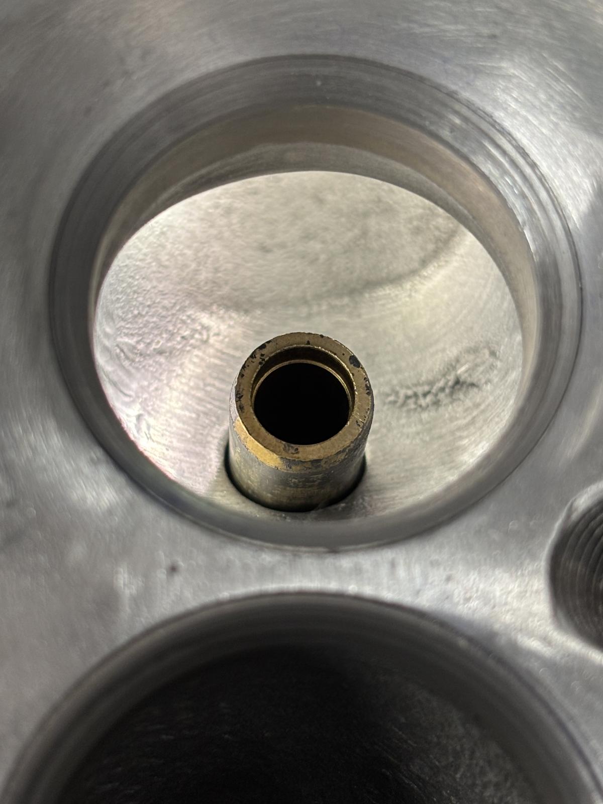

Couldn't find my snap gauge set right off hand so I used this to check the valve seat and bowl diameter on all 8 valves:
I did need to remove a bit more material. Now the diameter holds down the valve seat, into the bowl, and into the turns without getting tight and without loosening up either, except in one small place where the casting was always a tiny bit little wide. I don't want to take any more material out from anywhere.
While not perfectly consistent in texture like in your pictures, there are no ridges left from tooling, no shelves protruding out from under the valve seats, and some of the more intrusive casting flash was ground flush to the port walls even if that doesn't actually do anything productive. Probably all I can do without a flow bench, more tooling that I may not ever use again, and a lot of experience that I simply don't have. I think any more and I might start going backward.
I really appreciate your coaching on this. I'm pretty happy with where it is. Off to get the valves ground tomorrow!
