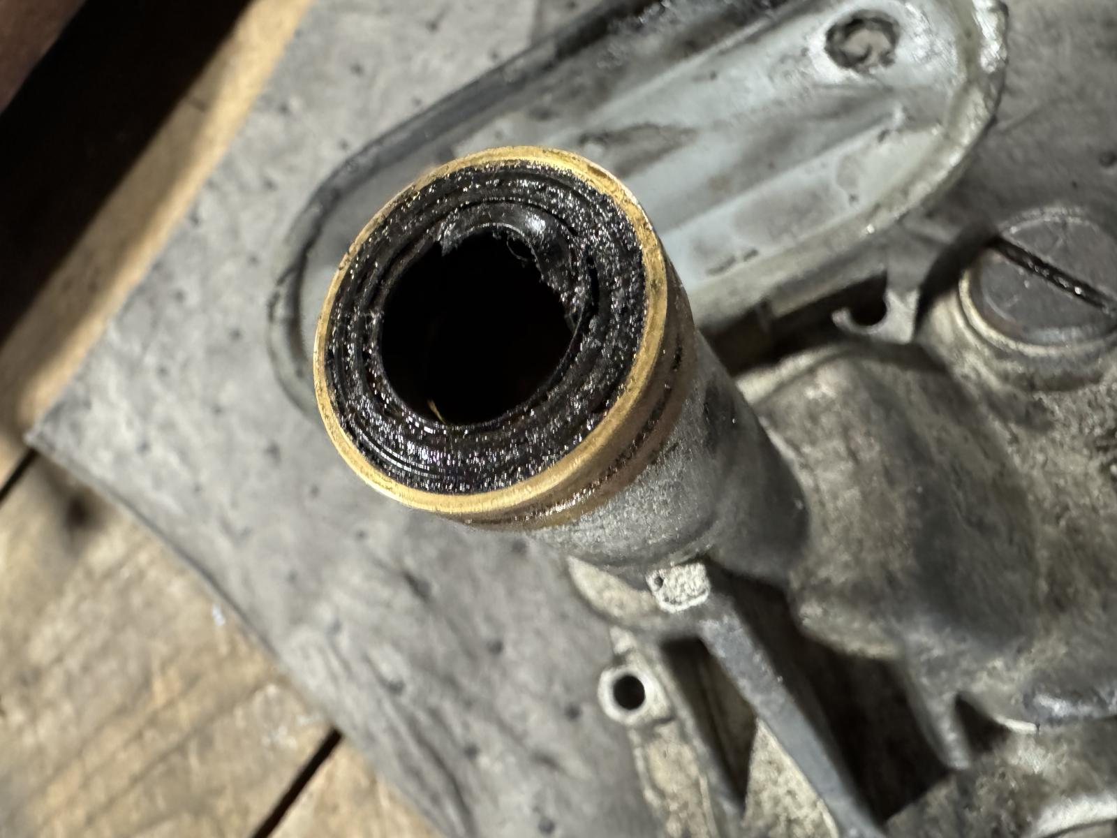

Back on this:
I believe this is the last system that we haven’t looked into and, as you might expect, it seems the PO left his mark here as well:
The first axle bearing (driver’s side) seems to be functioning as expected while the passenger’s side bearing spins freely and seems to not be fully seated in the housing.
Thoughts? What’s a novice mechanic to do?

PostPosted: Sat Jul 05, 2025 5:32 am    Post subject: Re: '59 Karmann Ghia fever Reply with quote
So I am wondering what caused that transmission fluid to leak on the driver’s side. I thought it was the boot but upon inspection it seems intact. The large o-ring, although I have yet to remove it, also does not seem to have any issues. The one thing that is odd though is that there seems to be a single paper shim. Perhaps it is two stuck together but I am suspicious that it was of an insufficient thickness as the axle simply flops about. I believe there is supposed to be some resistance?

PostPosted: Sat Jul 05, 2025 8:53 am    Post subject: Re: '59 Karmann Ghia fever Reply with quote
Have a looks at Pete's YouTube videos on Swing Axle Installation Parts 1 & 2
John.

PostPosted: Sat Jul 05, 2025 10:49 am    Post subject: Re: '59 Karmann Ghia fever Reply with quote
Thanks John! As you might imagine, I have been voraciously consuming YouTube videos on the subject. I have yet to find these though.
As I circle around our current project (and now I have ChatGPT to consult, albeit cautiously), it is my current understanding that the axle shaft should be dry. It is wet along its entire length! Further there is pooling of gear oil in the housing. The conclusion to draw from this seems to be that the inner axle seal has failed. It also seems to be the case that this can occur if the paper shims are not of the proper thickness. Sigh… I have yet to measure but I have yet to see a single case where one such shim is sufficient. Seems as though someone thought is was simply a gasket and, well, why waste another?
So it looks like we have to dig deeper. Gotta find a puller for this bearing…
[edit] Well it seems that the axle is indeed supposed to be wet in a swing axle setup—
From Rod and Dave:
If you have a swing axle, the bearings are harder to get out as you need an "inside" puller to grab the inside of the outer bearing race (after removing the cover plate inside the brake assembly of course). The only other way to get this off is to remove the whole axle and axle-tube from the car and tap the gearbox end of the axle so it pushes the bearing out of the outer end (using the axle itself to push the bearing out). The bearings are not really tight in the tube - just nothing to grab on to to help remove them. Once again, when taking the brake assembly off the spring plate - make sure you mark them so you can re-align them on re-assembly. There is a "v" notch in the top of the brake hub assembly to help you with this - just make a mark on the spring plate next to it.
These bearings use oil from the gearbox which sloshes up the axle tubes and sits behind the bearing. Low oil in the gearbox can therefore cause dry wheel bearings (the gearbox must be filled with 80w90 or 85w90 Hypoid Gear Oil until it runs out the filler plug in the left side of the gearbox).

PostPosted: Sun Jul 06, 2025 5:21 am    Post subject: Re: '59 Karmann Ghia fever Reply with quote
Okay, passenger’s side opened:
I was surprised at the emptiness found haha!
Also, have finally discovered the number of the transmission:
Nose cone is next, then a parts list for sealing this all back up again.

PostPosted: Today 12:43 pm    Post subject: Re: '59 Karmann Ghia fever Reply with quote
Such slow going.
So it seems likely that the nosecone seal might have been the reason I had to pull the transmission — transmission fluid was leaking from that general vicinity and it was not intact.
Of course, the seal that came with the kit is not the right one.
Found the right one on JBugs. Another shipping charge, another week.
