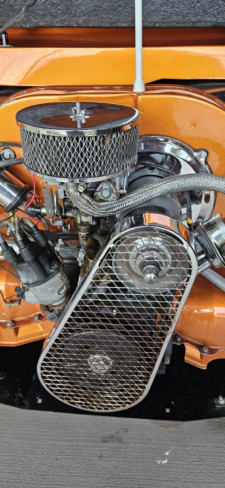

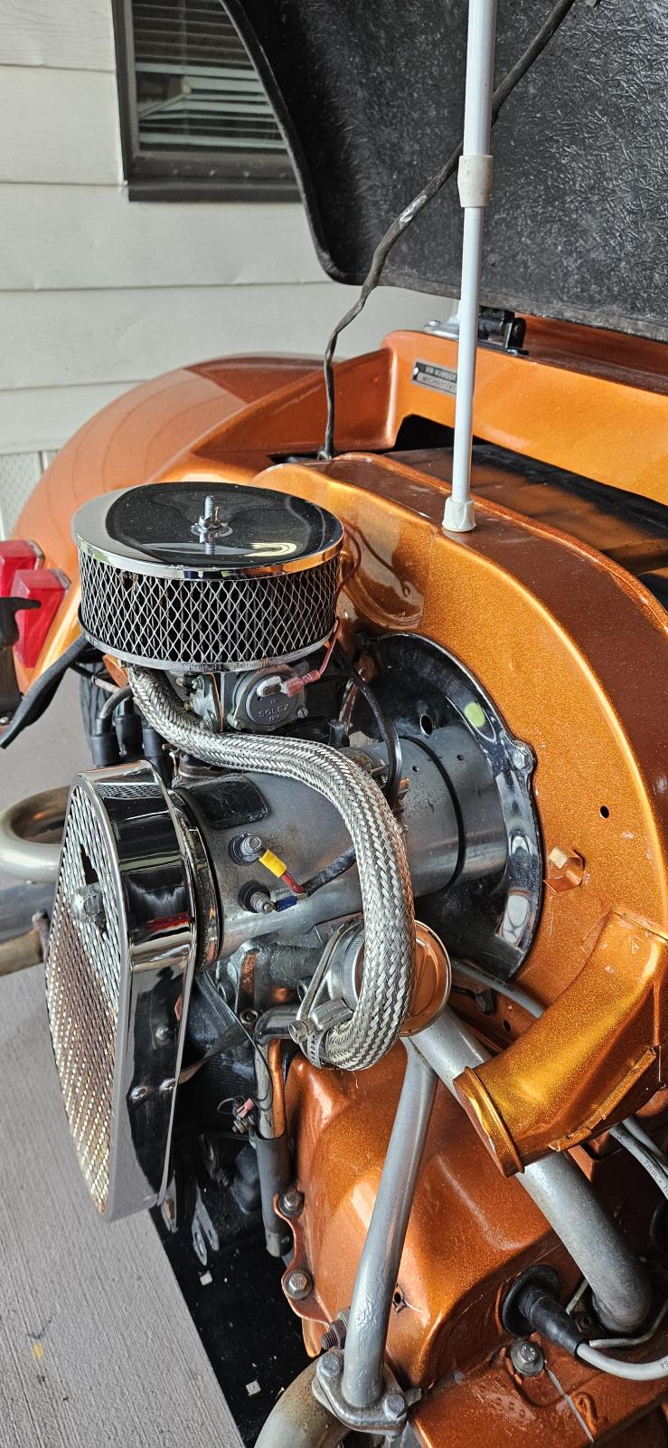

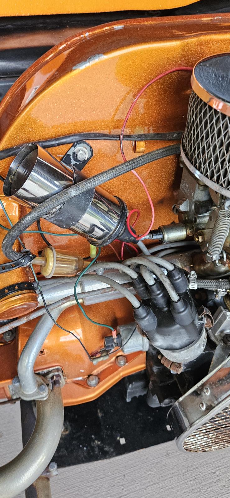

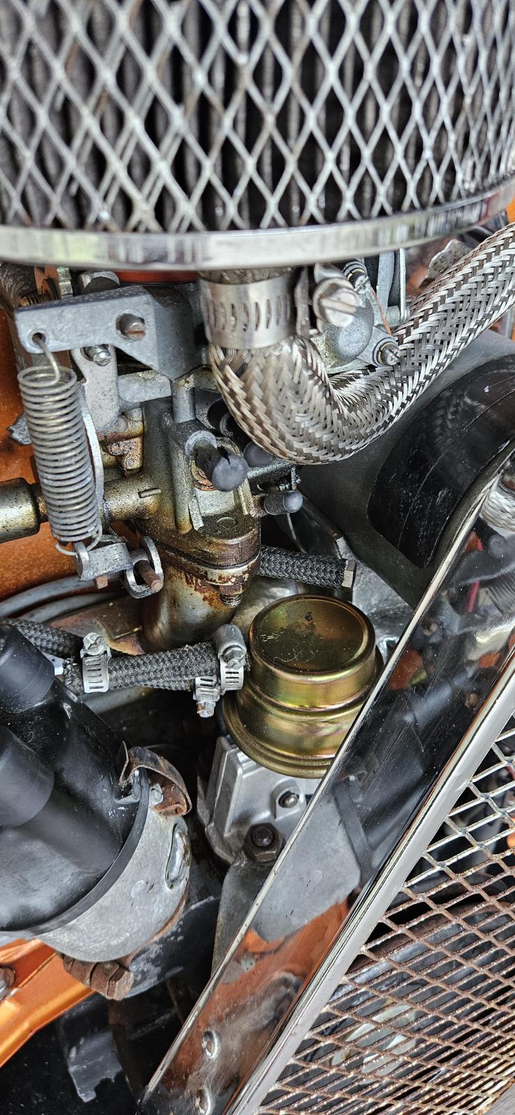

As jinx suggested, a systematic troubleshooting process is needed. Replacing parts without a confirmed reason to do so can get expensive and actually complicate the problem given the generally poor quality of many aftermarket parts and assemblies sold today. Posting several photos of the engine is a big help. It allows us spot things that are amiss that we otherwise wouldn't be able to point out.
