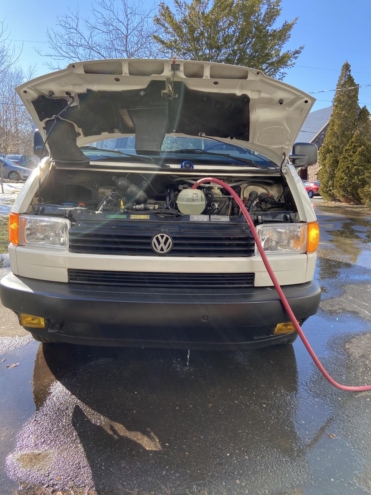

A little bit lame to merit a DIY but, too bad..here goes.
G12 coolant is advertised as lifetime, but I change every 4-5 years (low miles on my EV, like 3k per year.)
This is a really nice coolant change.
Cold engine
Drop 4 M6 bolts to lower engine pan
Up high, left side of engine, is a coolant drain plug which unscrews by hand. Its got a nice o-ring seal which pops into the a seal groove.
Drain coolant into bucket.
Now put hose into reservoir and turn on
Check flow through drain port
Start car, let run for 30 minutes with water coming from both drain port and overflow reservoir. Resist the temptation to surf Samba while you are doing this, in case the hose flops out and you then burn up your EV.
I added 4.0 of VW G12 coolant after replacing plug, then it took 4.0 liters of water to top off I calculate the dead volume of 1.0 liter for a total freeze protection to -15F
All data told me to run the car at 2000 rpm for 3 minutes and then recheck level - I found no change. I took it for a highway spin of 10 minutes and found no change.

Thanks. My coolant overflowed recently when the belt tensioner pulley froze and shredded the belt. Need to refill. Since I had a reman engine installed only 1k miles ago I'm assuming I don't need to do the flush part.
Want to make sure I understand. I should start the van while the hose is running only water into the cooling system? I guess this means there's no overflow until the system is filled with water. Makes me a little nervous to start the engine with the system open.

Yes, this is to flush. Run the wate r until it fills before you start..takes about 20 seconds. Make sure you have water coming from the drain plug and coming out of the top of the reservoir to flush. Idle speed only.

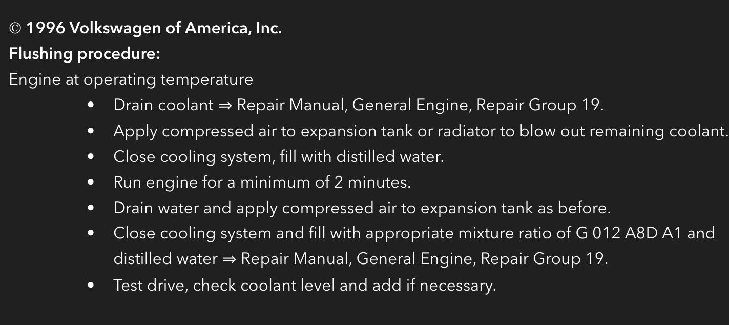

Here is the VW procedure for flushing coolant:
