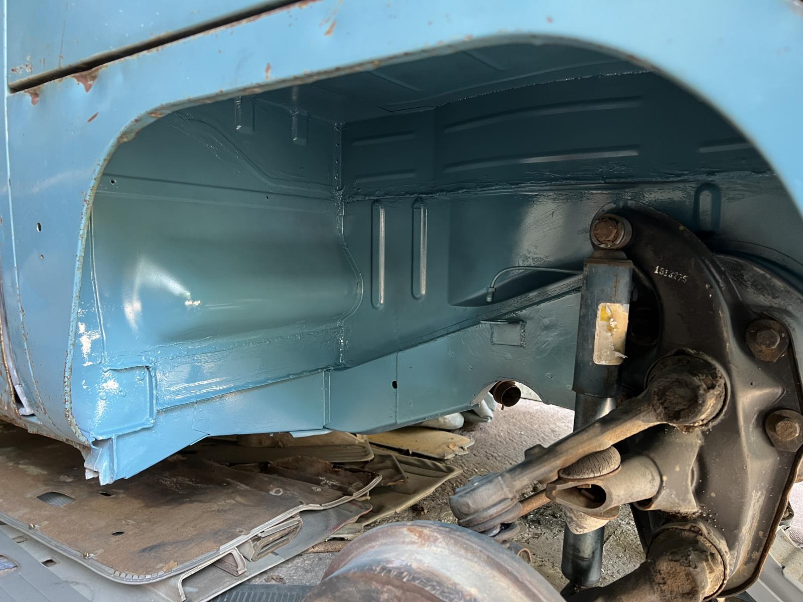

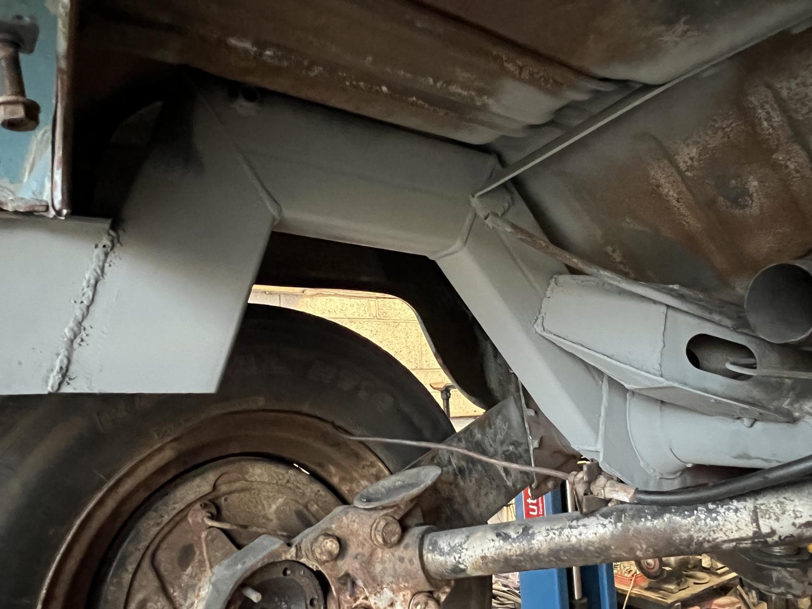

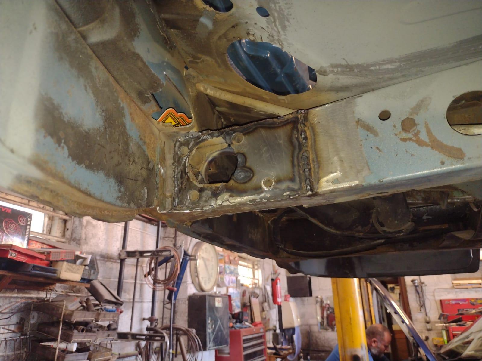

Chassis repairs and battery tray
sparkywig
Joined: July 26, 2008
Posts: 170
Location: Bristol, England
sparkywig is offline

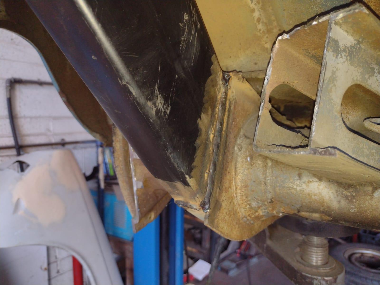

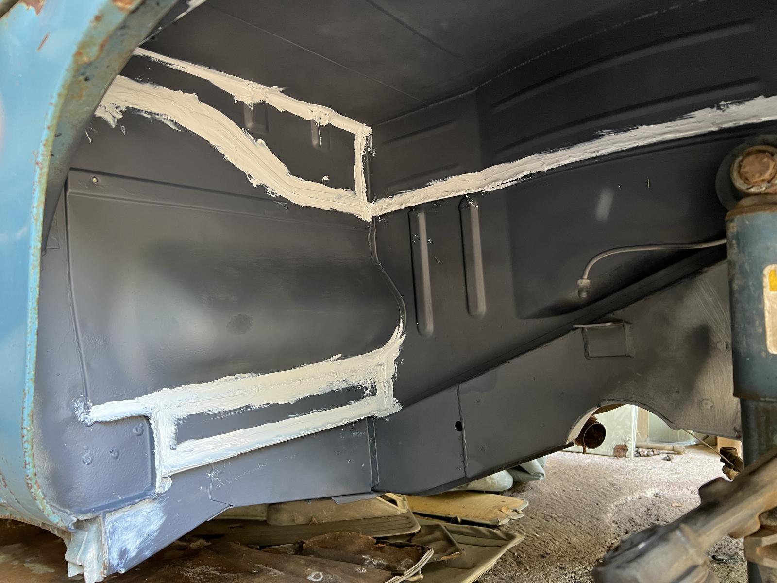

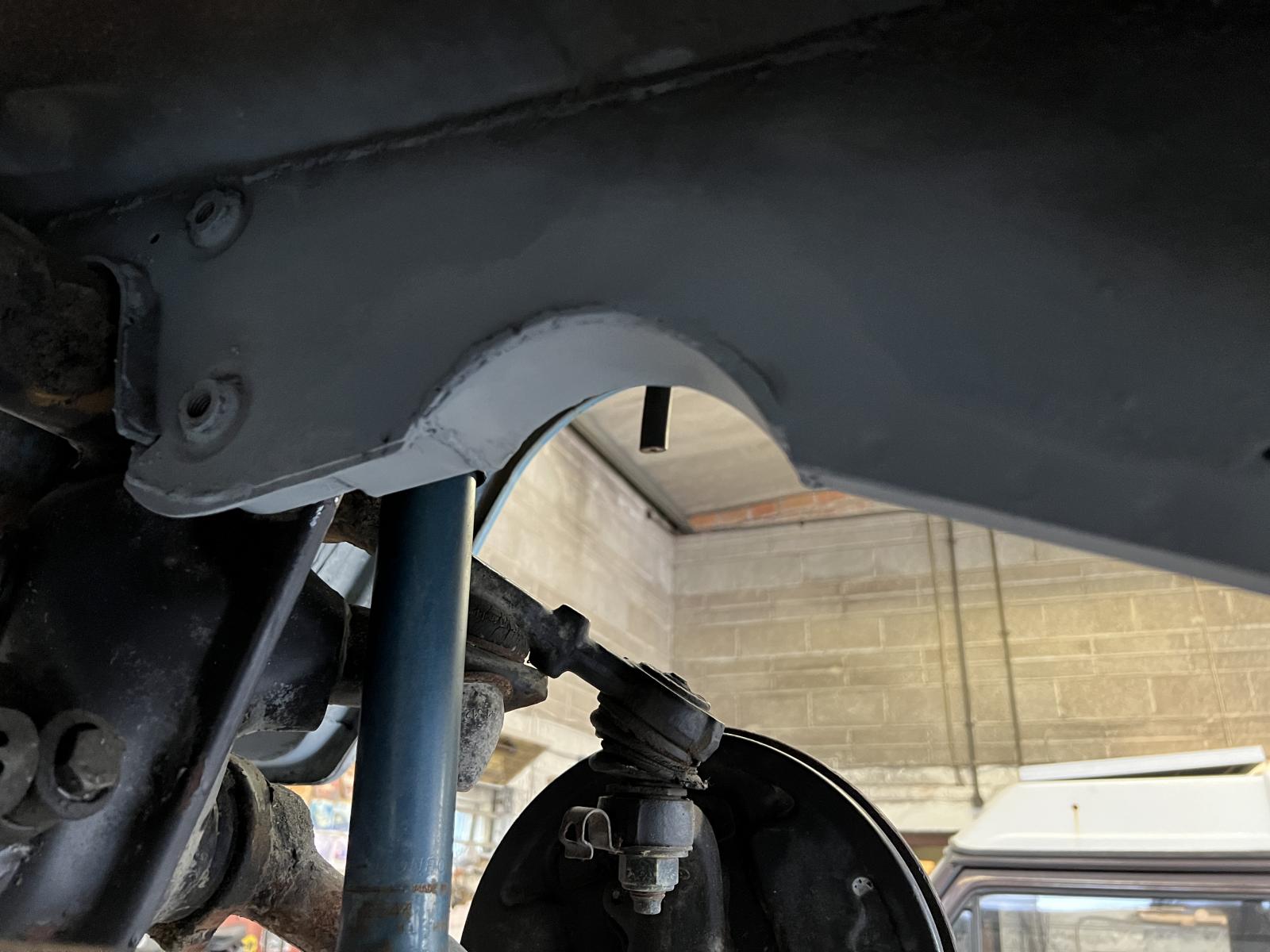

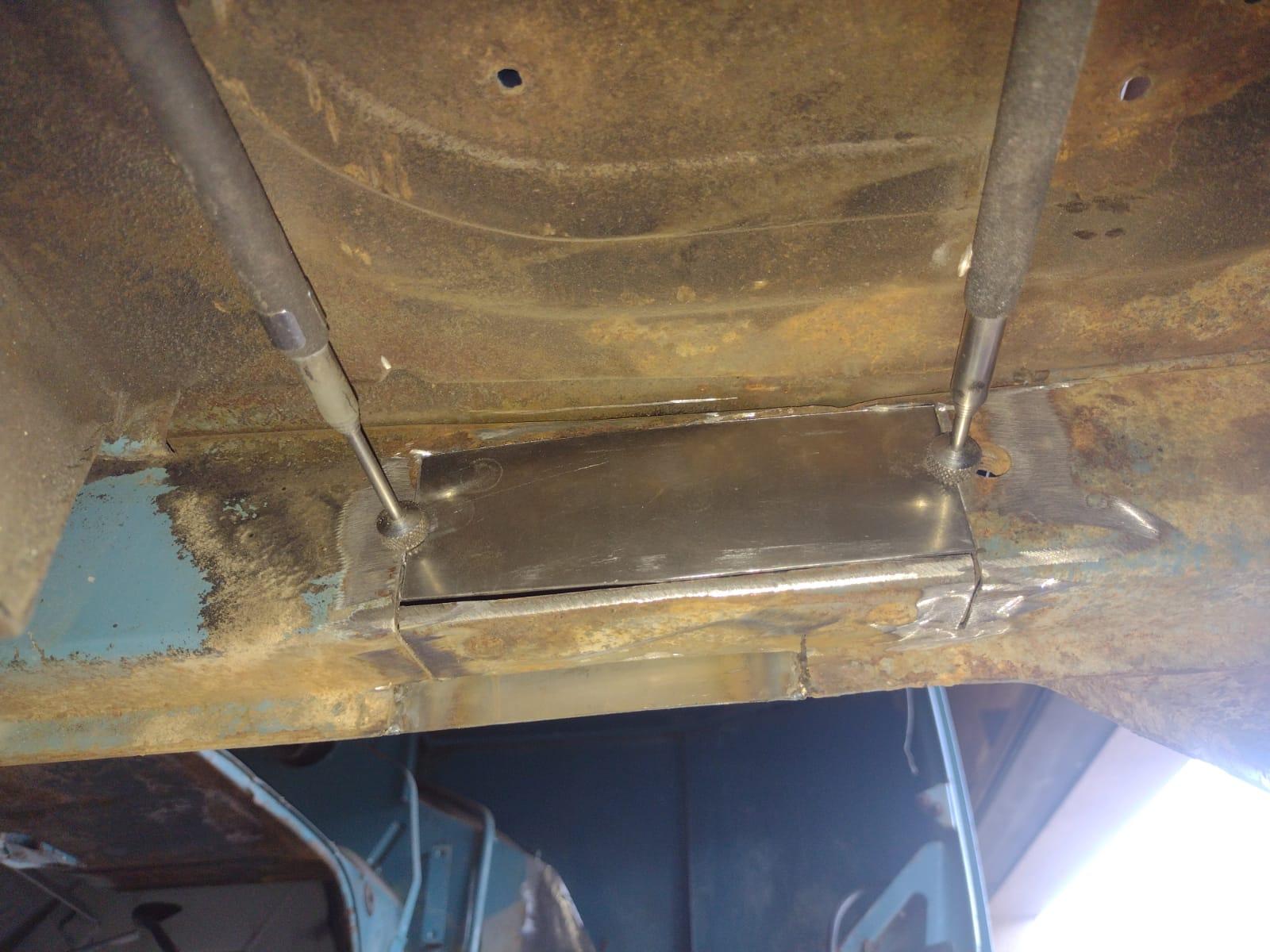

PostPosted: Sun Jul 06, 2025 3:04 pm    Post subject: Re: Sept '67 (1968 MY) deluxe, another Blakes Bus Reply with quote

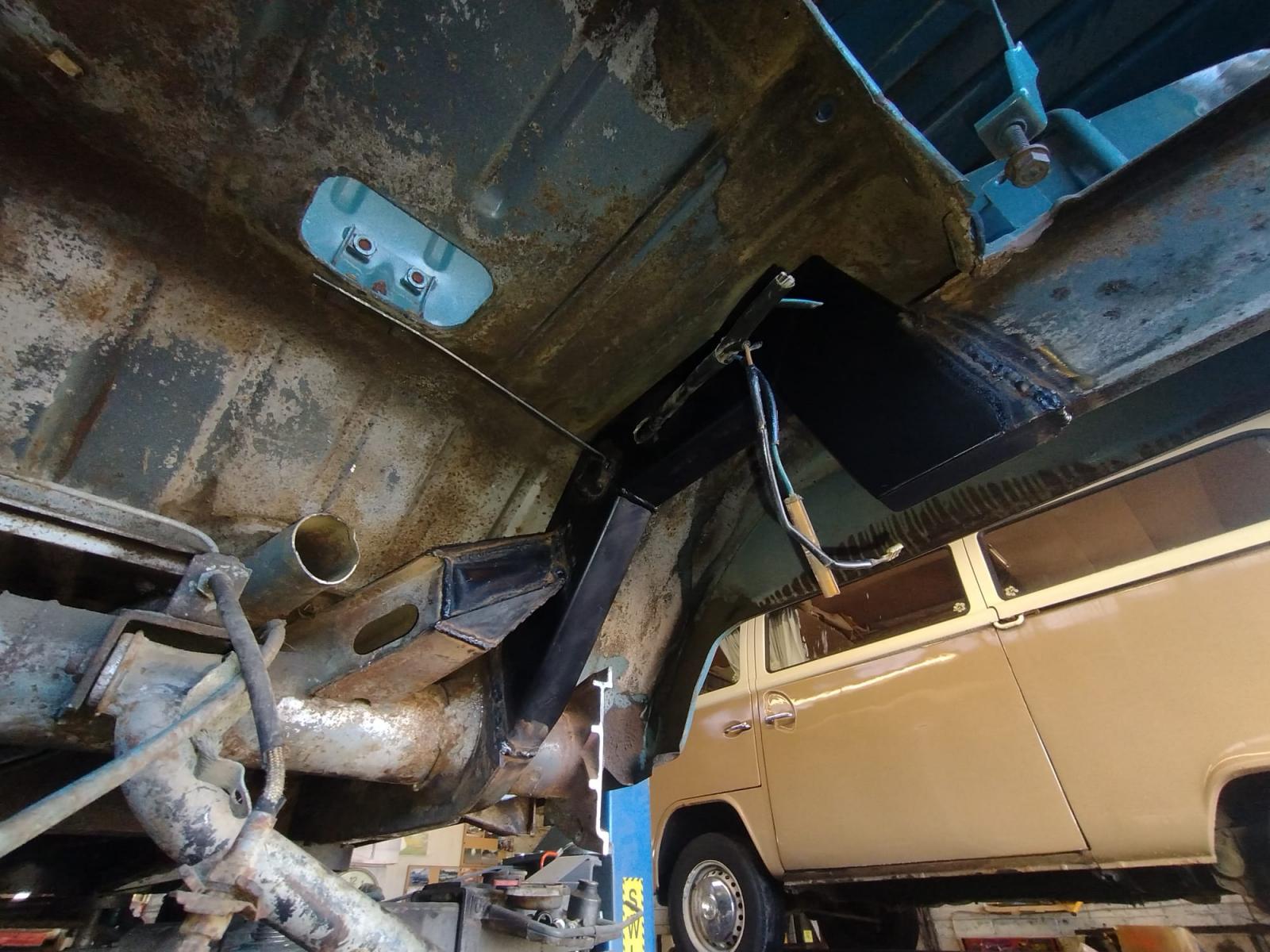

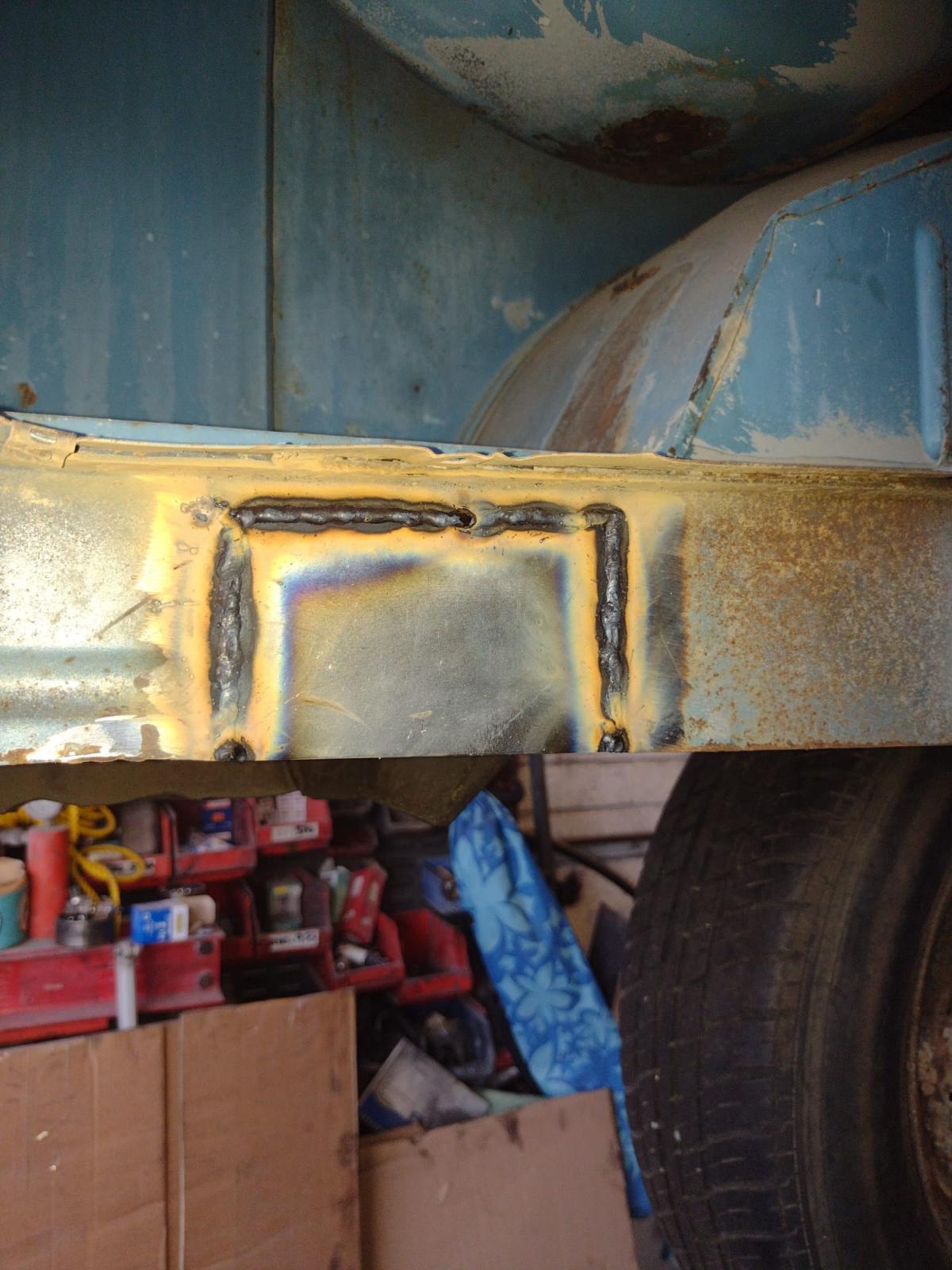

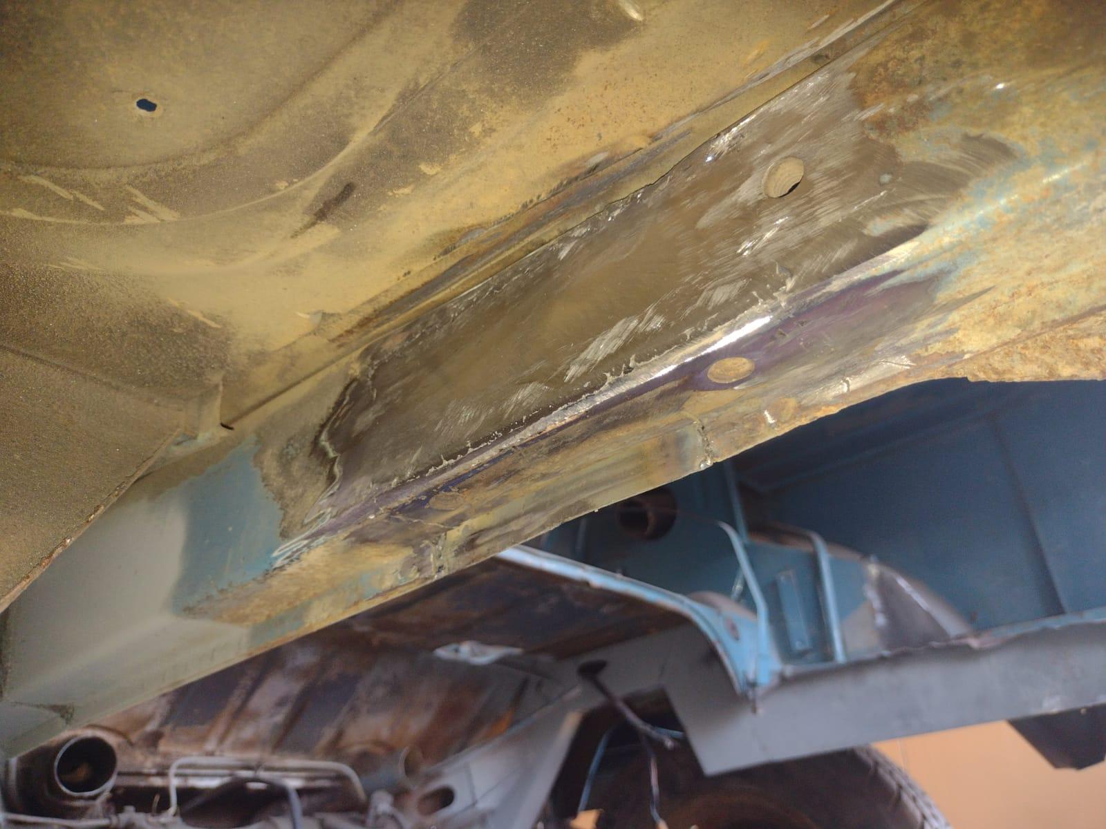

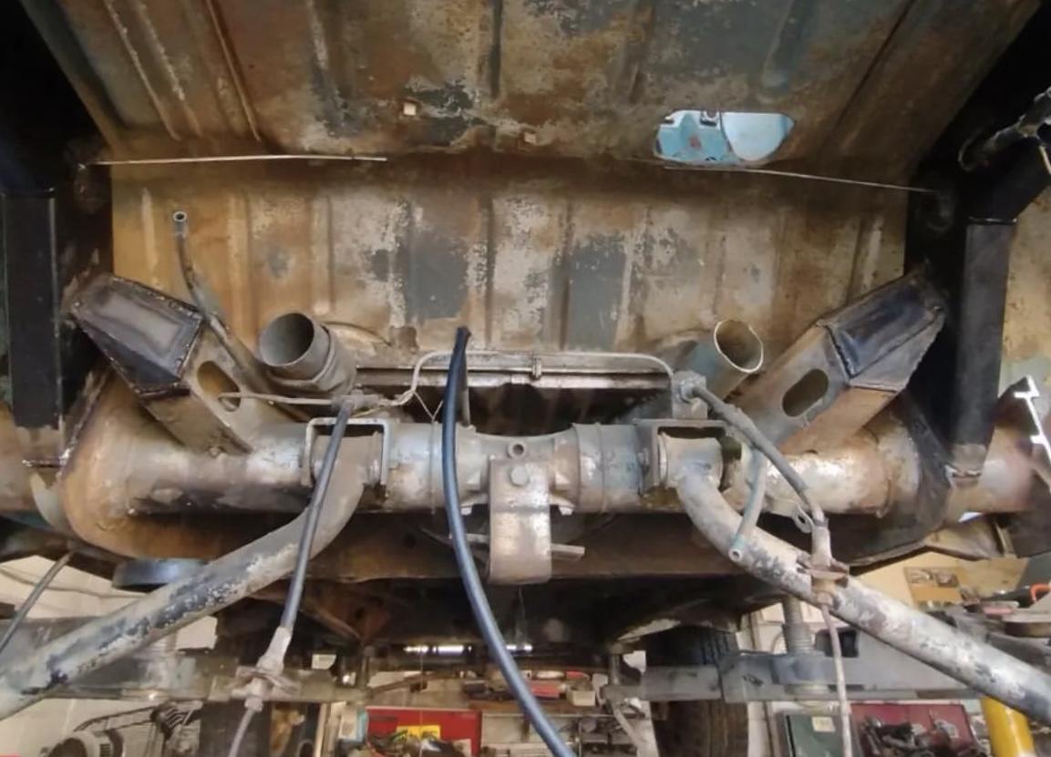

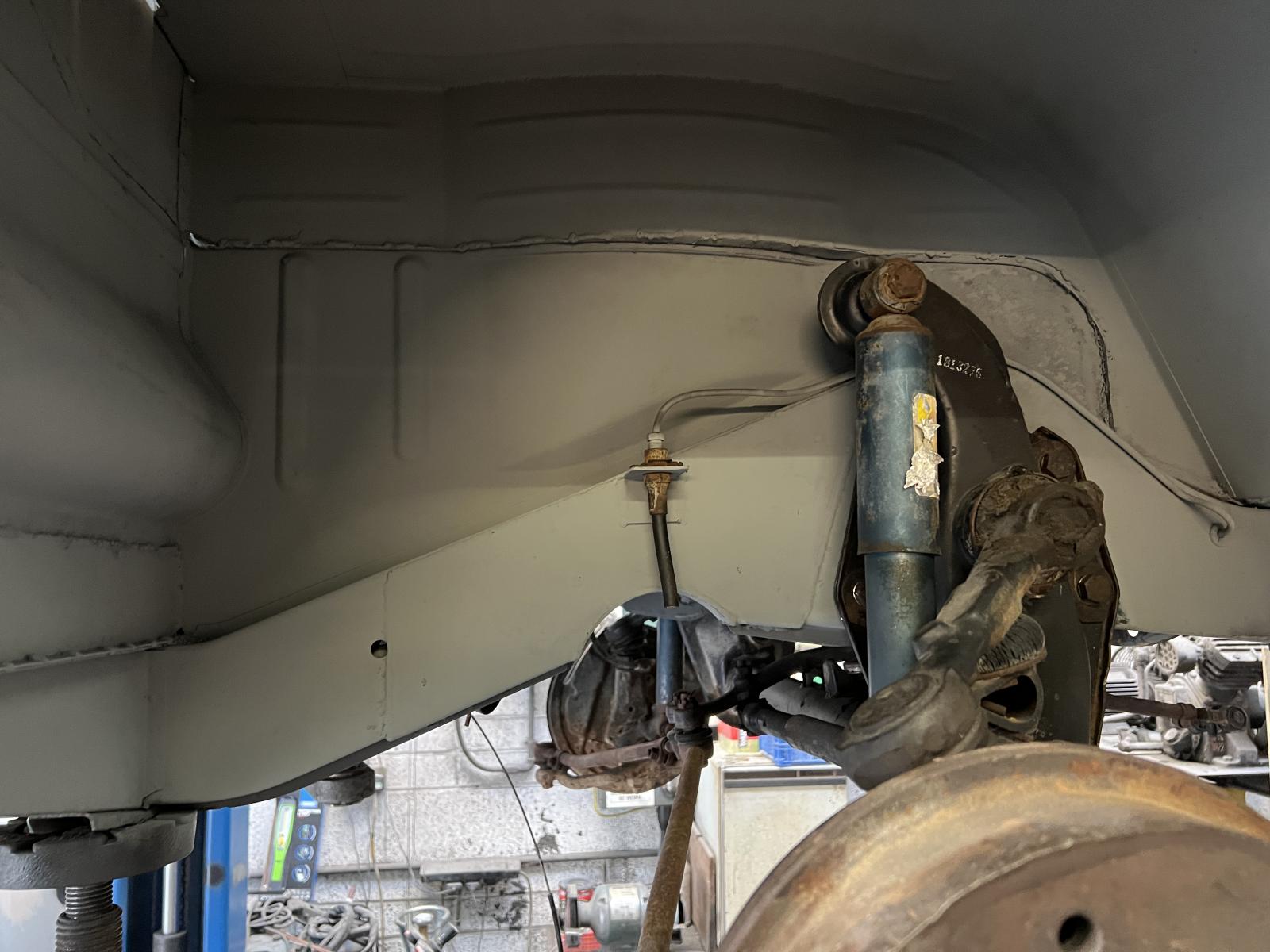

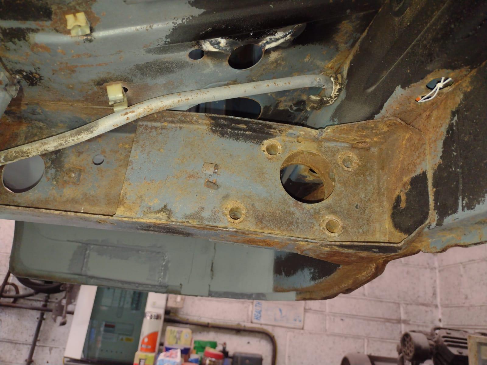

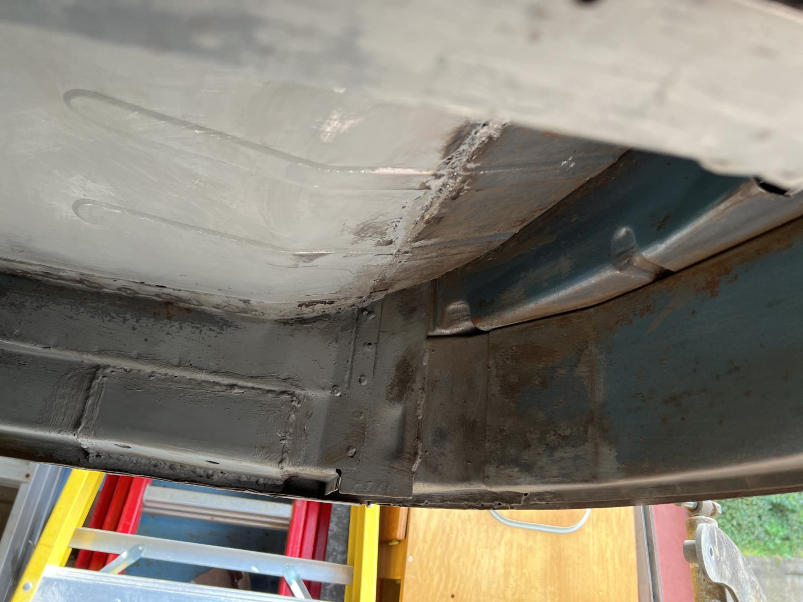

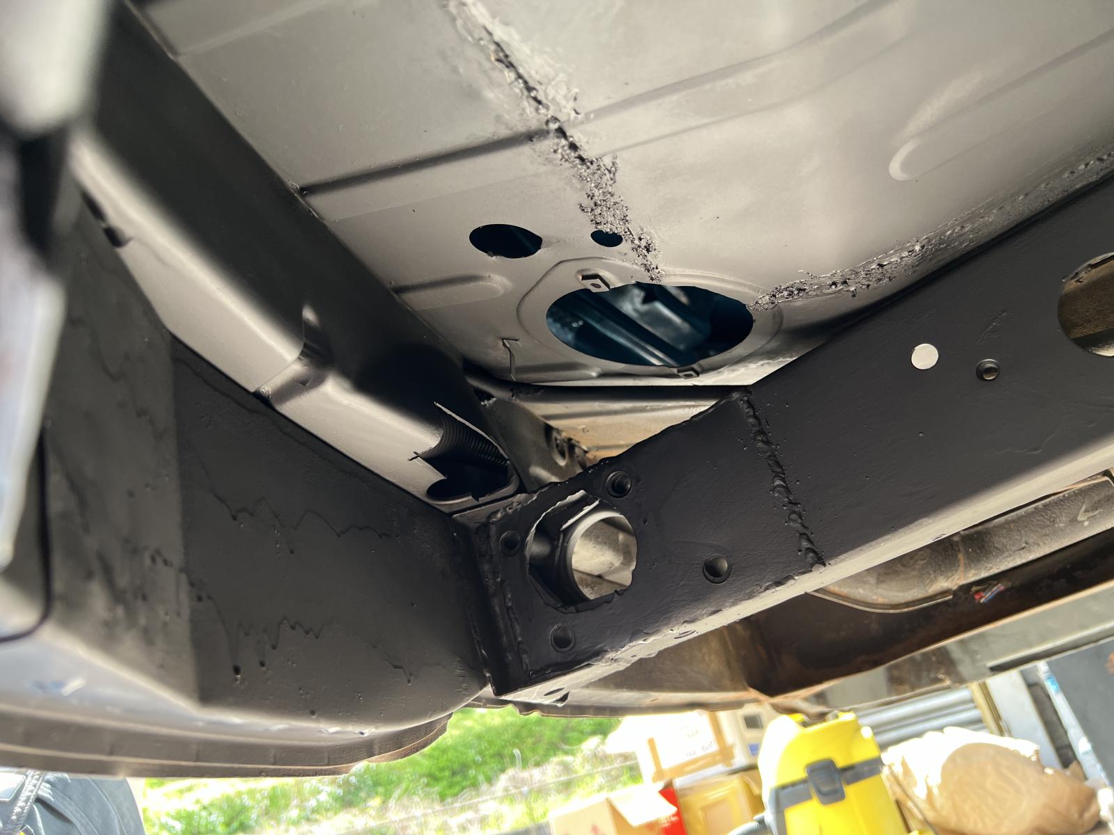

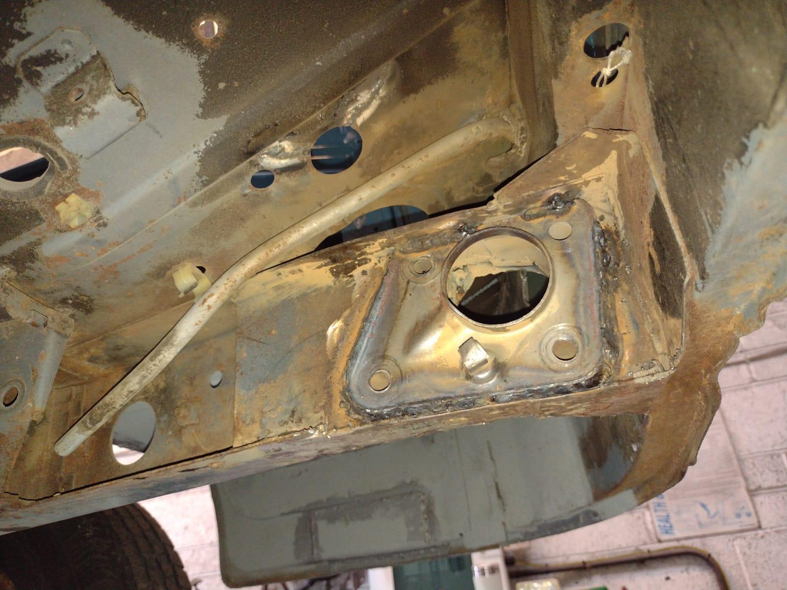

Front chassis notches
Late bay steering box conversion
Rear chassis notches

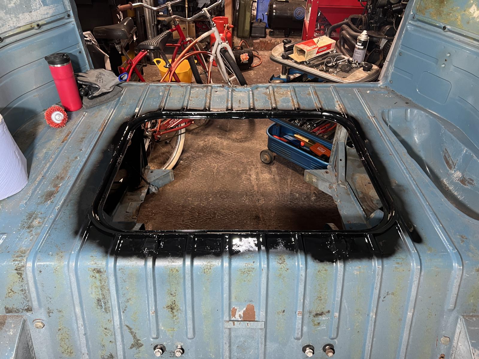

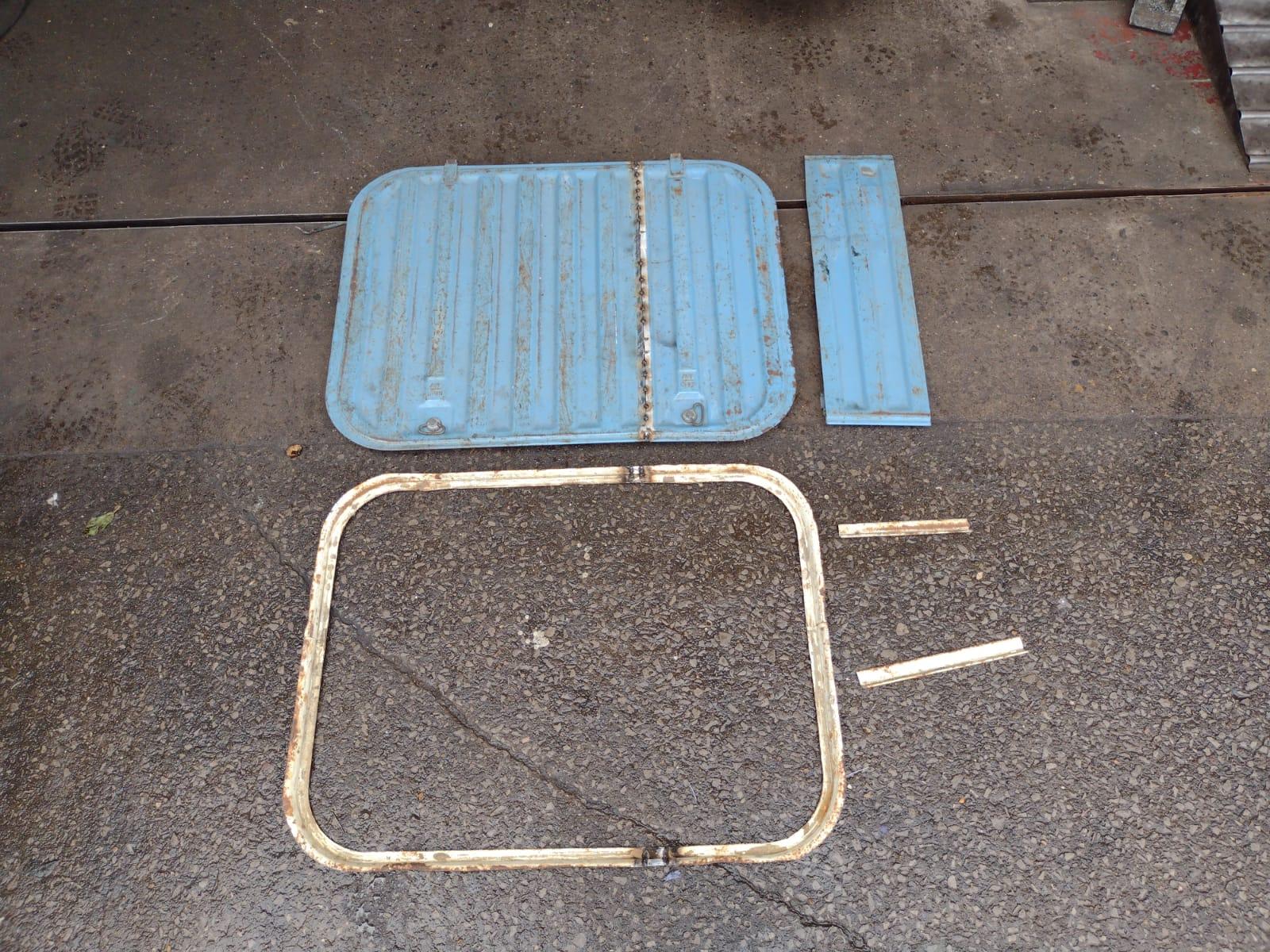

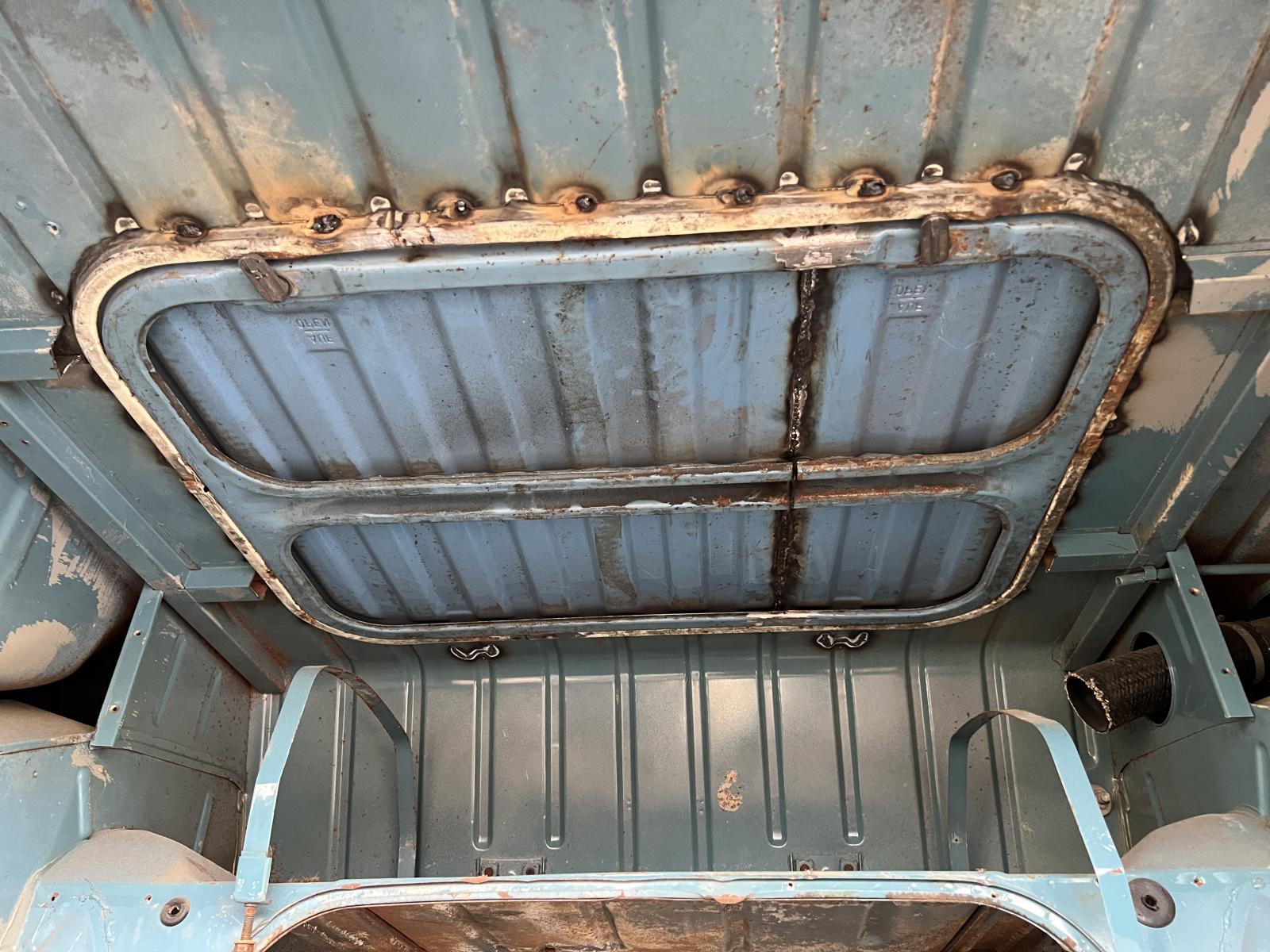

T25 (Vanagon) engine hatch
I had this cut down to fit between the longitudinal engine deck supports.

PostPosted: Mon Jul 07, 2025 1:26 am    Post subject: Re: Sept '67 (1968 MY) deluxe, another Blakes Bus Reply with quote

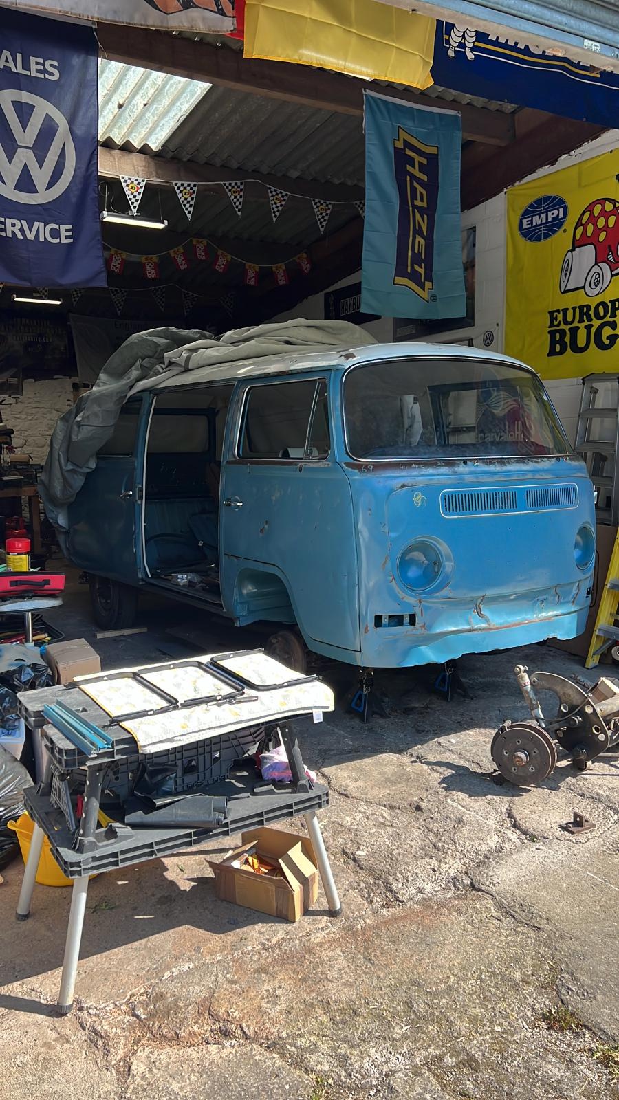

November 2022, and the bus is back at home.
First job is to get some paint on all the recent metalwork.
The engine hatch surround is primed, seam sealed and primed again.

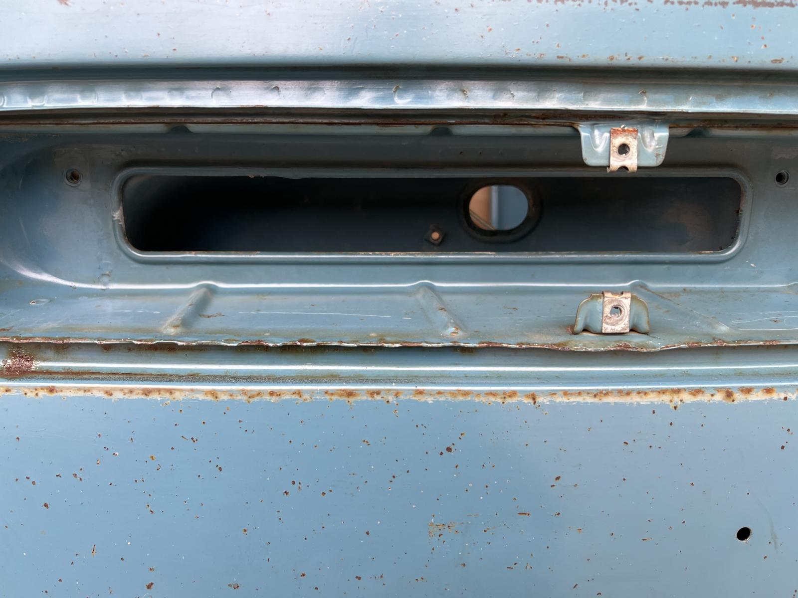

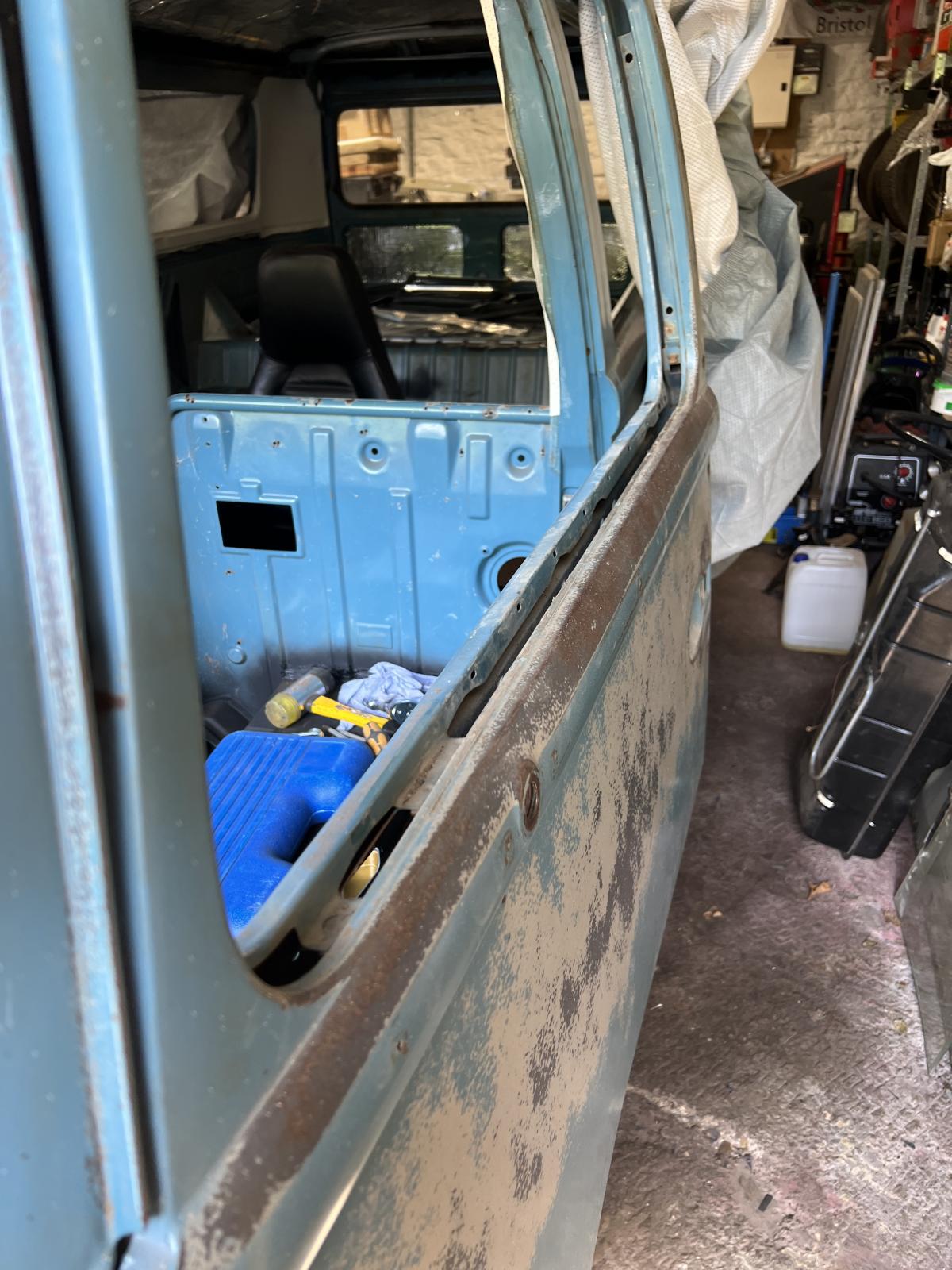

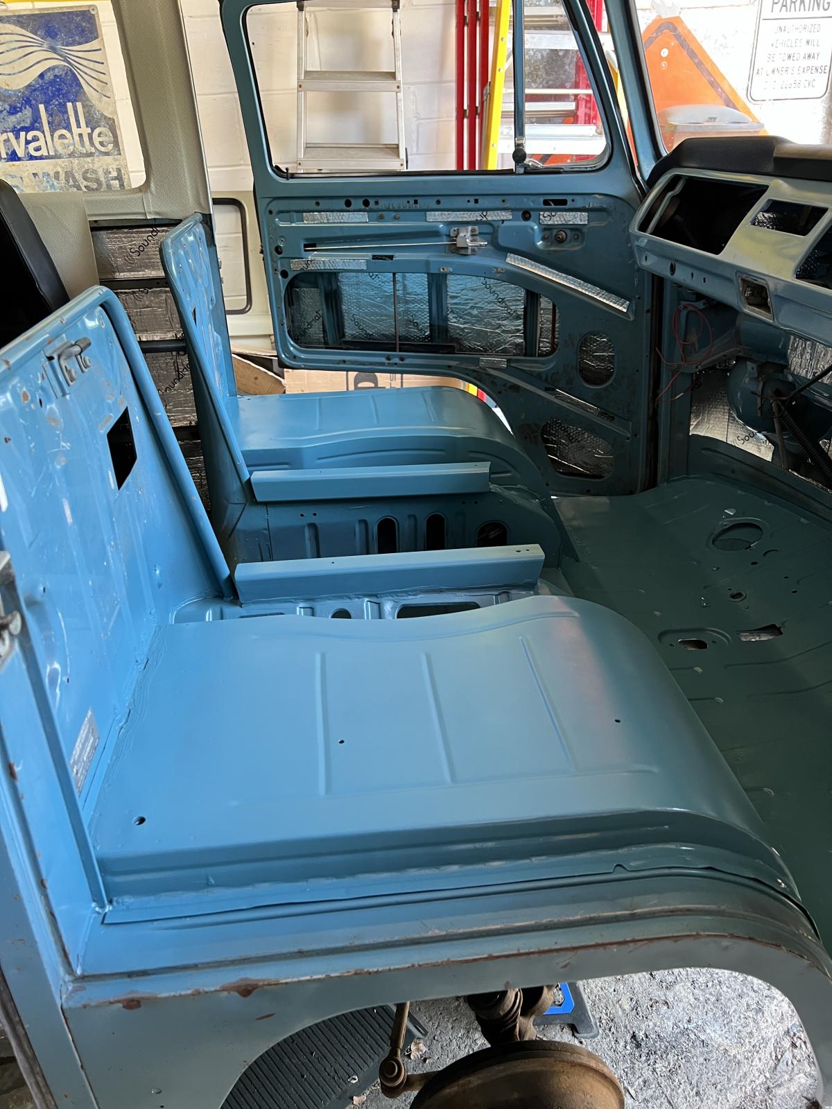

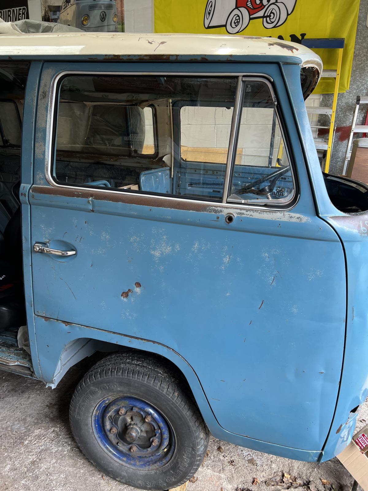

January 2023
R/H door stripped, rust treated and primed.
While the window mechanism is drying after a good clean,
I'll start on getting the tombstone seats in place on the tubs.
Some 2" square tub to support the inner runners.
There's enough room to slide under the steering wheel.
Driver's seat is angled inwards to be able to comfortably reach the pedals.
Square tub welded in place, final check for position and then a coat of primer on the tubs.

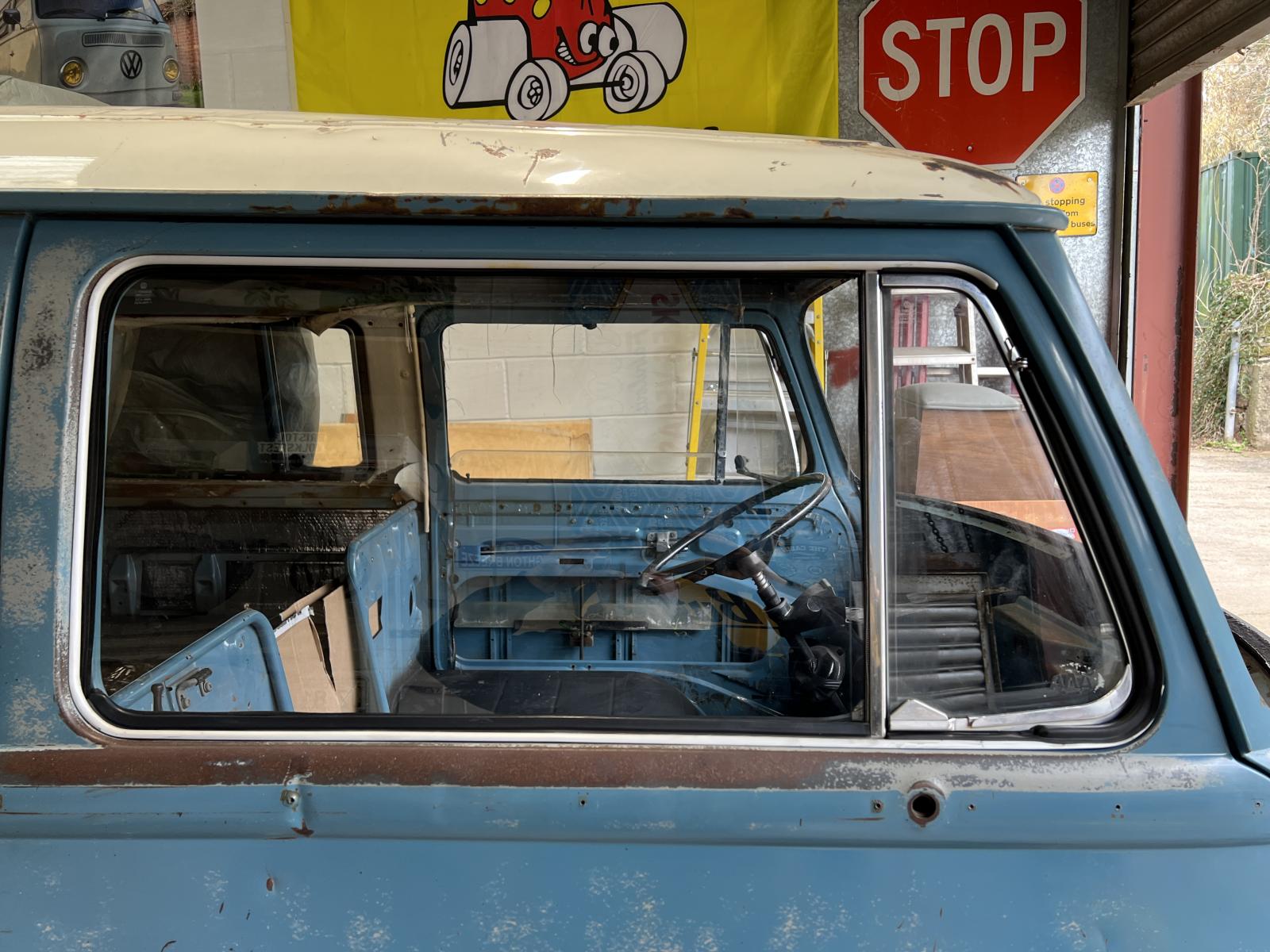

PostPosted: Mon Jul 07, 2025 1:47 am    Post subject: Re: Sept '67 (1968 MY) deluxe, another Blakes Bus Reply with quote
February 2023
Back to the cab door, sound deadening in place and interior of door sprayed with chassis wax.
Lock and latch mech cleaned, lubed and refitted.
Window scrapers refitted with new rubbers, but the old metal spring fixing strip.
Window glass and mech,
and the vent window/1/4 quarter light installed.
That's this door complete until the trim panels are fitted.

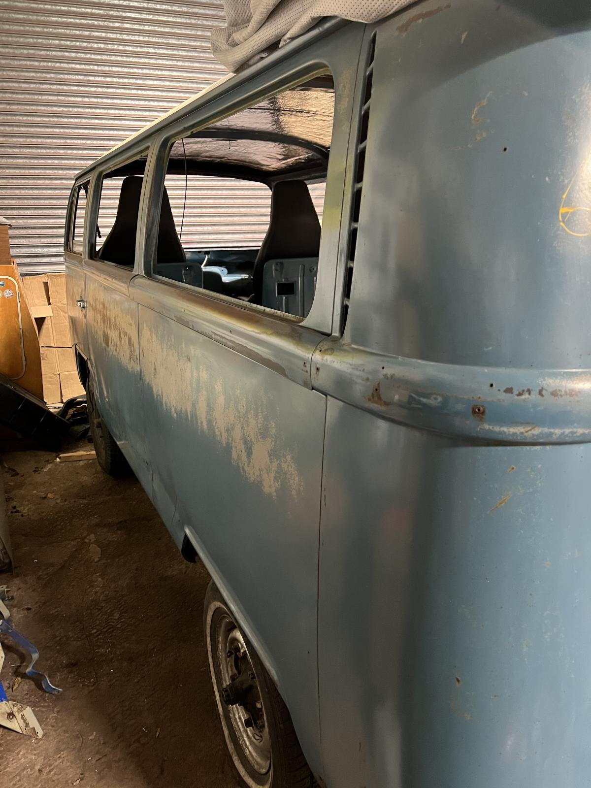

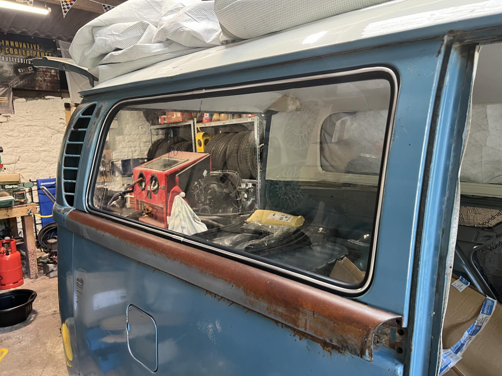

March 2023

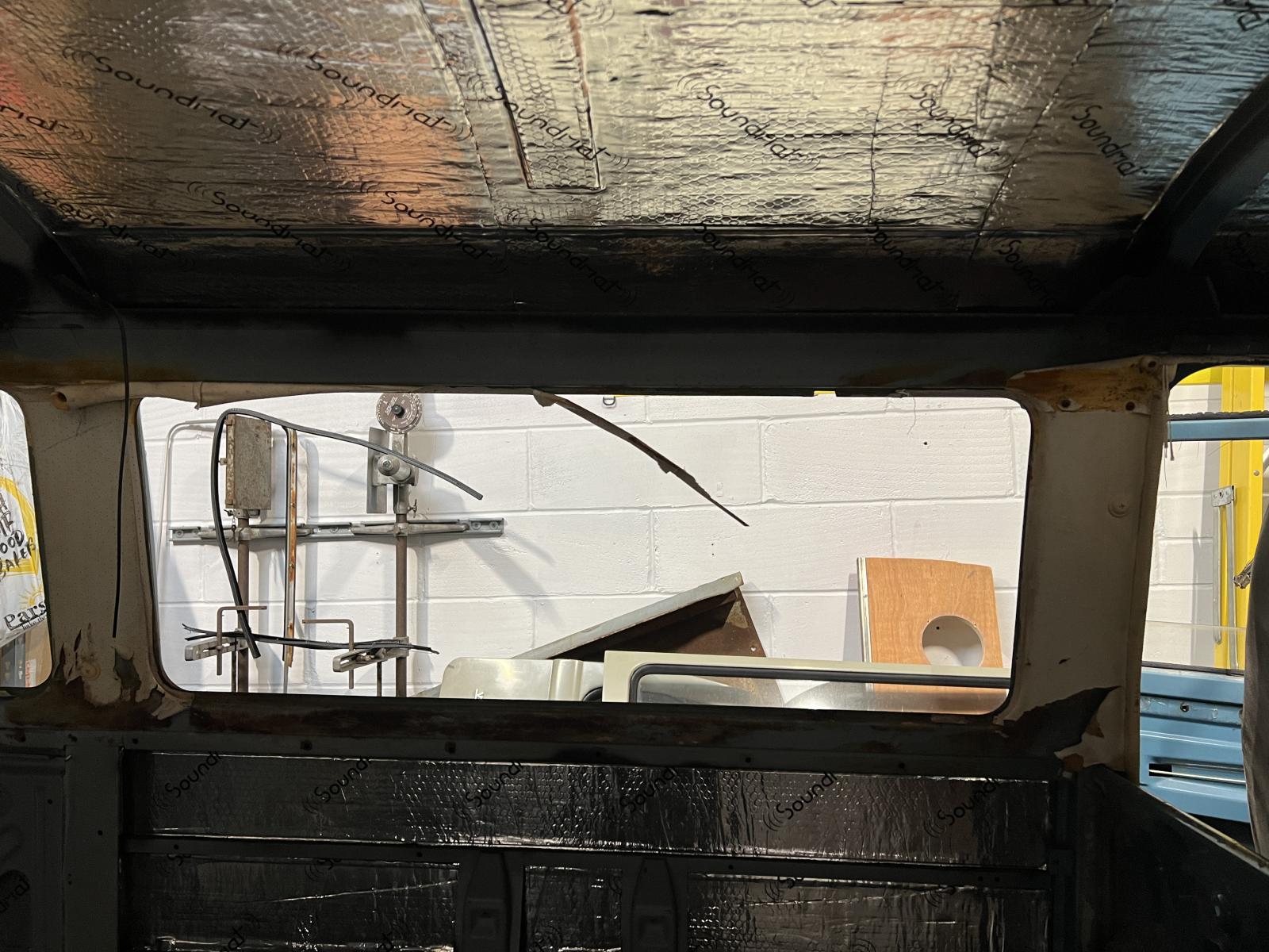

All the remaining windows and rubbers removed to clean the reveals and ready for a headlining to be fitted.
No dramas there, just a lot of Colorado dust and sand to clean up.
A spot of rust treatment and primer/paint where needed, but nothing major.

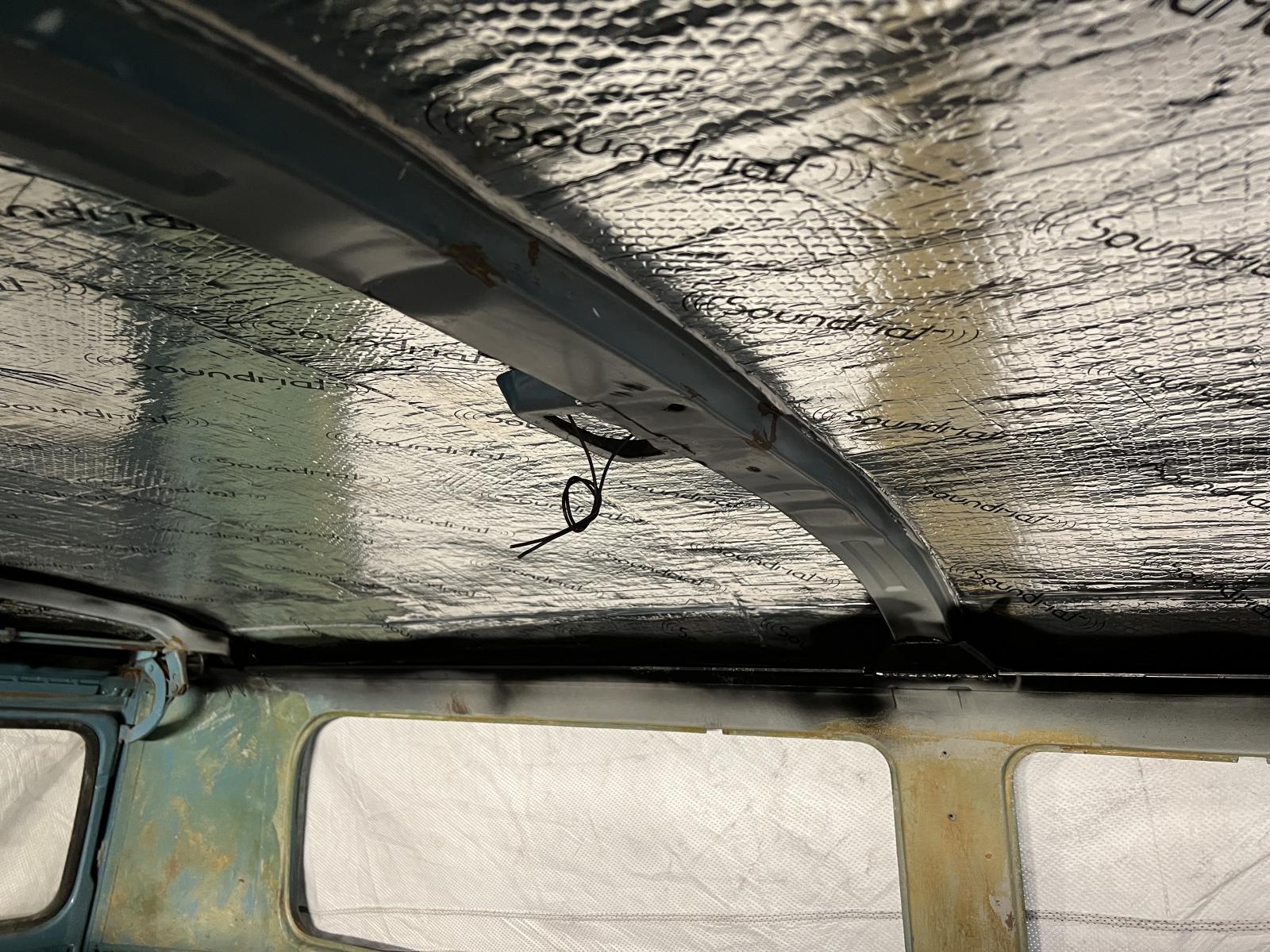

PostPosted: Mon Jul 07, 2025 2:10 am    Post subject: Re: Sept '67 (1968 MY) deluxe, another Blakes Bus Reply with quote

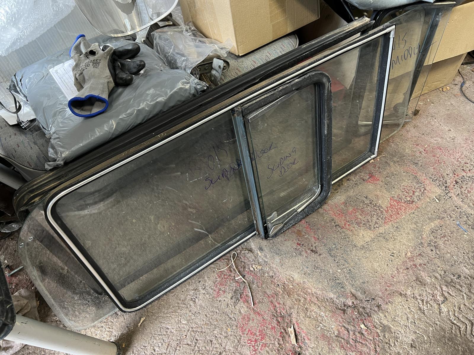

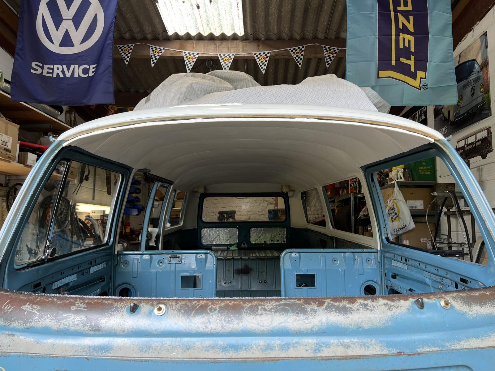

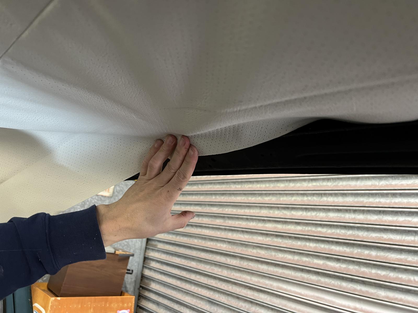

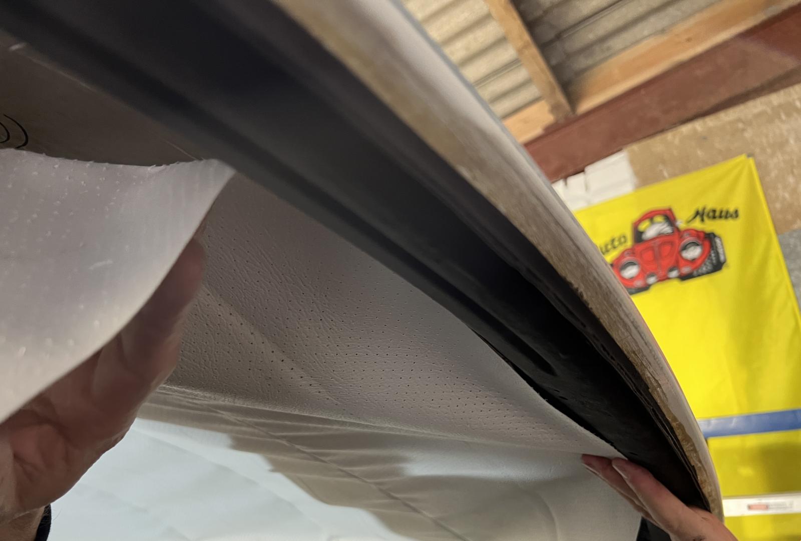

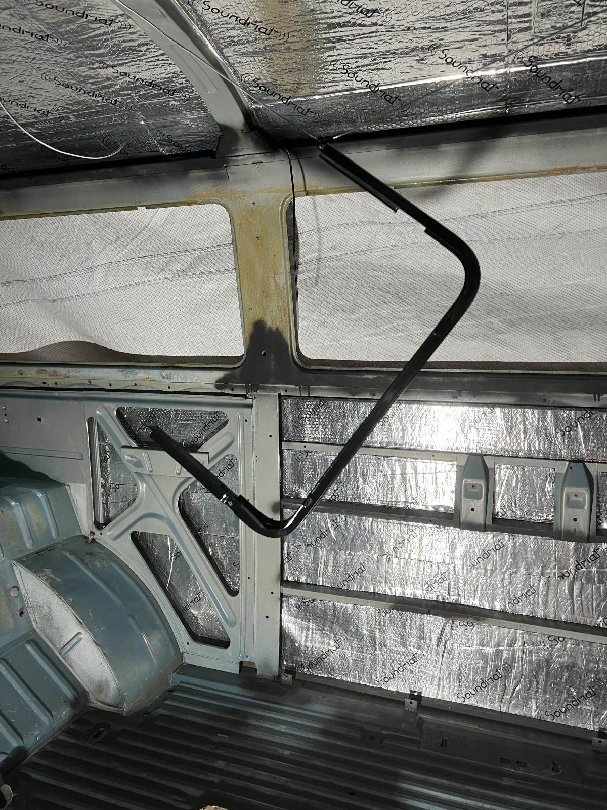

Sourced a headliner and some used bows.
I did wire the courtesy lights before the headliner goes in.
Material fitted around windows.
But unfortunately a setback, the headliner isn't long enough to wrap around the windscreen lip. It's plenty wide enough though.
So back to the supplier.

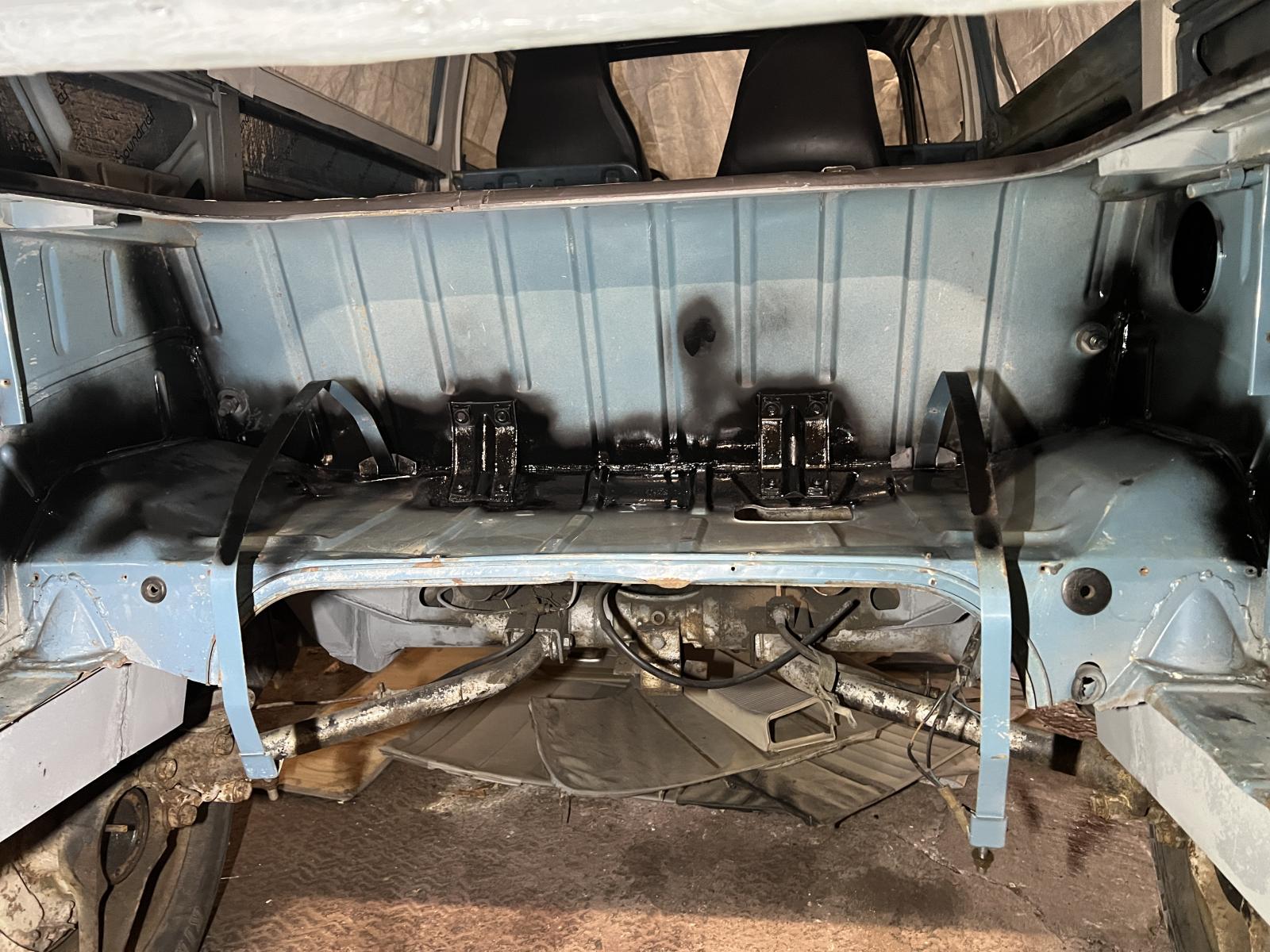

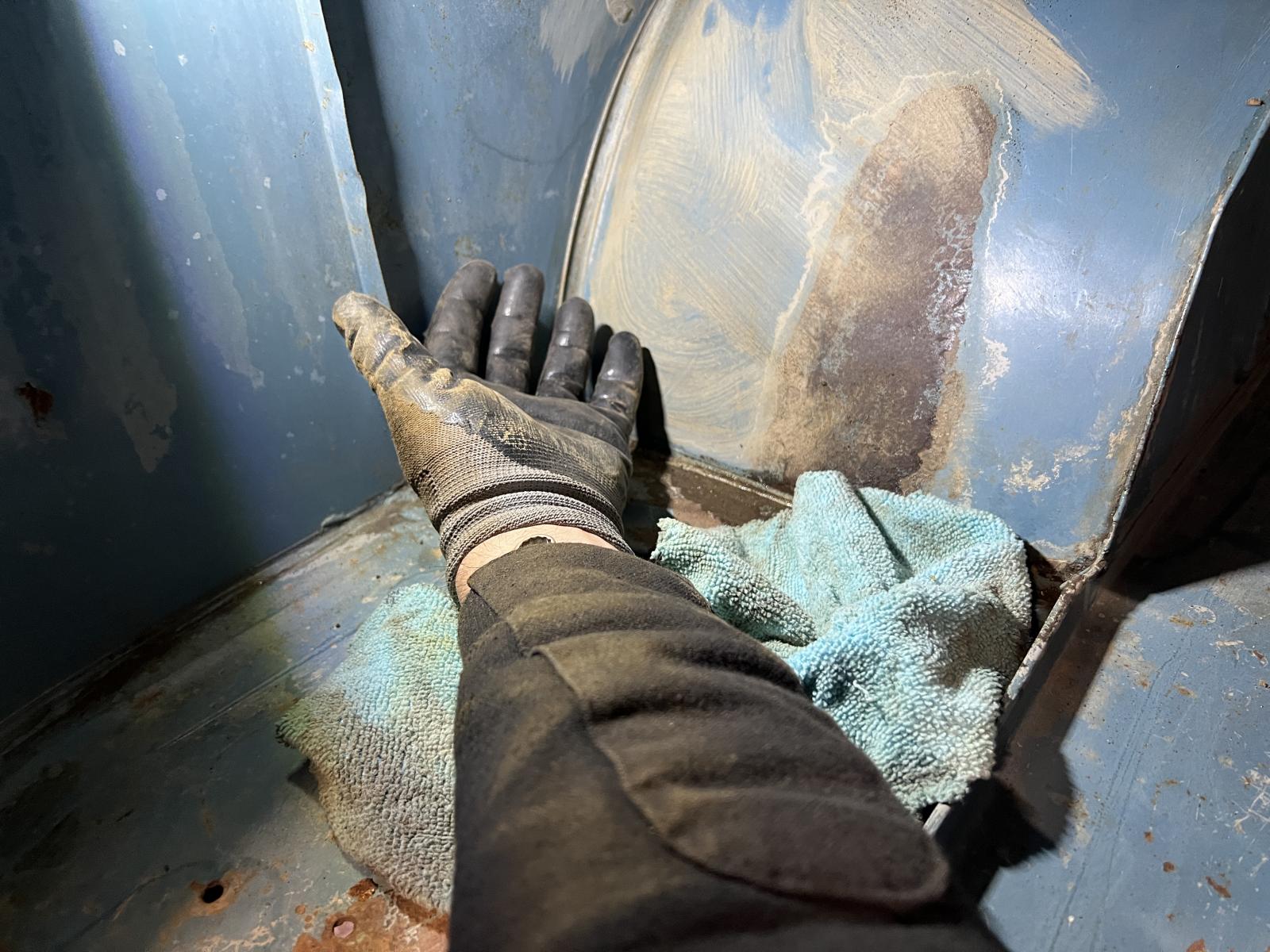

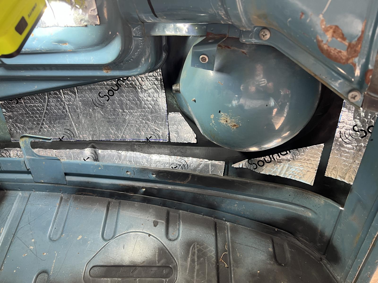

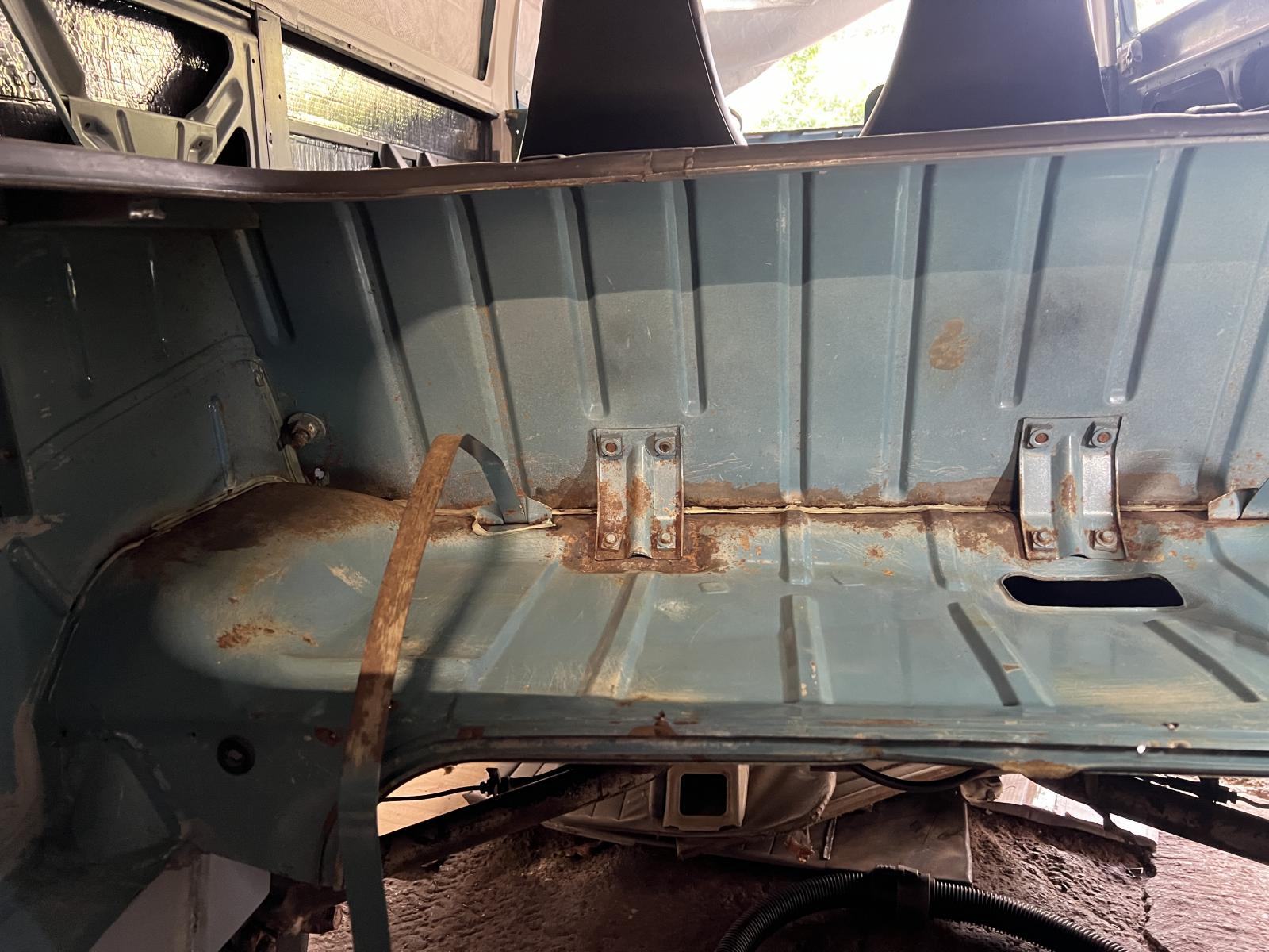

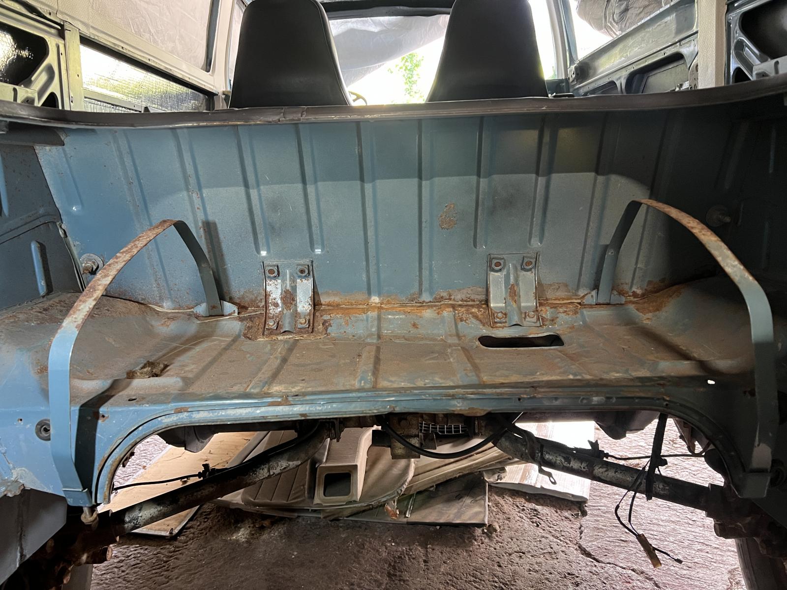

While I'm waiting for the headliner issue to be sorted, the engine bay and tank shelf needs a further cleanup.
Factory sealer only where you can see it?
sparkywig
Posts: 170
PostPosted: Mon Jul 07, 2025 2:22 am    Post subject: Re: Sept '67 (1968 MY) deluxe, another Blakes Bus Reply with quote
Rust treated, resealed and primed.

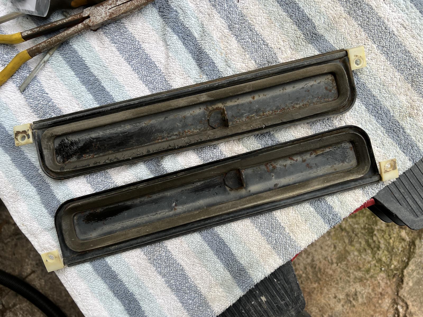

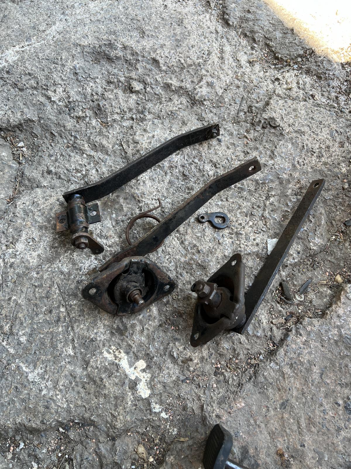

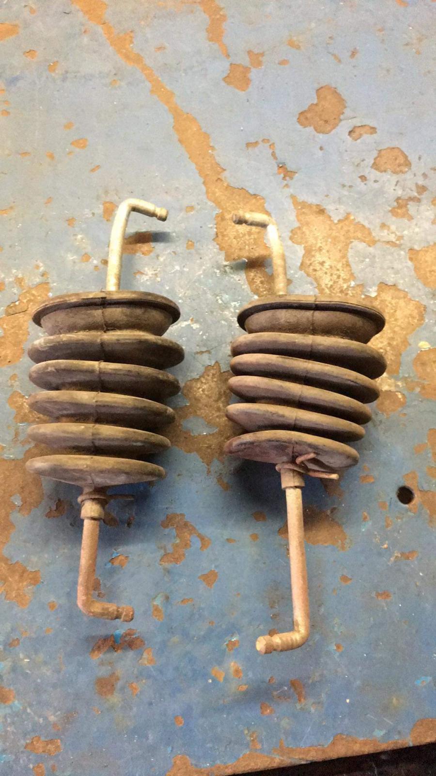

Stripped the fresh air flaps and mech. The flap seals are nearly perfect so just need cleaning, but the rods where cut when the interior was removed.
I have some rods, rubber gaiters and the internal mech in stock, so they're refiitted and ready to be reinstalled.

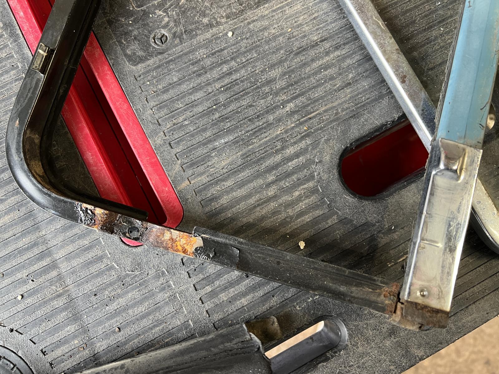

PostPosted: Mon Jul 07, 2025 6:07 am    Post subject: Re: Sept '67 (1968 MY) deluxe, another Blakes Bus Reply with quote
Vent windows stripped, cleaned, repainted and new seals.
And repeat.

Oh yes, I've also started to sound deaden panels as well.

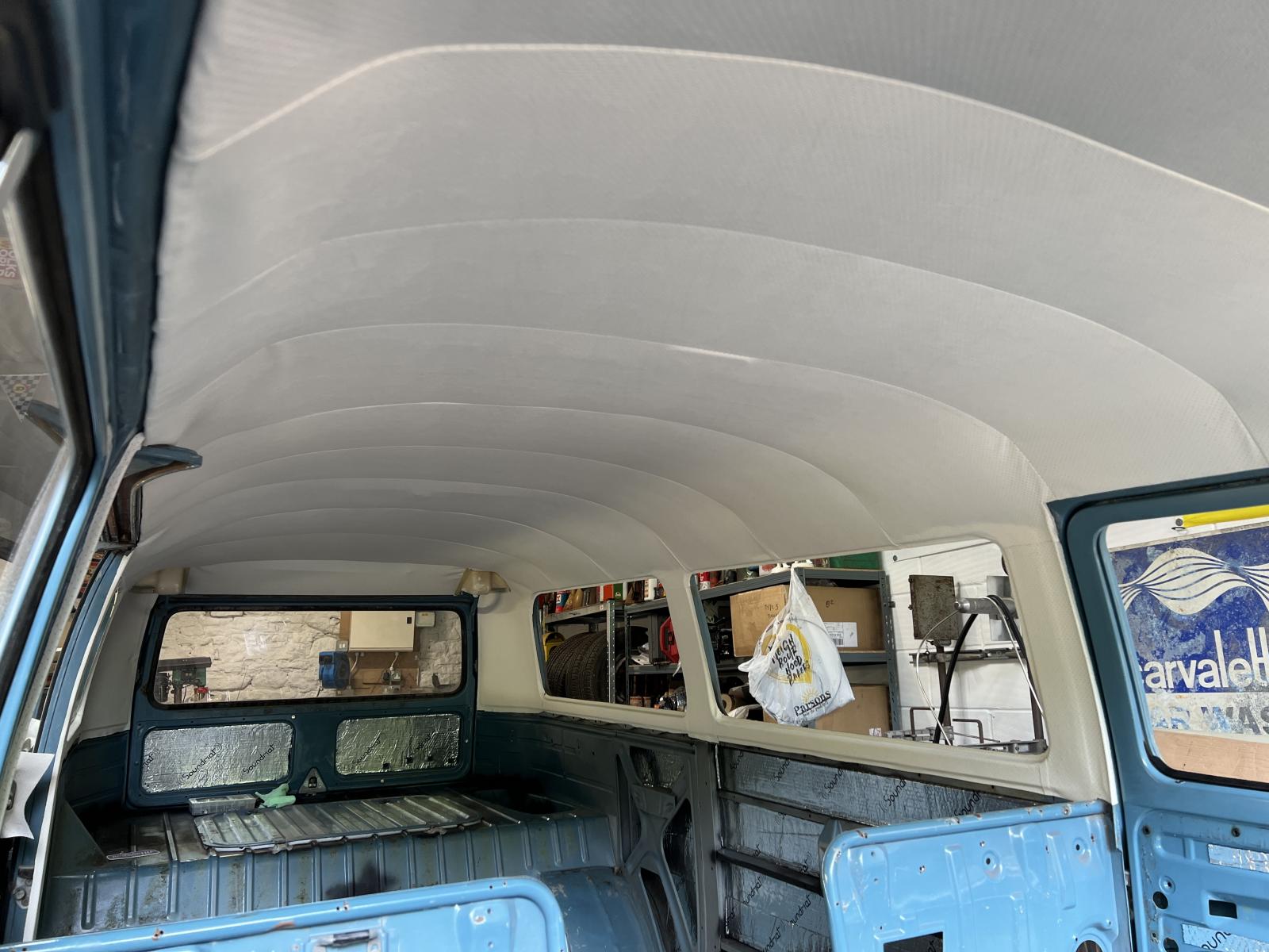

It's now late May, 2023 and the headlining is back and being fitted.
That looks better.

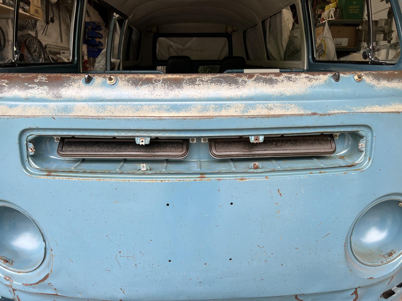

Fresh air flaps are installed and connected to the mechanism.

PostPosted: Mon Jul 07, 2025 7:06 am    Post subject: Re: Sept '67 (1968 MY) deluxe, another Blakes Bus Reply with quote

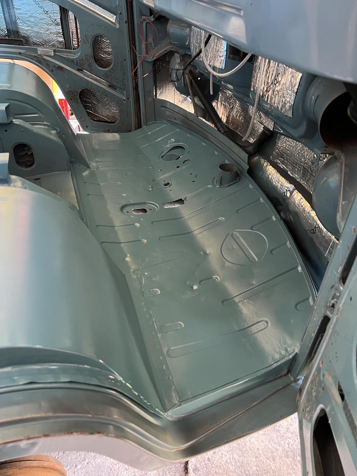

Tombstone seats next.
R/H seat runner mounting holes marked drilled and tapped.
A few coats of primer and topcoat on the tubs and cab floor.
And then sound deadening.

Rebuilt the vent windows with new rubbers.

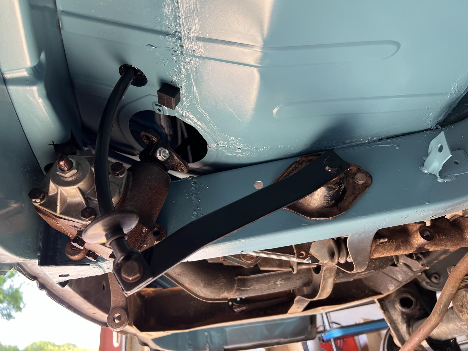

PostPosted: Mon Jul 07, 2025 7:34 am    Post subject: Re: Sept '67 (1968 MY) deluxe, another Blakes Bus Reply with quote

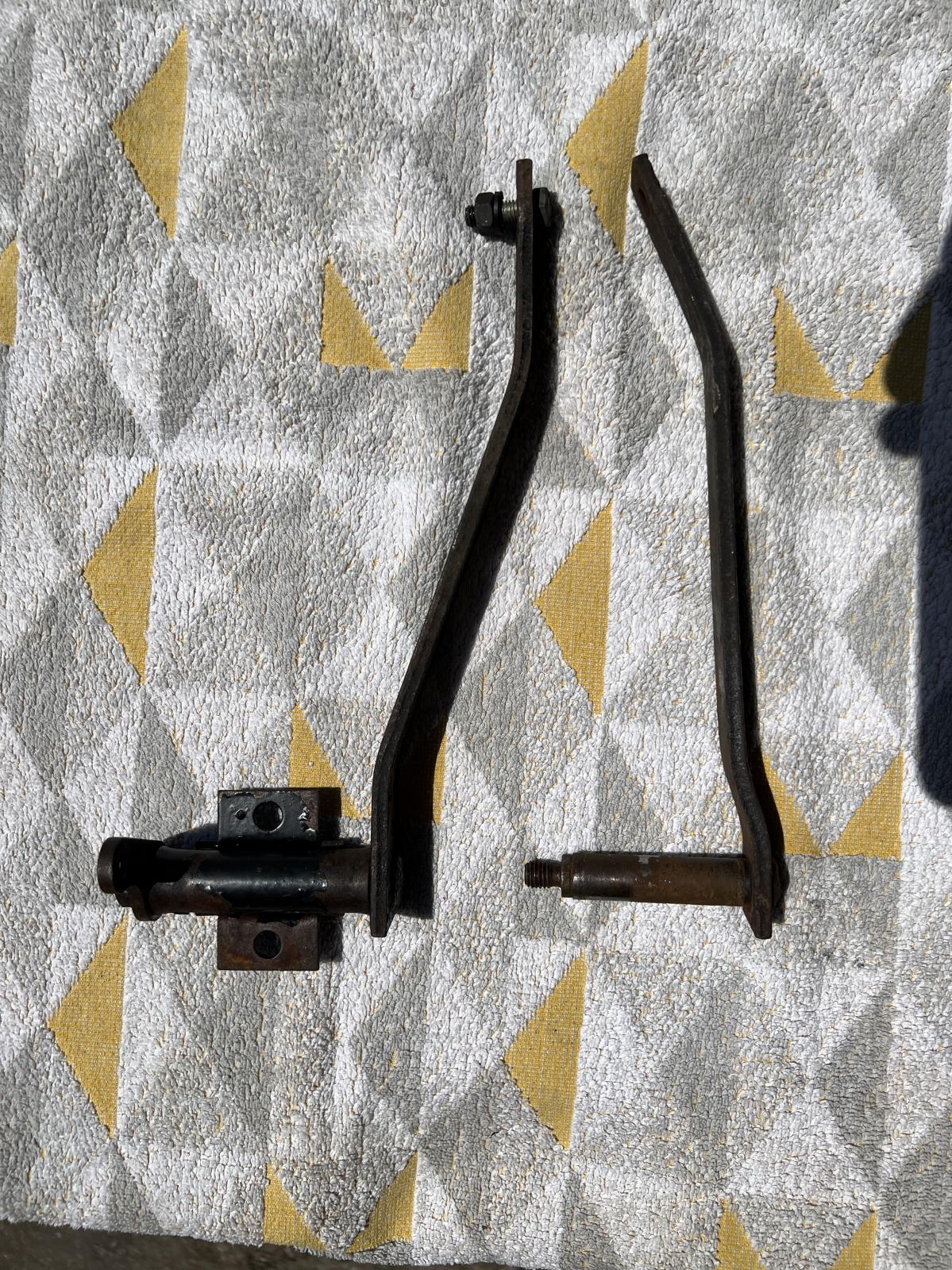

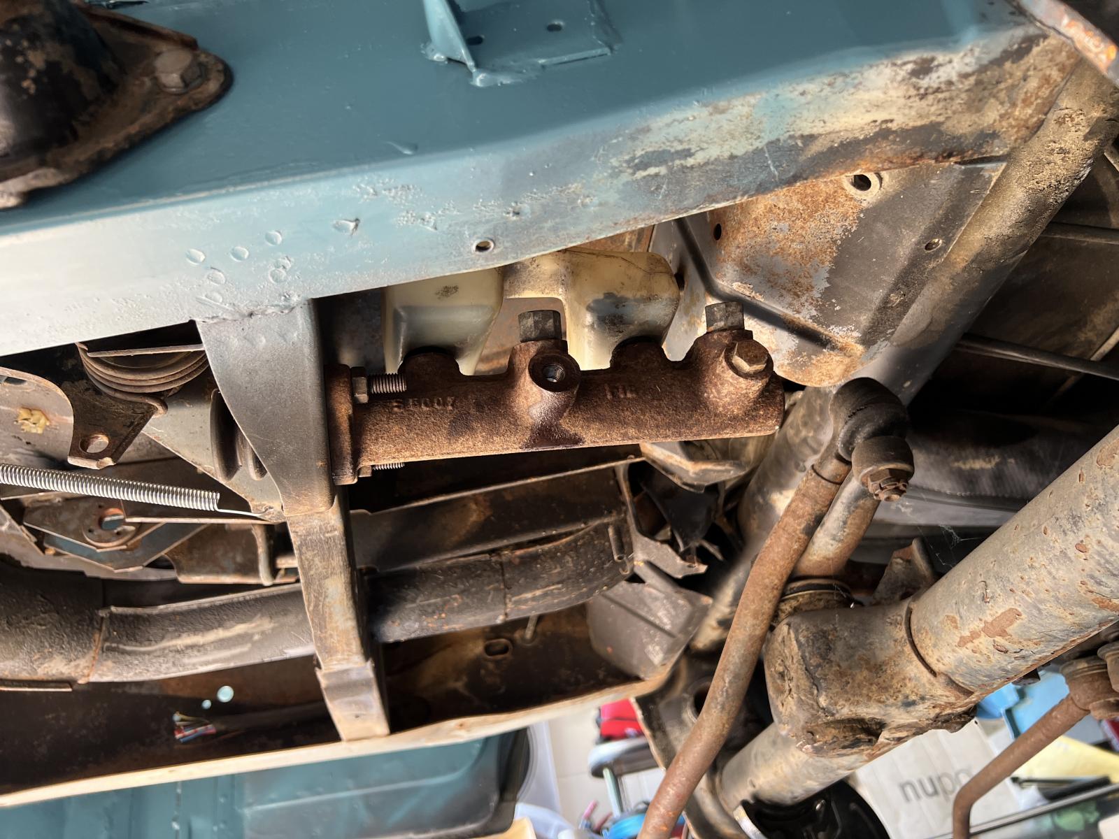

Cab floor underside clean and paint.
I've had to cut part of the inner front valance to clearance the late steering box as this sits slightly higher.
Pedals have also been cleaned up, straightened, painted and installed.
Brake master cylinder and throttle linkage installed as well.
