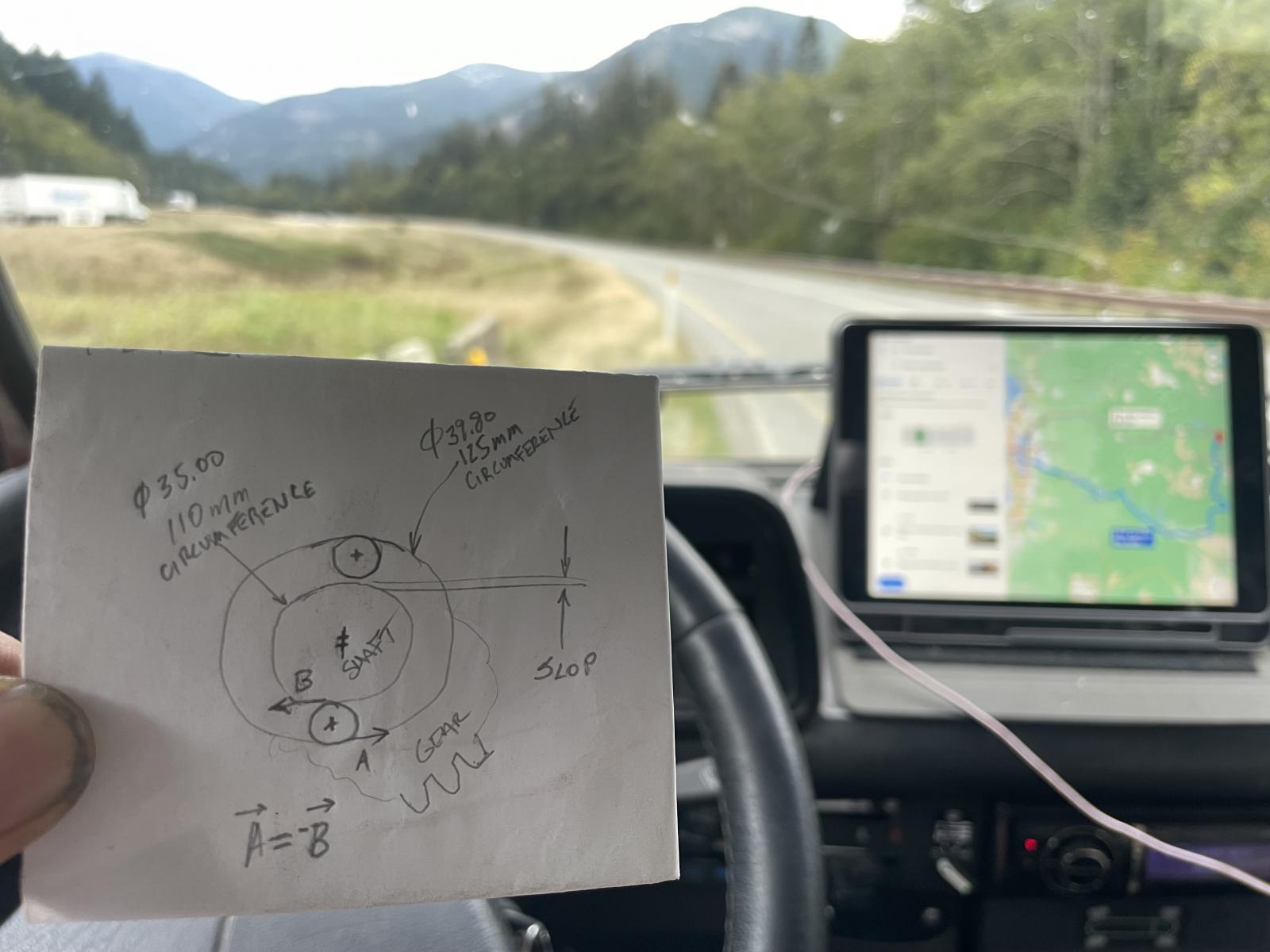

I’ll have to think about that. I tried to omit angular velocity.
The conclusion cannot violate “1 turn = 1 turn”.
I agree this is mathematical, and likely available somewhere on the web. But I gotta head for the woods currently, and hoping someone can find the math.
I cannot ‘perform’ a mathematical proof but perhaps can “follow” along.
This notion goes “against the grain” but appears feasible by observing used shafts. I can hardly believe I could be “the pioneer” of this discovery. I expect that Germans did the math back in the 1930s.
I can see that the 4th gear idler race is the most polished, shiniest race on an old shaft. As expected …. since 4th gear sees the most “area under the curve” (heaviest duty).
And it doesn’t make sense the race can burnish to the highest mirror polish....
between it's two states..... of
    “stationary loaded needles (in 4th) ”
    .vs.
    “no-load idling (in 1st, 2nd, 3rd)”.
Logically, the loaded needle rotating (mechanical precession) under load would produce a mirror polished bearing race.
I've made a statement that says the cage rotates at 1/8.33th the speed of the locked gear. Which seems outlandish. I think it's feasible that it rotates but my gut feel is it rotates a lot slower than the "432 RPM".
My gut feel is the difference in rotation would be relative to "slop/39.80mm".
I do not have an accurate measurement of the slop.
Lets guess the slop is 0.2mm
thus----> 0.2/39.8=.005
.005 x 3600rpm =18rpm (which I wouldn't mind either, anything but 'stationary!!)
^^just thinking out loud^^
Thats my gut feel what the needle cage rotation should be based upon.
I can't dig into it for awhile PLUS need to let it rest a little - maybe it will come while I'm out in the woods. Wink
I'm like a pig in the mud, I enjoy this. I need someone to tell me where I’ve gone wrong, or help from a big brain to take this farther. Surprised

Sodo, was your main bearing fit loose when you had these failures?
The measurements I asked for could tell you a lot about what is causing this failure.
If the diameter of the damaged area is larger than the diameter of the bearing race, you have eccentric rotation equal to the difference of the two measurements. I’m curious about the exact measurement but any confirmation is better than none.

Sodo, was your main bearing fit loose when you had these failures?.
No the mainshaft bearing was tight in its bore.
The bore was sleeved. Dangit I’m “away” from my parts for a few days, can’t measure anything.

Thus the cage is rotating at 15/125 of shaft RPM.
>>>>> At '65mph' the cage is rotating 432 RPM.
Got it. I used ChatGPT for the first time today.
It was frightening, actually, how quickly it guided me into clarifying the desired result of my query.
At 3600 RPM; appx 65mph in 4th gear, the needle bearing inside 4th gear rotates at minus-23 RPM even though 4th gear is locked to the shaft.
This is caused by the bearing "clearance".
I used an estimated "50 microns" bearing clearance to get the "23rpm".
The 4th gear bore center, and the mainshaft center are "off" by 50 microns, which causes a precession.
This 23rpm needle cage reverse rotation prevents false brinnelling. Over time, this slow reverse rotation burnishes the mainshaft surface to a mirror-finish.
Bedding-in trash in the oil, especially the lumpy new trash
(not yet rolled flat into flakes by circulating thru gears and bearings thousands of times.)
can 'chock' the needle bearing
and stop this (beneficial) 23rpm.
Then as oil depletes from sustained 4th gear thrust, false brinnelling commences.

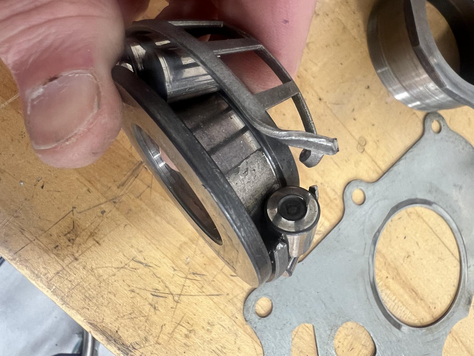

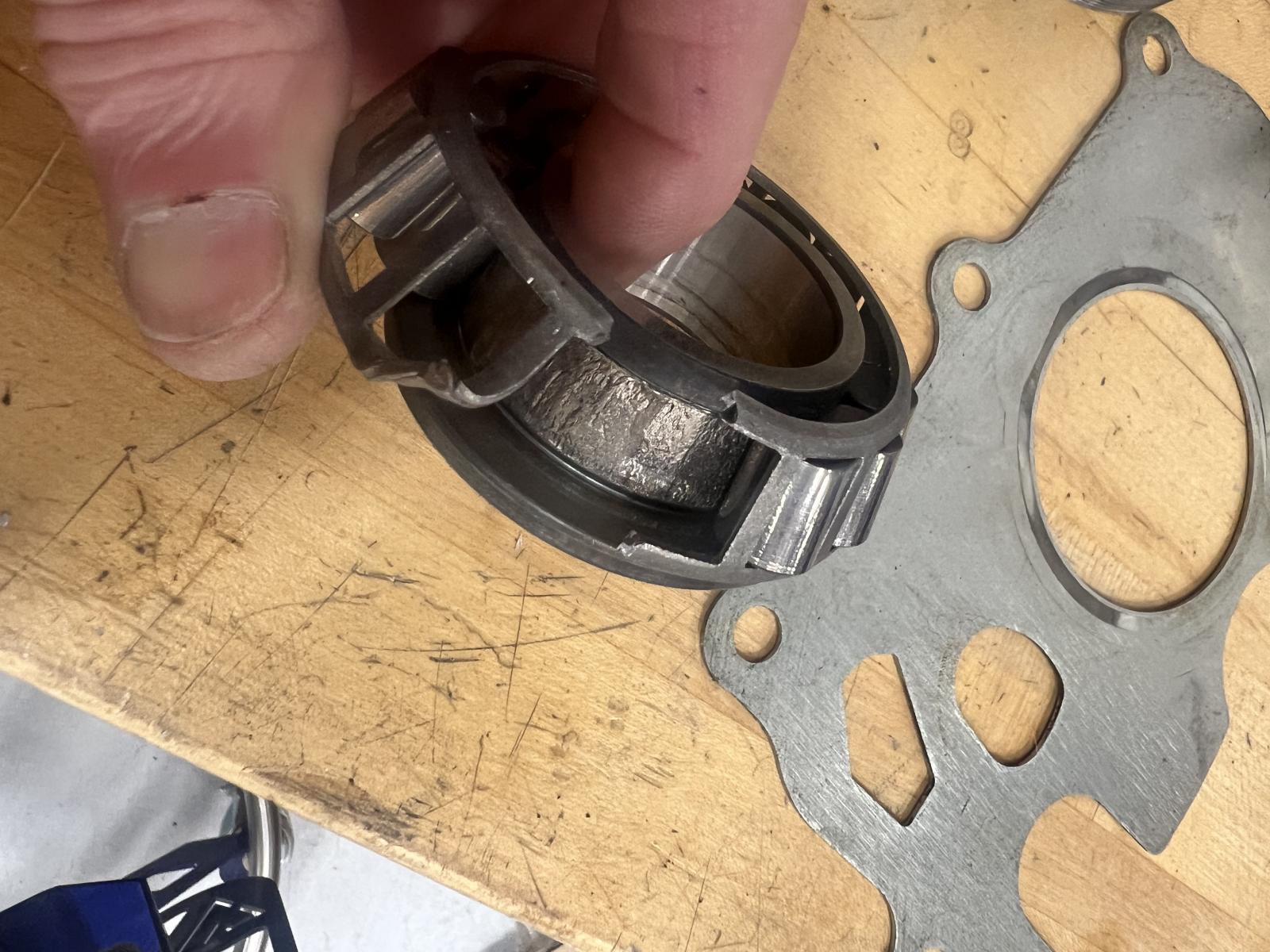

I rebuilt a transmission for a guy several years ago. About three years and 12k miles later, it began jumping out of 4th gear.
When I took it apart I was amazed at the amount of "sludgy black" coating on everything inside. I have no clue what spec of oil he had used or how many times it had been changed.
I put the gear stack/carrier in my jig.
None of the shift-forks were loose or out of adjustment.
As I was finishing reassembly and placed the shifter end of the transmission on was when I noticed the problem. The external shift lever had been installed incorrectly. Although there is supposedly only one way for it to slide onto the splines, it had been installed about 15 degrees out of proper orientation. (He gave me the back story on why it was installed incorrectly. Very Happy )
Anyway, my point is, agreeing with Sodo about how important it is to change the oil in a newly rebuilt transmission .......... change it often the first 5k miles. And, as Sodo has suggested, save that oil and let it settle for future use.
Side note: Somewhere in my photos, I have an excellent pic of a "mirror polished" 4th gear main shaft journal. Found it.
Note: it my look as if there are some imperfections, but it is totally blemish free.

Here are a few photos from the tear down of my Syncro Tranny. The transmission had about 90K on a rebuild and was making noise for about 600 miles before I could swap a different transmission in. This is in a 1.8T engine heavy westy van but with trans oil re-circulation, filtering and cooling. For the "early years", I did not understand the 4th gear scenario and I would put it in 4th on cruise control and happily go along without the occasional downshift to get some oil on the 4th gears face.
Classic photos of 4th gear face wear
The noise issue was apparently the pinion bearing starting to tear itself apart (cage ripped open to see journal) I really almost completely screwed the ring and pinion but it somehow survived this.
My theory is that degraded grounding across the gearbox case blackens the oil early. Electricity makes Fe2O4, which is a black powder, and its mildly abrasive too. Its magnetic, and piles up as black mud on the drain magnet. Which crowds the magnet's ability to hold onto steel. The electricity craters the bearing races though, ruins the bearings, ruins gear faces too. When cratered, then steel starts chunking off.
Electricity that can't get across corroded bolts and thus diverts thru the internals is bad news. Those who would spend $100 on gear oil would be far better off spending $15 on proper grounding FIRST. Running electricity across the gearbox case is a risky proposition, and we don't NEED it. Use direct copper.
As the interface between the 4th gear and mainshaft bearing dries,
resistance drops at that interface, beckoning more current to cross the mainshaft bearing,
enroute to the forward transaxle ground.
DougnLina, I have wondered if steel braided rear brake hoses would beckon wayward amps across the pinion bearing, R&P, CVs, & rear wheel bearings.
But "electrical assault" is a different subject to the oil-starvation that happens at the 4th gear/mainshaft bearing interface.
Andy, did you disassemble the mainshaft bearing & look at the races?
I would like to see a 12,000 mile mainshaft bearing.
I have been surprised by the pock-marks from the break-in trash
that you can see with the naked eye, on low-mile bearings.
DougnLina thanks for the pics of the mainshaft/4th and the cruise control + oil-pumped data point/pics.
I don't see the 'red hematite' on your 4th gear and bearing thrust surfaces. Can you see it in real life?
It's feasible that if the red hematite is only visible on a 'tight' mainshaft bearing.
With that much pinion bearing wear,
do you recall if the gear lever moved in your hand in 1st/2nd gear?
Is this false brinnelling from the idler bearing needles or just oil?
Can you catch a fingernail on them?
False brinnelling is another likely problem caused by oil starvation.
It's exacerbated by oil contamination if the chunks stop the needle bearing from precessing.
I see nothing red, all shades of grey. The shift lever did not move much if at all when going on/off throttle. The transmission initially started making a faint bit of noise (slight gravelly sound idling near the front of the box) but then we took a roadtrip and found ourselves fighting hellacious headwinds across New Mexico that just seemed to push the sound into being "this transmission telling you its time" noisy.
I noticed the brinnelling but did not know what to think of it or remember to ask the rebuilder what it was all about. I can feel it but it feels more like light impressions than anything you can get a fingernail to hang onto. You probably have a better idea where this comes from than I do...
