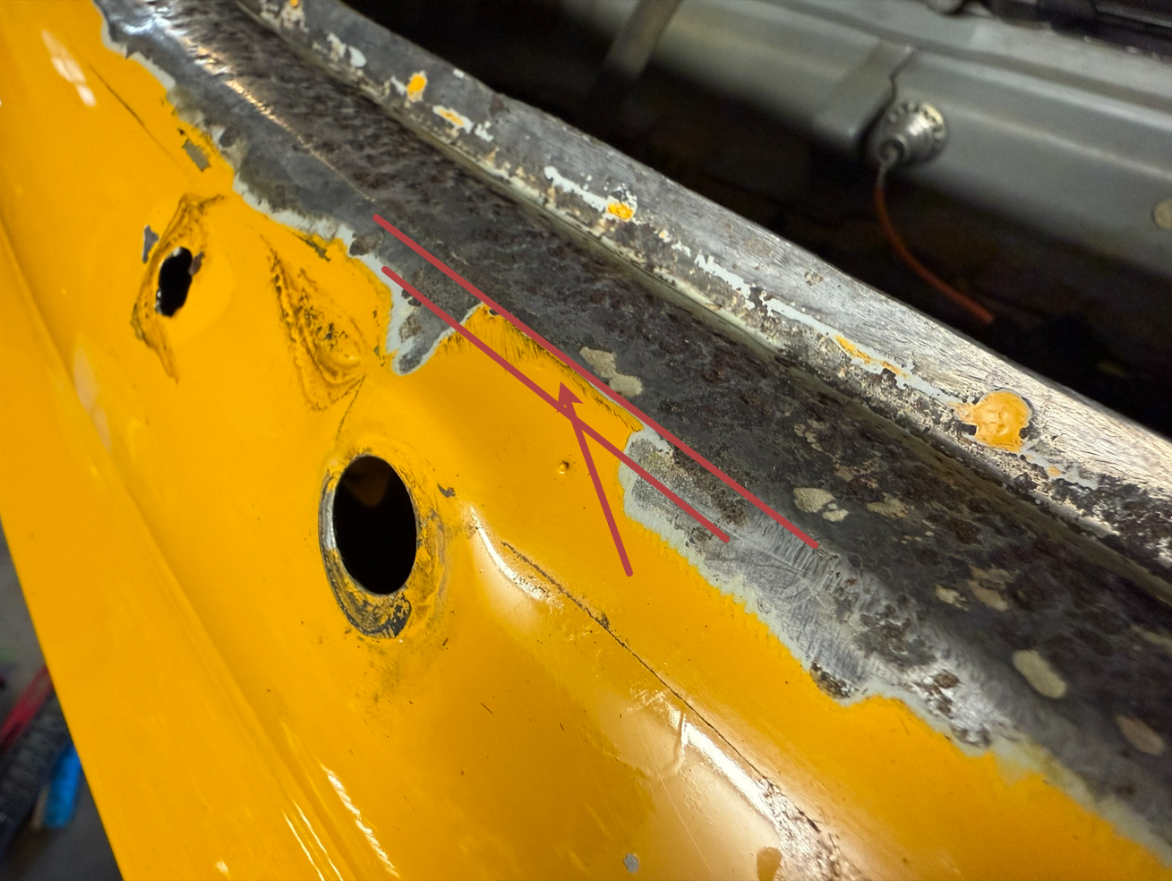

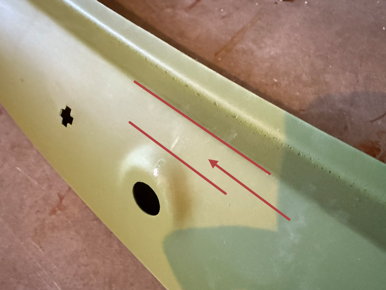

Okay, I received the replacement part from Klassicfab, and it arrived without trauma.
In looking at this new part versus the existing bus, I see 2 main differences:
1. On the new piece, the sill in which the windshield and seal sit in is flat. On my bus this sill is bowed upward slightly. That is, it has a slight convex contour to it.
2. On the new piece, there is probably 1/2" space between the bulge for the wiper hole cutouts and the round edge where the sill begins:
On my bus the pic here doesn't show it well but there is virtually (if any) gap between the bulge for the wiper hole cutout and and round where the sill begins:
Does this seem right to you guys? The sill bulge versus flat is the biggest thing that I'm not sure about. Or is this just much ado about nothing?

PostPosted: Sat Dec 07, 2024 12:56 pm    Post subject: Re: Under Windshield Rust Repair Recommendations and Progress Reply with quote
hard to tell in the photos what you mean, but the wiper 'eyebrow' looks right to me.
your nose looks to have a ton of paint/filler which may distort the profile of the wiper arm area.
at the end of the day, it won't make a difference

Thanks, Skills! Kind of what I was thinking but you guys are the experts. Appreciate the feedback.

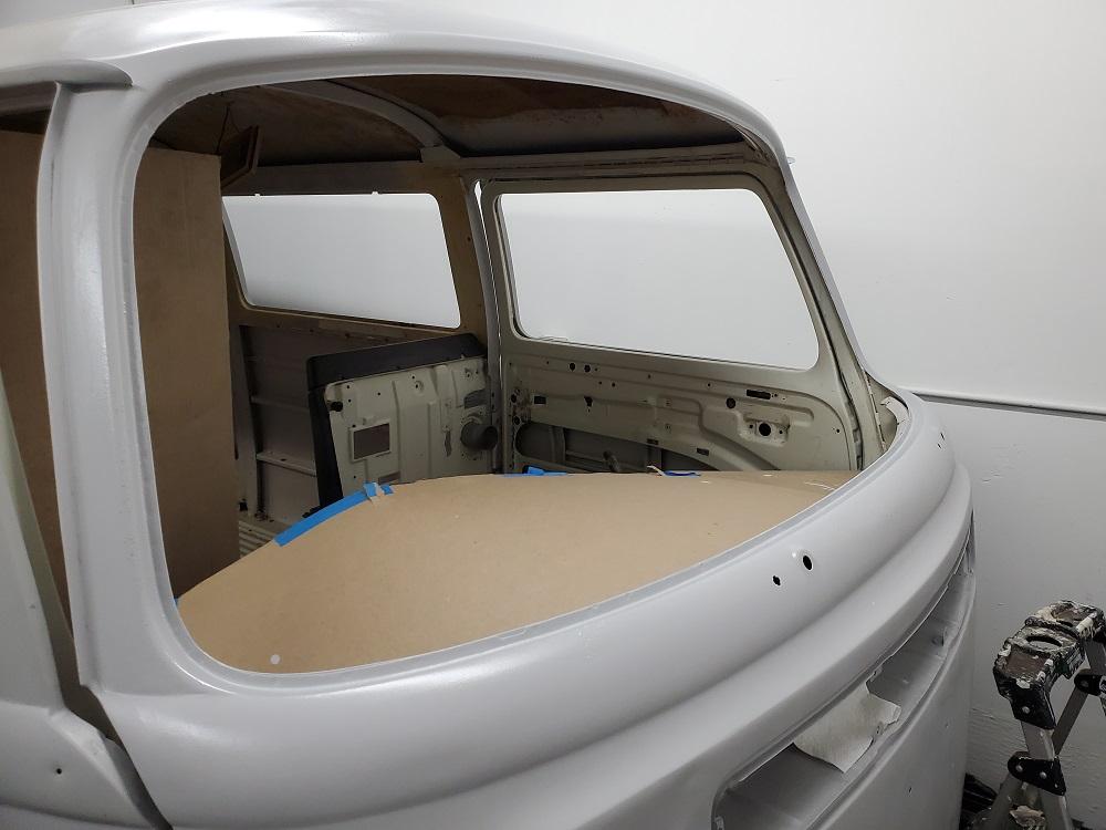

I noticed this too on the last one I got. I used my bead roller to correct this. Also, the sill is not as deep. This Klassic Fab piece doesn’t fit all that well when installed as is. I recommend only using what you need.
Here’s my ‘74’s repair…

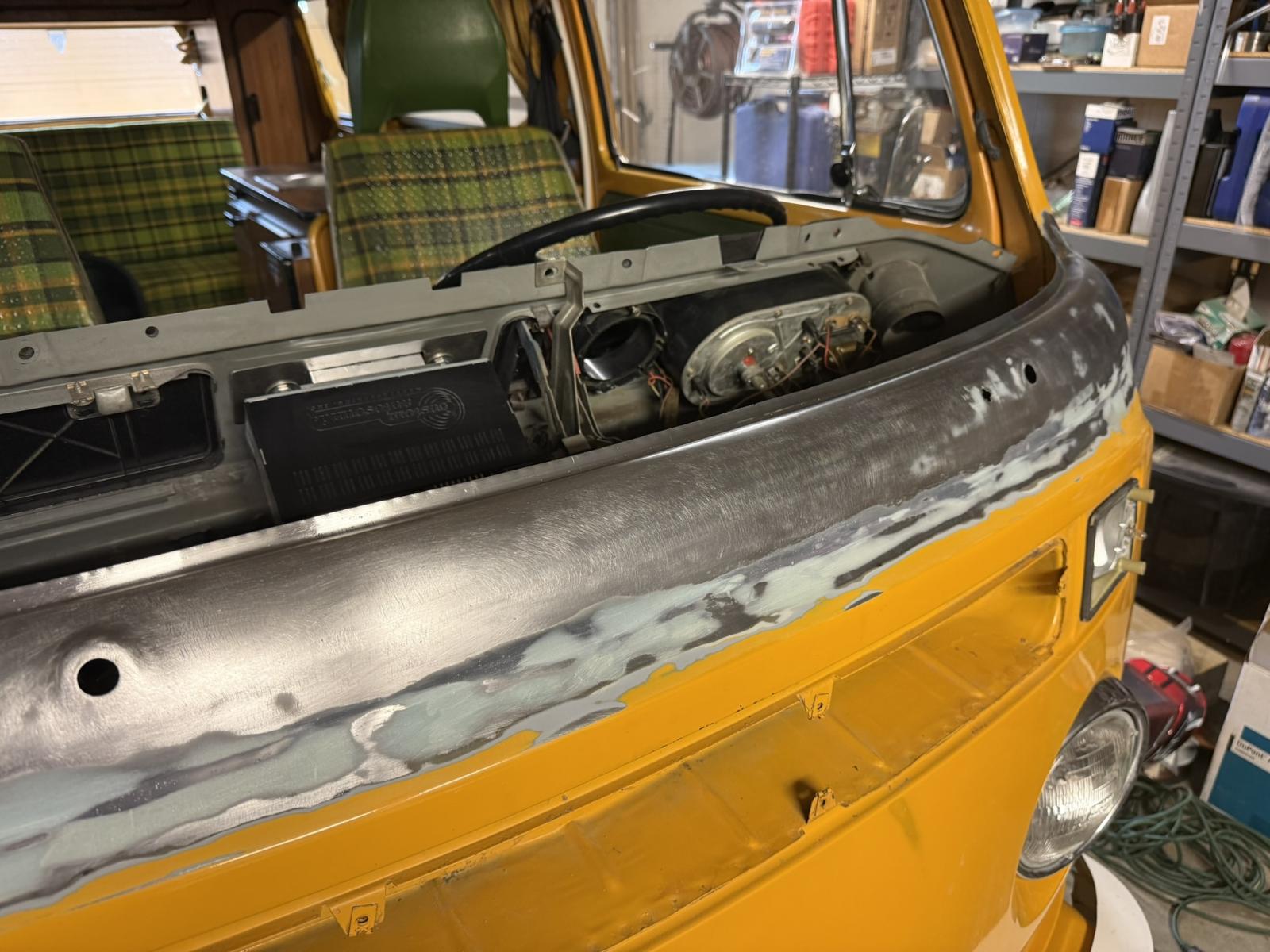

Wanted to catch up on this thread and my progress. It's been slow-going, as the boss put a stop work order on the bus this winter to do some house projects.
In short, thanks to you guys and a buddy I took the plunge, set my balls on the table, and cut into the front of the bus.
I ordered the patch panel from Klassic Fab, and we cut the bus away based on what was still good and what the patch panel consisted of. You can see what looks to be a bunch of JB Weld oozing down the inner surface on the passenger side from the previous "repair" ...
We trimmed both the patch panel and the bus to make a good fit and clamped it into place. We measured at 5 locations in the windshield opening before cutting out the old. Then those measurements, in conjunction with using the wiper arm mounts, were used to locate the patch panel.
Some of you had suggested cutting the patch panel across the front of the bubble. My buddy thought it would be easier to hide any imperfections using the bottom of the bubble so that's what we went with.
Here is the piece tacked into place:
At that point my buddy left me to use a welder for the first time. Not the prettiest or best thing in the world, but stitched along the entire length:
Then got out the grinder and detailing file sander tool I bought for this job. Once ground down, I found some pinholes and proceeded to take a step backwards by blowing holes in my fresh work trying to fill in the little pin holes. My buddy came back and helped me out. I'm mostly happy with the edges, though if you look along the bottom of this first edge I might have a bit more sanding to do (though opinions are appreciated as to whether or not this is good enough):
I have zero experience so I'm really hoping that body filler will smooth out the underside seam a bit. I don't really know how perfect the metal has to be. It does wave in and out a bit as you go along the bottom and the seam profile differs a bit because my buddy had to add more weld in a couple areas to fill in the holes. I have a bit more sanding/grinding to do and think I can clean it up a bit more, but I'm also afraid to go too far. The pics don't really show the detail, though you can click on them to view a larger image...
My buddy said he'd come back and help with the plug welds that still have to be done along the top lip.
I feel... okay about this repair so far and there is obviously a very long way to go. I wish I could have done better but what's done is done I guess.

That’s looking good. I trust you did a “dry fit” of the windshield before final welding, just to be sure. Keep up the good work!

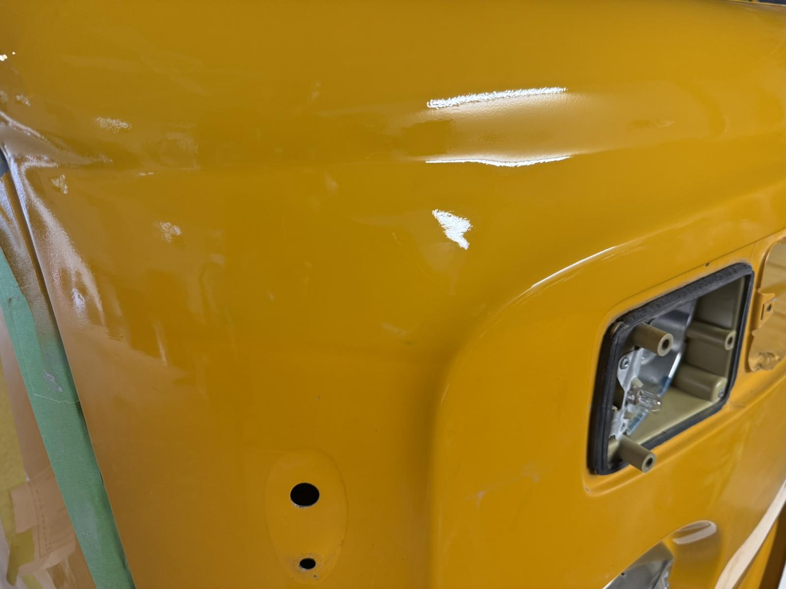

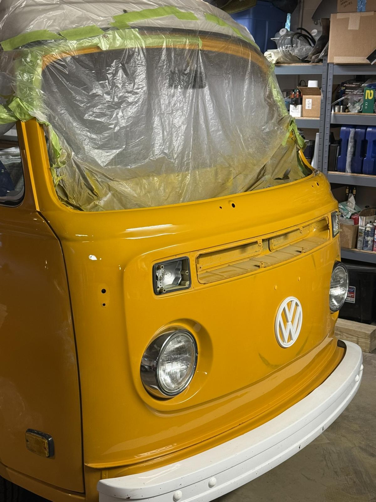

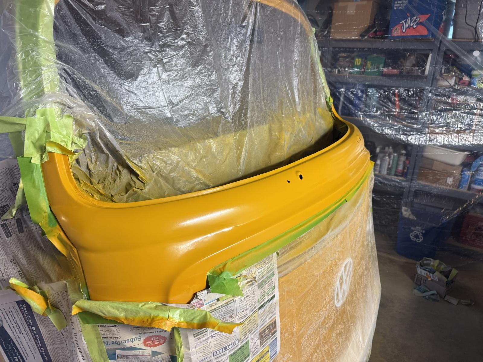

More progress pics. I applied the clear coat this evening. A couple runs that I'll sand out.
Having never done anything like this before (welding, body filler), I'd say it turned out "okay".
I'm rather disappointed in the paint match. I don't know if the problem is coverage or just poor matching from the scan of the existing part at the paint shop, or something else. This was all done with the Spray Maxx rattle cans. I'm also pretty disappointed with my shitty blending. I didn't know a good spot to blend on the bottom and my reverse tape job really didn't give the wide blend gradient I had hoped for.
Fiberglass body filler followed by Evercoat 157 filler. I went with the "less is more" mantra. Where we did the weld at the bottom made bringing back the body line literally impossible, and that is a valuable lesson learned.

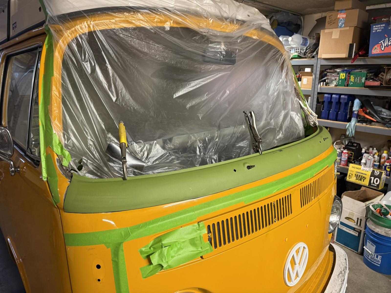

Epoxy Primer applied:
Filler Primer applied:
Somewhere during base coat application:
Final Base Coat applied:
Clear Coat applied and Spot Blender:
Tomorrow I'll wet sand the blend area and polish, then install the dashboard and front trim.
Following day the windshield. Wish me luck. New seal is already on the glass and ready to go.

Looks great from here. No one learns this stuff overnight and that is a difficult repair. You dove in and got it done.
Paint matching has never been easy and it’s gotten worse. For years, I was able to get VW orange in PPG shopline. It was always a good match to the factory color and consistent over the years as I painted bits and pieces of my bus. Then they stopped making it and I had to buy it online. It doesn’t match, so I have a cab door and a slider that are a lighter shade.
Yours actually looks like a pretty good match. Spray cans can take more coats to hide and get a really saturated color coat.
