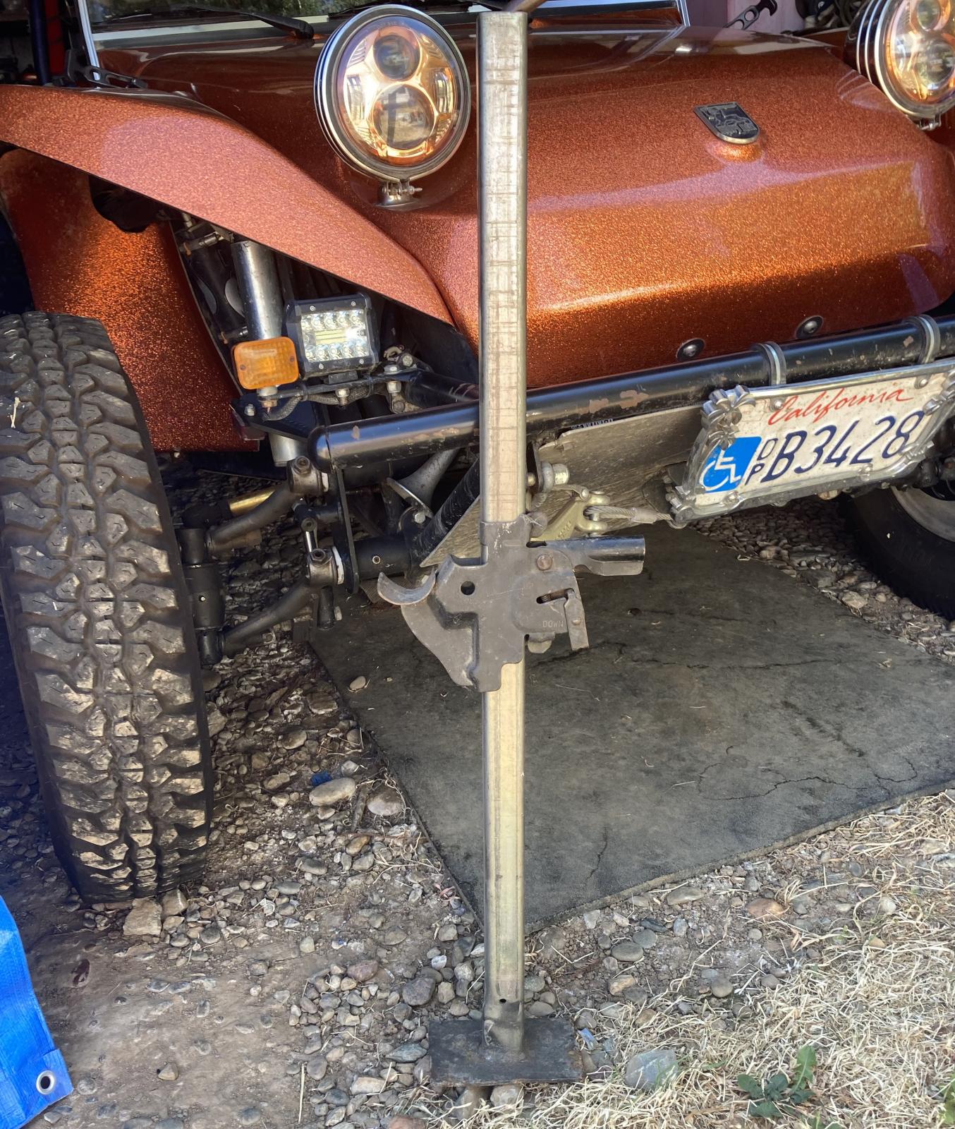

jsturtlebuggy
Joined: August 24, 2005
Posts: 4606
jsturtlebuggy is offline
PostPosted: Tue Jul 08, 2025 1:41 pm    Post subject: Re: Jacks & Mounts Reply with quote
These are what I used for my buggies
It is a modified bumper jack.
The saddle part is a 1/2 piece of 1-3/4 tubing welded where original hook for bumper would be. This one has flat plate welded to bottom, other ones I have uses the stock part that fits on bottom of jack.
They are lighter then a HiLift jack.
They are getting harder to find
