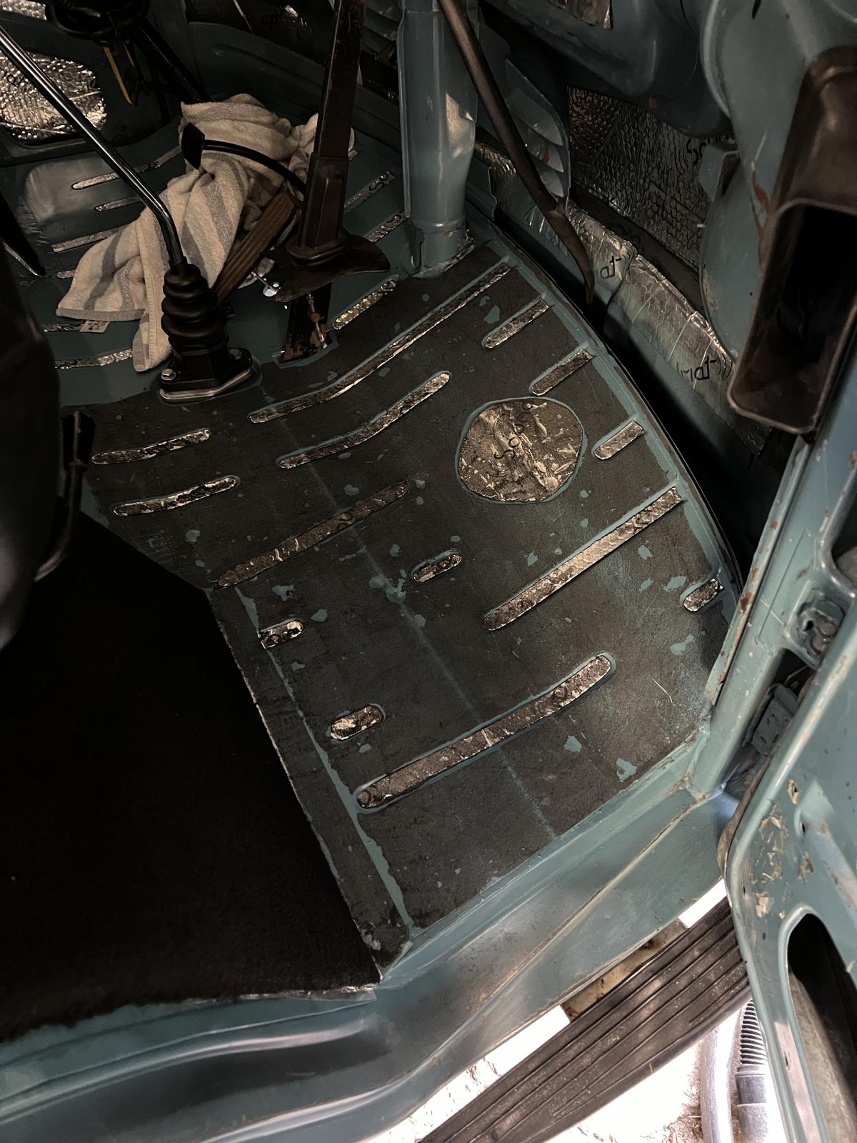

I'm not happy with the Dodomat on the cab floor, but the mice like it apparently.
So it's coming off and I'm sound deadening the complete cab floor.

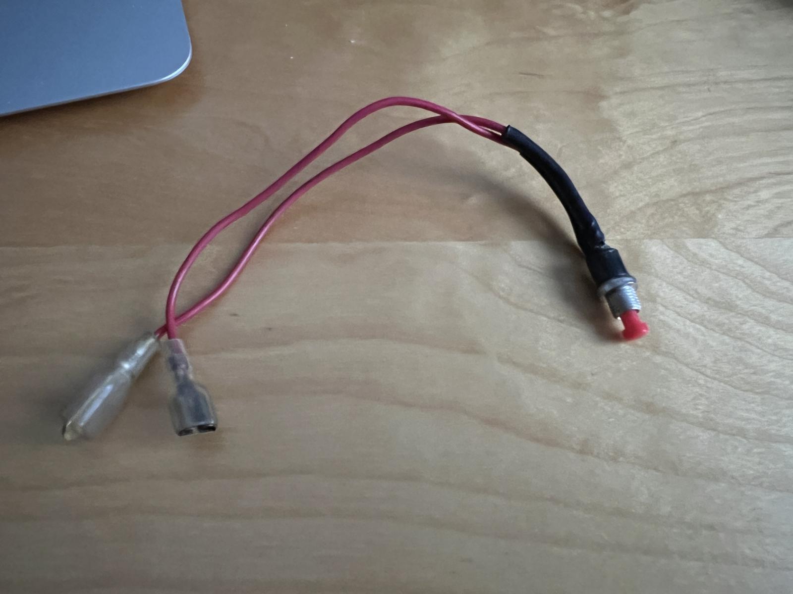

I've converted the wiper/washer switch to run the electric washer pump.
Details on this link here
https://earlybay.com/threads/how-2-convert-your-stock-washer-air-switch-to-electric.18970/page-2

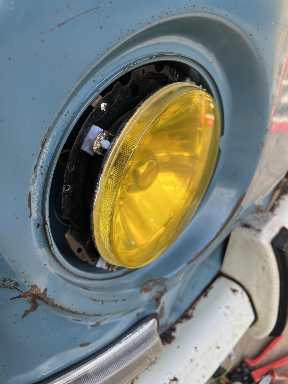

Headlights are in, I'm using Mk I Golf/Rabbit units.
And Euro tail lights

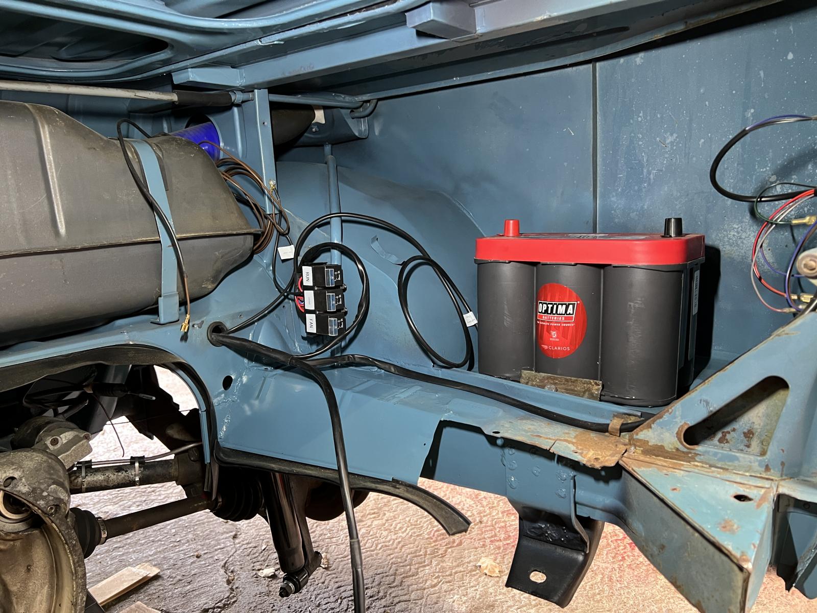

Electric fuel pump, cut off solenoid and pipework.
I'm running AN-6 PTFE/teflon hose to reduce the risk of modern fuel issues.
During this job I noticed that I was missing a section of the clutch cable conduit that runs under the torsion tube.
It looked as if it was cut deliberately, but anyway, I replaced the short section and installed a new flexible conduit onto the gearbox as I was fitting the electric fuel pump mount.
Back to the plumbing, cut off solenoid under tank to fuel pump

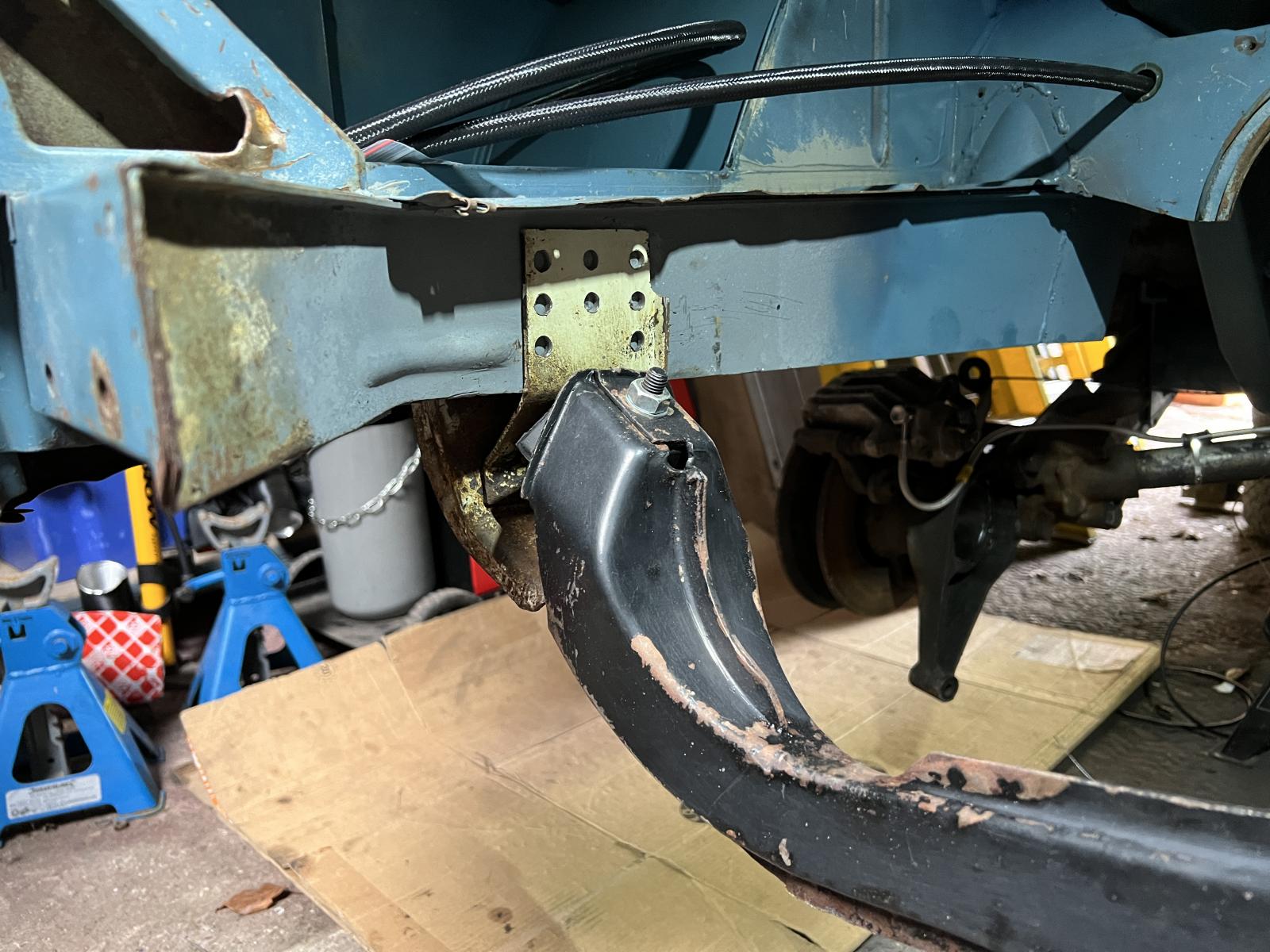

PostPosted: Tue Jul 08, 2025 5:40 am    Post subject: Re: Sept '67 (1968 MY) deluxe, another Blakes Bus Reply with quote

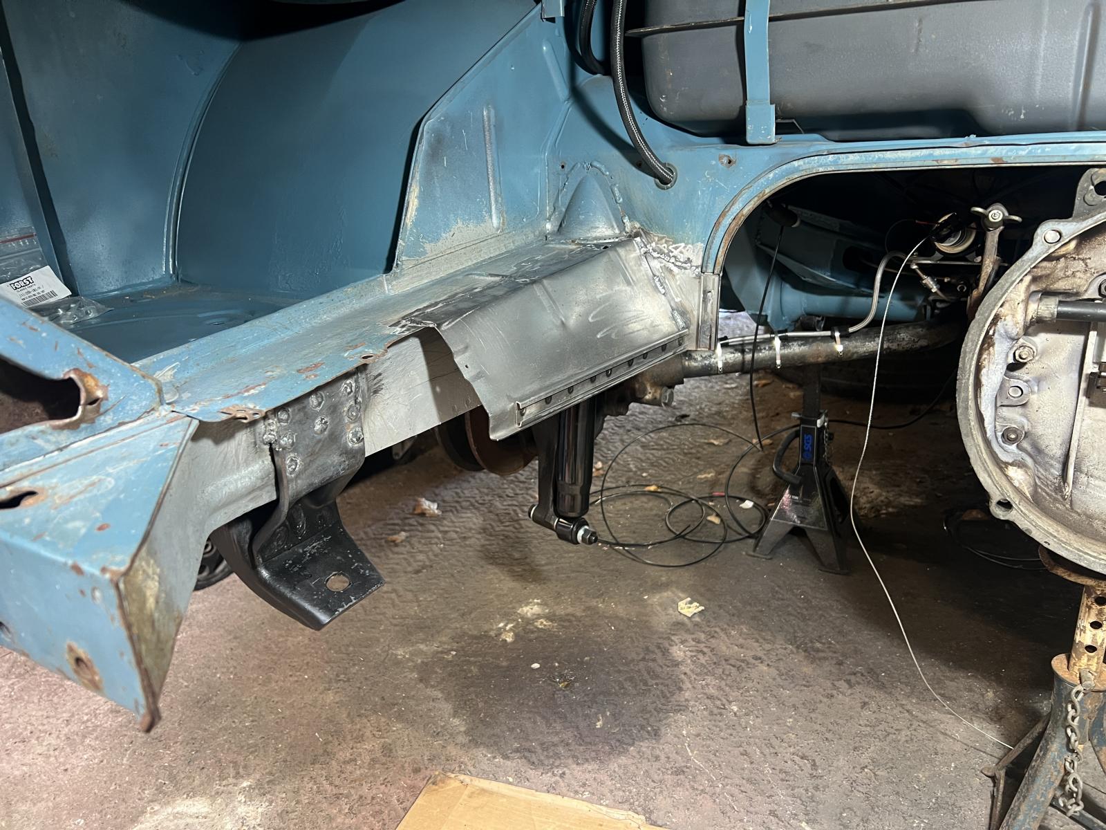

Remember that engine mock up with the later support bar?
Well, that didn't work.
The later support bar and mounts are way too wide to fit an early rear chassis, so back to an early set up.
I cut the support bar brackets off another early shell, drilled the spot welds out and shortened them until they bottomed up against the chassis leg.
So that gives me about 75mm/3" of engine raise. I've already raised the front of the gearbox about 20mm/3/4". I didn't want to start cutting into the floor to get any more room, and the gearshift still works.
The only downside is that the rear bumper brackets will have to be modified, as they slide through the support bar mounts.

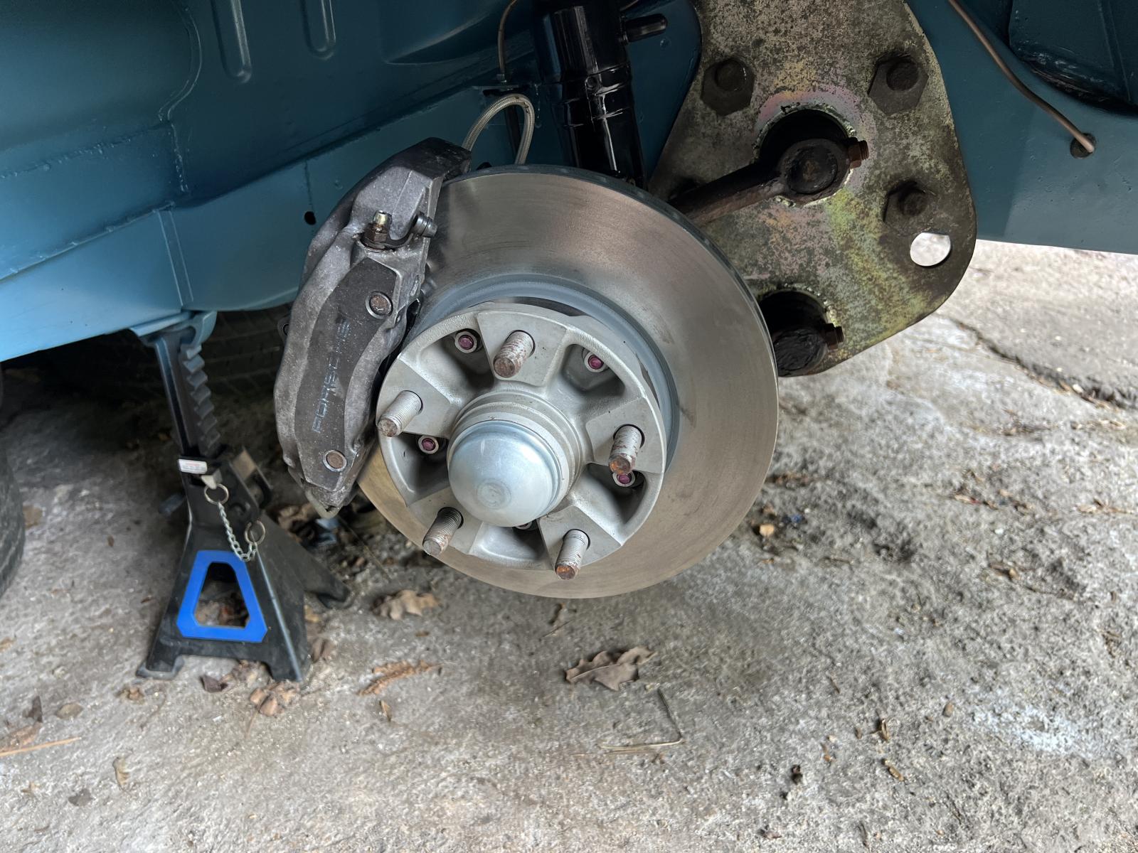

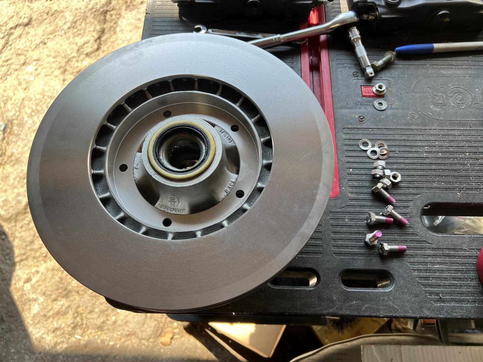

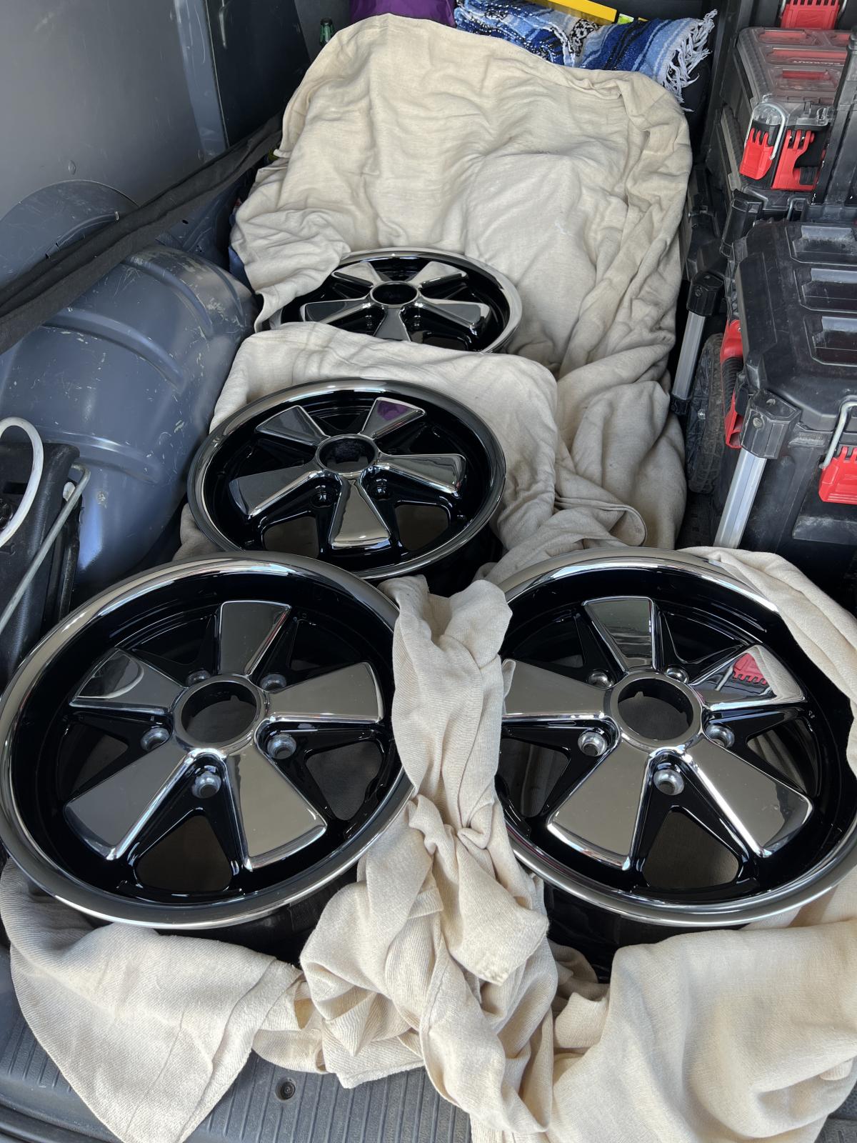

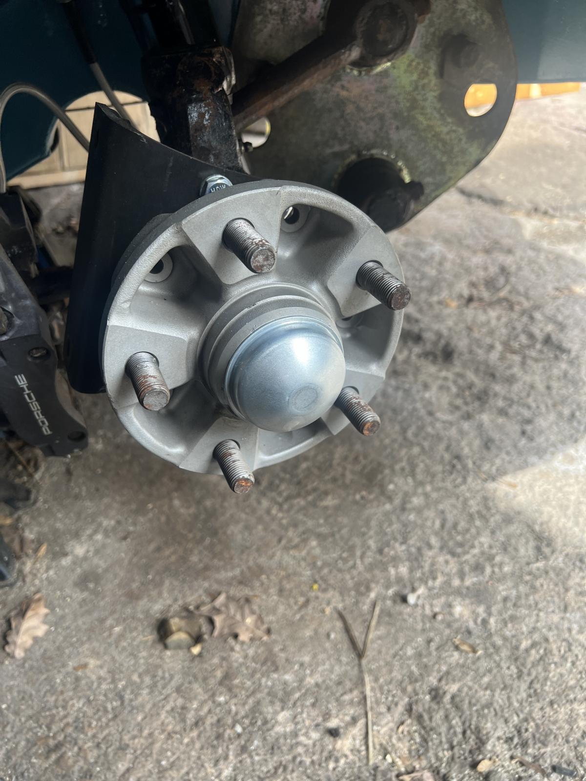

The Fuchs are being sent for detailing, so I'm stripping the existing paint from them.
And the front discs have turned up, so they can be fitted.
The calipers and then the hubs have to be removed as the discs are bolted to the hubs from the rear.
And calipers refitted.
The more eagle-eyed amongst you may have spotted the front calipers are different. That's because the early 996 calipers have a slightly different casting and interfere with the wheels.
Good job I checked.
Any way, a gratuitous shot of a bare Fuch on the hubs.

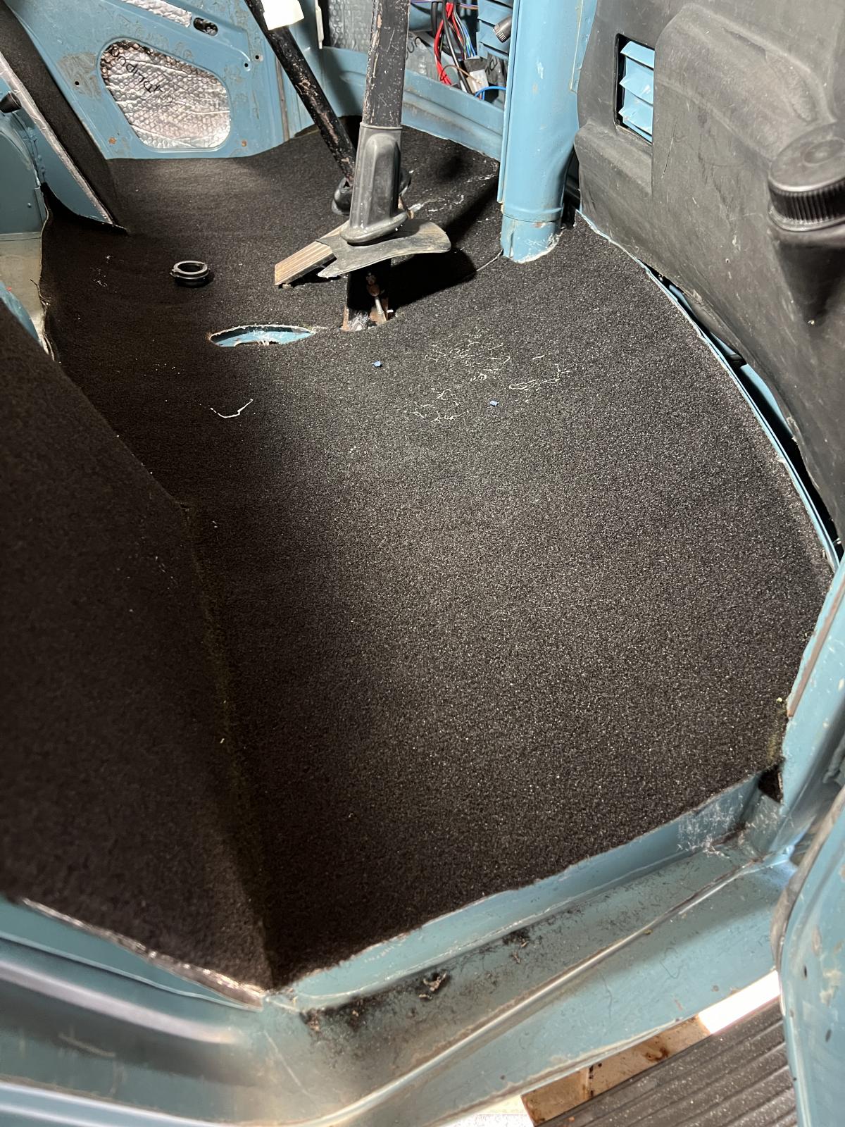

Interior again.
Mocked up a piece of 18mm ply and installed the full width Westy bed hinges.
Trimmed and glued the carpet.
Cab floor carpet fitted.

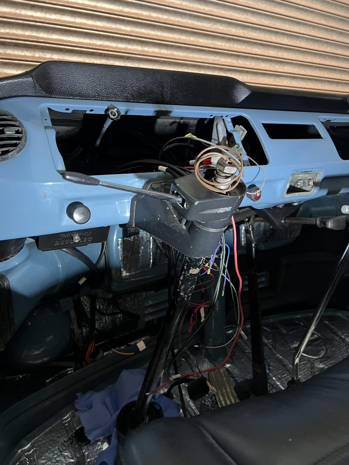

Stripped the steering column out again as the lower mount was bent, replaced it with a decent one from storage and refitted the column with the wheel on temporarily.

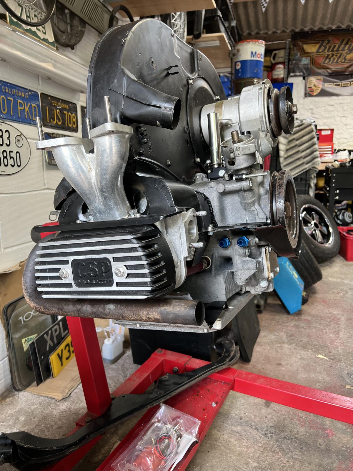

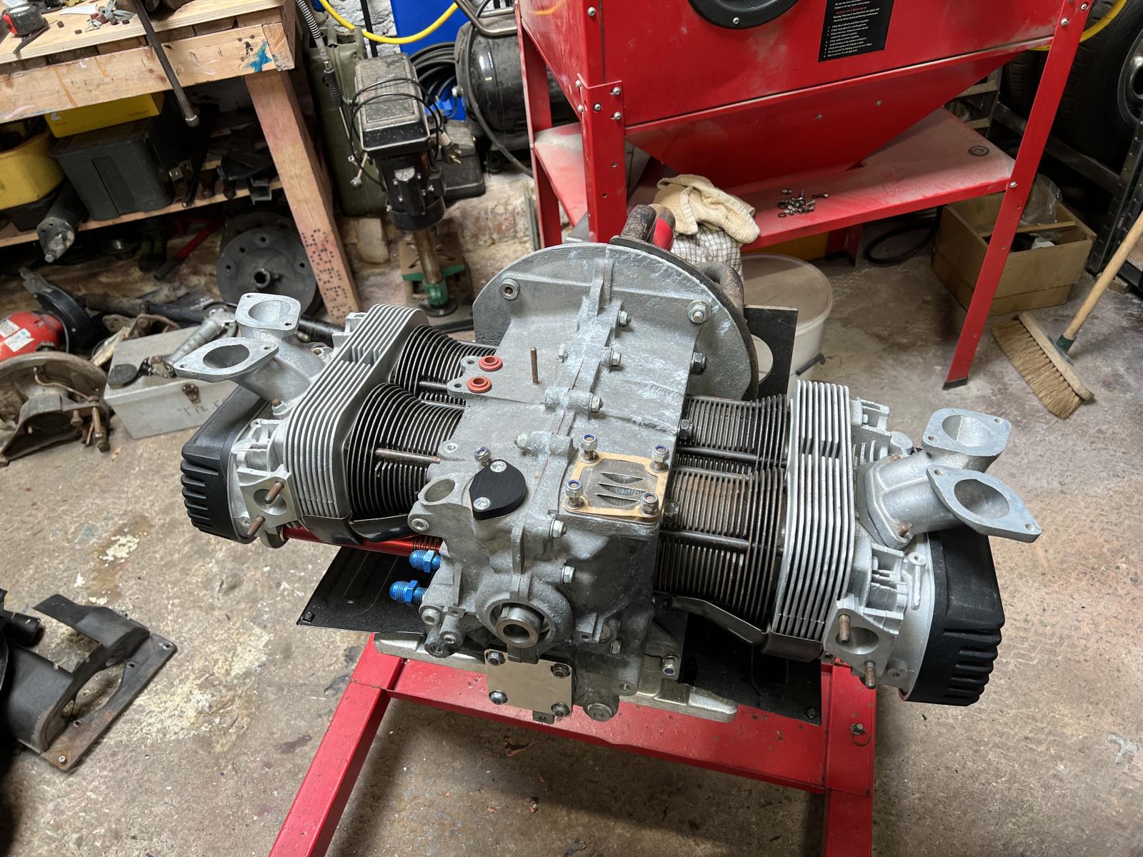

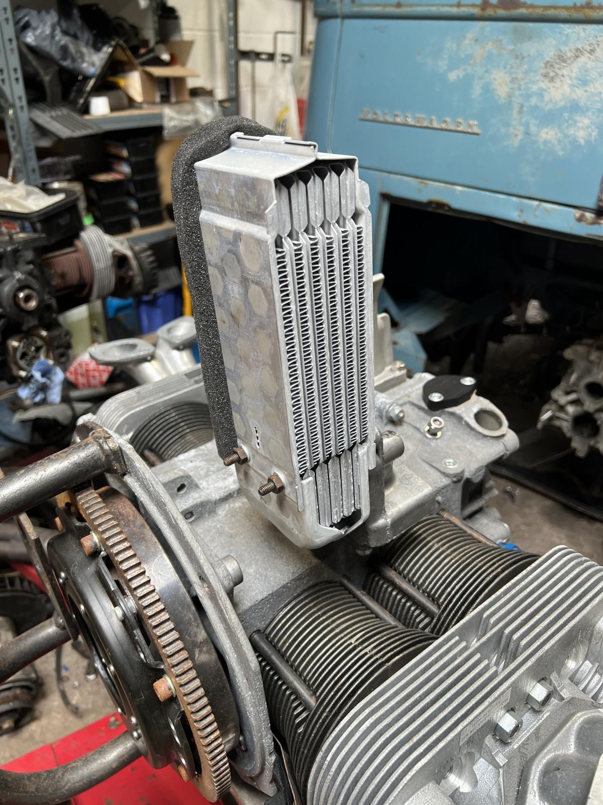

It's engine time.
Do you remember that 80x92 stroker long block that was going into my squareback?
Well, the square sold without the engine so it's being converted from a Type 3 to Type 1 and going into the deluxe.
First job is to fit an oil cooler, but as Type 3 oil coolers are laid flat on the case I'll have to cut down the mounting stud, retap and fit an adaptor to mount the cooler.
All the oil cooler seals are stuck into the adaptor using Wellseal

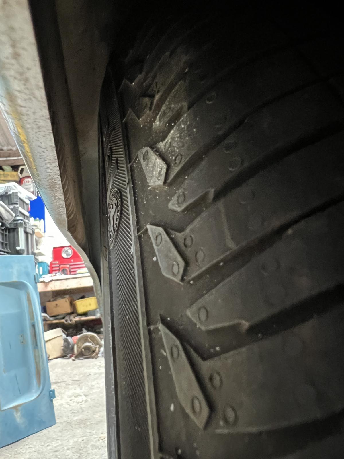

PostPosted: Tue Jul 08, 2025 6:33 am    Post subject: Re: Sept '67 (1968 MY) deluxe, another Blakes Bus Reply with quote

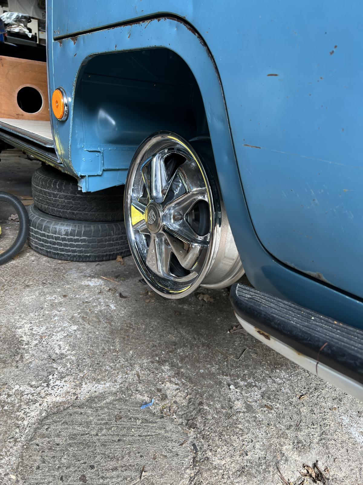

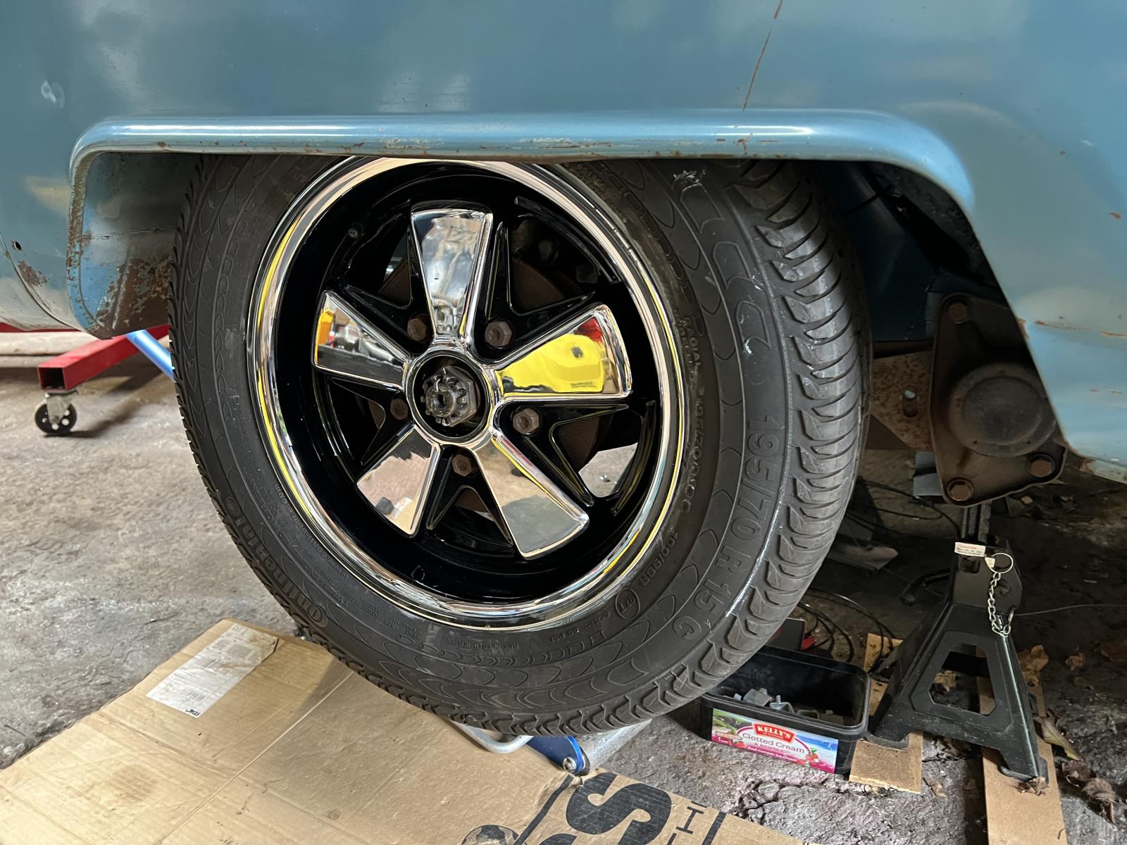

The Fuchs are back from detailing, so straight to the tyre fitters and get them on to see what they look like.
Rears - Deep 6 with Continental Vanco 195/70/15
Plenty of room
Fronts - 4.5" with Continental 165/50/15 XL

Back onto the engine, here's the spec if you're interested.
Carbs out of the box

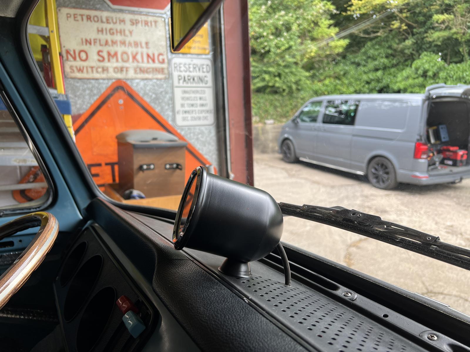

Managed to get an 1960's Veglia Borletti electronic 4 cylinder rev counter and pod.
And decided to run with black wheel nuts and bolts.
Have you seen how much Porsche lightweight wheel nuts are!!
Should've gone with chrome instead. Laughing

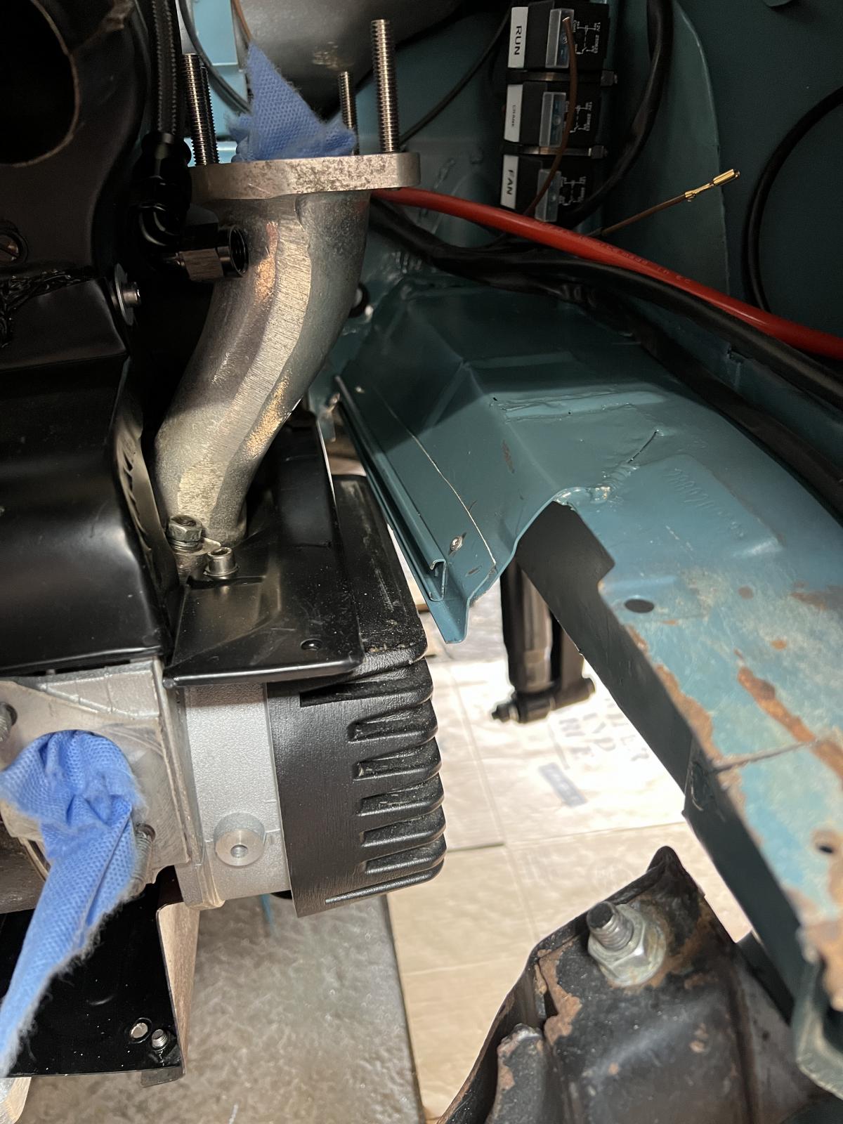

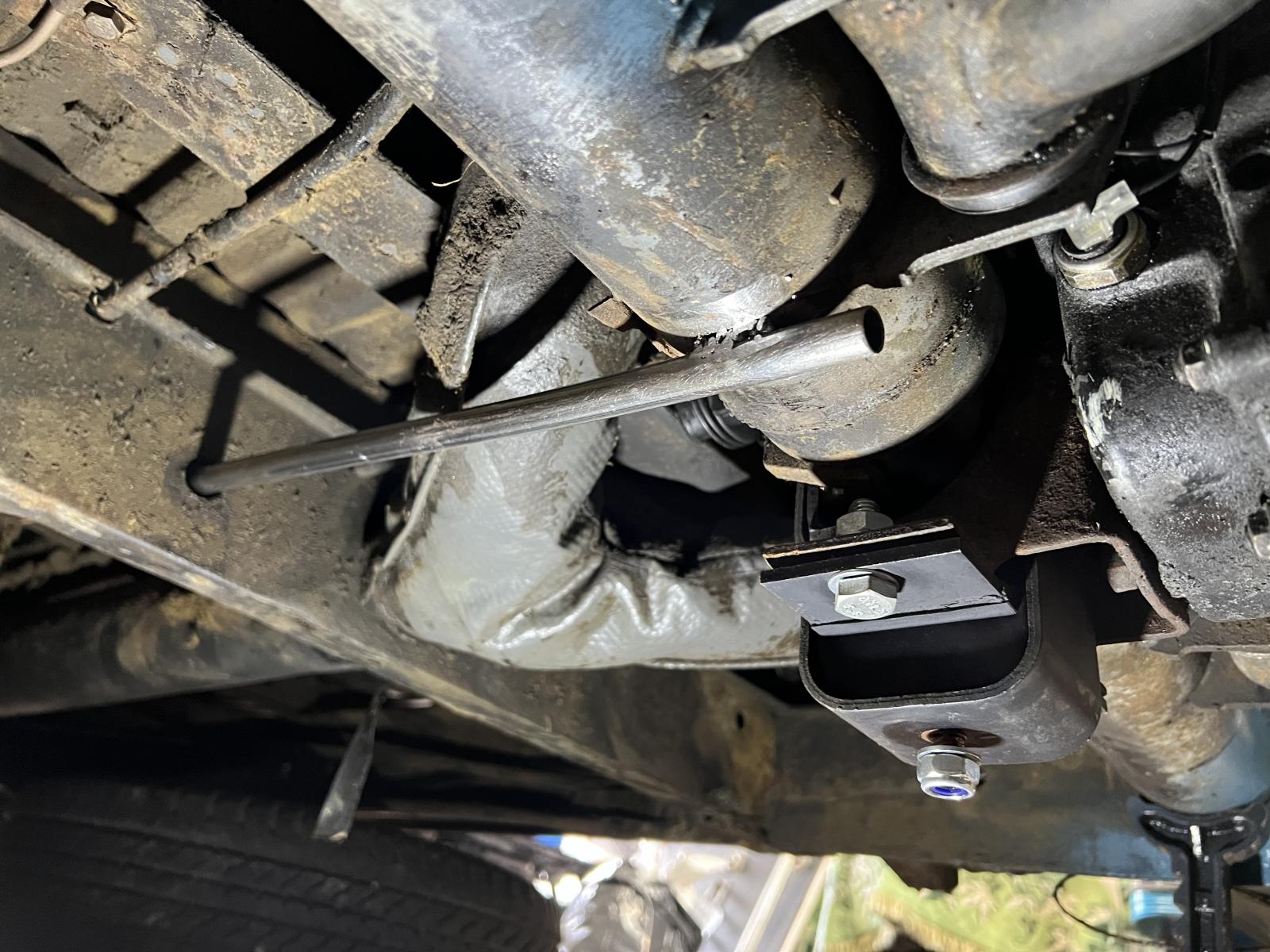

As Type 3 engines have a different dipstick set up I had to use one of these dipstick adaptors that don't fit properly.
So I modified it.
I bought a big bore (42mm/1 5/8") exhaust and heat exchangers for the squareback
But unfortunately they clash with the engine support bar, so J tubes it is for a while.

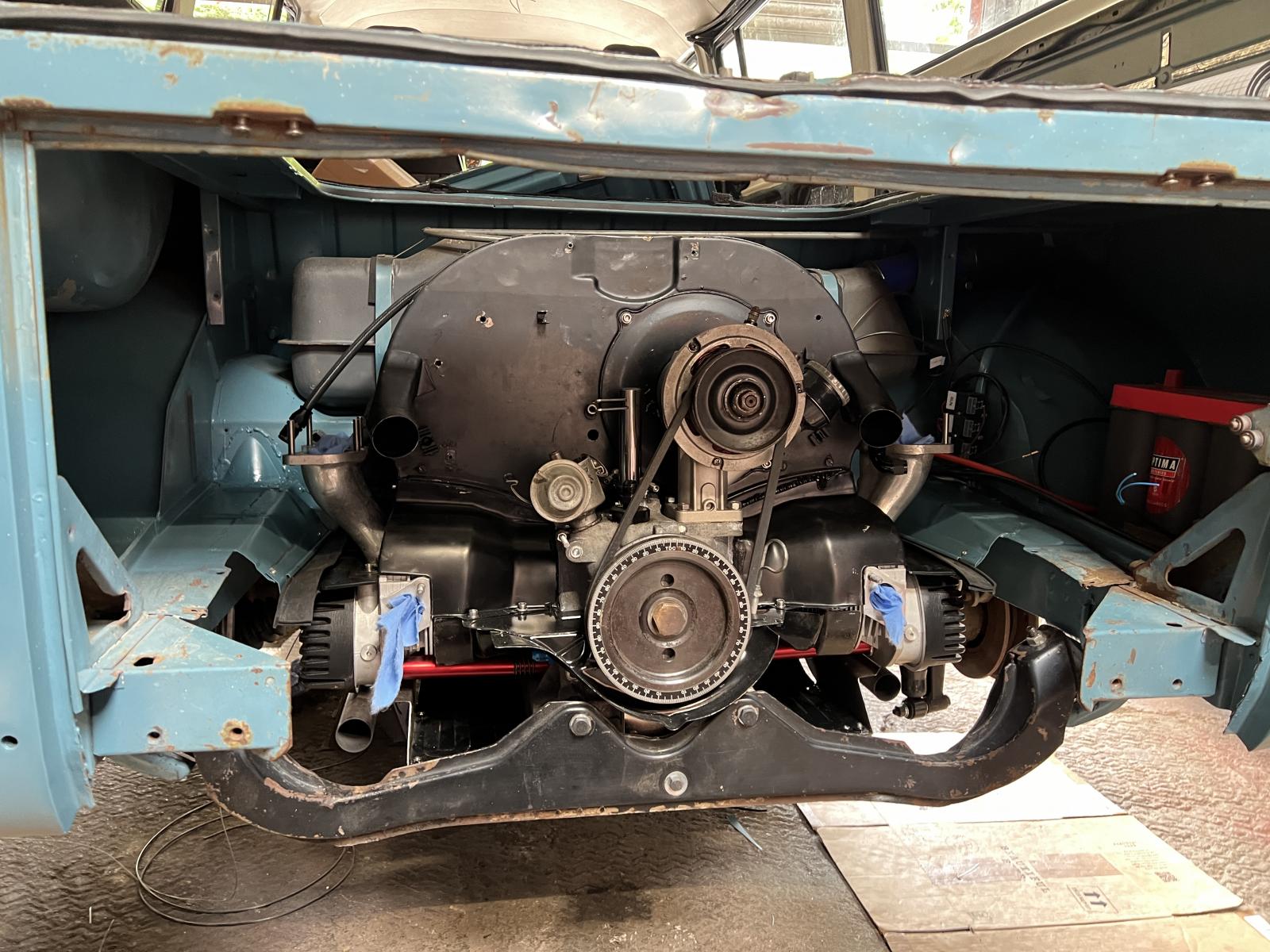

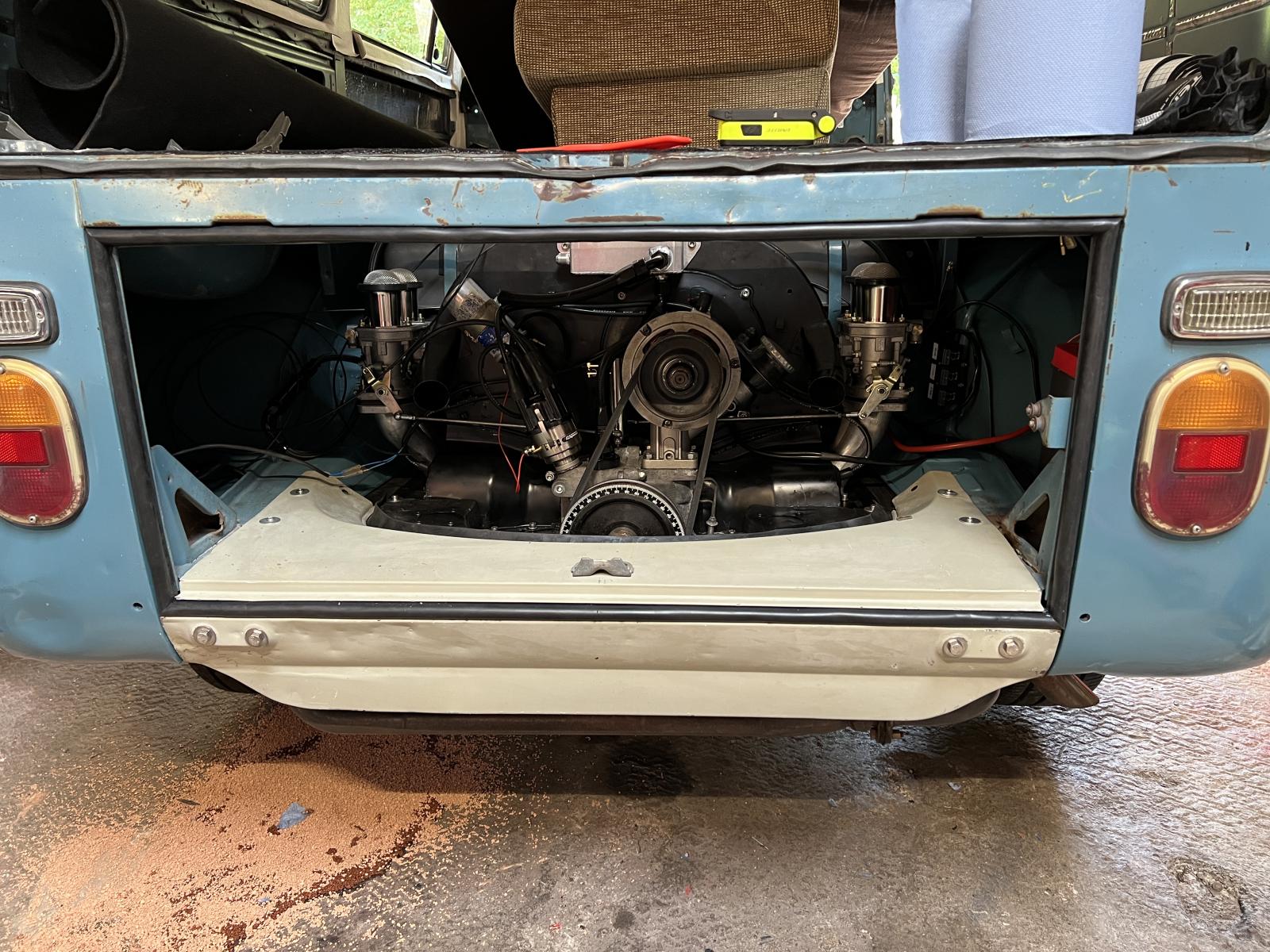

Engine install
Run into a couple of unseen issues due to the engine raise, firstly I've had to drill a hole higher up for the throttle cable tube,
and secondly I installed the engine seal panels in stock positions rather than 3" higher. Confused
They're clashing with the valve covers and stopping the engine fully mating with the gearbox.
So the recip saw has come out to trim the metalwork, and then temporarily pop-riveted back to get the engine in. So unhappy with myself about this.
But the engine is now in place.
Fuel lines and wiring connected.

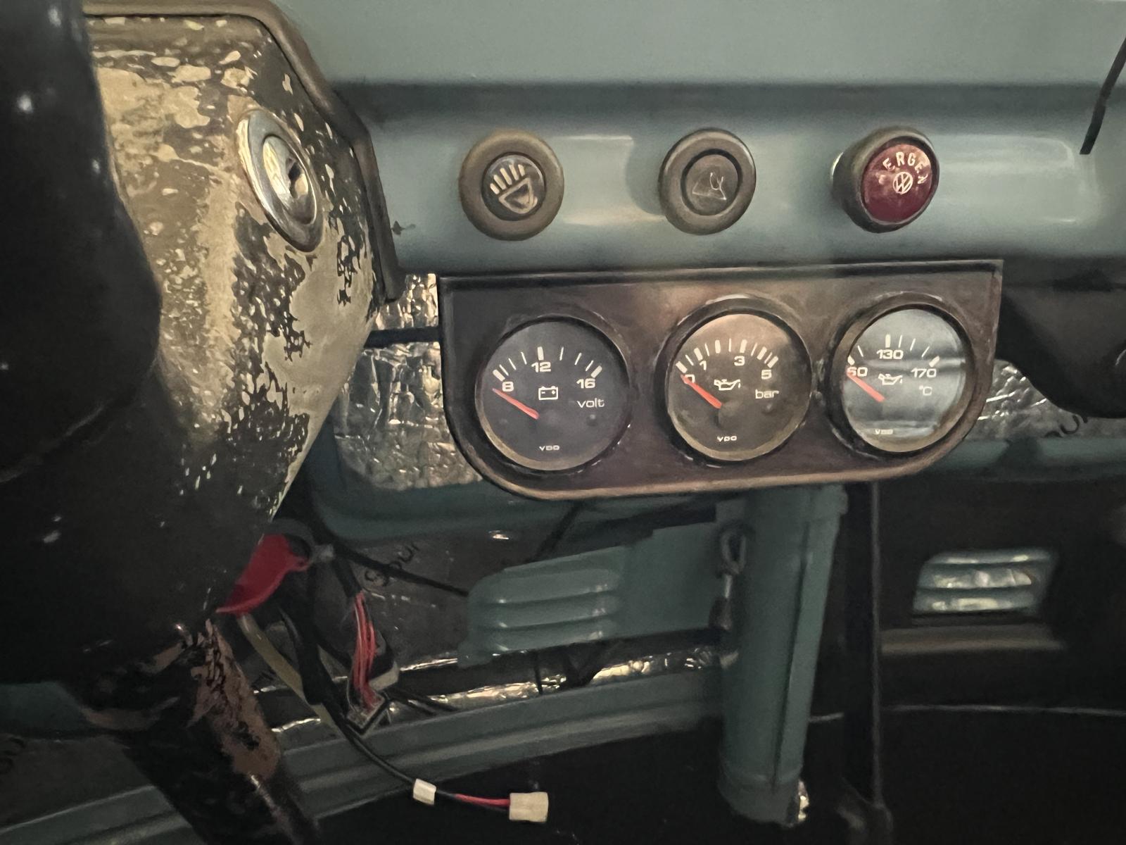

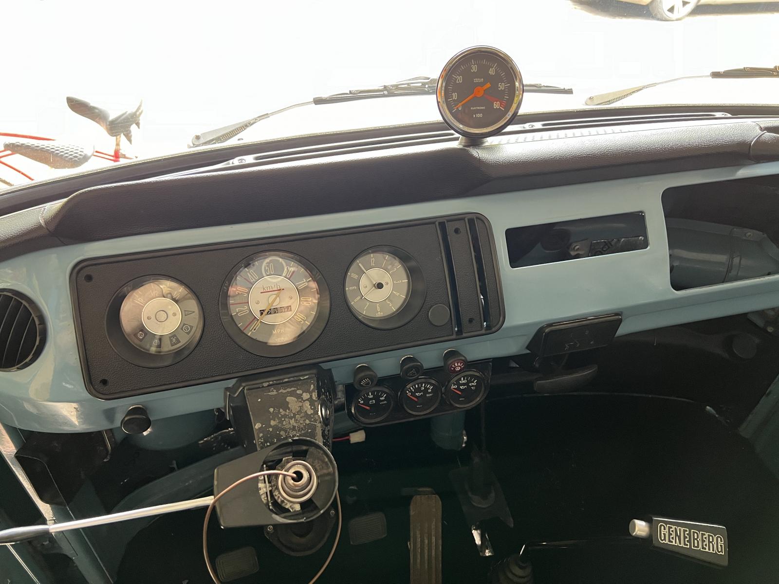

Dashpod and gauges installed and connected.
And we have power

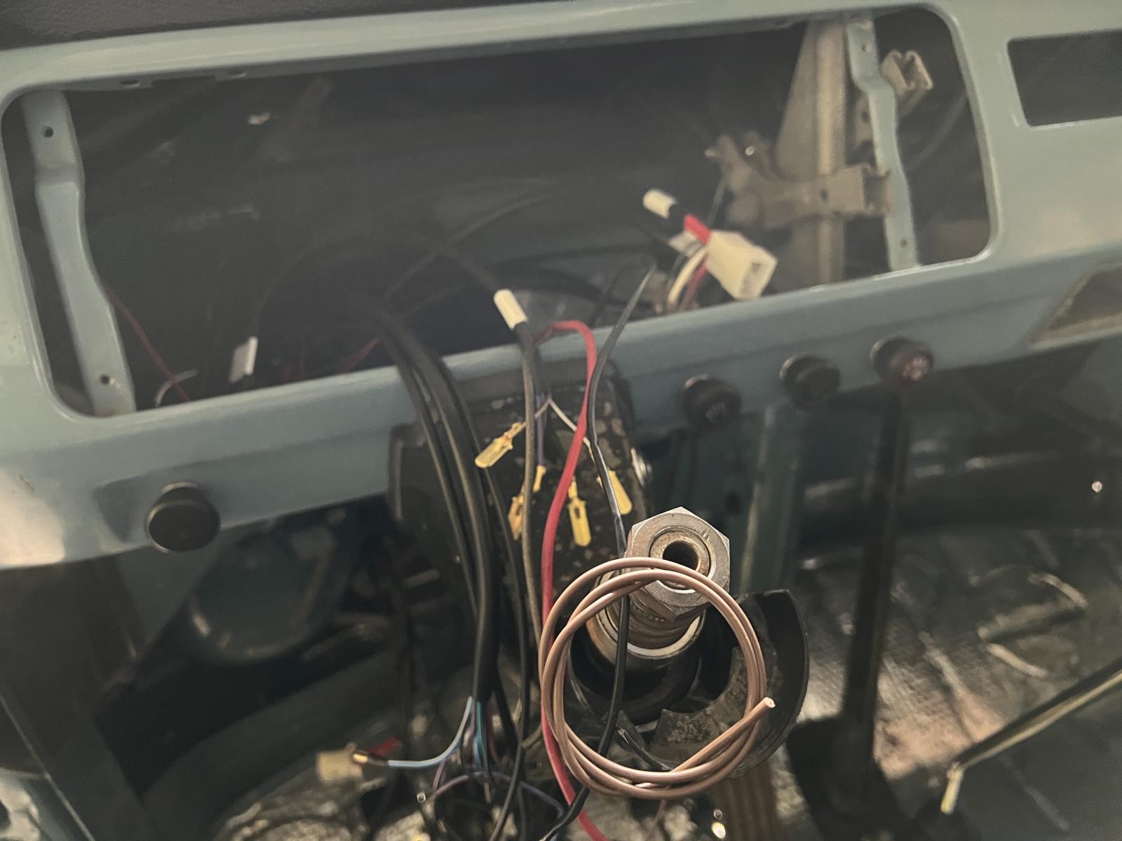

Another issue before I can try to start the engine, the repro ignition switch has failed already.
Column apart again.
And we're back

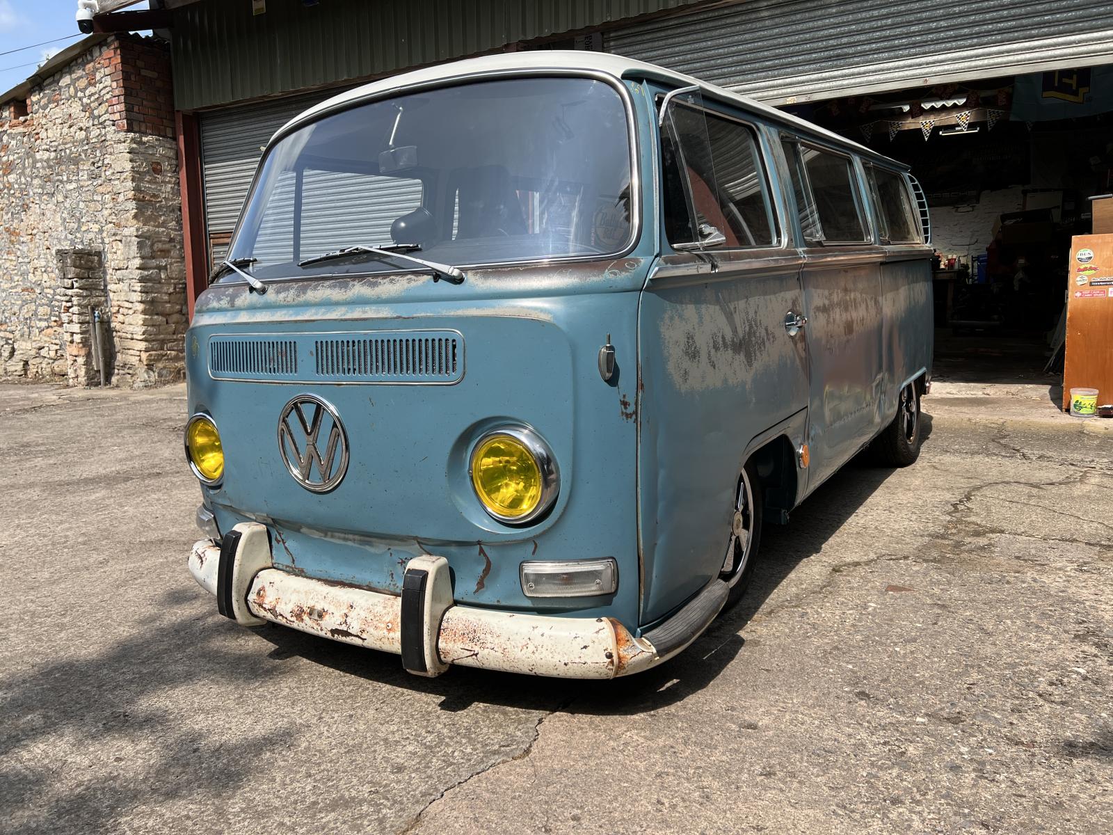

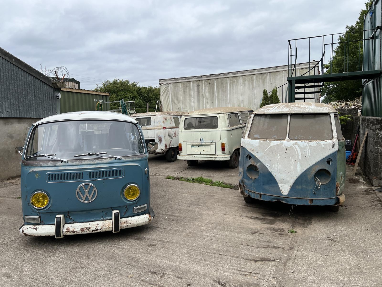

PostPosted: Tue Jul 08, 2025 7:54 am    Post subject: Re: Sept '67 (1968 MY) deluxe, another Blakes Bus Reply with quote

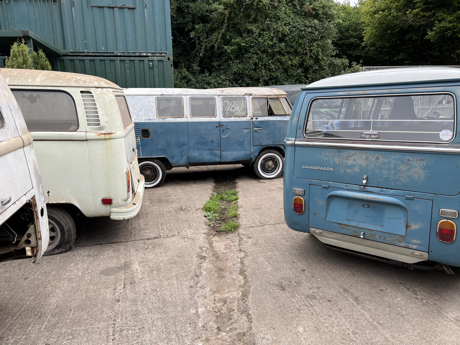

Rear valance fitted off my old bus, and engine lid.
First time outside and running.
First drive around the yard, and parked next to a couple more buses from Blakes Yard.
