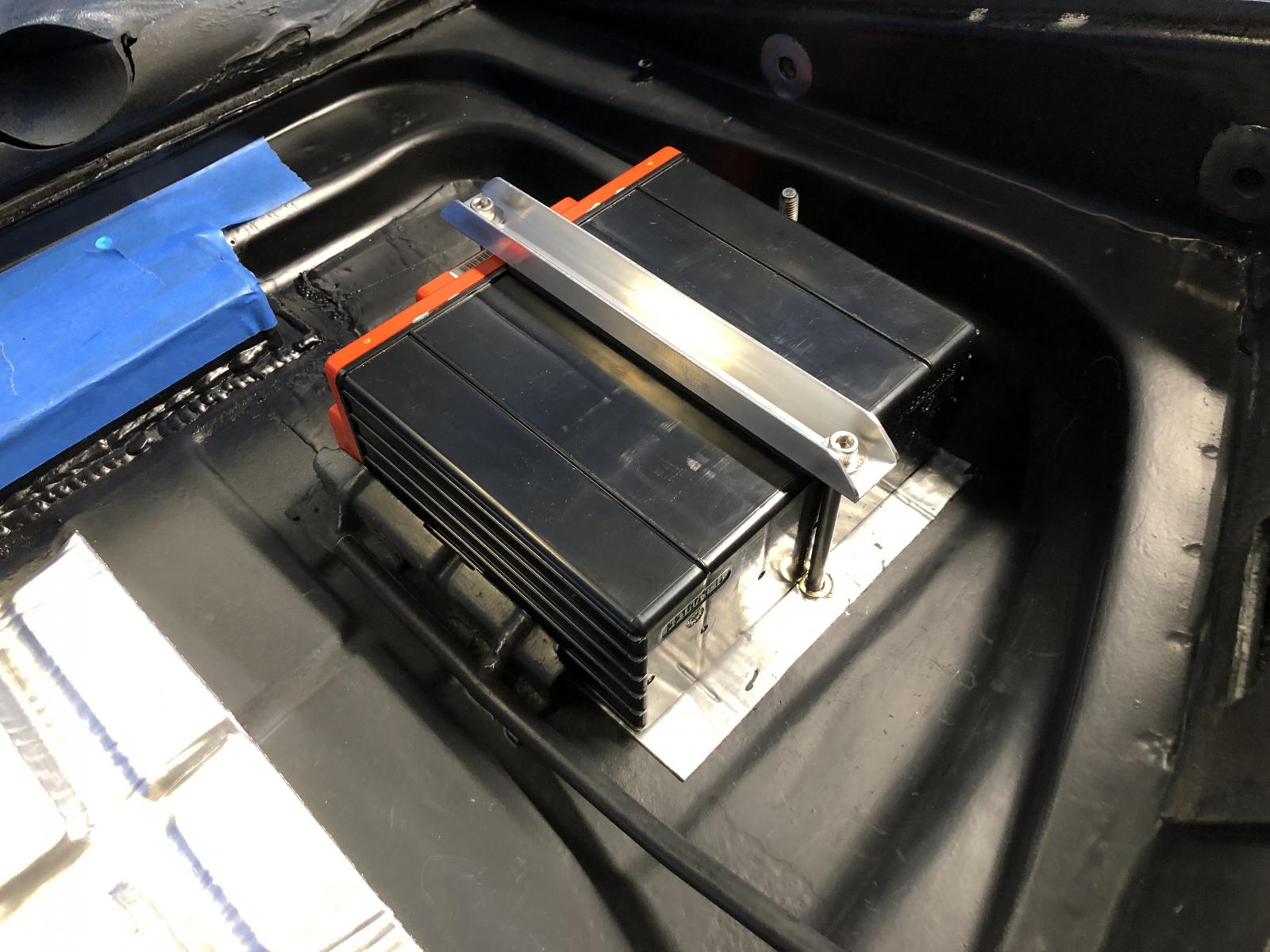

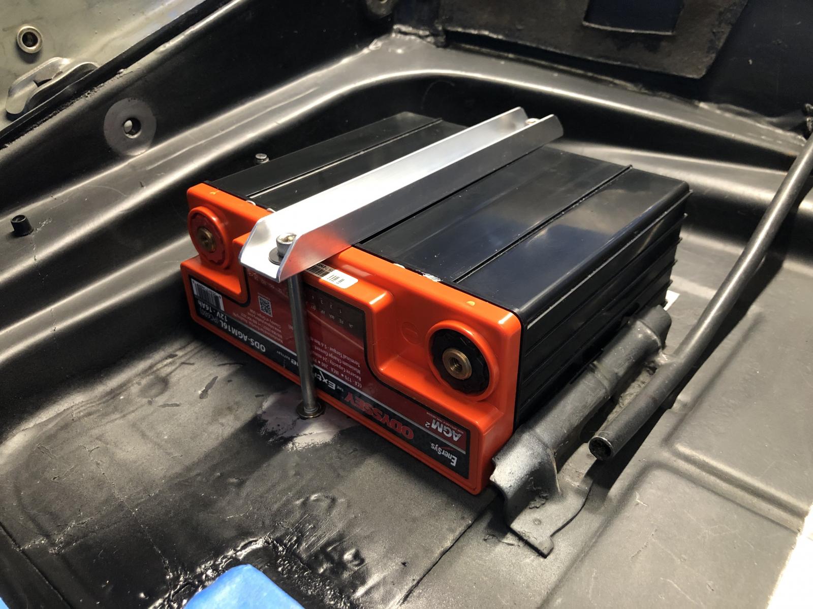

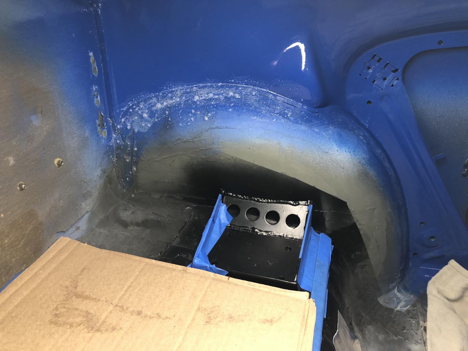

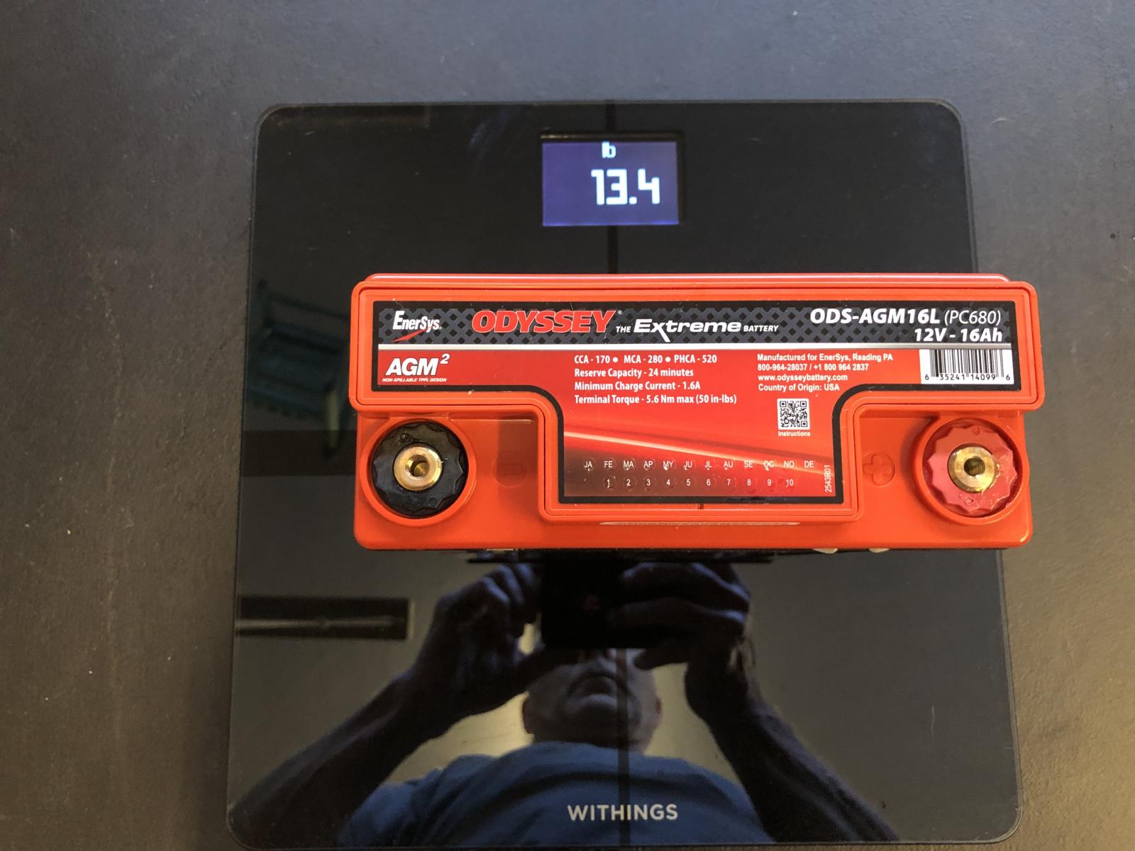

Adding Lightness…

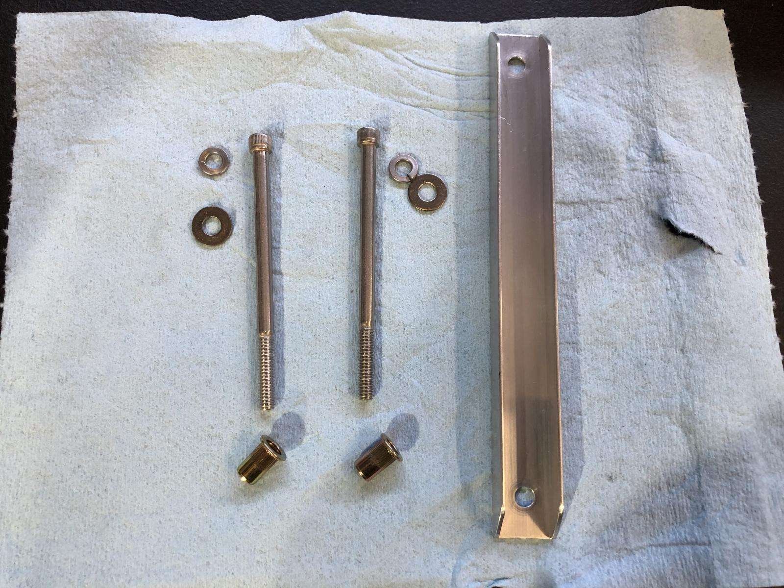

PC680 battery…I’ve used this battery several times before in other ‘hobby cars’. Works well for me.
16.6 lb reduction…
Fits perfectly between rear bulkhead and OEM battery cleat…
…no fwd/aft movement at all.
Fabricated a simple tie down…
…used 1/4-20 Nutserts in the pan…
It’s not going anywhere…
…and uber low CG! Very Happy
J.

Would that battery work in a stockish bug too? My 73 is due for a new one and I like the look and weight and price of that one compared to a traditional type.
DUNGBTL Premium Member
Joined: October 17, 2022
Posts: 509
Location: Ashland, OR
DUNGBTL is offline
PostPosted: Sun Jun 15, 2025 7:43 am    Post subject: Re: The DUNGBTL Build Reply with quote
Yes…however…
This model/size AMG (Absorbed Glass Mat) battery does not have the same reserved capacity as a more standard OEM replacement…
I’ve used this battery in several of my past ‘hobby cars’ (not daily’s) and never had any issues. This included a V8 and high compression 4 cylinder cars…driving them both in summer and winter.
That said, all these cars were garaged and had ECM controlled FI engines in top tune…and I always kept a Battery Tender on them when not in use…
Because of the reduced reserve capacity of this particular size battery, I would not use it in a 4-season carbureted AC VW daily driver that is kept outside.
J.

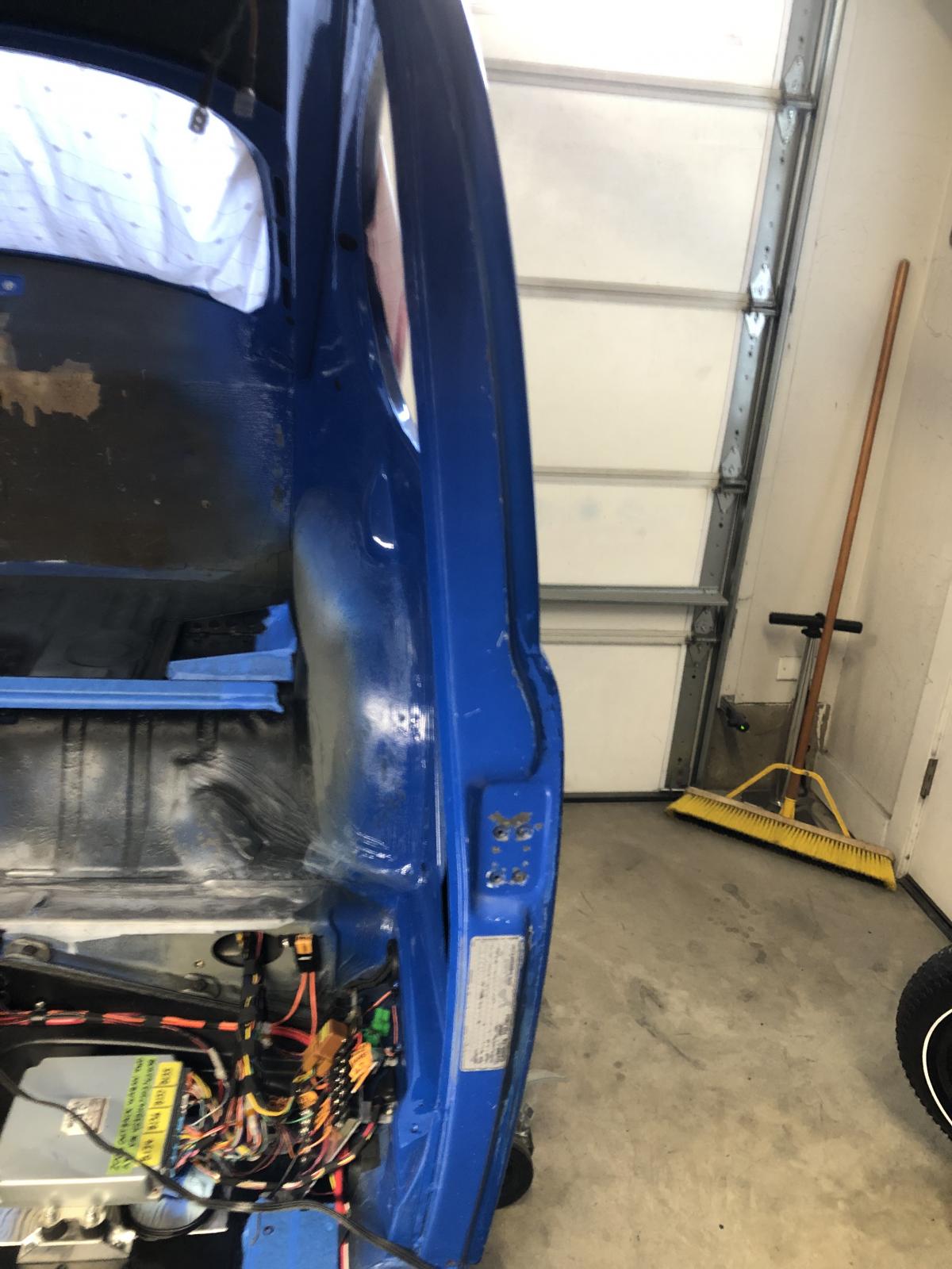

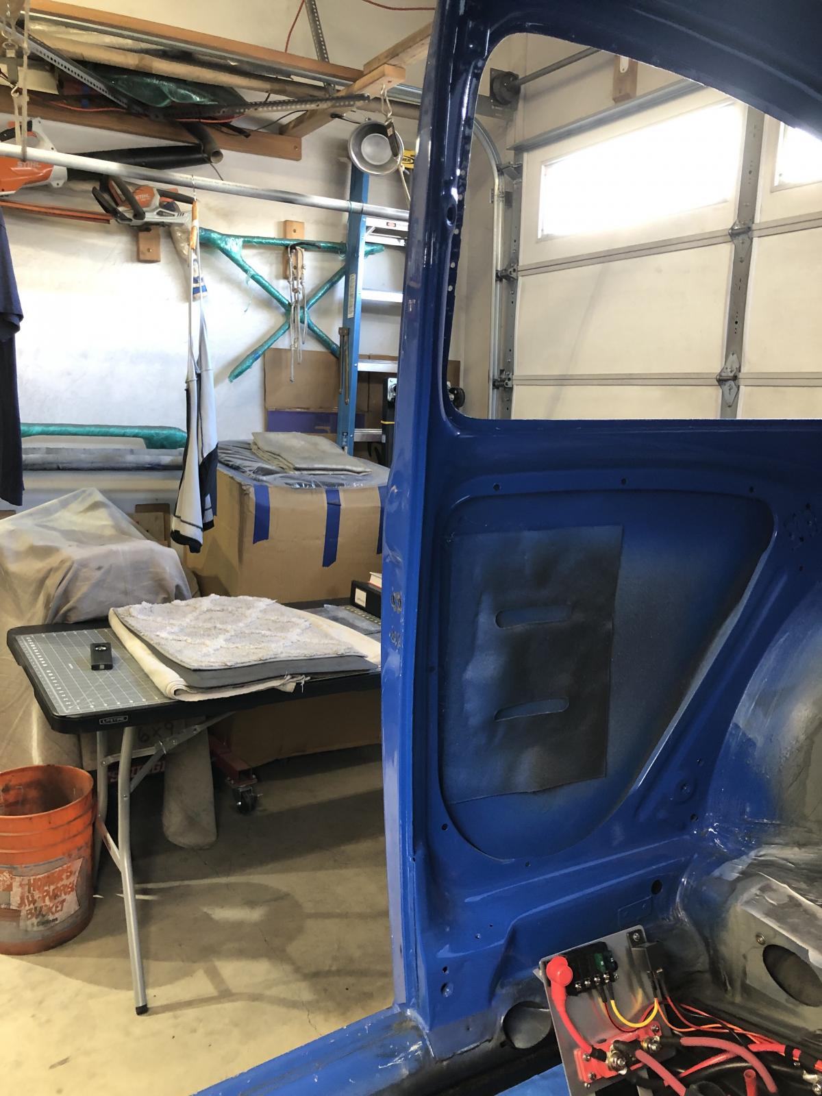

Yet more wiring…
Fabricated a mirror image (to the LHS) wiring panel for the battery side…
…to hold the electrical components that I defined in my battery side wiring diagram…
I was going to re-use this ground cable that came with the car. I cut it to length and smelled funkiness…pealed back a few strands and saw this!
Looked good from the outside but this 53 yr old cable was done!
I made some harness retention clips out of 3/4 x 1/16” aluminum strap covered with heat shrink tubing…
…attached to the heater channel…
…they keep the wires in check down the LHS.
Tidied up and clamped the wire run around to the battery and panel…
That leaves the dash gauge wiring to do:
…after which the bulk of the wiring should be done!
Still will have to make the final connections to the engine and trans (starter, reverse light and VSS) but I’d say I’m 90% done with wiring! Rolling Eyes

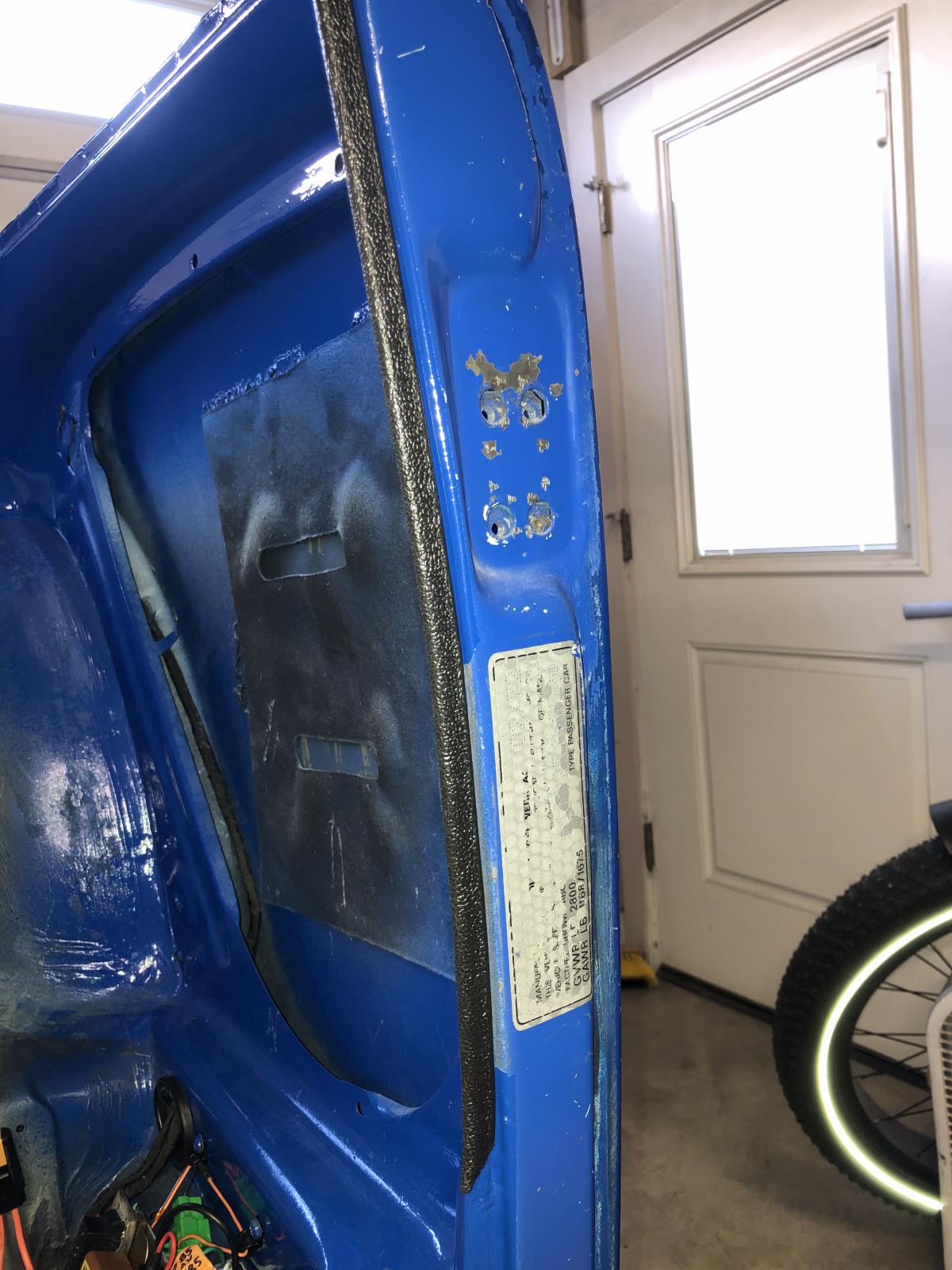

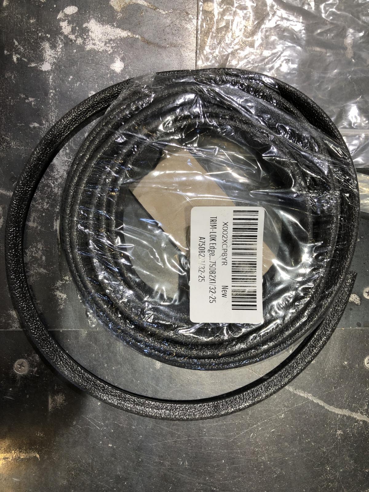

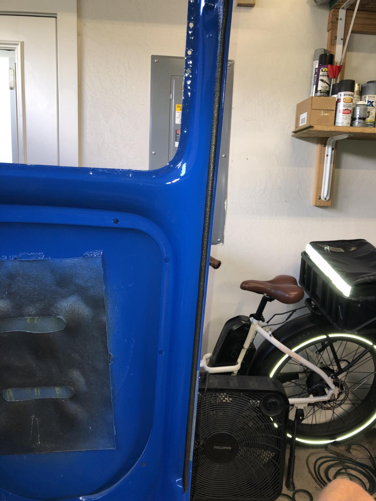

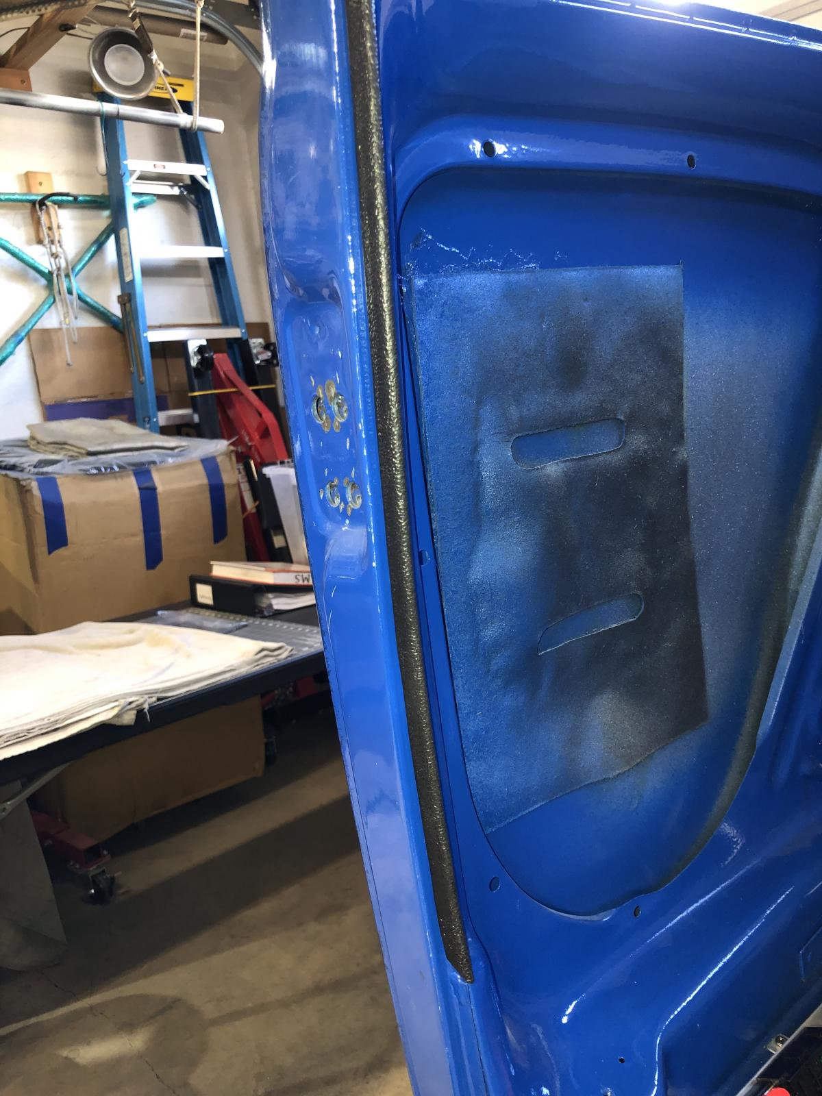

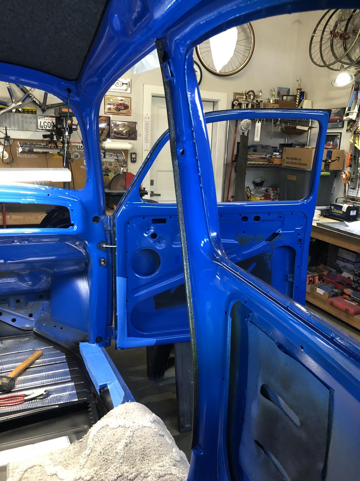

Did this today…a little thing that I found oddly satisfying. Kinda like finish work.
I’m going for a very stripped down interior look. Before painting the OEM upholstered areas, I trimmed away the ‘alligator teeth’ that gripped the factory upholstery on the door pillars. I didn’t cut the flange flush as it would have cut thru the spot welds separating the sheet metal. So it left a somewhat sharp flange…
To give it a more finished look I installed some heavy vinyl edging…
J.

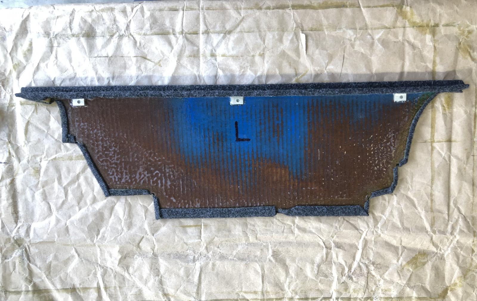

Remember the light weight composite rear seat delete close out panels I made?
https://www.thesamba.com/vw/forum/viewtopic.php?t=...;start=380 (bottom of page).
I upholstered them today. Used Porsche Perlon carpet, same as what I used for my headliner… https://www.thesamba.com/vw/forum/viewtopic.php?t=...;start=600 (bottom of page).
Panels hide all the spaghetti…
I’m pretty pleased with how they turned out and seeing some more finish work done is motivating!

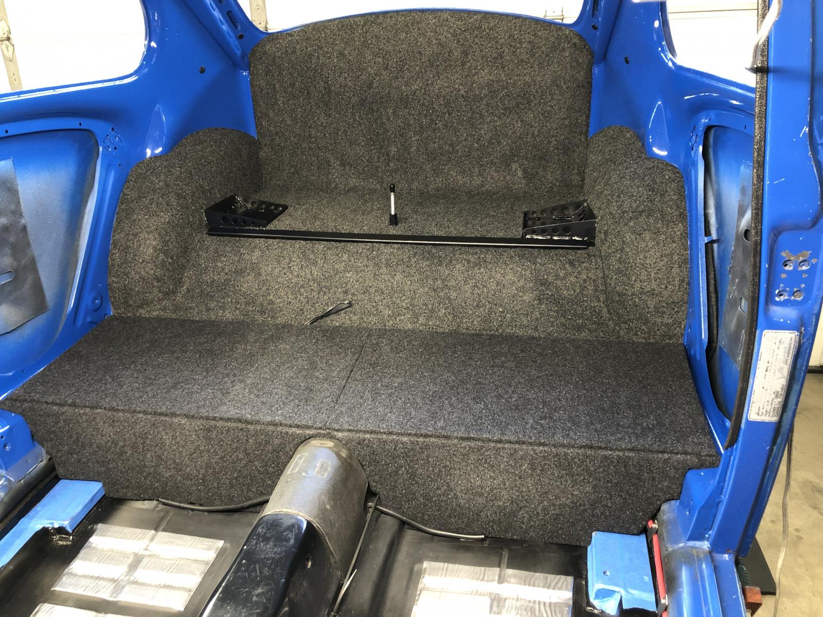

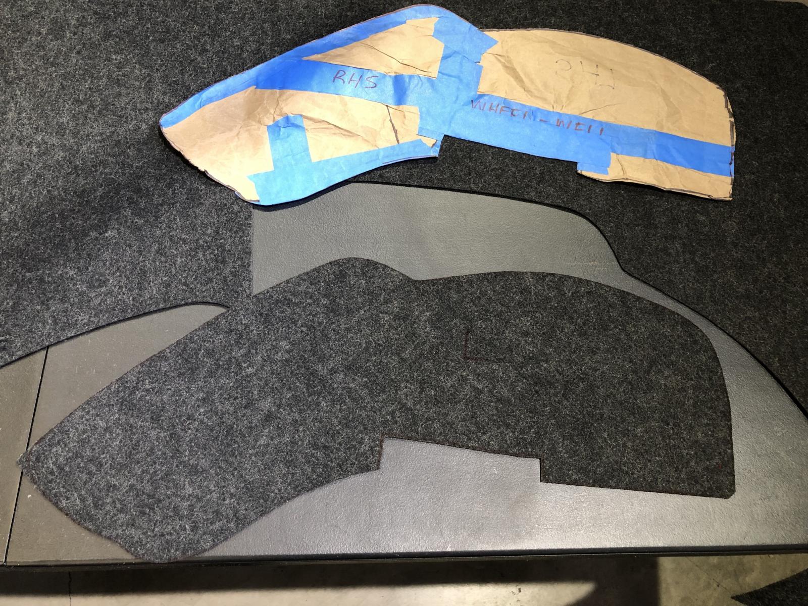

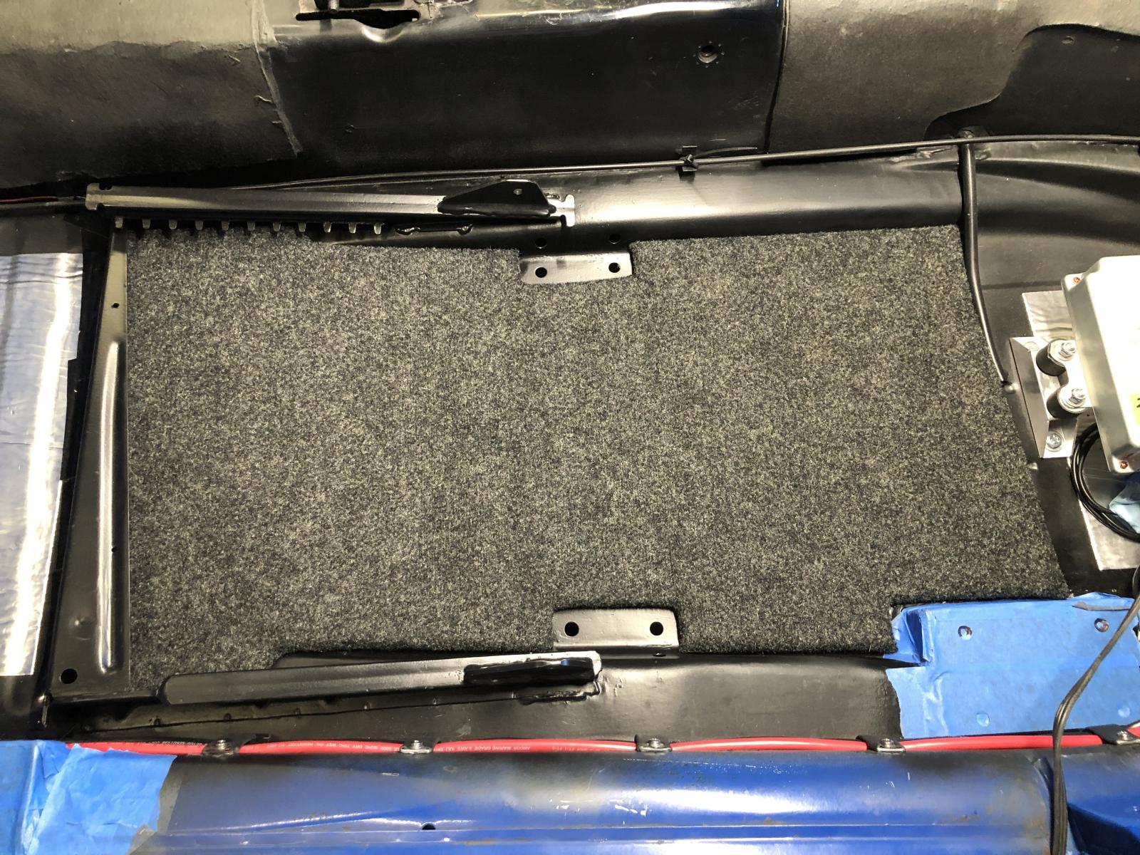

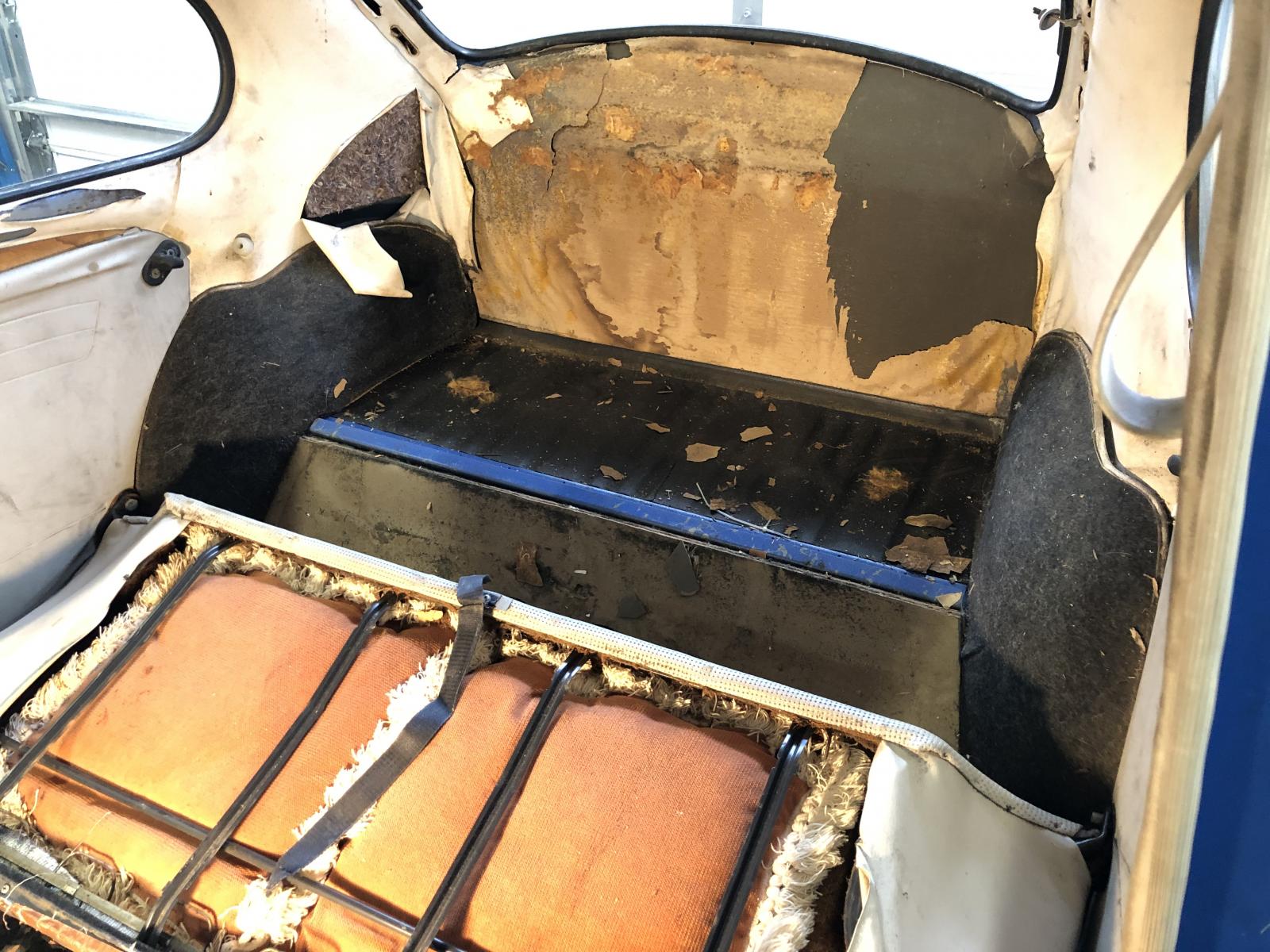

Finished the rear upholstery.
Made my own templates for my custom upholstery. Started with the hardest part…the wheel wells. I’m using Porsche Perlon carpet which, in my mind, is essentially felt with a backside for gluing. Very light weight. Porsche used it in their race cars and frunks of 356’s and early 911’s.
For the rear firewall and package tray, down to the battery & electronics bays, I used a light weight acoustic/heat barrier material called Thermozite…
…and covered that with the Perlon…
The package tray is where the Porsche full size spare will reside, ala Shelby GT350R…
Before (as purchased)…
…after…
I installed the Battery Tender remote charging chord with a hold down clamp so I can connect it with the close out panels installed…
Pretty happy with the results…very motivating!

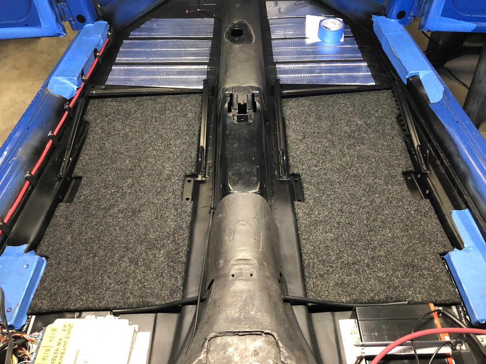

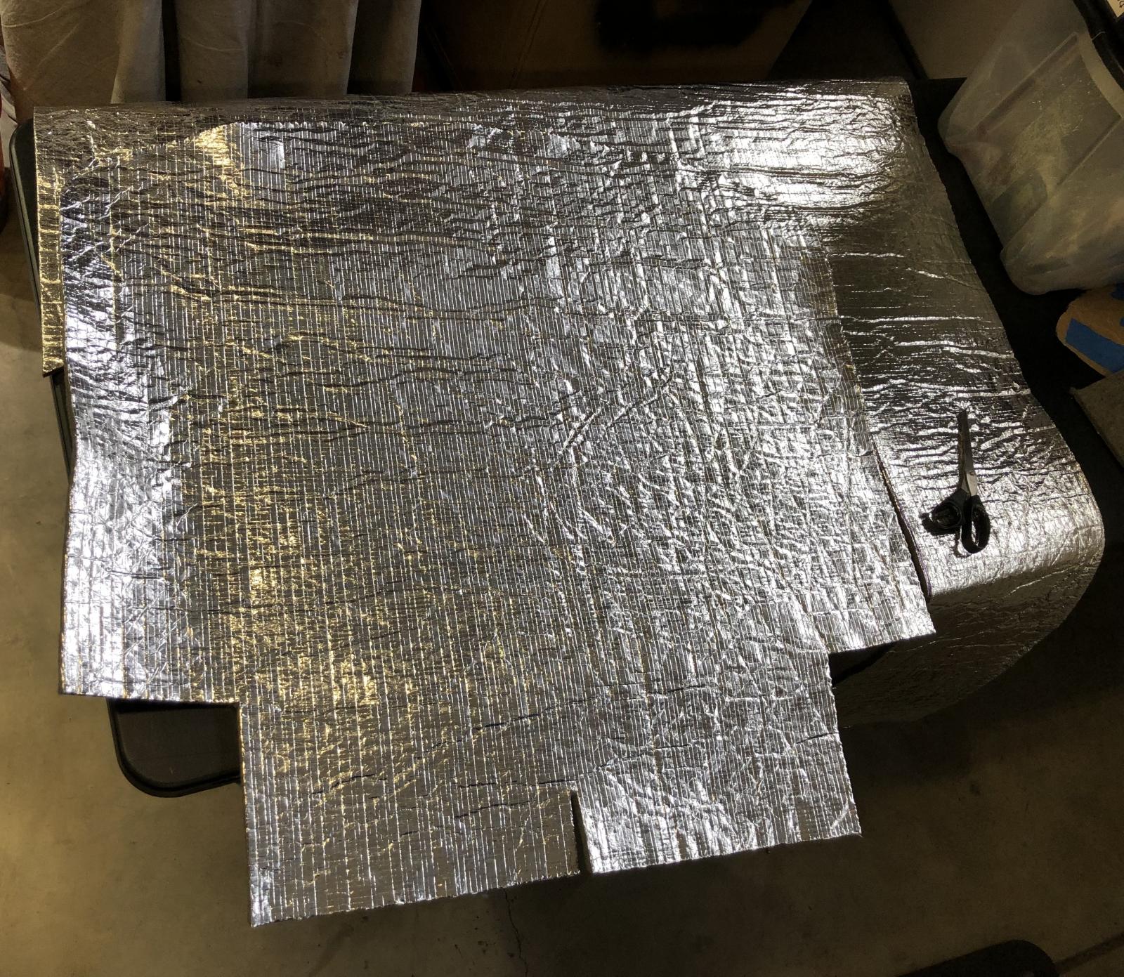

Thanks to your reply and question it got me thinking. My original idea was to use the traditional OEM style rubber floor mats to cover the floor and tunnel…
…front and back. Got to thinking how heavy the rubber mats would be compared to the Thermozite & Perlon carpet (light weight is a top design goal for this build).
Hmmmm…I could make custom floor mats by covering the Thermozite w/Perlon, & cover the tunnel with just the Perlon (tucking it under said mats along the length). It would be much lighter than the rubber mats and with the Thermozite foil side down, it might reduce the radiant heat from the engine coolant lines that run under the pan…
Well, maybe not since the coolant lines run on either side of the tunnel…which by way of its structural mass is probably a bigger heat sink relative to the pans under the seats. Anyway…I think the Thermozite/Perlon would be lighter and more acoustically beneficial vs. rubber mats. Let’s get on with it! Rolling Eyes

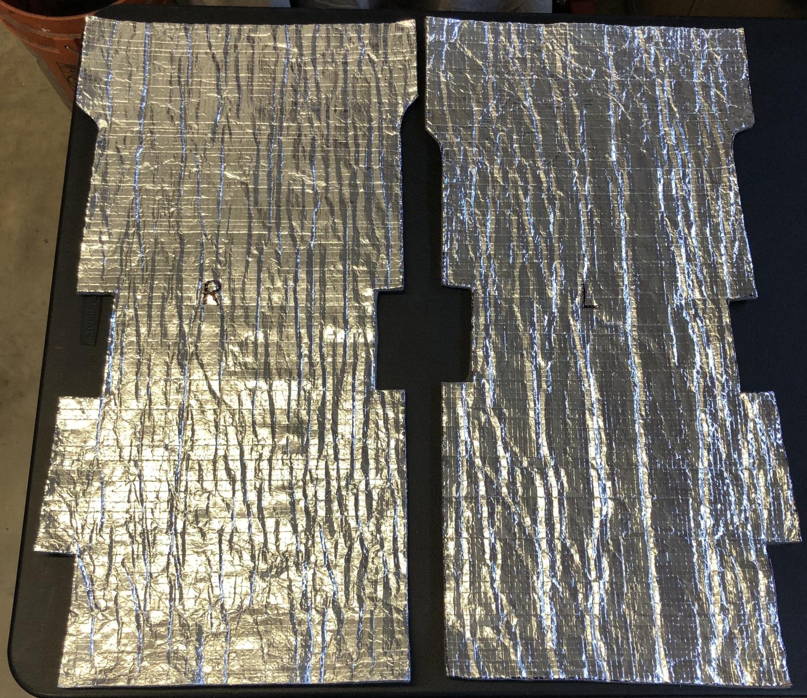

So I started by making the rear floor mats. Made patterns…
…transferred to the Thermozite and cut out L & R sides…
Covered them with the Perlon carpet…
…complete with cutouts for my custom seat brackets and roll cage…
The mats fit tight and don’t move. I don’t plan on bonding them to the pan as I want them removable. The fronts will be fastened to the pan using industrial velcro in a few locations. For the driver’s side tunnel and floor, I’ll bond some rubber matting to the feet area for abrasion protection.
So thanks again for your reply and question vanram , it got me to come up with a better design solution! Very Happy Thumbs Up
J.
