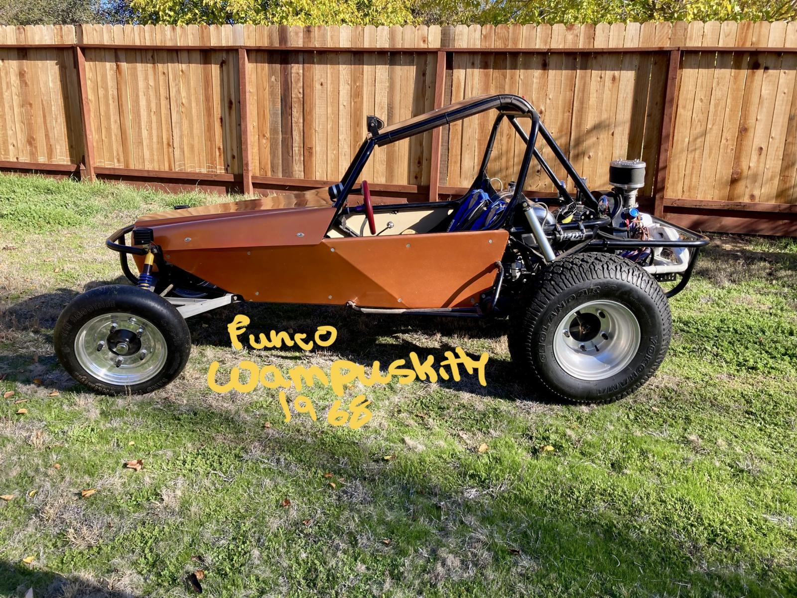

This my 1968 Funco Wampuskitty using a single 48IDA carb on a original Crossfire manifold.

I’d like to see some pics of the front suspension on that wampuskitty..
