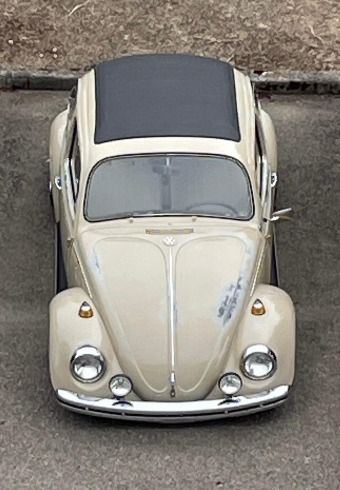

Hello everyone,
I have been looking into the legacy/Britax style ragtops. Which one is close to the original size? I’ve noticed that most open up all the way back to the rear window. I like the look of the original that leave a good gap between the rear window and the ragtop.
Also, how close to the windshield can I make the opening. I’ve seen some with a large space between the windshield and the cut out and I’ve seen a smaller gap . I prefer the smaller gap. Is it preference or is there some sort of structure that you don’t want to ruin?

PostPosted: Wed Jul 09, 2025 5:51 pm    Post subject: Re: Aftermarket Ragtop Reply with quote
I would think you can move it up, but they recommend 7". I didn't want a oh crap I cut it too close. The stock sun visor sticks out in the open some. The aftermarket one that came with mine I didn't install as I feel it's not needed if you have pop outs. I would go for the largest one you can get because if you don't you will regret it. I would do it all over again as I have been running mine for two weeks. I am updating my build thread with pictures of the install. Hope that helps.

Zodlaw,
Thank you for the response. I love the way yours came out. It is what I am looking at for my 62. Nice and subtle. What size did you order?
Also is it 7 inches to the outside of the frame or 7 inches to the inside of the frame?
Thank you for your help.

PostPosted: Thu Jul 10, 2025 5:39 pm    Post subject: Re: Aftermarket Ragtop Reply with quote
The measurement is from the inside. This is the unfortunately the best install out there. Do CC and then translate it to English. The size is 96x126cm or 38" x 50".
