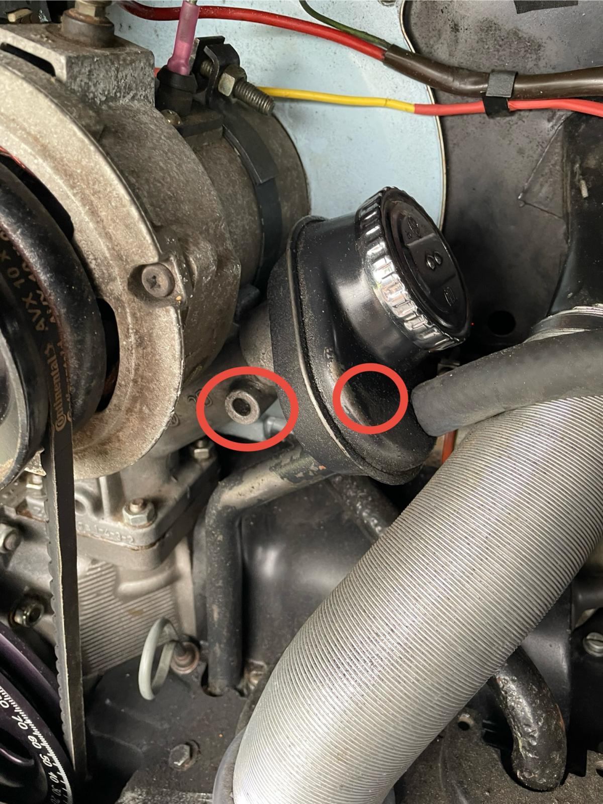

Hello all!
My engine is a 1679, very close to stock but with a sand seal pulley. It’s having occasional crank case pressure problems. I think I just need a small bit of additional ventilation with the following restrictions:
- mechanical pump so can’t vent there
- don’t want to vent valve covers
- as simple solution as possible
Would it make sense to just add a venting port at either of the locations I marked below with red circles?
Thank you!

Um....what is that fat hose doing right next to the smaller red circle? Isn't that a vent port?
Man that is like a 12mm ID hose. If you are still having venting problems with that....drilling another hole next to it will likely be of no help.
Describe what is happening in detail and I would bet that someone here has a better answer.....like oil slinger issue or too much oil at the sand seal point etc.

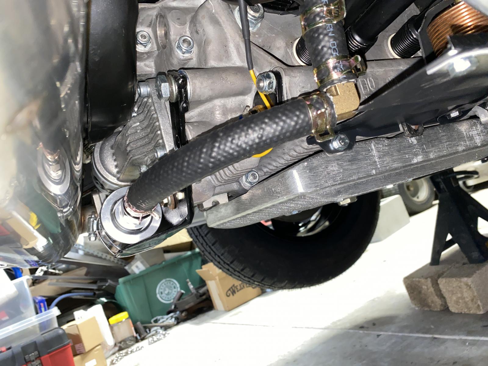

PostPosted: Thu Jul 10, 2025 9:44 am    Post subject: Re: Correct way to vent the crank case Reply with quote
6 pages and I still don't know the correct way to vent the crank case.
I do know THIS is the incorrect way!
(image by fastorange72)

Maybe bad rings are causing the internal pressure.

Where or what is the hose connected to on the end that is not shown in the picture? Maybe a fitting/hose nipple that has a much smaller inside diameter than the hose?
