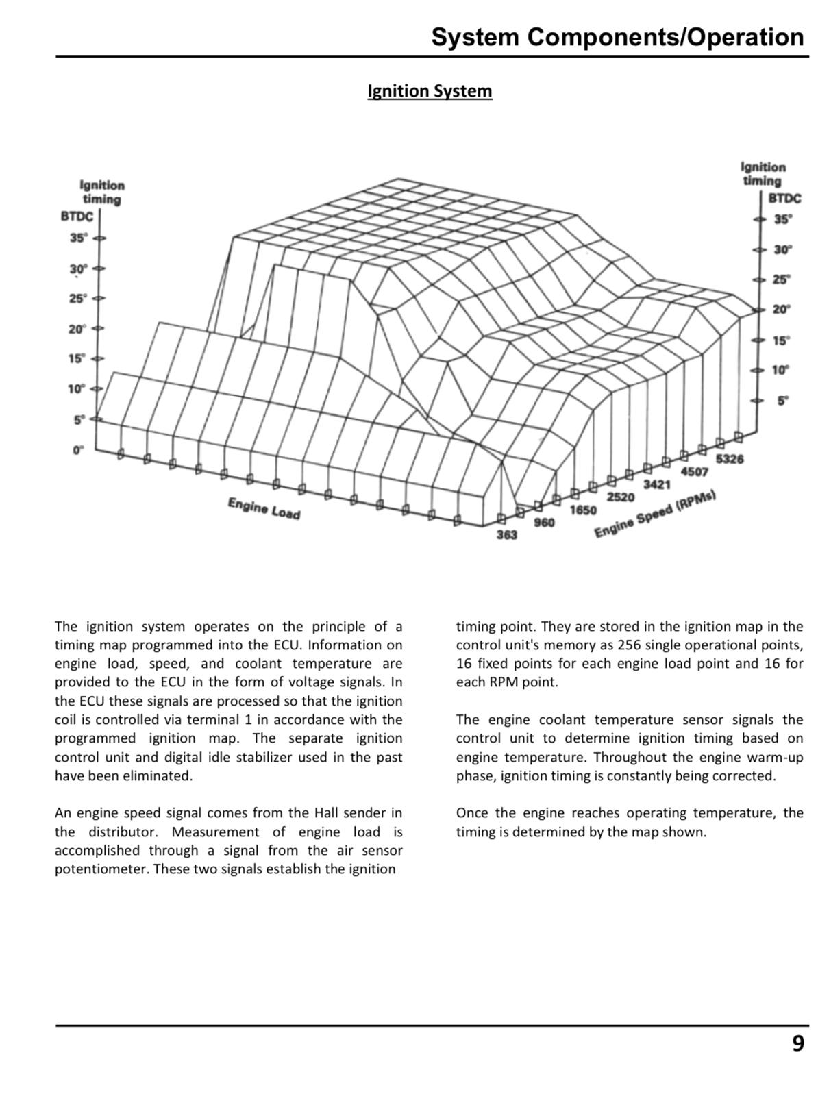

denwood wrote:
Using a Digifant II AFM in my conversion. I could not discern a difference between the 1990 Vanagon AFM and Jetta Digi II ...and from this post I can see they are indeed interchangeable.
Curious if there is any fuel mileage difference or the like. While they may be plug and play, I always had it in mind the inline 4 and flat 4 had different engine mapping in the ECU. No proof of that at all, I just got that impression from this page in the Digifant Pro Training manual.
