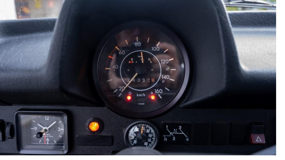

The '71 Super Beetle in your gallery has the same original dash layout as my '77 Standard Beetle did. This is what I did many years ago shortly after I bought the car. I cut the original speedometer opening out, moved it slightly to the right, and had it welded back in. Then installed a speedo opening from another standard Beetle (junkyard find) to the left and had it welded in. Placed them far enough apart to position two 2 1/16" gauges. The tachometer is from a 4-cylinder Porsche 914 which fits into the Beetle speedo opening. I made the metal cover plate using thin sheetmetal, painted wrinkle-finish black.

I like it! If my dash was already hacked up, I'd do the same. Maybe on the next one...

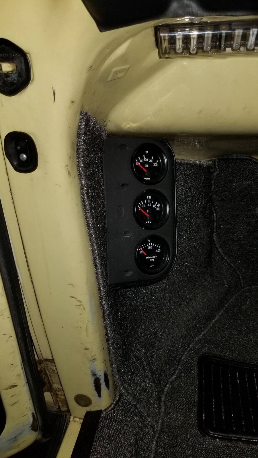

The previous owner of my ride put the gages in a swell spot. Tucked away on the left, I think it looks great. Thoughts?

dennis, are the gauges illuminated with the ignition on? They are down in a dark area even in daytime. Does your left knee not obstruct the view of the lowest gauge, or is your leg usually out of the way when you're not shifting? IMO that location is out of peripheral vision when looking at the road, so that you have to purposely look downward at them to see the needle position. I'd prefer having them higher up.

Yes, the gauges are illuminated, but only with the headlights on. And you're right, I have to purposely look down at them to see the needle position. Also, my left leg doesn't block my view, nor does it hit the gauges, but it's possible I have to move my leg a bit to see them. I still like their location, given the limited space involved, but maybe they aren't as "perfectly" located as I thought they were.
