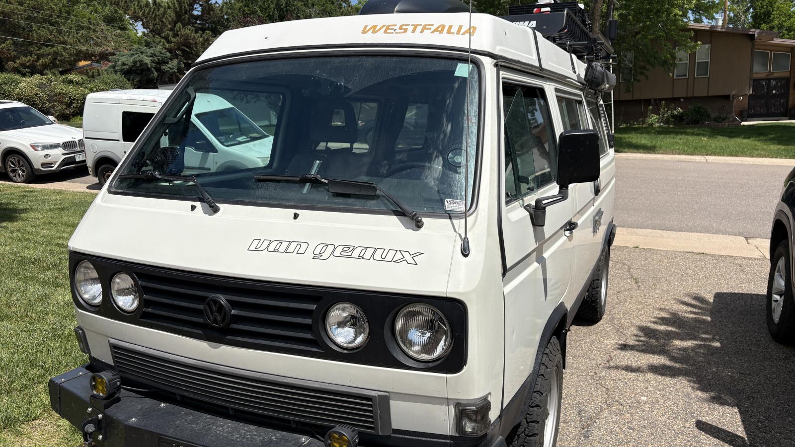

LOL - my wife is an LSU grad and LSU law professor and our son was just accepted into the LSU music program.
Approval all around!
joetiger wrote:
Icebox500 wrote:
In preparation of our move to New Orleans, I’ve finally named the Vanagon.
As an LSU grad, I wholeheartedly approve of this name!!
87 Westy 2WD “Van Geaux”

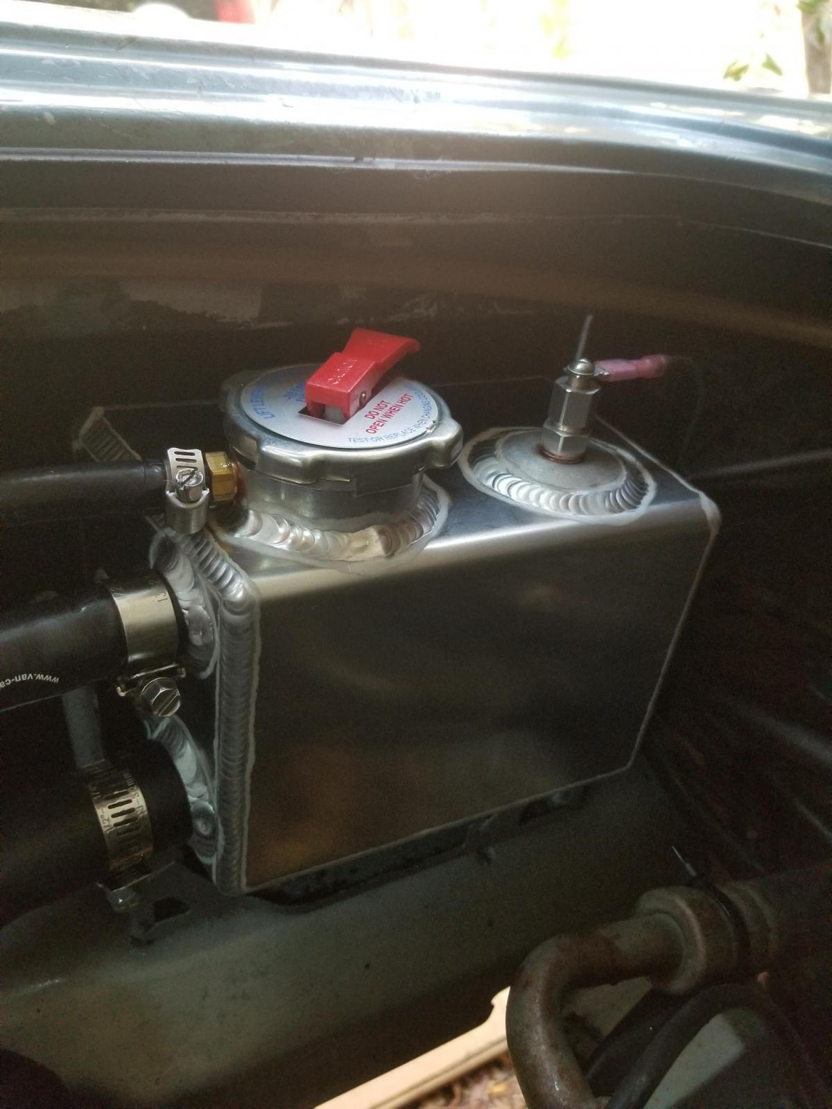

Cindy and I are planning a Road Trip to Oregon in August. I've been going through the Van; spark plugs, distributor cap, rotor, filters, etc. I came across a couple of small drops of coolant right on the seam of the coolant pressure tank. Probably ought to address that.
Searched the Forum for Aluminum Coolant Tanks, settled on VanCafe's version.
Easy install; Plug & Play on the existing bracket, connectors are provided for the (also included) Coolant Level Sensor lead and the ground wire. I bought an extra Level Sensor and Cap (it came with one) because, well, you know.
Waiting for the stars to align to install the Power Steering Rack & Pinion.
