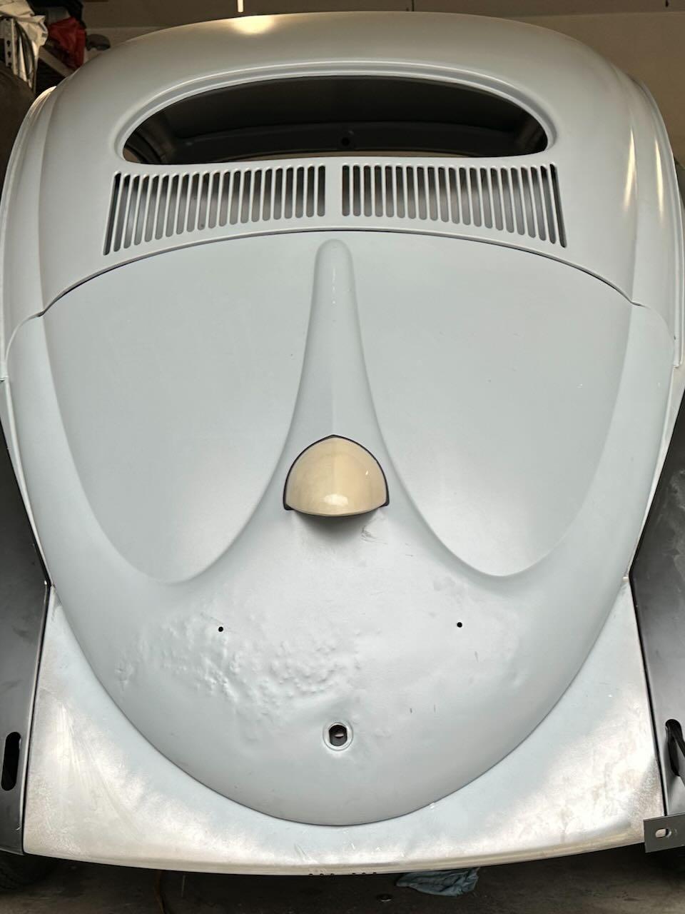

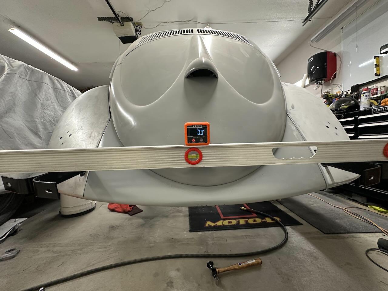

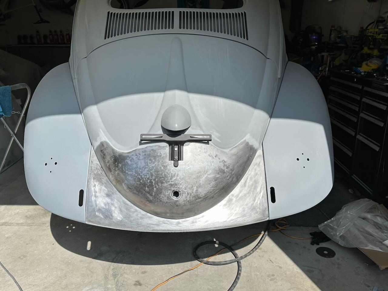

The first thing I had to address was the rear apron. There were two problems that I had to address. The first, the engine tin did not fit. For whatever reason, the Auto Craft inner apron is not the correct shape for the early engine tin. It made it impossible to get the rear engine tin installed when I test-fit the engine.
The second issue. I did not like the shape of the apron. The stampings are not good. So I opted to get a Wolfpart apron. I happened to pick the original inner apron off the scrap pile at the metal shop before it got tossed out. It did need some work, but it was original and would be guaranteed to fit.
I am happy that I did take it apart because it turned out that the inner apron was not spot welded in on one side. it was just floating there. They had also spot welded the harness tabs in upside down. They would never hold in wires.
It also revealed that they did not fill any of the holes from the original apron being pulled off.
So after a bunch of repairing pretty beat up metal, I was able to get the apron and inner apron installed and looking good.

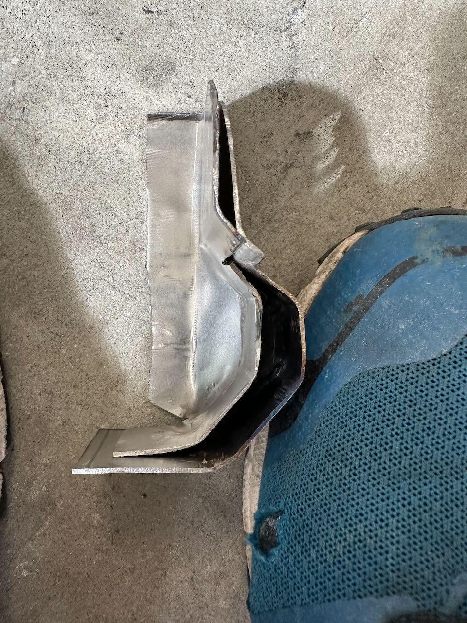

The inner apron is thinner. I can't find pictures of mine before I fixed it and attached a new seal channel, but it was not in good shape. It still looks a tiny bit beat up, but it is original, and I am ok with it.
I would sacrifice the apron to save the inner apron... meaning, don't drill, grind off the outer apron. I have done that in a few instances where I just wanted to preserve the metal that was left behind. The heater channel work that I will post in the future is an instance where that came in handy.

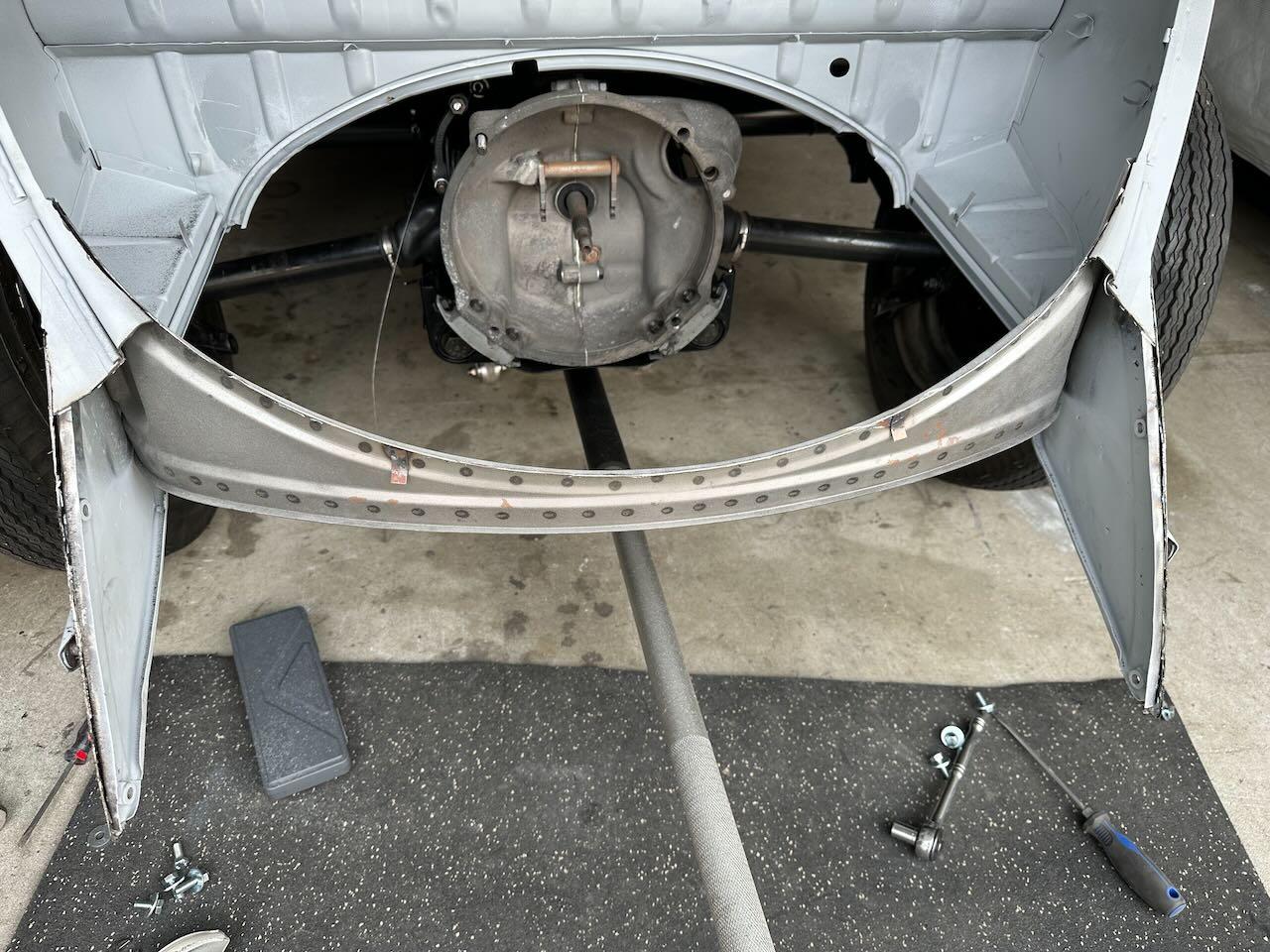

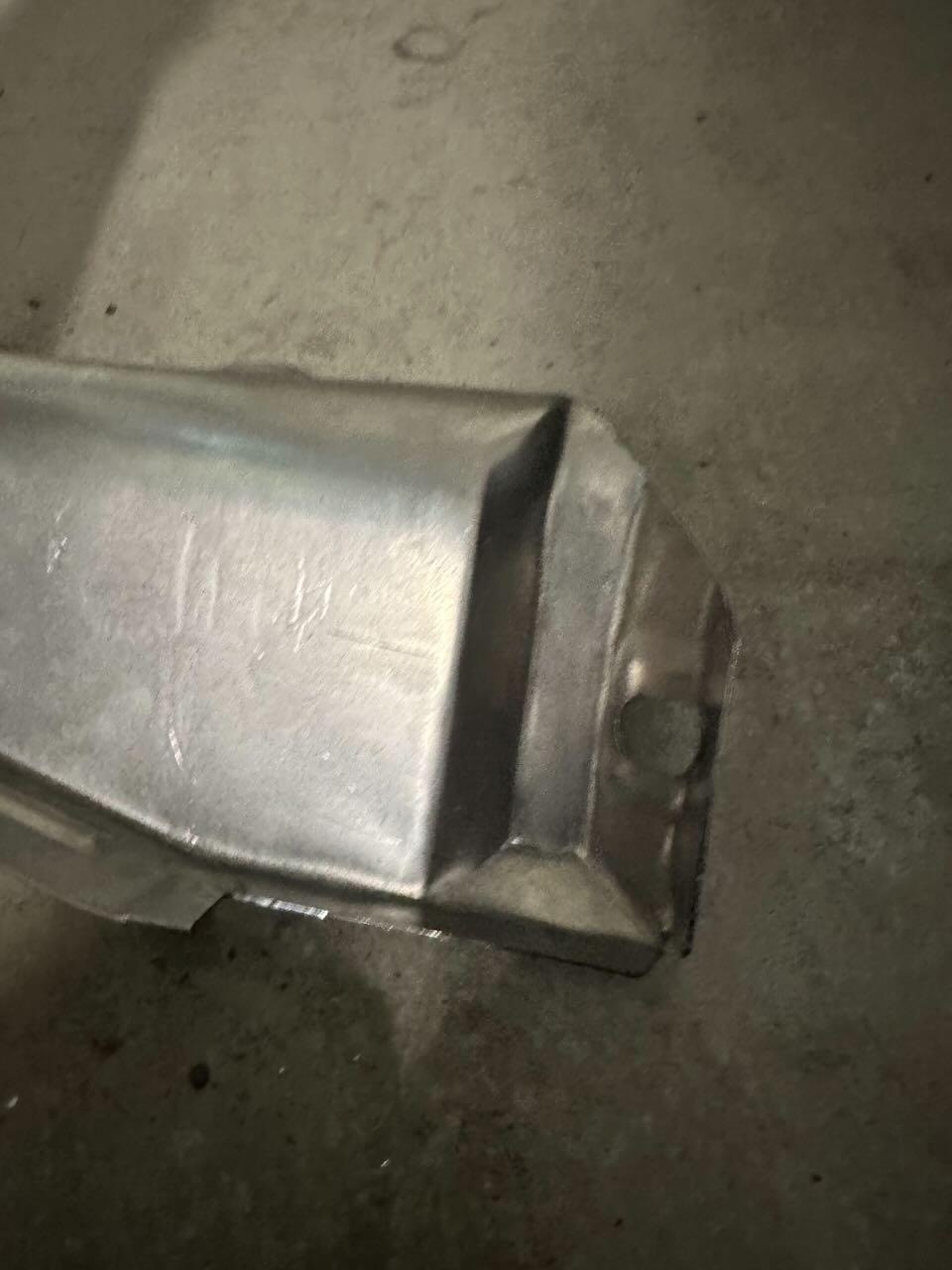

Moving onto the rear engine trays and bumper mounts...
First off, why am I doing them, given they were already done by a "reputable" metal shop? Great question.
After replacing the rear apron, I discovered that there was no room to put the bumper bracket to body seal. Although I could get the bumper level to the body, I could not install the seal on one side without major deformation. This might have been solved another way, but I chose to fix it properly.
There were also a few issues with the engine trays. Again, I could have left it and let the tar board hide it, but it was one of those things that was just sloppy work. They were not level side to side, which created an issue when installing seals. I ordered up some new trays (this time I used Autocraft because they are the closest to the original) and got to work.
Here is the massive amount of work it took to get this sorted. I will add that I would have preferred to have done this work prior to doing the rear apron. It would have made the correction to get the tray to fit much easier.

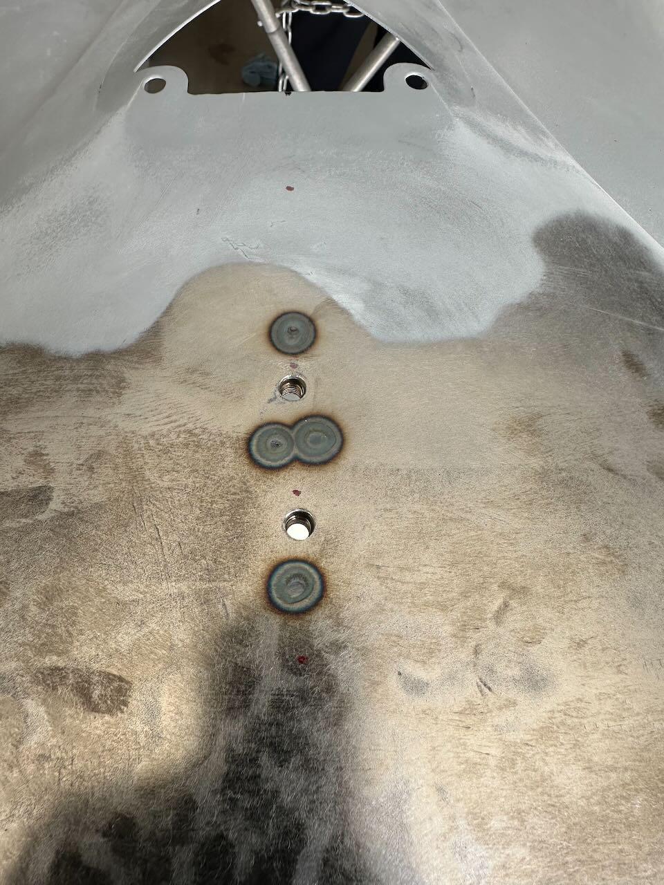

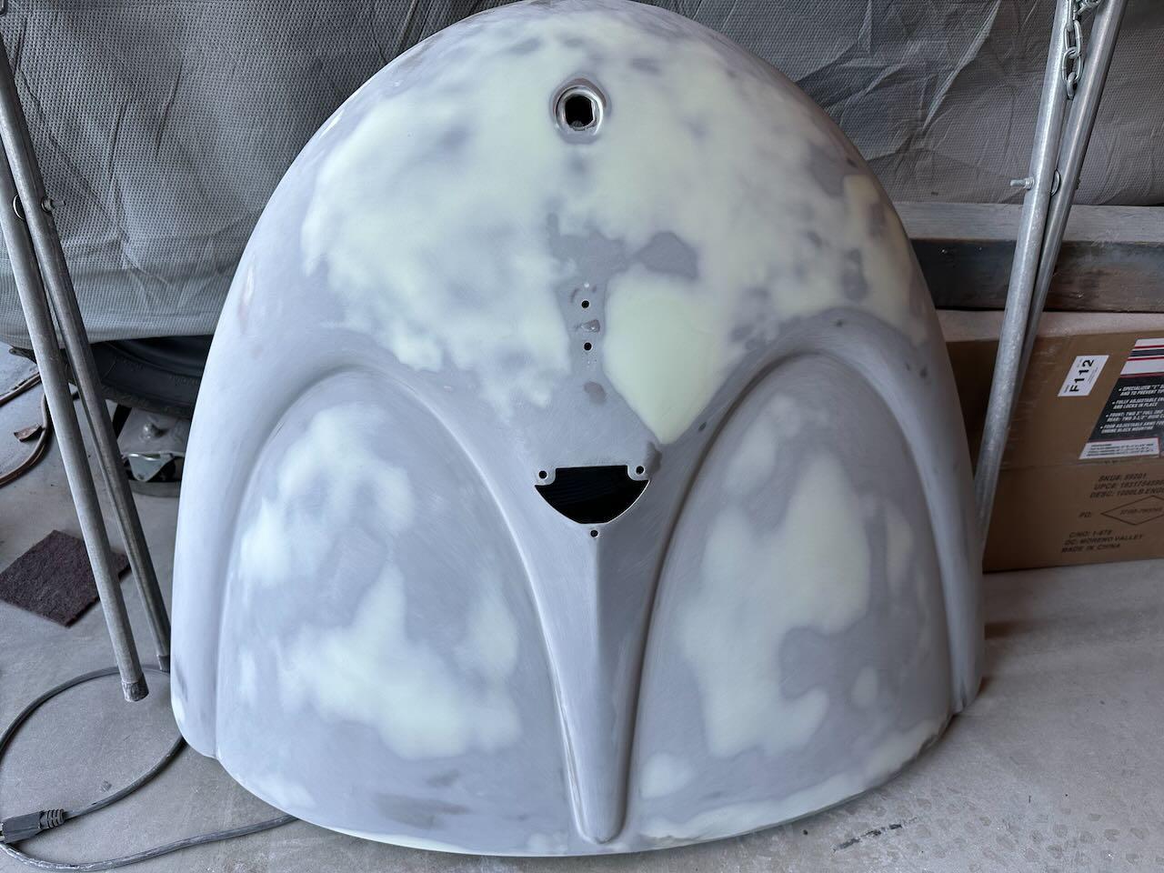

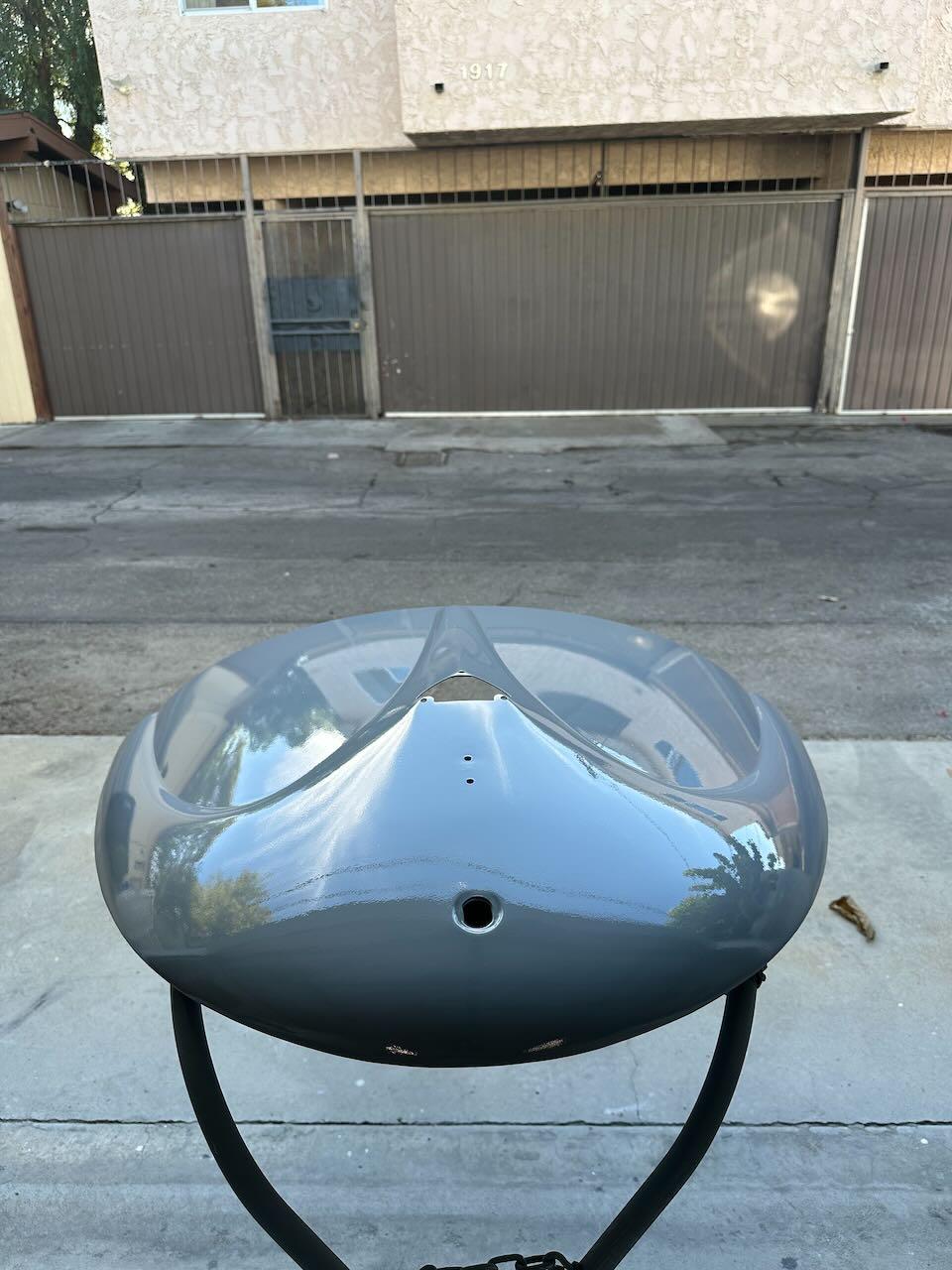

Moving onto the decklid. This decklid, like many, has been hit and then crudely repaired with a hammer. I took a pass at it without taking the brace out. I quickly realized that I needed to remove it in order to fix the brace itself. It was tweaked, and I was not able to fix it without removing it. The benefit to doing that was that I had full access to the panel.
I used a shrinking disc, slapper, and dolly to do the majority of the repairs.
While I was doing the work, and after I was happy with the repair, I added a license plate bracket bolt-down plate.
As I was test fitting the decklid, I was not happy with the shape of the apron, so I did some work to flatten it out a bit to make it look more like the original which also helped the decklid sit better.
As I get deeper into this build thread, you will see that I have been bodyworking panels once the metalwork is done. That is what I did here. It really helps me visualize the finished work.
I am using SPI products for both epoxy as well as 2k. I am laying down two coats of epoxy. The next day, I will add Evercoat Rage Ultra filler so that I get a mechanical bond. Then 80 grit for initial shaping and removal of excess. Then 120 with a guide coat. At that point, if there is metal showing, I will spot that with epoxy followed by 2k medium build.

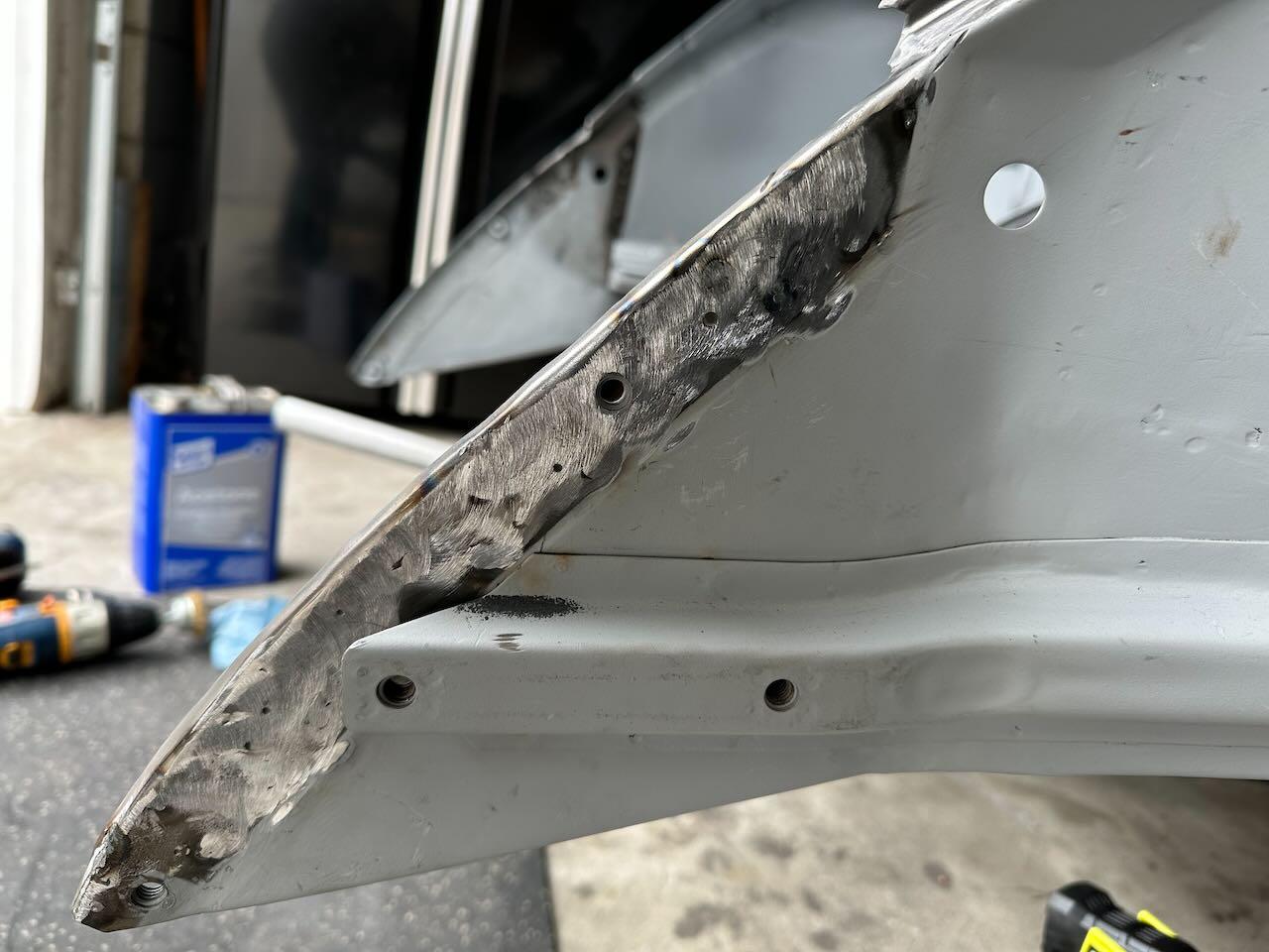

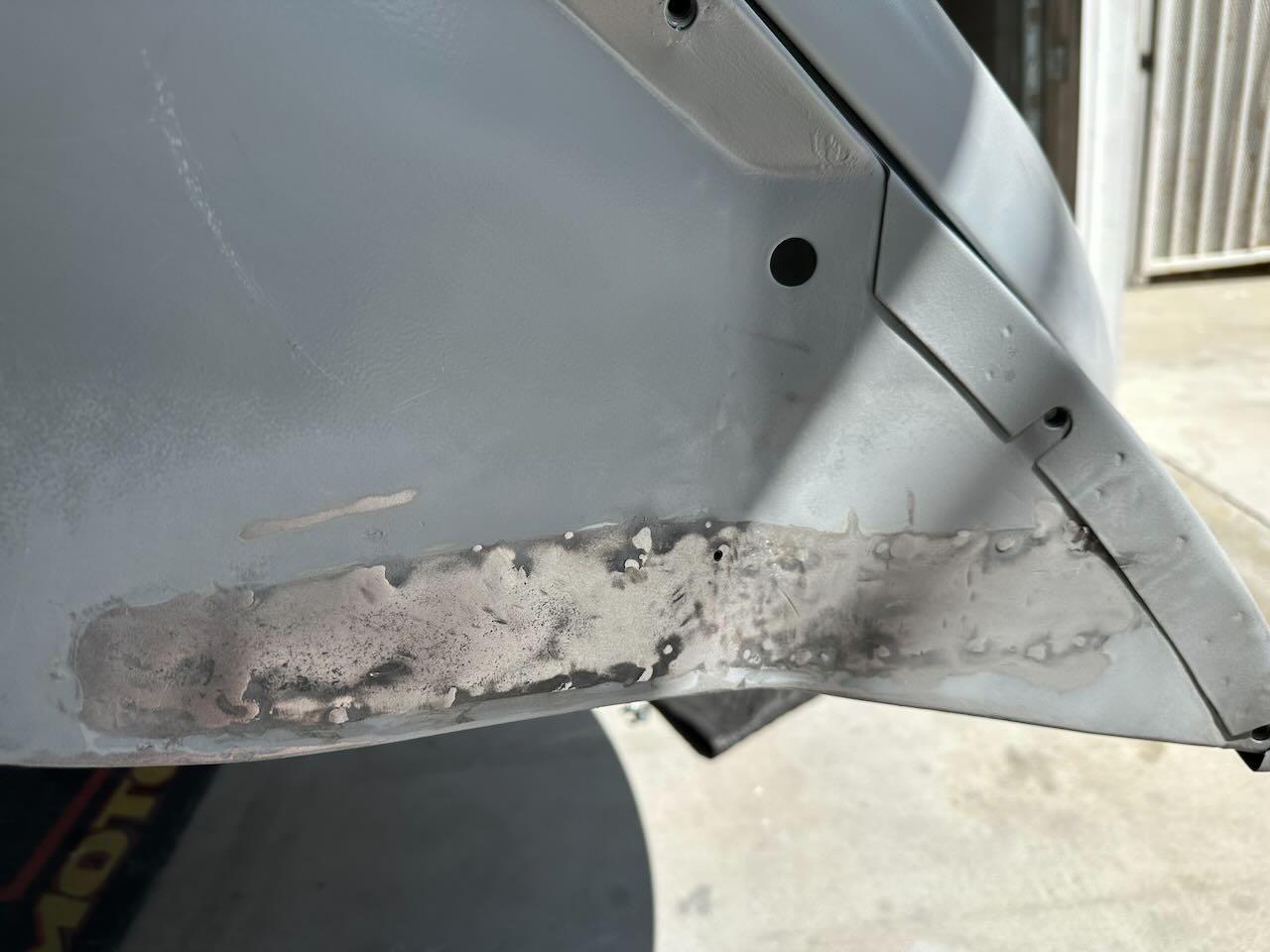

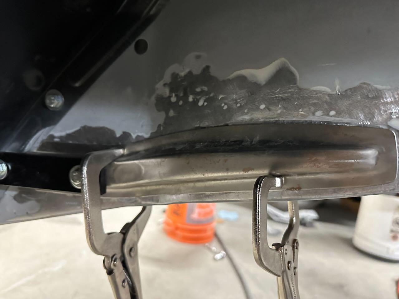

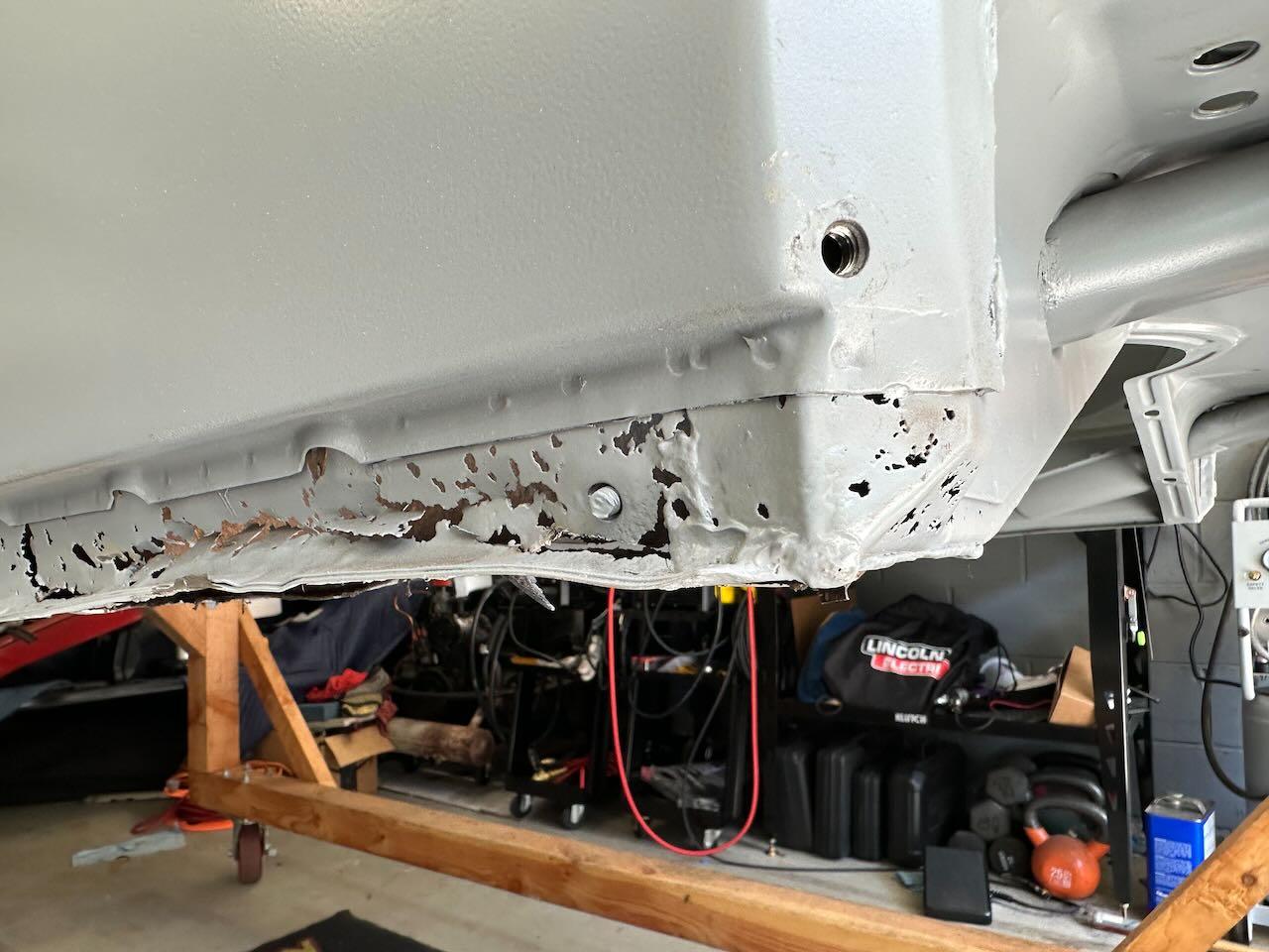

Overall this car is very rust free. There was a little rust hear and there, but the main issue with rust was the right rear heater channel. I am not sure what the issue is with how the moister collects in these cars, but it is the same problem I had with the 54. The good news, it was not anywhere in the surrounding metal.
That plan is to remove the portion of the heater channel just to the b-pillar. I did not want to disturb the weld in the door jam. I also did not want to drill out the spot welds but rather remove the channel from the inside to allow plug welding from the inside to preserve the original spot welds.
Here is what I started with.
I did choose to brace the door opening just in case.
Then on to the demolition. Being very careful not to remove good metal.
The plan was to use replacement pieces from Mika and graft them in. You can see where I marked the section to replace on the rear of the channel.
It turned out that the stamping was much to shallow for my particular car. I did not like the way it fit. I contemplated things I could do to fix it like reshaping it and so on. I came to the conclusion that I could just make a piece that would take way less time and get me to the finish line much quicker.
Here is the difference in shape.
I installed it using TIG and MIG and then covered it with Master Series rust protection.
Next up, more heater channel repair.
