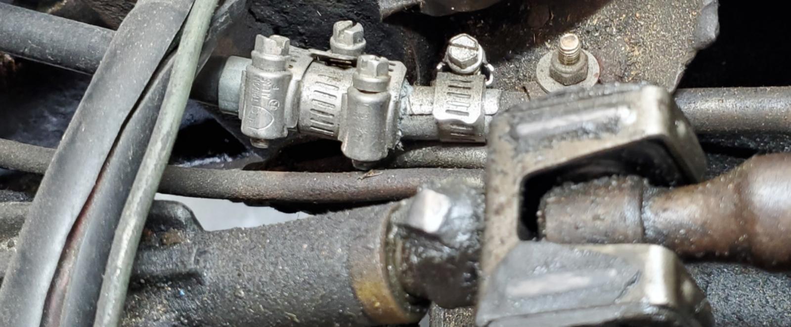

MrGoodtunes
Joined: May 14, 2012
Posts: 1016
Location: South Florida
MrGoodtunes is offline
PostPosted: Today 1:05 pm    Post subject: Re: Bowden tube mounting Reply with quote
I cobbled the forward end of my bowden tube, using 4 hose clamps around a couple small roll'd up pieces of sheet metal:
Check out this far more elegant adjustable solution:
https://www.thesamba.com/vw/forum/viewtopic.php?p=8018955
