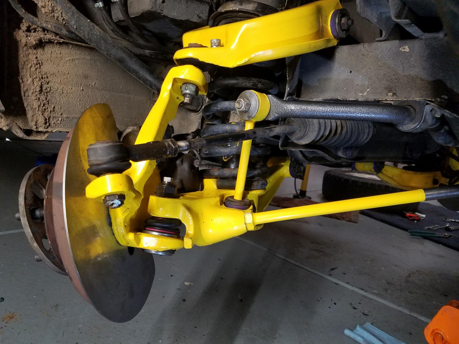

When I fully renewed & upgraded my 2WD suspension, my goal was to remove the slop from all the aged/expired bushings. I wasn't expecting the ride to be smoother, just more precise. I went with the poly bushings because I knew I would be spending a lot of time off road. However, now that most/all of my driving is on-road, I might choose stock over poly for a less stiff/harsh ride quality.
While not the simplest job, it is quite doable yourself. I did all the work myself in my garage, save for the final alignment. Just use an overabundance of caution when working with the springs and underneath the vehicle.

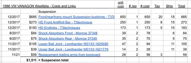

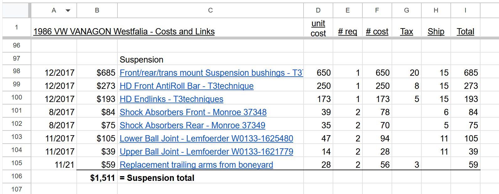

As far as costs goes, what I spent in 2017 (with links to the parts) is in the spreadsheet link in my .sig at the bottom of this post. Here's a screenshot of the suspension portion of the spreadsheet, unfortunately these are pre-pandemic/pre-tariff prices:

I like to paint the big parts I touch Tonka Truck yellow. Wirebrushing and cleaning the parts allows me to examine them closely for any damage. Now, whenever I see that familiar flash of yellow under the vehicle, even years later, it always makes me smile and reminds me that, "Yeah, I fixed/renewed that right."

PostPosted: Sun Jul 13, 2025 7:23 am    Post subject: Re: 1984 Vanagon - Suspension work needed Reply with quote
sanchius wrote:
… Here's a screenshot of the suspension portion of the spreadsheet,
unfortunately these are pre-pandemic/pre-tarriff prices:
No pic (inadequate VW content?) but I fixed it:
