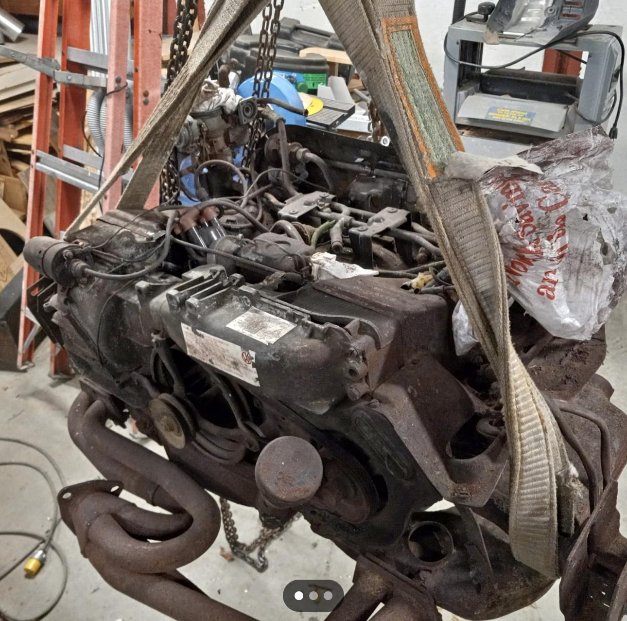

Picking this engine up. Will it fit and spin my 73 beetle trans

I know plumbing, cooling and exhaust work is necessary. I don’t mind removing my fenders and rear apron. I just want to know if it can bolt on and spin the beetle transaxle

You'll have to add a pilot bearing in the flywheel, the beetle input shaft is too short to reach the one in the end of the crank.
Is that it? I have 2 extra pilot bearings for the original engine I accidentally ordered. Will those fit?

73Dailybajabug wrote:
No, the shaft will still be 12mm too short, either press a custom bearing into the flywheel, or install a type 4 input shaft in the transmission (not sure if bus shafts fit in beetle trans')
Don't know, did this come out of an automatic vehicle?
No info at all apart from that picture. Seller doesn’t know anything about it, probably husband’s
This little 'detail' could mean the difference in big money being spent just to tell if this engine is 'worth' it or just additional money being wasted on a 'boat anchor'. Confused

The people who gave advice looked at that picture and thought, "oh god this poor soul doesn't know they're about to invest time and money into an absolute boat anchor and have absolutely nothing to show for it after wasting their life on something that will never meet their expectations."
They just used different words.

nextgen on here has a manual for sale on converting type4 to type one use.
try pming him.
