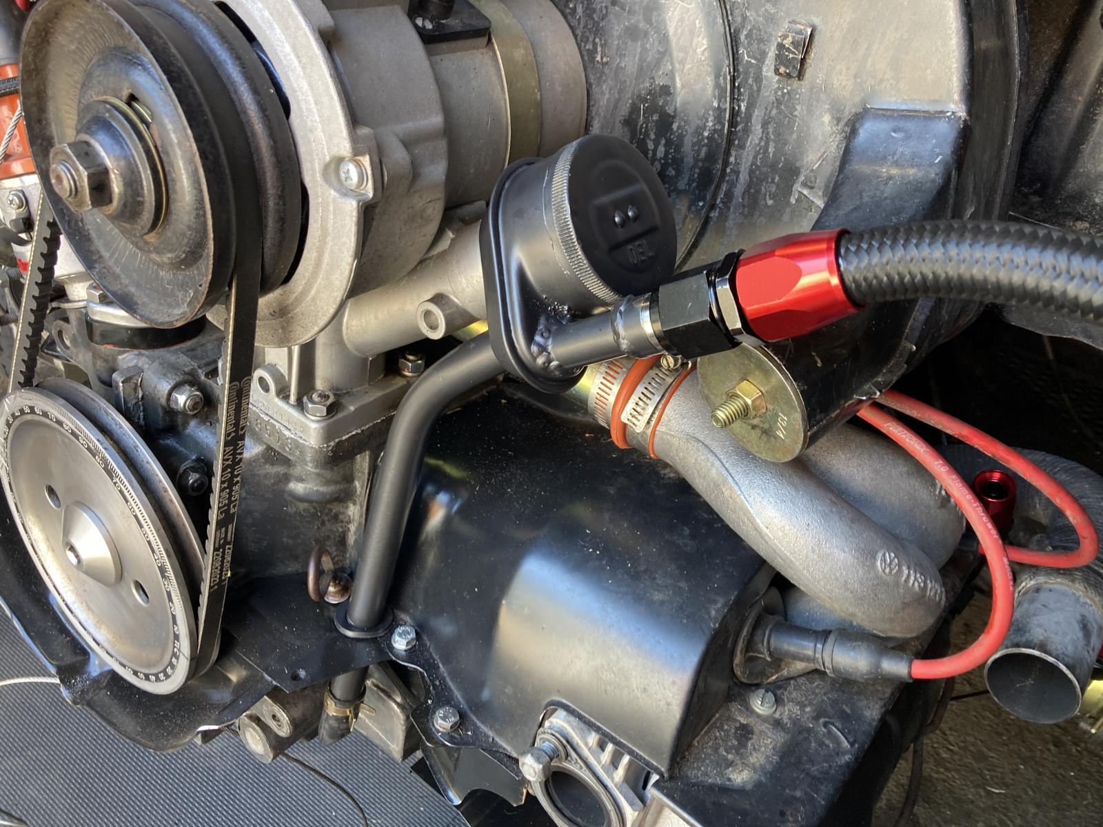

Schepp
Joined: March 22, 2020
Posts: 447
Location: NorCal
Schepp is offline
PostPosted: Yesterday 6:49 am    Post subject: Re: Correct way to vent the crank case Reply with quote
I modified the stock oil filler. Cut the original vent pipe off, then drilled the hole to the same I.D. as a -10AN. A new appropriate sized extension tube and SS -10an bung was welded on.
Note the down tube and rubber piece at the end still exist.
