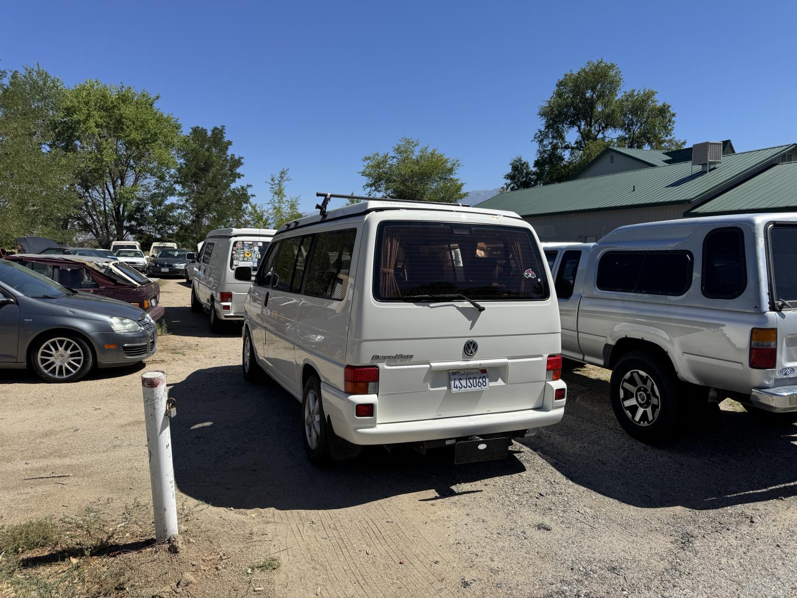

I unfortunately had my first mechanical issue already. Driving from picking up the van to the eastern Sierra I had some serious overheating. The radiator fans weren’t running unless the AC was on (saw this mentioned in a post here.) I was able to get it to Tim Miller at Sierra German Auto, and he traced it to a bad sending unit which is on order now.
Here is a picture at the mechanic’s. Funnily enough, there was another Eurovan with fan problems there at the same time. Shocked

My 03 EV had the same failure, before I bought it.
A mechanic in Mt. bypassed the trans cooler when he "so called repaired" the cooling fans.
The end result was, a complete transmission replacement with a different trans due to it completely welding all the internal goodies together. It wasn't pretty and it was, Expensive to replace.
It's rude but, if you can, keep a sharp eye on the mech. while he does the repair on your EV. You don't want to go through what the PO of my van did.
