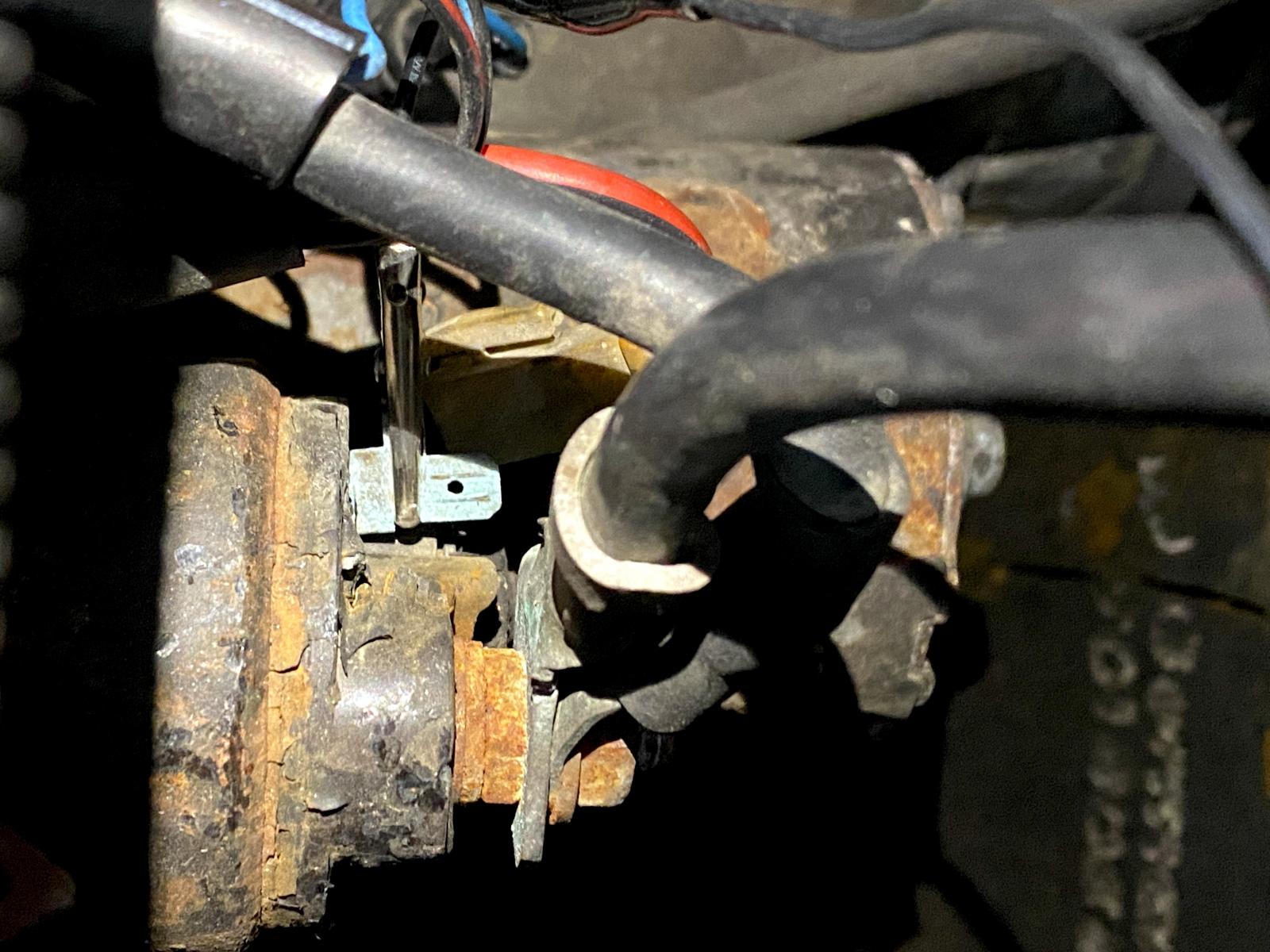

I did clean the connection at the starter (it looked ugly) and I thought that would do it. Alas, no. Battery connections look good/clean but Iโ€™ll remove and check them again. The chassis ground definitely needs a look.

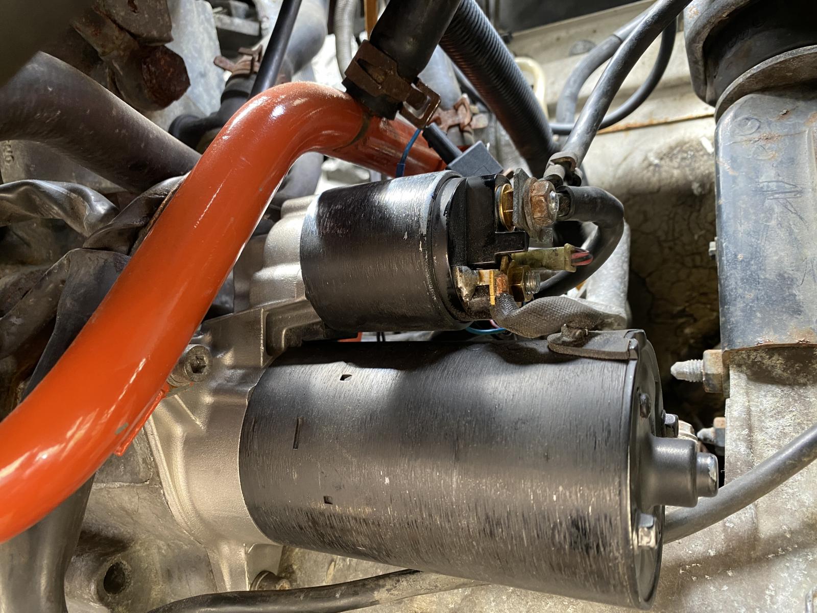

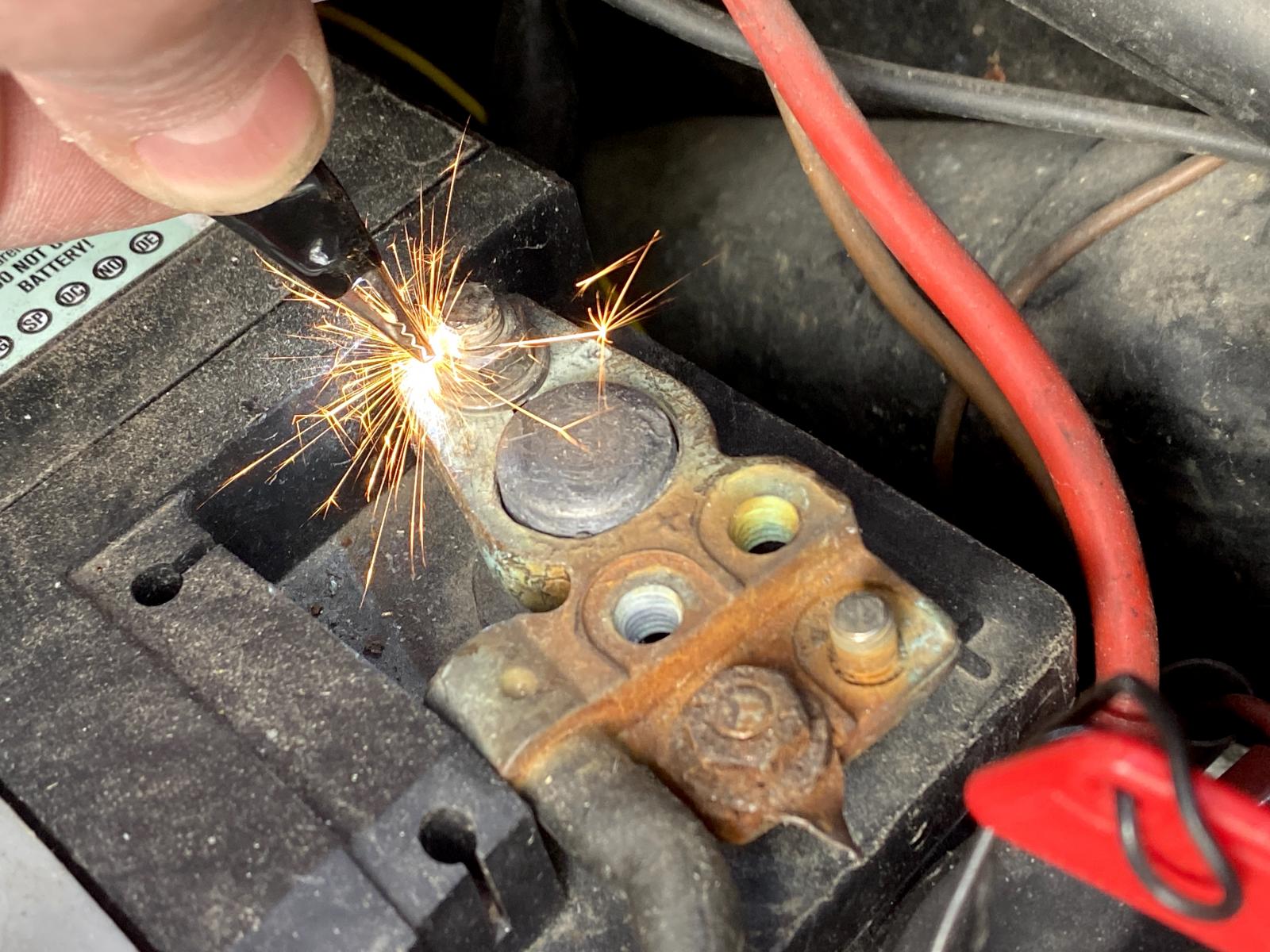

In terms of the starter, an easy way to check if it is working properly is running a jumper between the male connector on the solenoid to the positive battery terminal. This bypasses the ignition switch/circuit, delivering 12V to this solenoid and should activated the starter. When experiencing a no-start condition on my 1995 EVC during a Thanksgiving trip, tried using a jumper on the starter and it remained dormant. When brushing the lead on the +battery terminal, the results were a bunch of sparks telling me the starter was most likely the issue and not the ignition switch. When returning home, tested the jumper wire bypass on my 1993 Weekender and the starter immediately started turning.

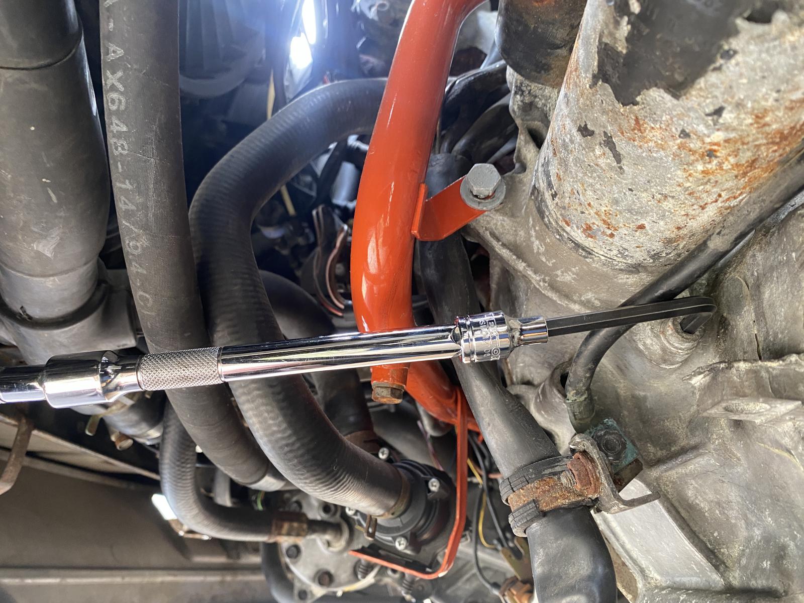

As an FYI, on my 1995 EVC, the starter is secured by 3 allen bolts and they were a pain get loose. Since you have the VR6 engine, not sure it is the same configuration. One of these had been removed about 2 years before when going through the cooling system and deciding to repaint the main metal pipe since it has a fair bit of surface corrosion on it. I pretty much mangled the head of it trying to remove it so it was replaced with a hex head bolt. When replacing the starter, the two remaining allen bolts took some perseverance and persuasion to get them to rotate. When installing the new starter, the hex-head bolt was repositioned to the backside of the starter as it is easier access that location with a socket than with an allen wrench.
