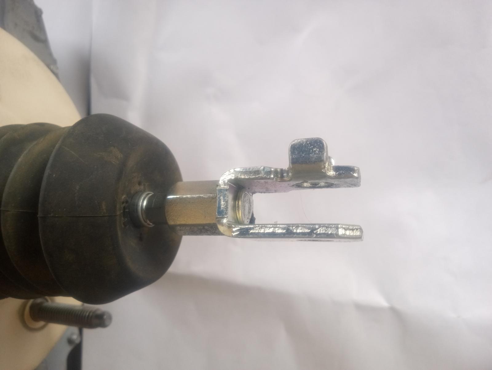

This end piece here, whatever it's called needs to go,
I don't see any way to mate this to the brake pedal pushrod. Upon close inspection this piece looks like it can be screwed off so I put a couple wrenches on it and spun it around, having to force it a bit.
Afterwards I watched a video and the guy did the same thing I did on his iboost except, his piece didn't screw off either but it snapped off. So, that is how that is done.
At this point the only idea I have to connect the iboost rod to the brake pedal pushrod is to machine a coupling, one end is threaded to the pushrod and the other slips onto the iboost rod.

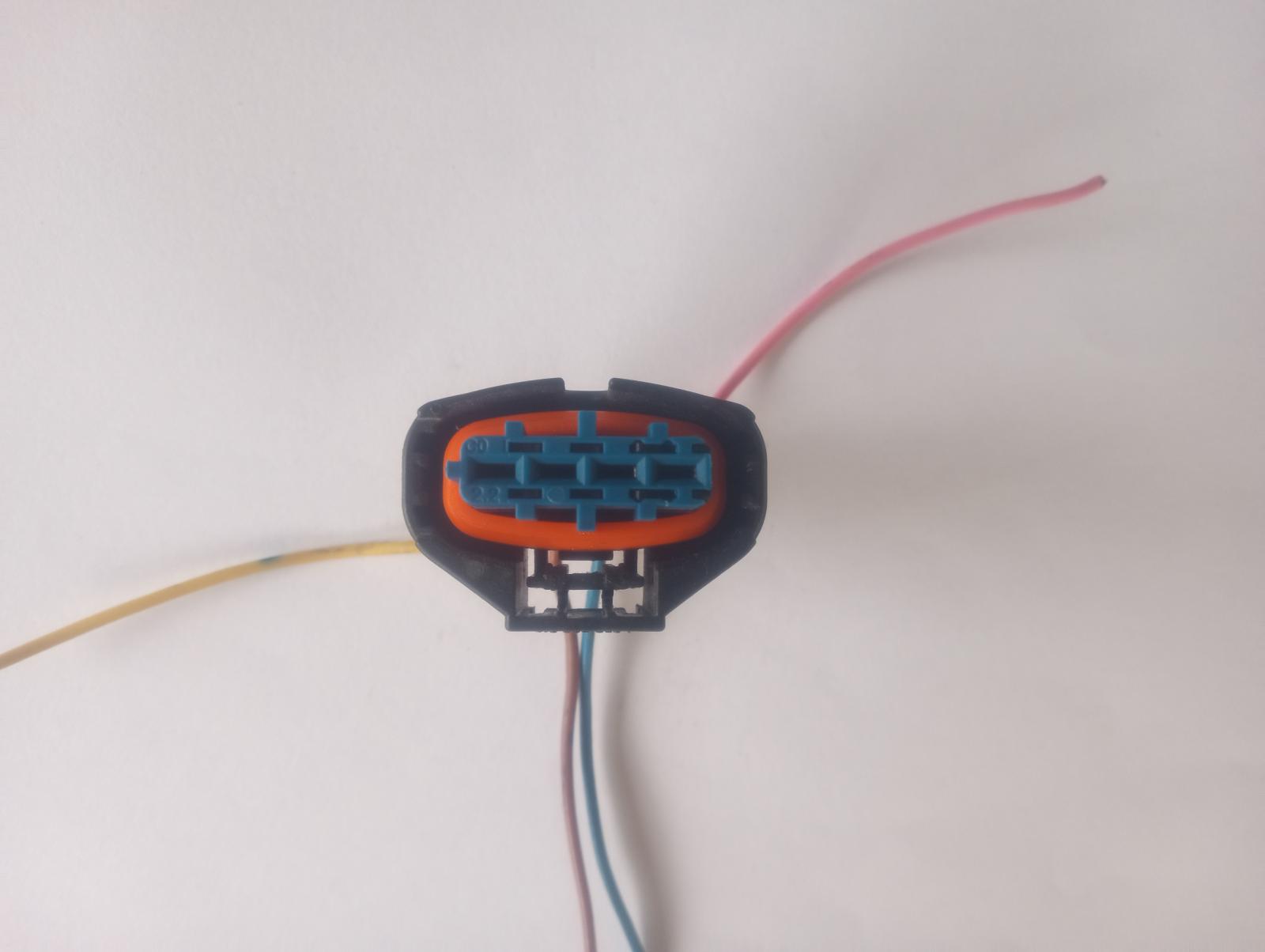

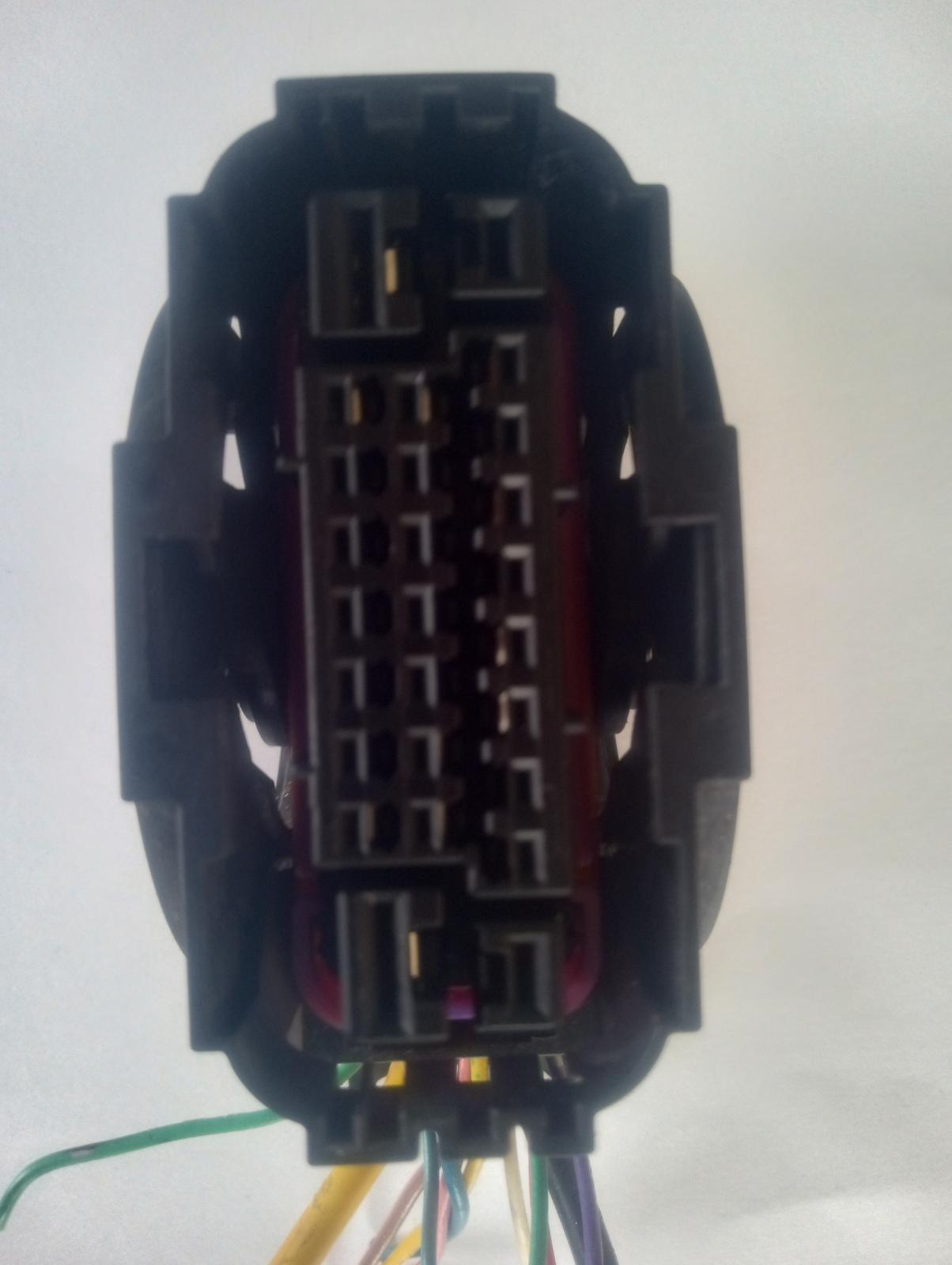

Now for the electrics. The gen 2 iboost is only a three wire hookup. A 12 gauge constant hot hooked directly to the battery on a 40 amp fuse, a 12 gauge ground and a switched hot on a 5 amp fuse.
All this connected to the ecm through the big connector.
Also connected to the ecm through the big connector are 4 small gauge wires, 22-20 from the pedal travel sensor...
with this connector...
If someone decides to do this and you source your iboost from a parts car, grab that harness. More then likely the constant power wire will be yellow and you will have to splice in enough length to reach the battery and maybe splice enough for the 5 amp switched.
If like me you get the connectors with pigtails or no connectors at all, you can buy a ready made harness like this...

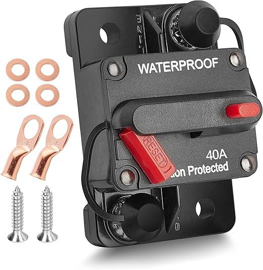

Instead of a fuse, I'm thinking to use this...
from here...

So...I done did it. I went from this...
to this...
to this...
Balidas
Joined: August 25, 2020
Posts: 75
Location: Ft Lauderdale
Balidas is offline
PostPosted: Tue Jul 22, 2025 6:38 pm    Post subject: Re: Tesla Tech? In a VW Bus?? Oh yea! Reply with quote
Initially I put a couple of wrenches to spin the bracket to snap it off. It didn't snap. Then I got my angle grinder, put the disc between the forks and used the edge of the disc to grind the head flush with the bracket. Then used a screwdriver to pry the bracket off leaving me with a small umm..."protuberance".
The grinder quickly took care of that to give me a smooth, flat surface, which is what is needed. Then used a file to clean up any rough edges.

I also got the circuit breaker in;
This is a nice little unit. Feels nice and sturdy. I like it. It came with these copper lugs;
The barrels tho are too big for 10-12 gauge wire. These are for 6 gauge so I put them aside for later and got a bunch of these coming in;
I like this open barrel style because for one, they are all brass and 2, the top part of the barrel crimps on the bare wire while the bottom part crimps onto the insulation. Which gives it a stronger hold. It's like having that Kung Fu grip.
