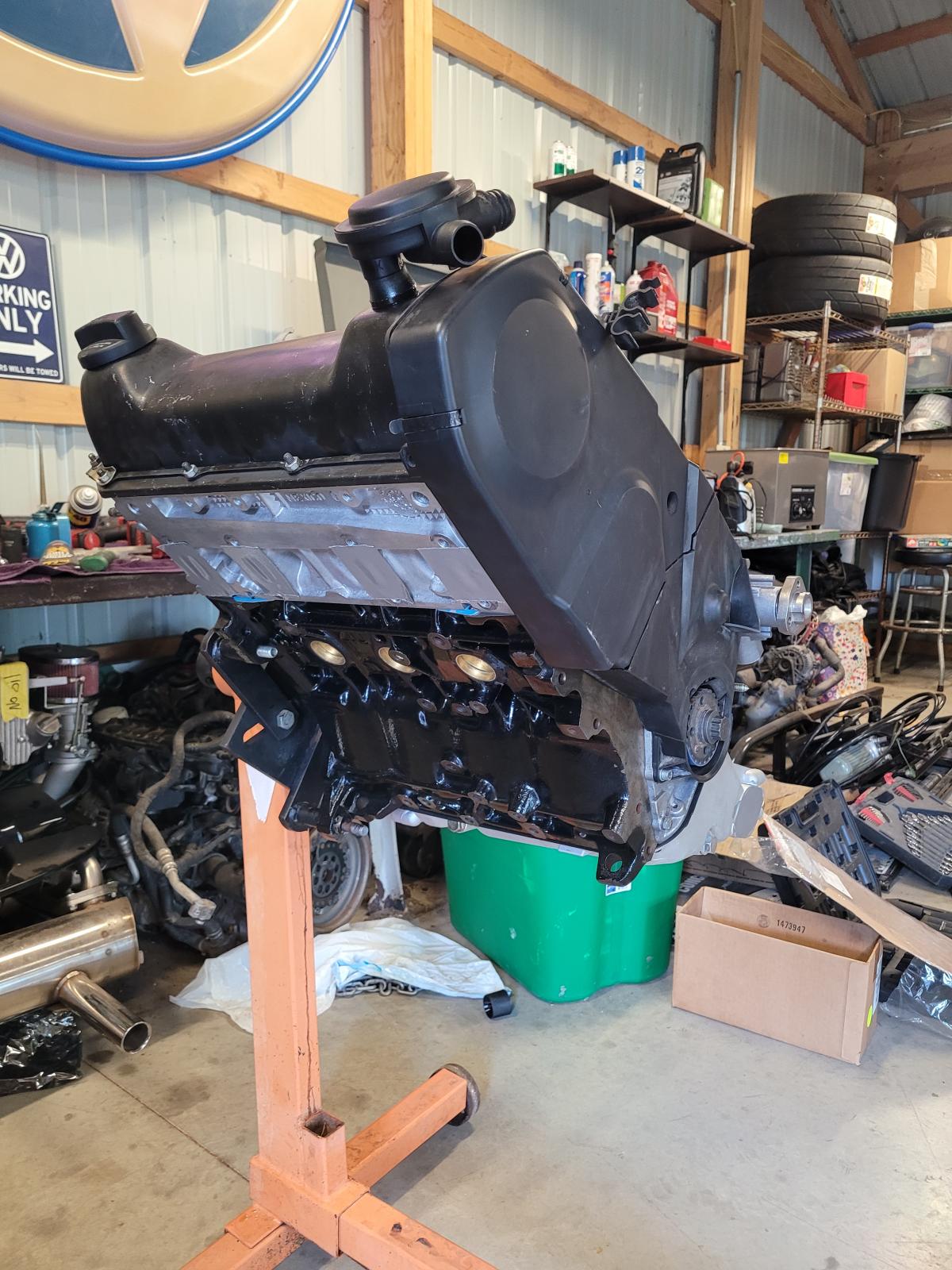

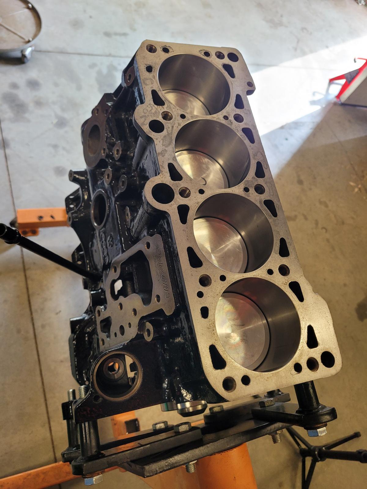

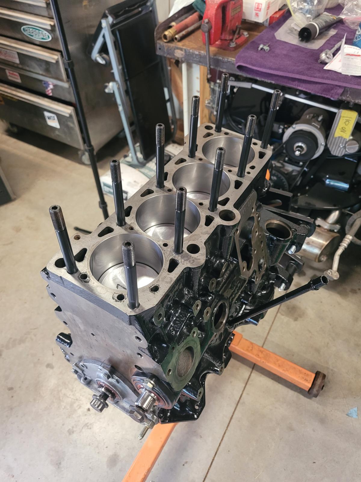

I have a good update to this thread. A buddy of mine helped me clean my block for 10 hours on a Saturday. We got the block looking immaculate. Started off by getting the cleaning materials ready and then started the cleaning process.
My dad came over and gave me his engine building expertise. We then started to assemble the short block. We put the IM shaft in, Crank, the JE high compression pistons in with rods, then the oil pump.
Then I started assembling the long block with a TT 266/270 cam.
I haven't finished assembling the long block yet. Next I need to check my valve to piston clearance. Once the long block is built, and ports are covered I'll be getting the vanagon in the garage to rip the old water boxer out.

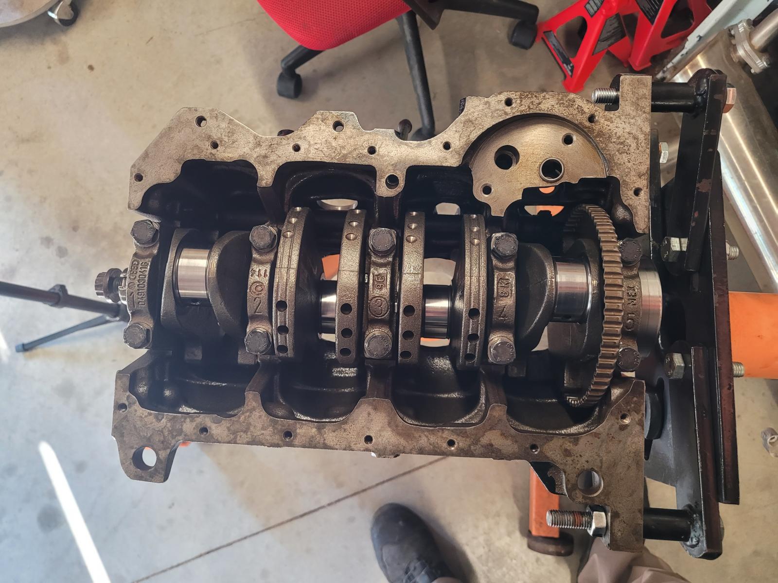

PostPosted: Tue Jun 10, 2025 8:33 pm    Post subject: Re: ABA Vanagon Conversion Reply with quote
Well I made a mistake. I installed 2 of the connecting rods incorrectly flipped. The bump on the connecting rod is supposed to be facing the front side of the engine, but there are 2 of them where they are facing the back. Asking around, there were mixed opinions on if this needed to be corrected or not. At first I didn't feel the need to correct it, but after some time I decided I need to correct this. When I bought my JE pistons, they came with rods that have ARP rod bolts installed in them with what I believe were intended for a Ford 289/302 V8 (APR 154-6002). This was a common alternative to the ABA ARP rod bolts that were twice the price at the time. I'm going to test these and replace the rod bolts if they test good. Bummer to have to step backwards, but better than having the possibility of something bad happening, and I end up with ARP rod bolts installed.

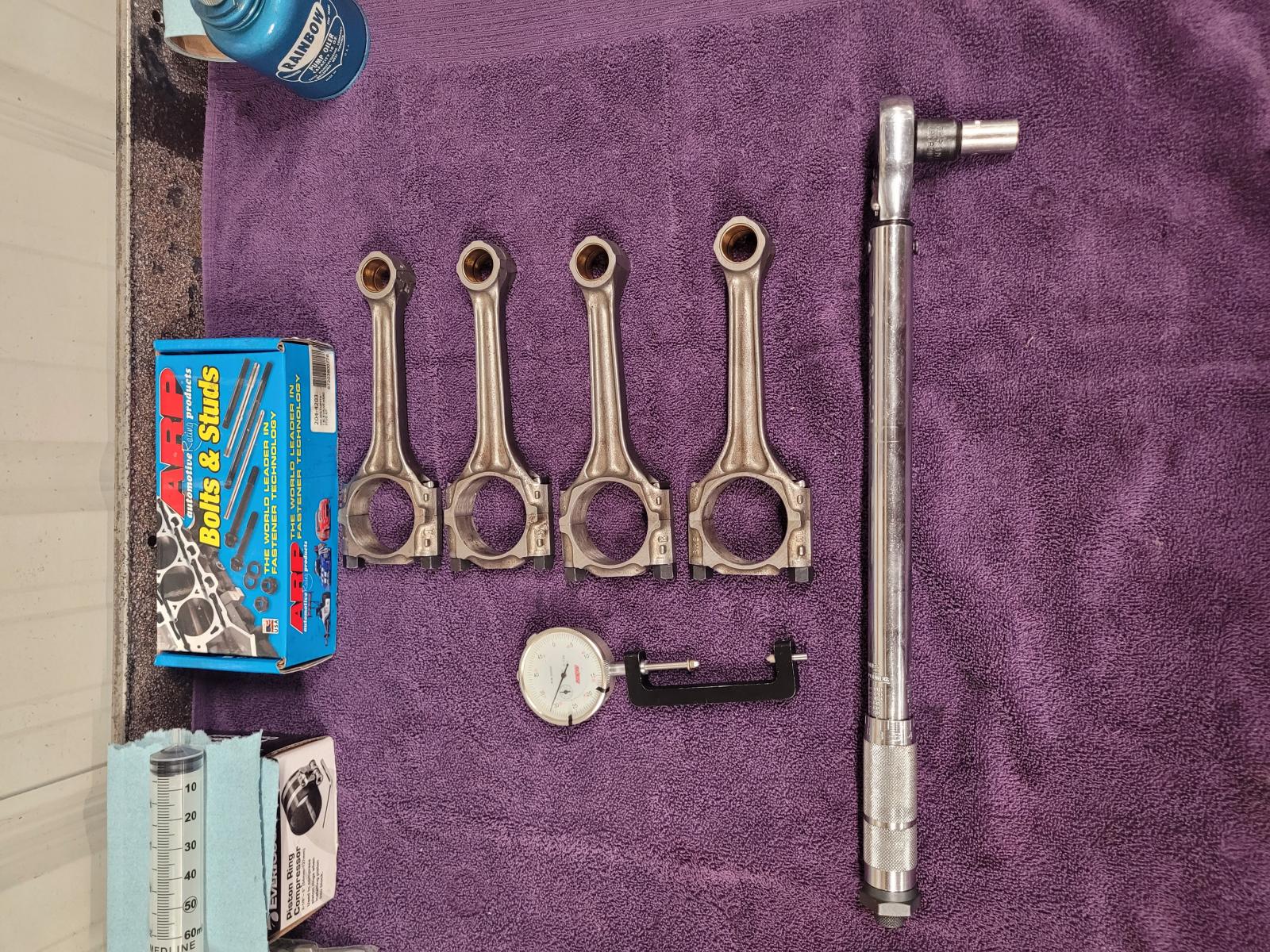

Well I tested my ARP hardware that came with my pistons on some spare rods. They are ARP 154-6002. ARP states to tighten till the bolt stretches .006" to .0065" or tighten to 35ft lbs. So as a test I tightened to 35ft lbs, but my bolt stretch was .009" to .010". To get the bolt to stretch to .006" to .0065", it only takes 21-22ft lbs. That seems like it doesn't take much torque to get to that stretch. I may call ARP about this and see what their thoughts are.

Just got off the phone with ARP. They said that the bolts may have been yielded during installation into the rods by pulling them through instead of pressing them in. However, I've had multiple people tell me they pull their rod bolts through for installation, torque to spec, and run them so I think thats what I'm going to be doing as well.

Update! Took the rods out, switched out the rod bolts for the ARP stuff, and put them back in correctly orientated. Put the head on and torqued it down for the final time, and we even calculated the compression ratio. We came up with 9.5-10:1. Now I can finish assembling the long block!

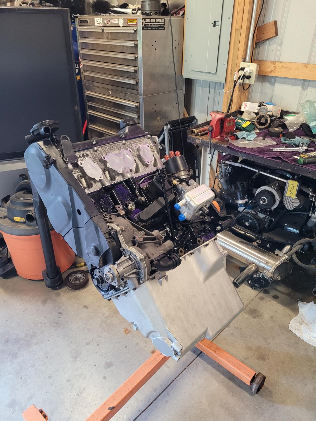

Another HUGE milestone today. The long block is successfully built and sealed off for the most part! I have to make a small flange to seal up on a port on the oil pan but that'll be real easy. This conversion is finally about to move to the next step. It's time to bring the vanagon in the garage.

PostPosted: Sun Jun 29, 2025 3:31 pm    Post subject: Re: ABA Vanagon Conversion Reply with quote
Just bolted on my ceramic coated AEG exhaust manifold with stainless steel hardware. Still getting things lined up to move the vanagon in the garage. I'll be doing that soon!

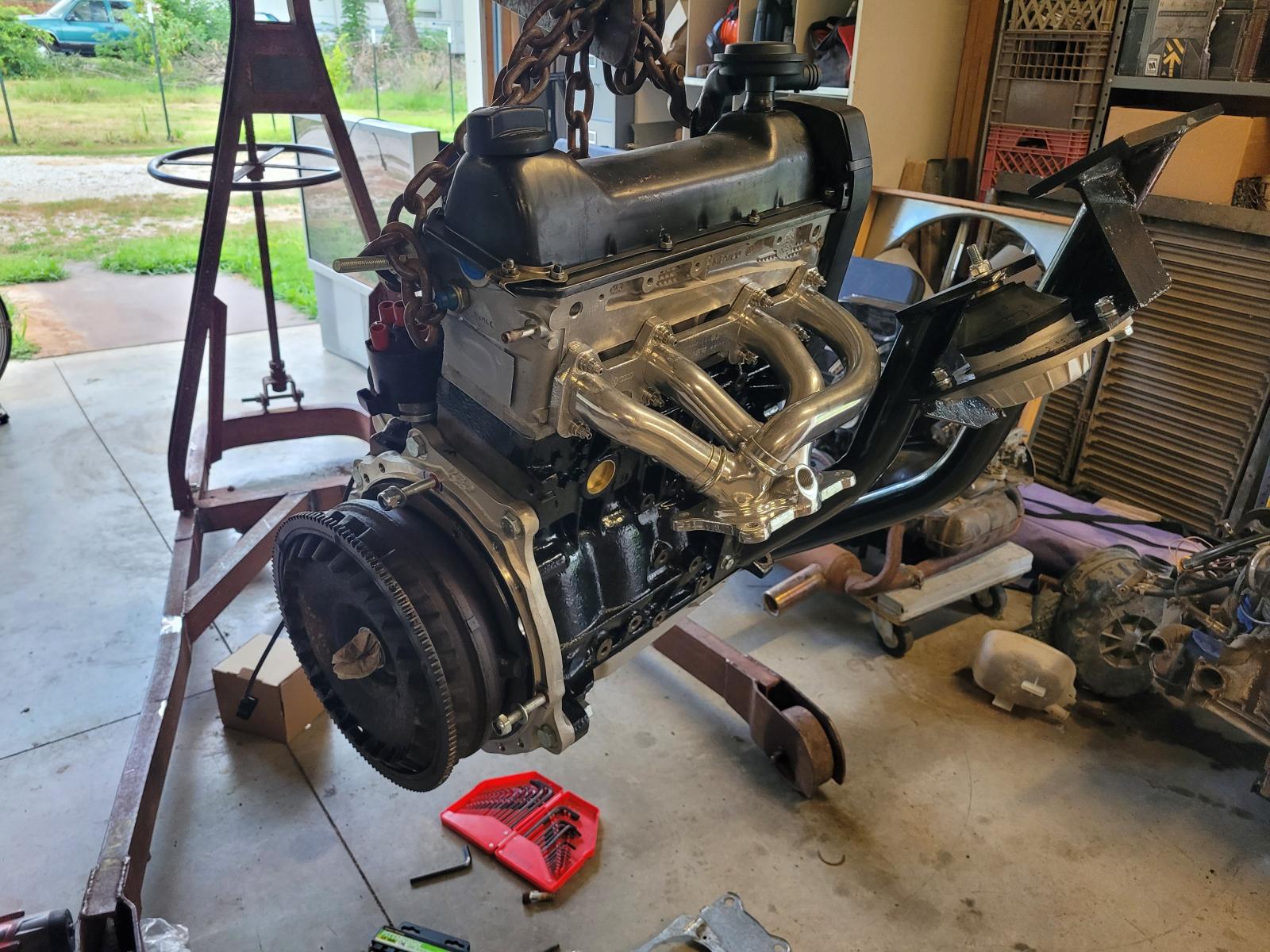

PostPosted: Wed Jul 09, 2025 6:41 pm    Post subject: Re: ABA Vanagon Conversion Reply with quote
First engine pull I've ever done. Got everything disconnected and pull the tired water boxer out of there! Now I'm going to get the engine side ready with the adapter, flex plate and torque converter installed. Then I'll clean the engine bay up, make sure everything is ready to install, and bolt it in.

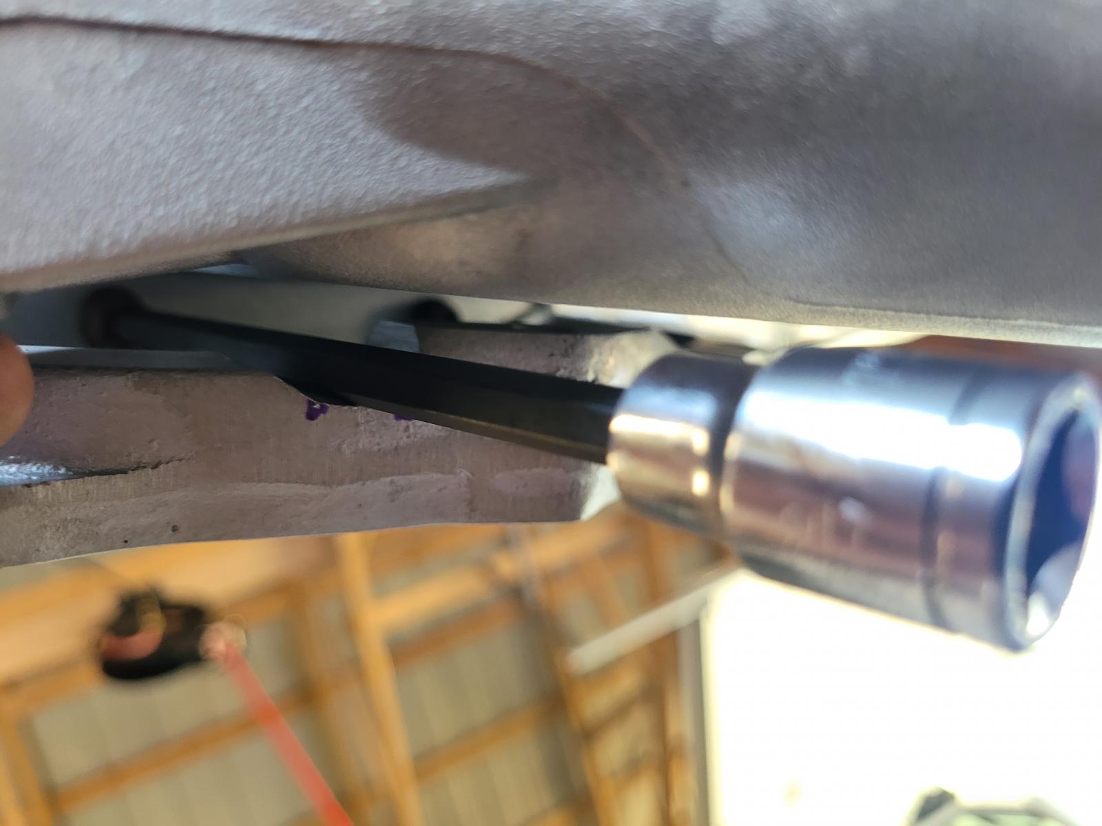

PostPosted: Thu Jul 10, 2025 7:31 pm    Post subject: Re: ABA Vanagon Conversion Reply with quote

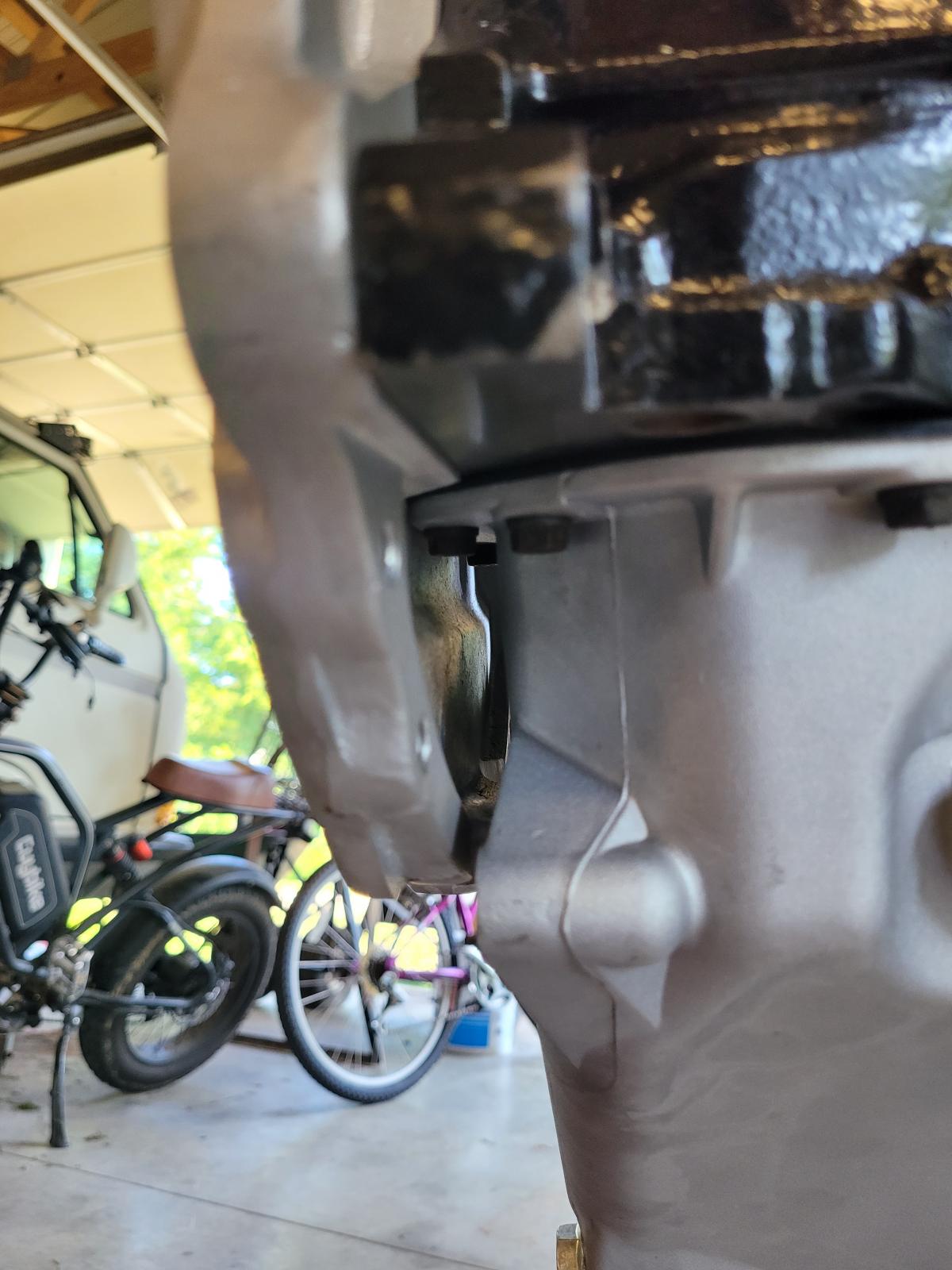

Did some test fitting on the kennedy adapter plate and noticed that the plate completely blocks the oil pan bolts on the engine.
With hardly any room to fit a tool in there incase I ever need to, I decided to modify the adapter plate to allow clearance of a long torx bit.
Small progress today, but hopefully something that'll save me down the road incase I end up in that situation. Next is to drill out the top left bolt on the bell housing so I can mount the adapter plate properly. More pictures coming soon!

PostPosted: Wed Jul 16, 2025 5:44 pm    Post subject: Re: ABA Vanagon Conversion Reply with quote

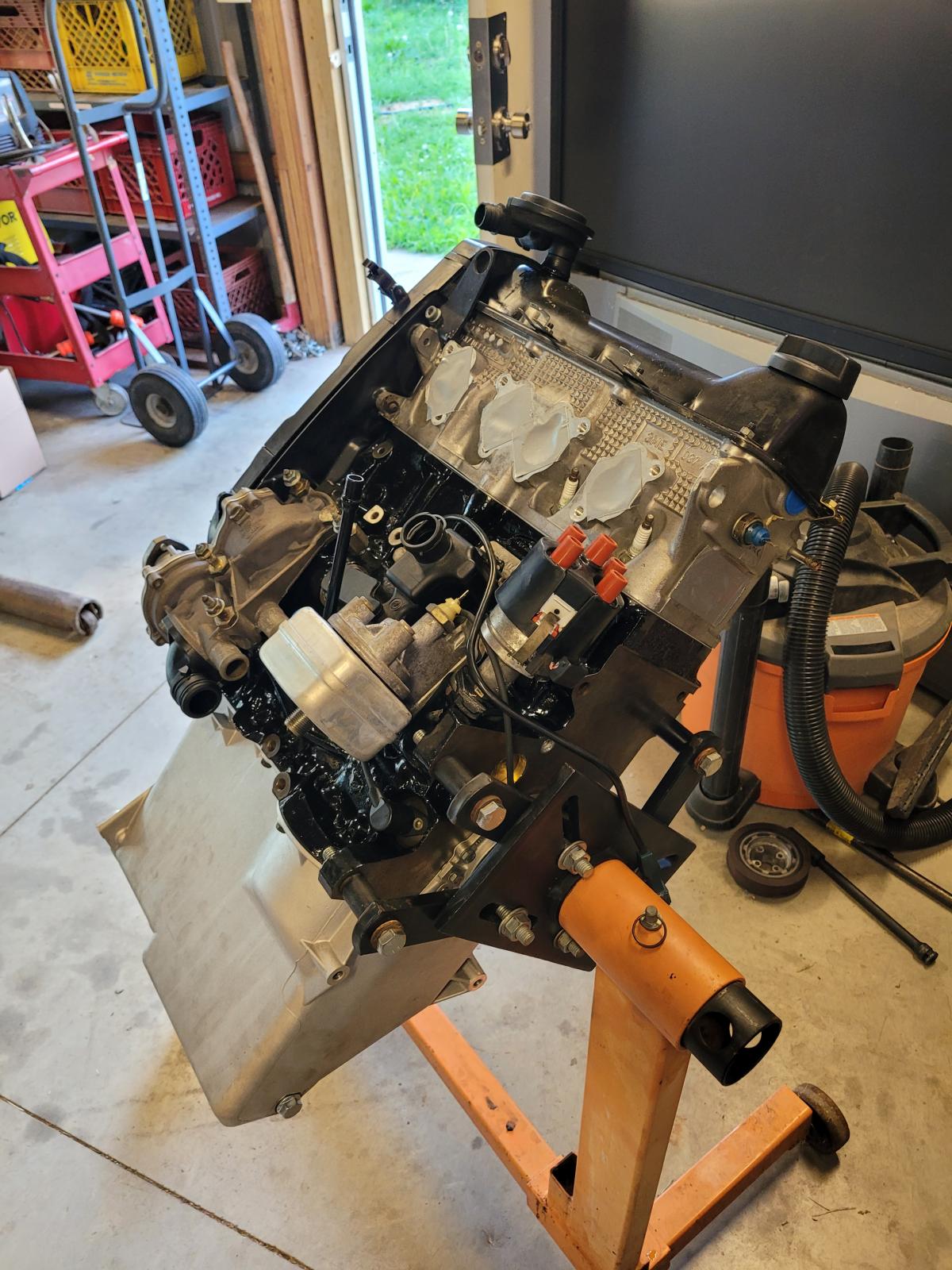

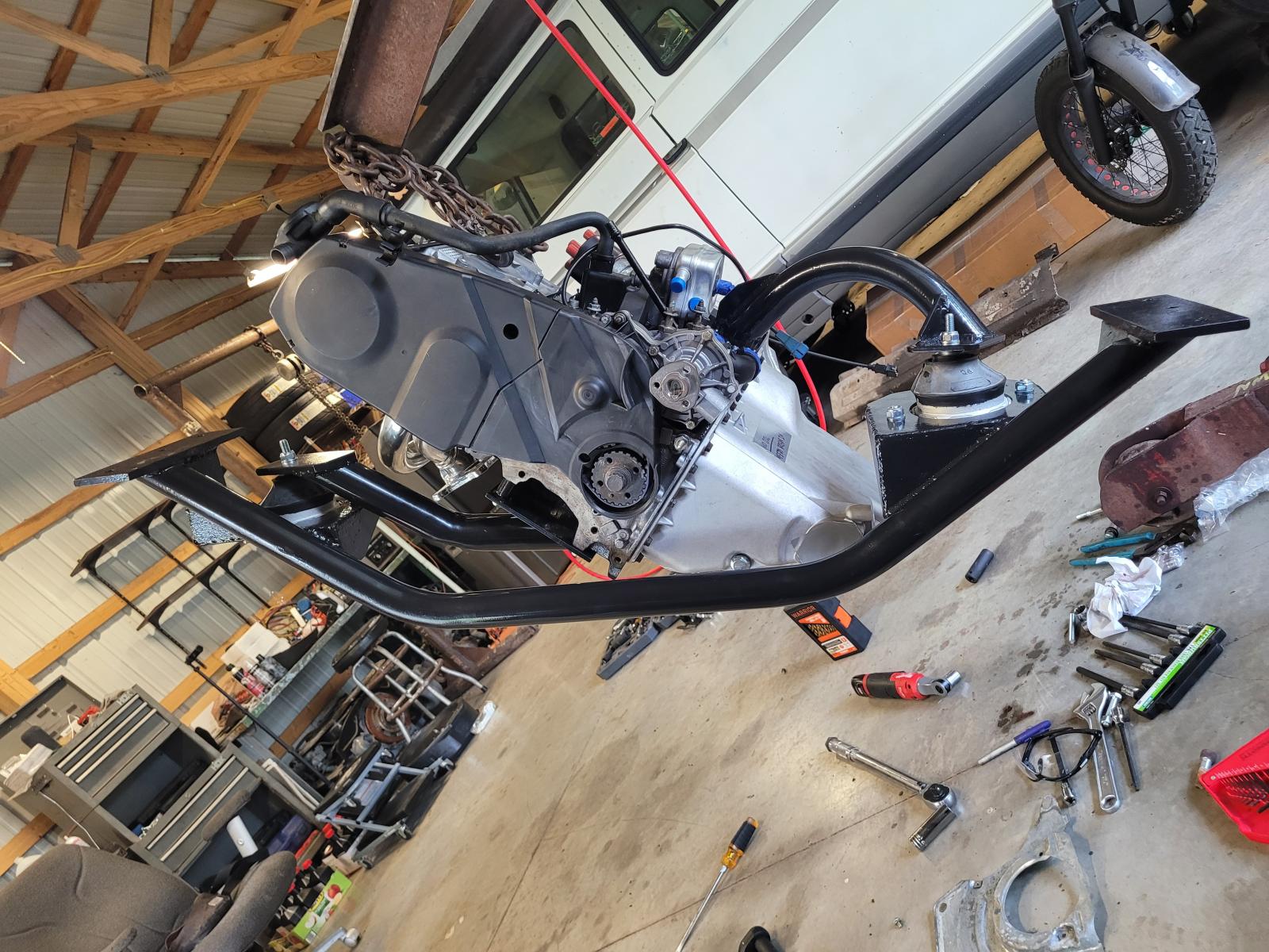

Got the ABA ready to install now. Torque converter, flex plate, adapter, and carrier arms are mounted on the engine.
Next is to clean up the engine bay, install a new torque converter seal, and start bolting things together!

PostPosted: Thu Jul 17, 2025 2:49 am    Post subject: Re: ABA Vanagon Conversion Reply with quote
Well, someone has never heard of piston slap, have they ?
Fix it/

Nice progress. I see the torque converter bolted up. I realize you are replacing the seal, but the torque converter needs to be installed fully into the transmission. There are 3 distinct steps that allow the torque converter to seat completely. Once the transmission is bolted up, then you attach the flex plate.
I donโ€™t believe you could get it correct with the torque converter mounted to the engine. Apologies if I misunderstand your method.
Thanks for the advice! Ive never installed a torque converter before, let alone one on a vanagon. Now that I think about it, I've read this on another thread before here on thesamba. I'll definitely follow the advice!
TC to transmission > engine to transmission > TC to flex plate.
