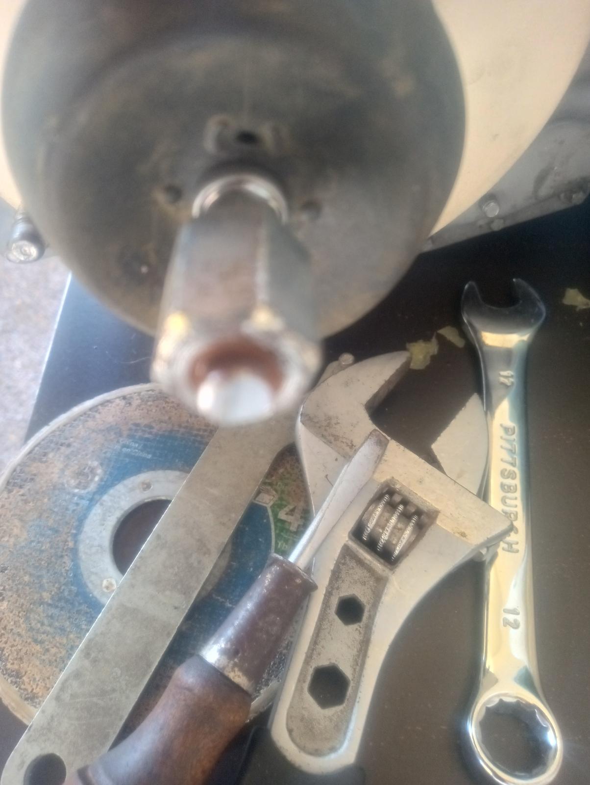

Initially I put a couple of wrenches to spin the bracket to snap it off. It didn't snap. Then I got my angle grinder, put the disc between the forks and used the edge of the disc to grind the head flush with the bracket. Then used a screwdriver to pry the bracket off leaving me with a small umm..."protuberance".
The grinder quickly took care of that to give me a smooth, flat surface, which is what is needed. Then used a file to clean up any rough edges.

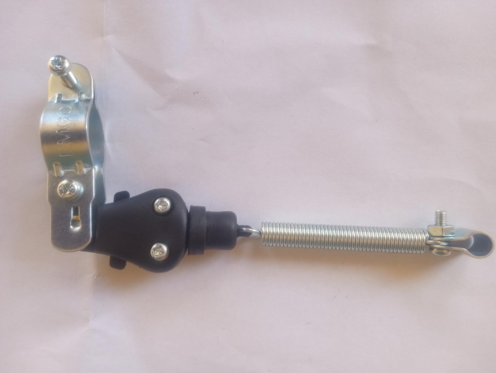

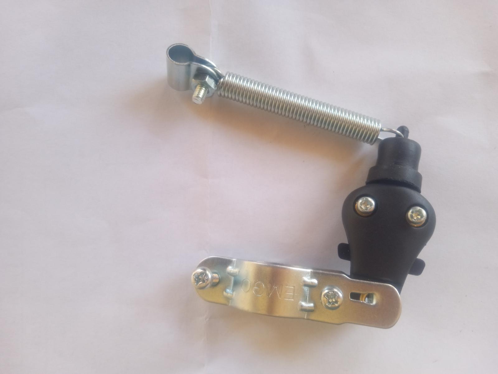

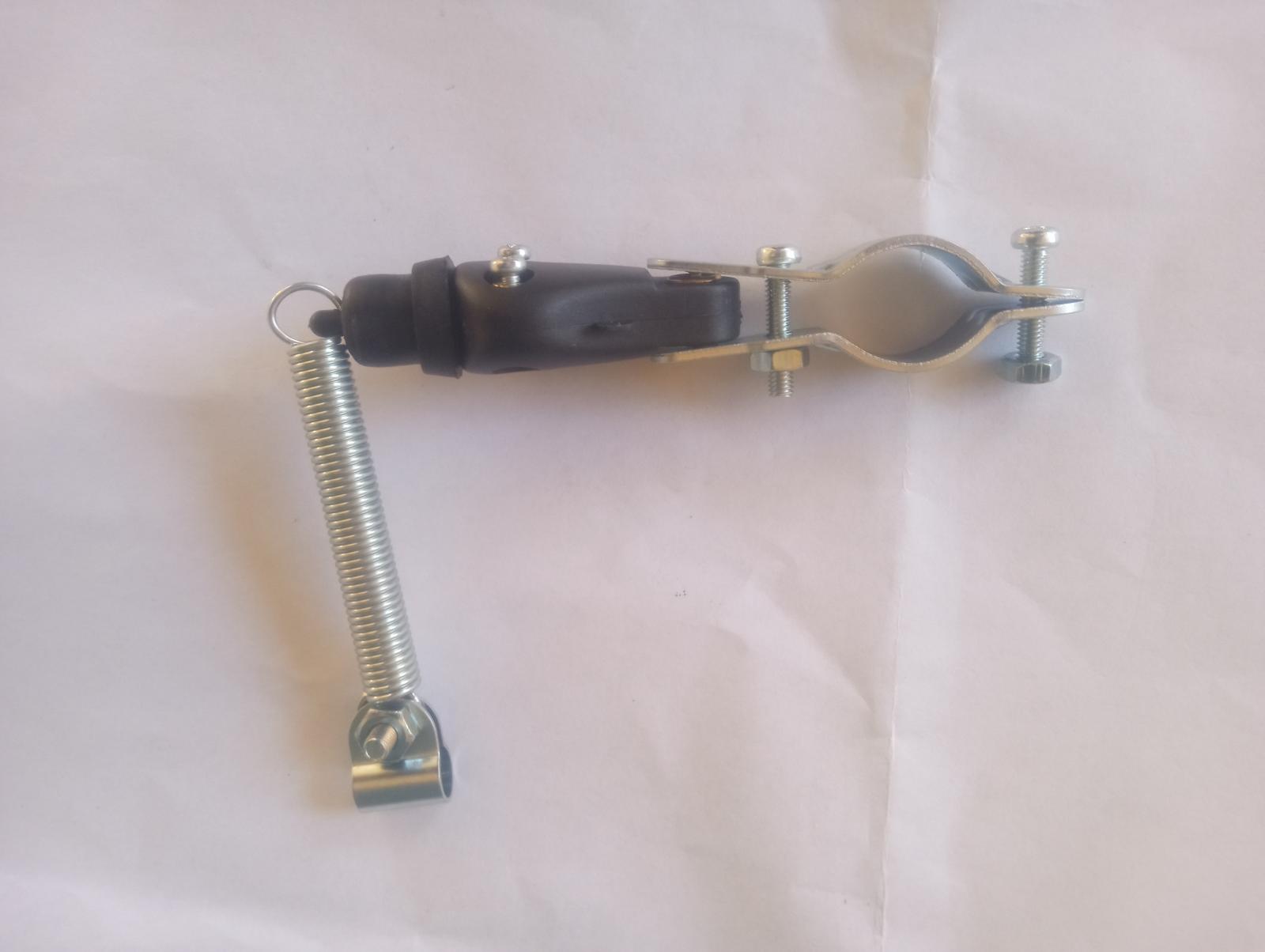

I went in search of a weather resistant/ water proof brake light switch. And because of this post;
lil-jinx wrote:
a L bracket and a hose clamp instead of welding, would be adjustable
This had eventually caught my eye;
It's a rear brake light switch for a motorcycle and it had just come in today. The switch feels very well made, quite solid and I believe could fit the bill.

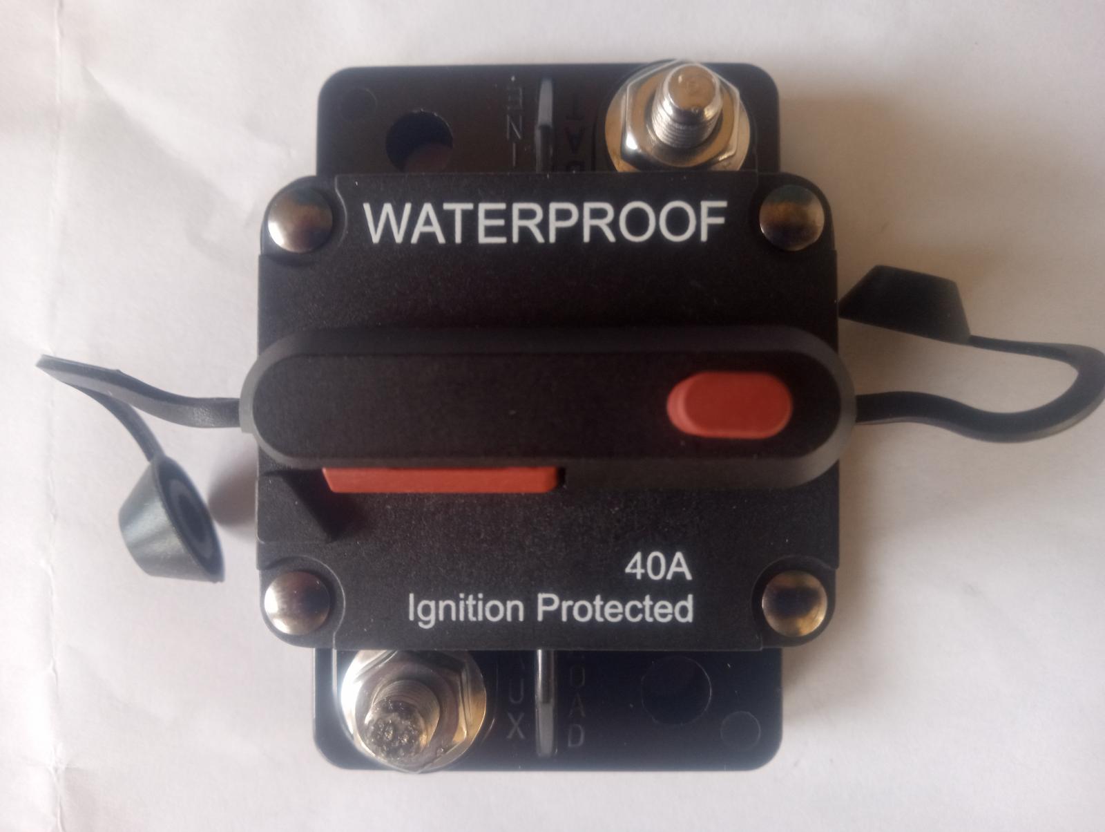

I also got the circuit breaker in;

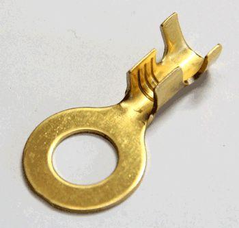

This is a nice little unit. Feels nice and sturdy. I like it. It came with these copper lugs;
The barrels tho are too big for 10-12 gauge wire. These are for 6 gauge so I put them aside for later and got a bunch of these coming in;
I like this open barrel style because for one, they are all brass and 2, the top part of the barrel crimps on the bare wire while the bottom part crimps onto the insulation. Which gives it a stronger hold. It's like having that Kung Fu grip.
