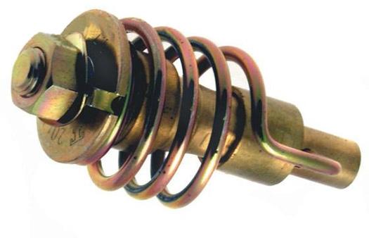

I've had three of them fail in the past year or so. Maybe something changed in the materials he uses to seal these. I don't think there's anything I'm doing when installing that is causing the failures. Got one directly from AP in December 2023 (failed and replaced/repaired after about 1500 miles, now replacement has failed after about 2000 miles), and another from a different vendor that also failed in a similar short time. I was hoping maybe the other vendor had older/better stock but I guess not.
All were type 4. Other versions may be different.

Use the bellows type, do NOT use the spring with wax chamber type. The bellows type will fail in the safe, full cooling position, the spring loaded wax filled chamber type will fail in the unsafe, closed, no cooling position, which can destroy your motor.
below is the BAD spring wax filled chamber thermostat, DO NOT USE this type!!!!!!! When it heats up, the wax expands in the chamber, pushing a piston that fights the spring (stretching the spring) this then opens the flaps for full cooling. when the seal in the wax chamber fails, the wax leaks out, and will no longer stretch the spring, thus the spring will hold the flaps closed, assuring that your engine does NOT get cooling air when warmed up
Bad type...
The bellows type will fail if it leaks, gets a crack, but it will fail so that the flaps open so you get full cooling. The bellow will fully expand when it fails, as when sealed and cold, a vacuum keeps the bellows collapsed, loose the vacuum do to heating (liquid inside the bellows when heated boils, and thus increases the pressure inside) or a leak (air will rush in and expand the bellows), and presto, she expands and your flaps will be open for full cooling A very safe design.

Yep. He's replacing the latest one. Told him how that one seemed to only partially fail so that it only returned halfway to cold position, which seems impossible unless it got hung up on the bracket or maybe if the cable slipped where it attaches to the flap rod. I checked and it cleared the bracket OK and the cable was still clamped where it should be. That half-way thing only happened a few times that I saw before it failed to the fully expanded state, so maybe there was a very tiny pinhole leak?
The one I have installed now has been working fine for about 1000 miles (I do a lot of short trips so that's actually a lot of warm/cold cycles) and isn't doing anything weird yet, so maybe I was just really unlucky and the first two and one replacement all came from a batch with weak solder or something? I feel like I have a "talent" for finding the worst part in the run, so it wouldn't surprise me at all if nobody else ever had an AP thermostat fail.

My understanding is that you should never test a bellows thermostat unrestrained outside of its holder. To do so allows the bellows to stretch past its normal position leading to damage.
I wonder how many people heat their new thermostats up to see if it works and then find out that their thermostat is damaged "out of the box"?
